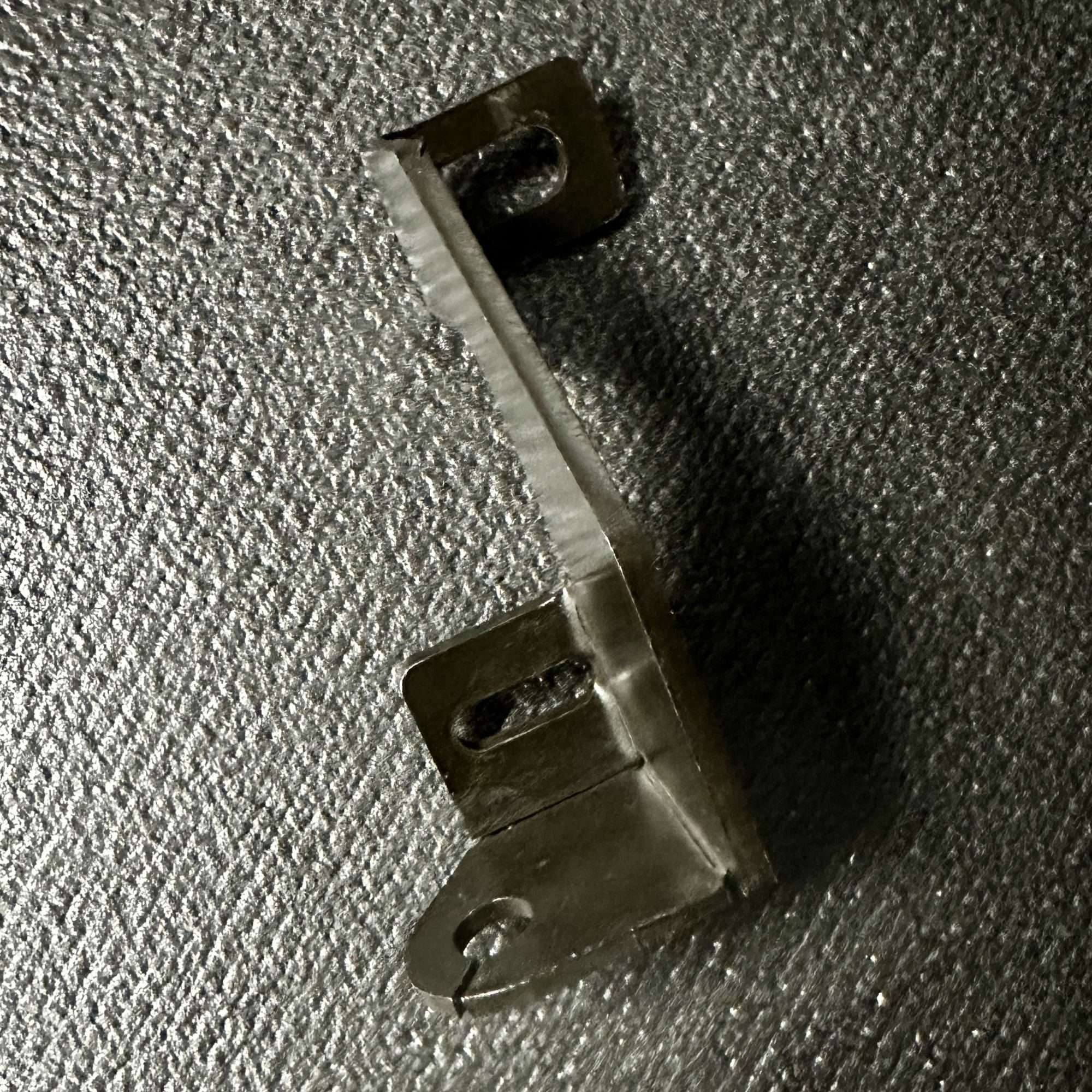

What is your plan for throttle cable linkage? I was looking at the DPUK linkage kit but curious what others are doing?I’m going to redo the whole a/c system with all new, modern components from Cold Hose - https://coldhose.com/ minus the evap core. I was planning to use the Mercedes compressor but I’m having a tough time finding the right manifold adapters for it. I’ve read that an fzj80 comp will fit the 606 bracket and I’ve found a bosch and a denso model that each have the proper clutch and pulley, should fit the 606 bracket and there are existing manifold adapters for them. Crossing that bridge when I get there.
I'm planning on using this and probably the dpuk setup myself.What is your plan for throttle cable linkage? I was looking at the DPUK linkage kit but curious what others are doing?

Thanks! Looks like a good option. Wish I would’ve been thinking about throttle stuff as I just recieved a big order from DPUK and shipping and tariffs suck! Would’ve been nice to add to my order!I'm planning on using this and probably the dpuk setup myself.
FJ60 FIREWALL THROTTLE CABLE BRACKET - For EFI Conversion - TOYOTA LAND CRUISER - RL1035 (SN2-16) - Red Line Land Cruisers
The FJ60 Firewall Throttle Cable Bracket for Sniper Conversion with Lokar Throttle Cable is made by Red Line Land Cruisers for 60-Series Toyota Land Cruisers.redlinelandcruisers.com
I bought the DPUK kit and the fuel pre heater plate with the mounting tab for the cable. Modified my pedal to accept a cable and used some fj62 pedal parts to make it all work and add an oem hand throttle. Deets are in my build thread.What is your plan for throttle cable linkage? I was looking at the DPUK linkage kit but curious what others are doing?
