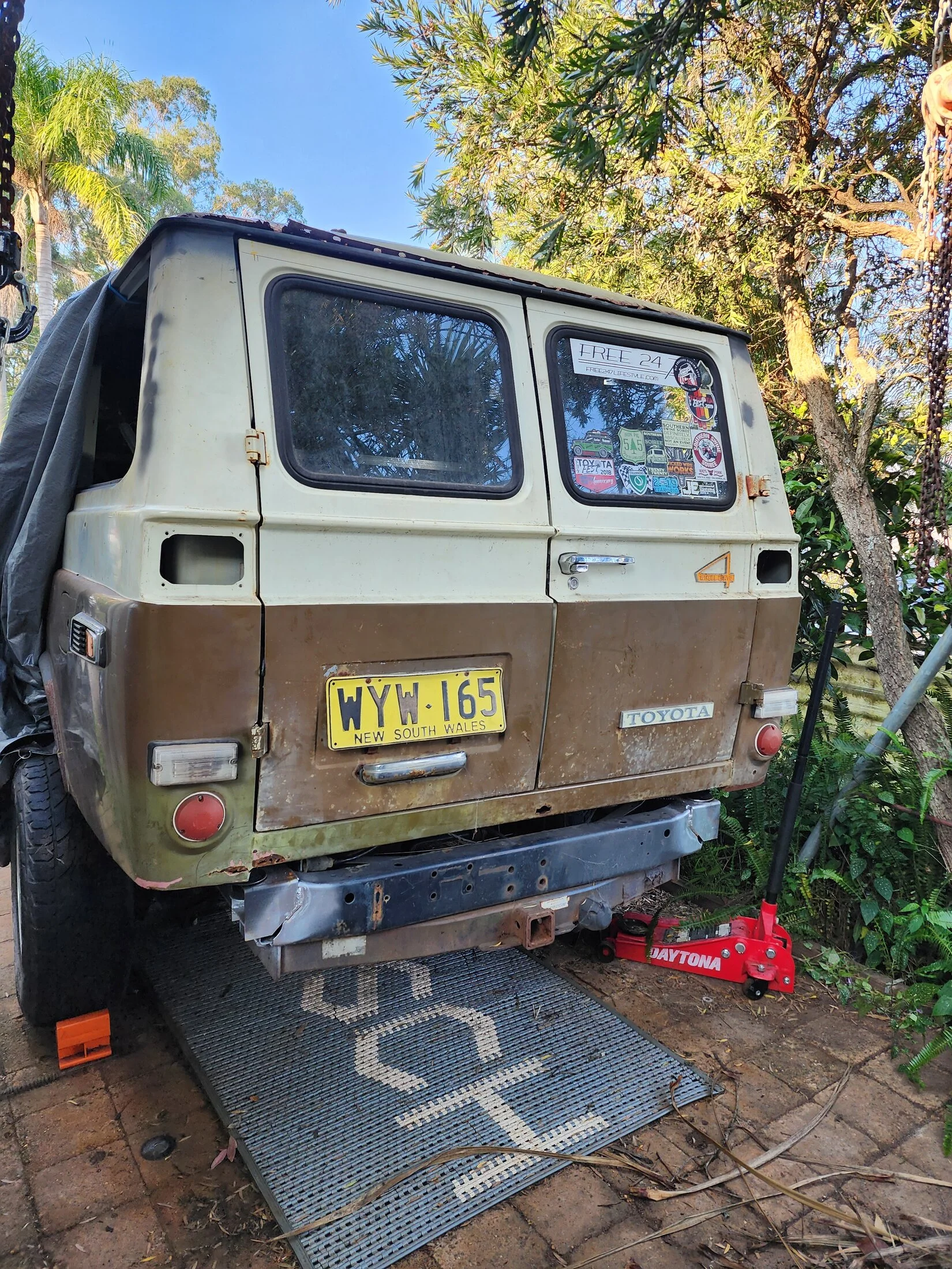

Smooth as silk.

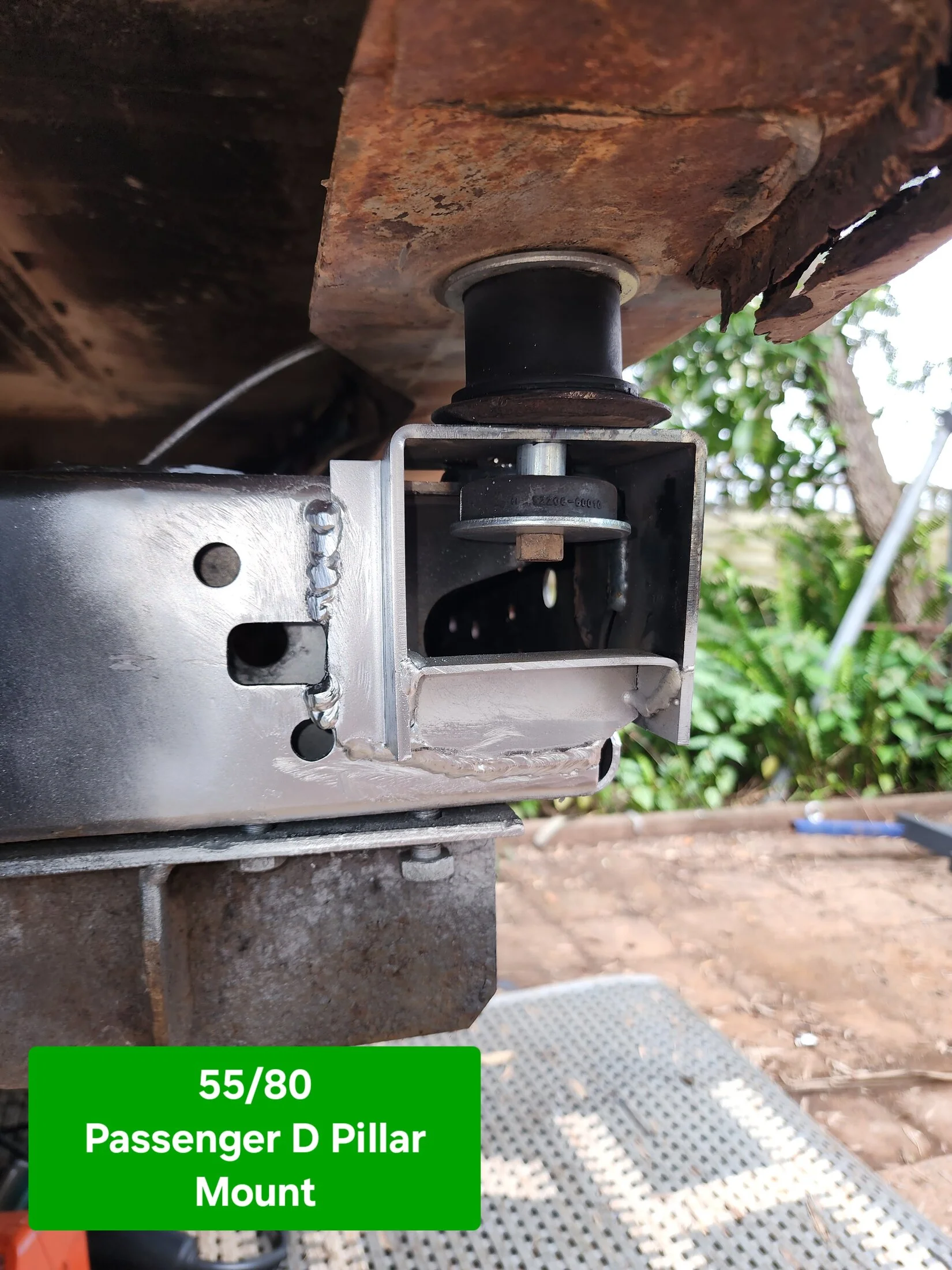

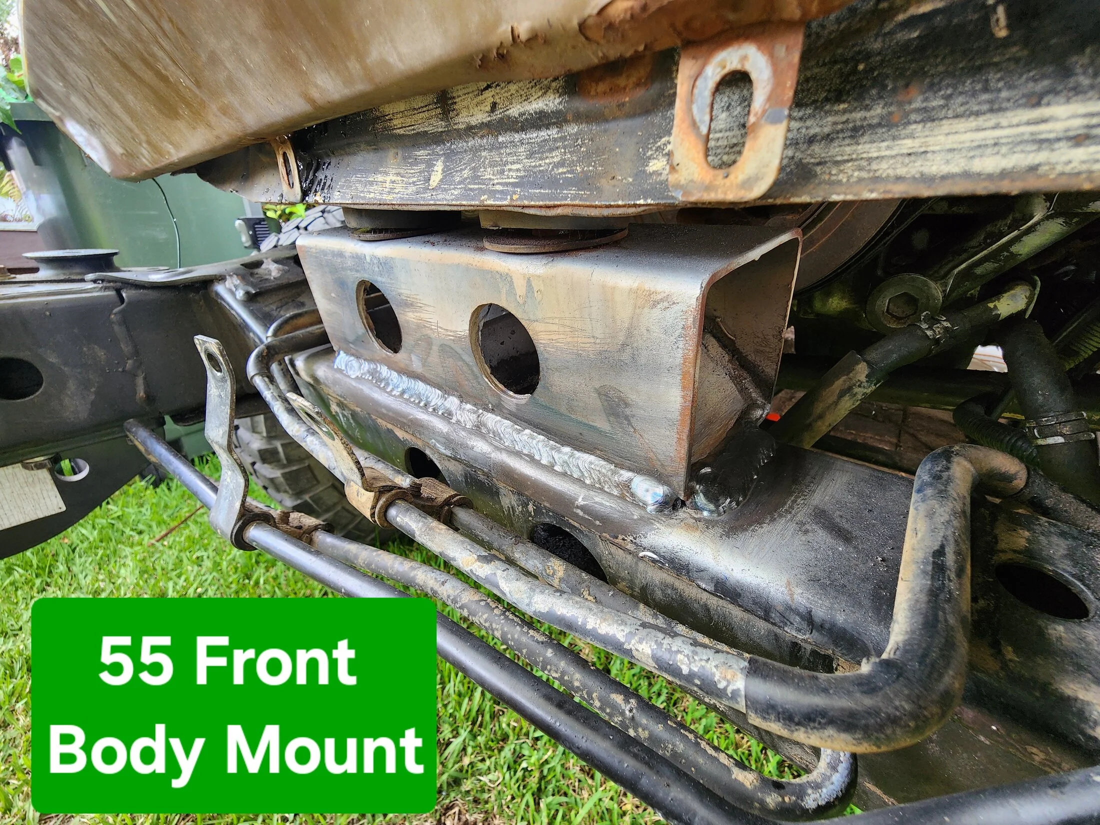

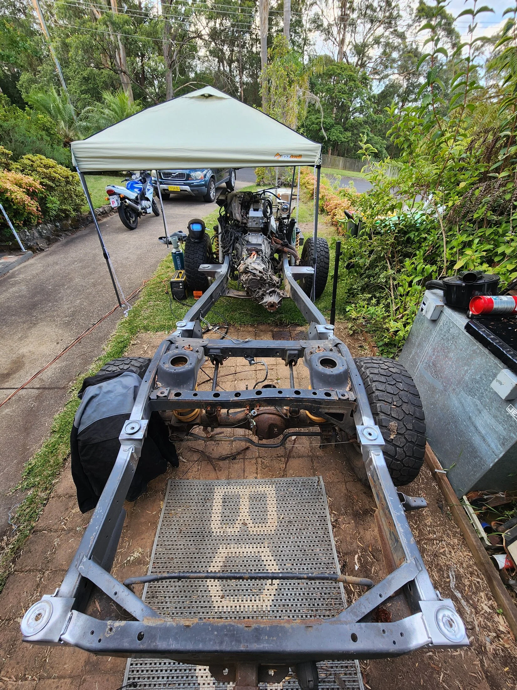

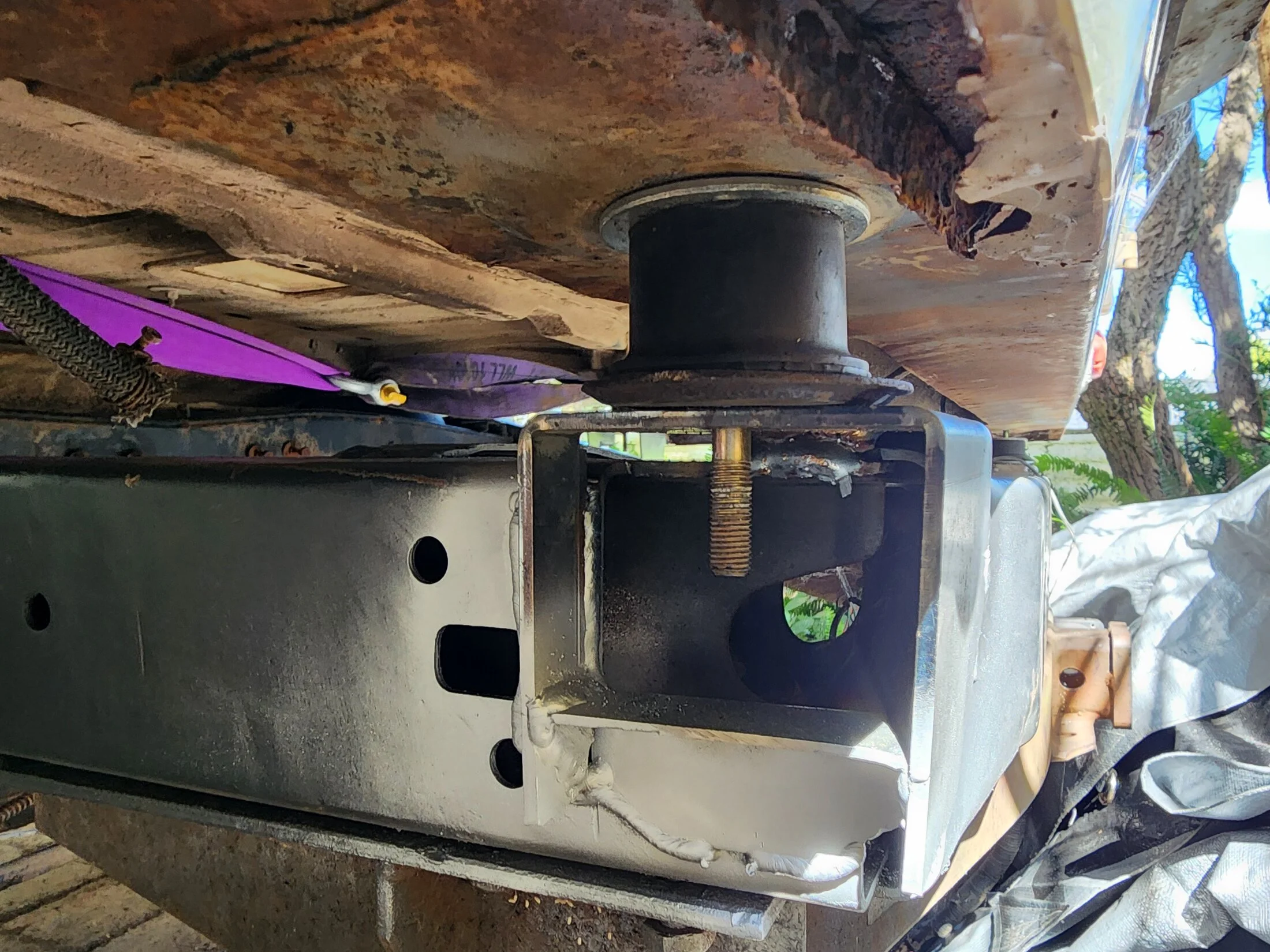

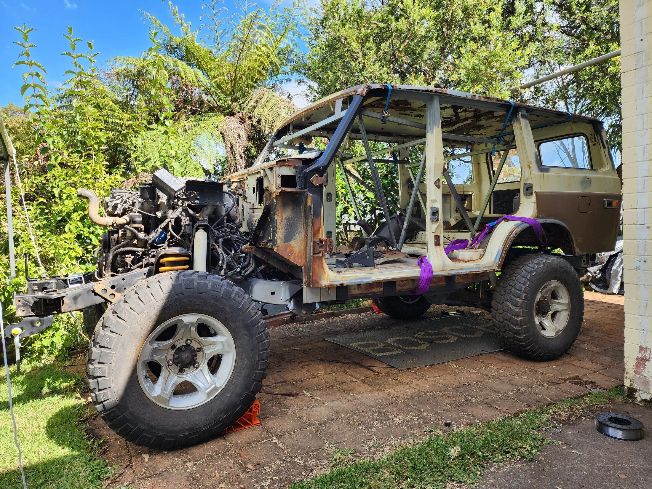

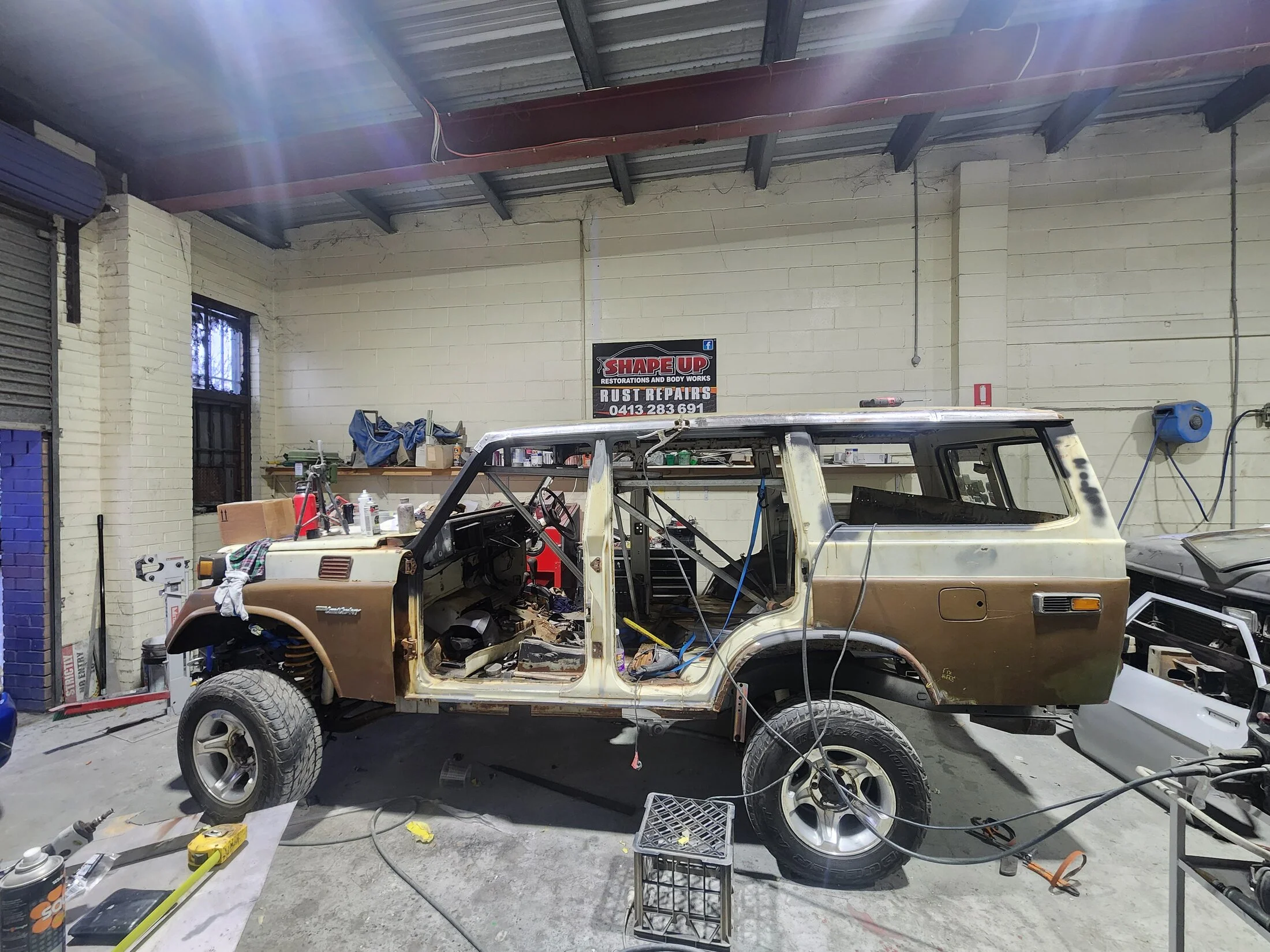

Body mounted to the chassis, sitting on factory 80 series rubbers right round.
Making crush tubes and tweaking body mount lengths now.
Weekly update.

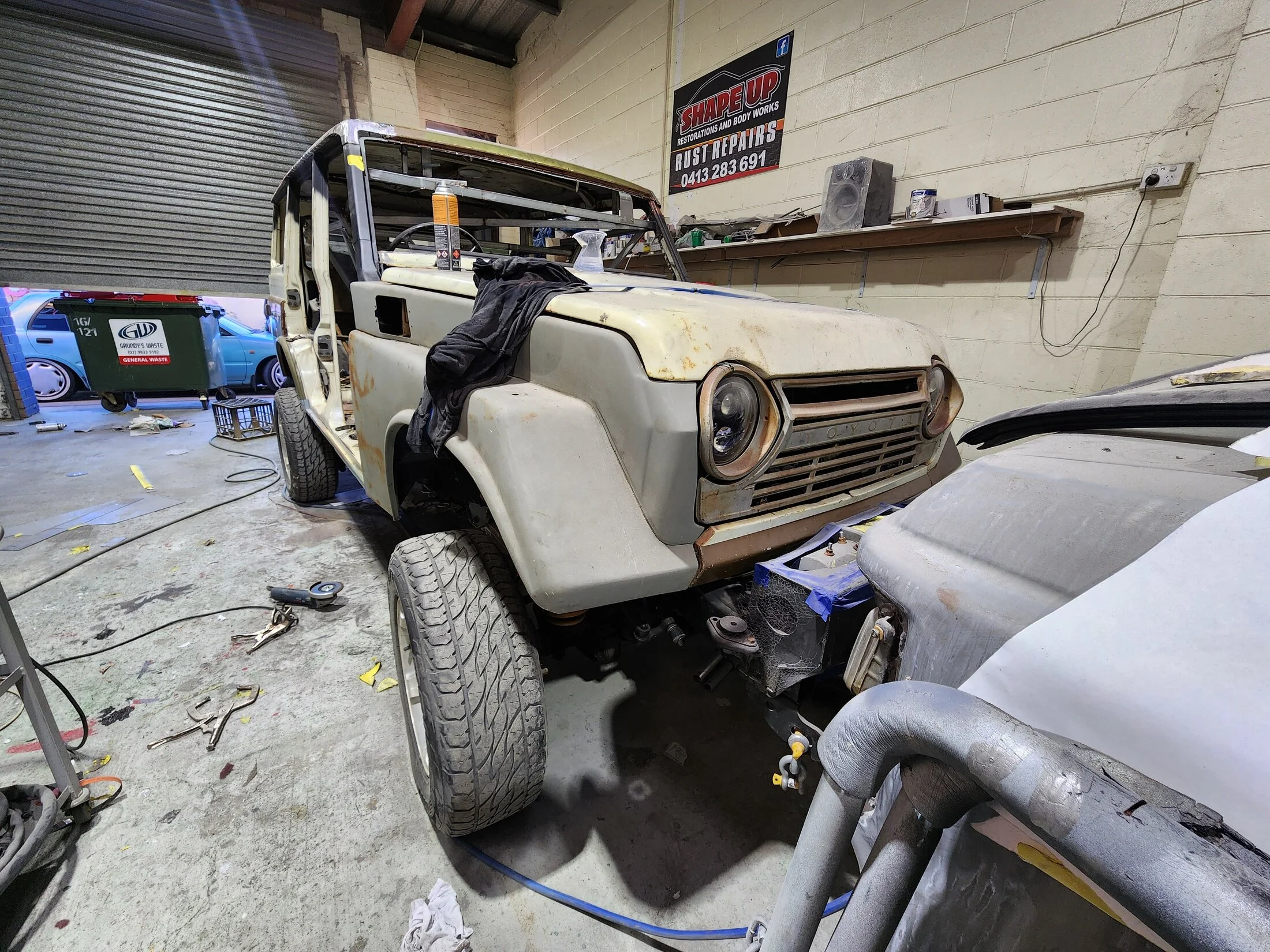

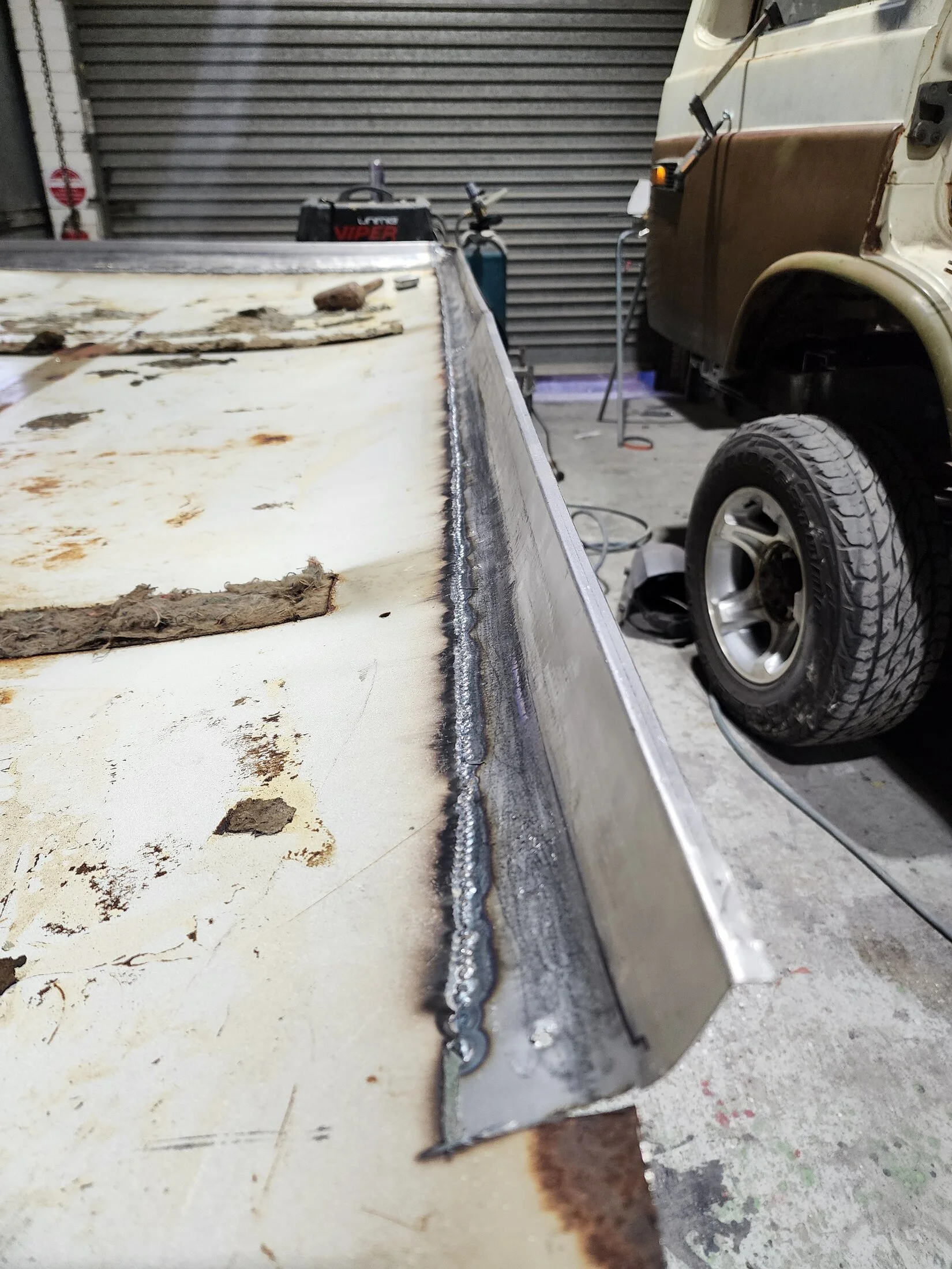

FJ55 looking fine with some hot passes on the welder. Utilised a stick welder to lay some hot beads as my engineer wasn't happy with my first attempt, welds were too cold.

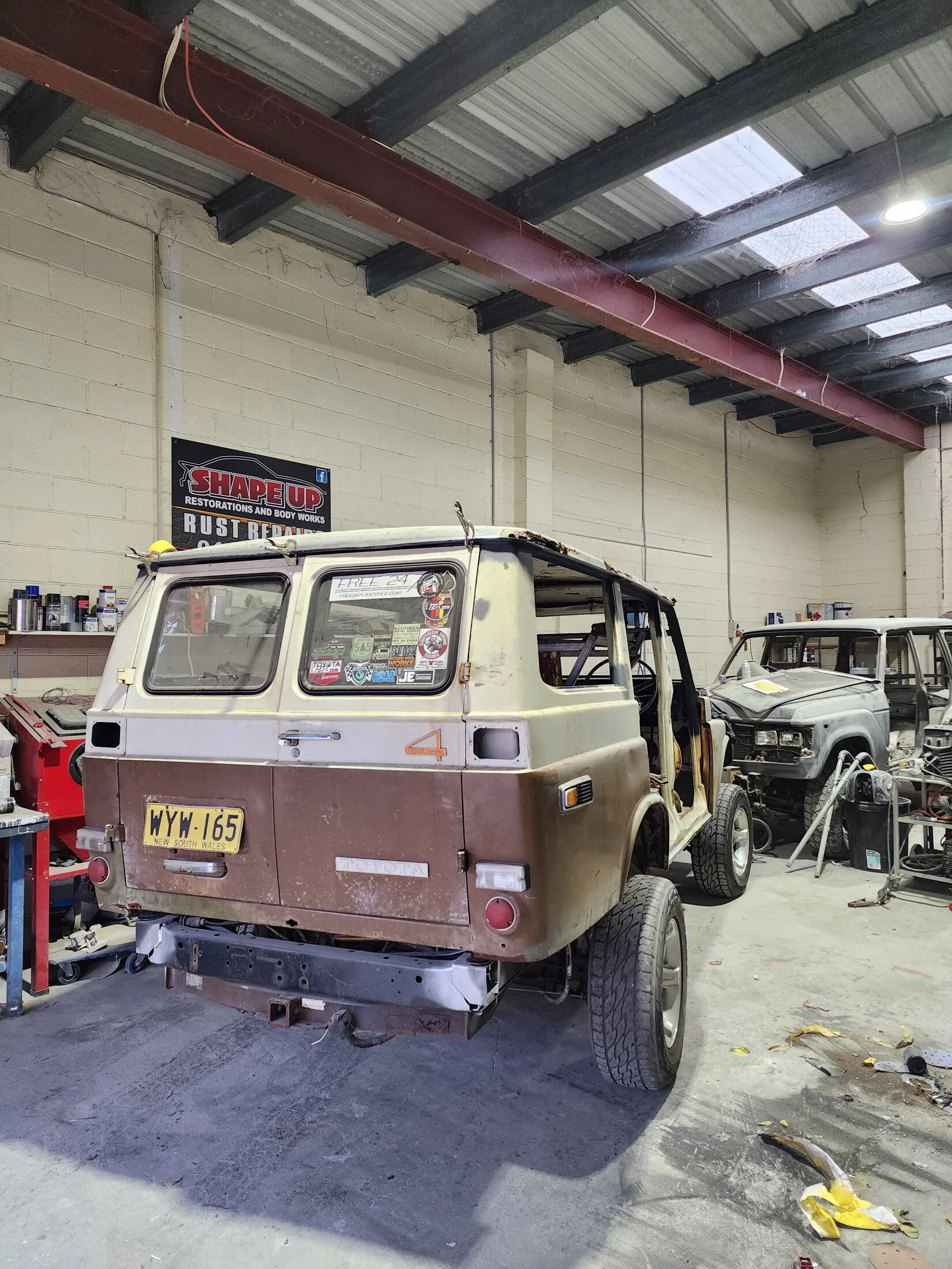

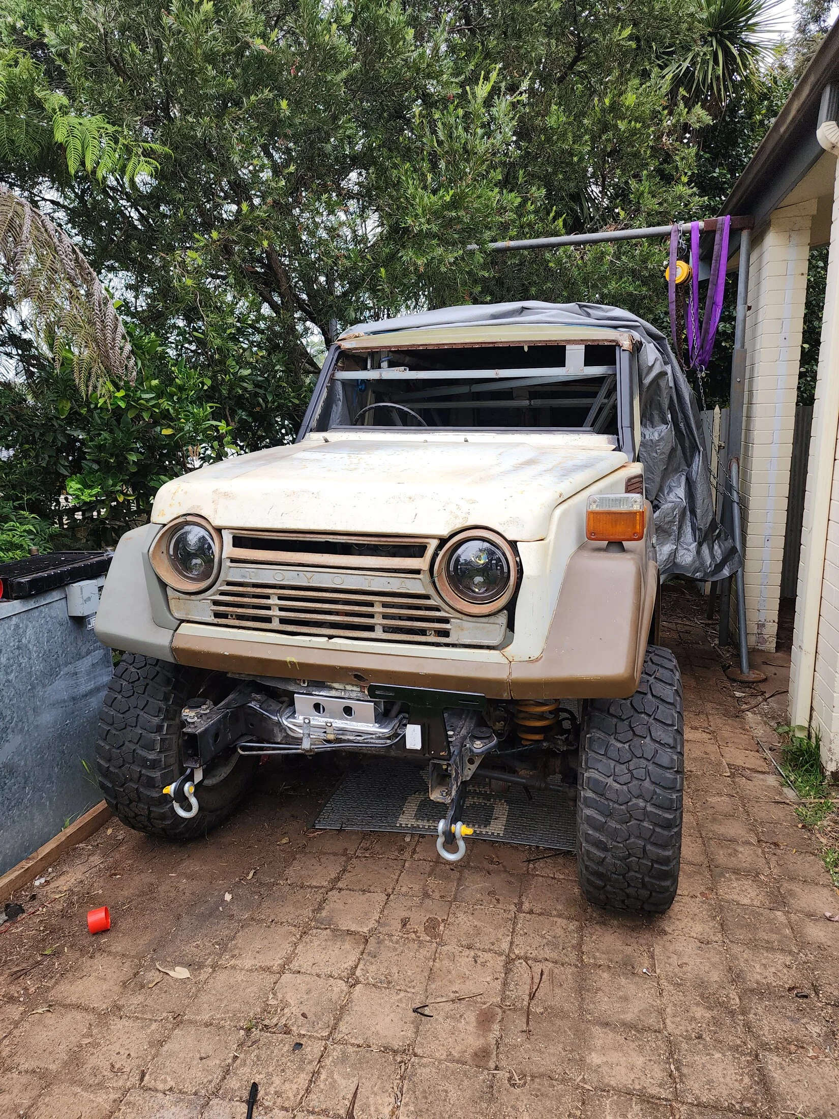

Brown 55 is primed ready for the next stage.

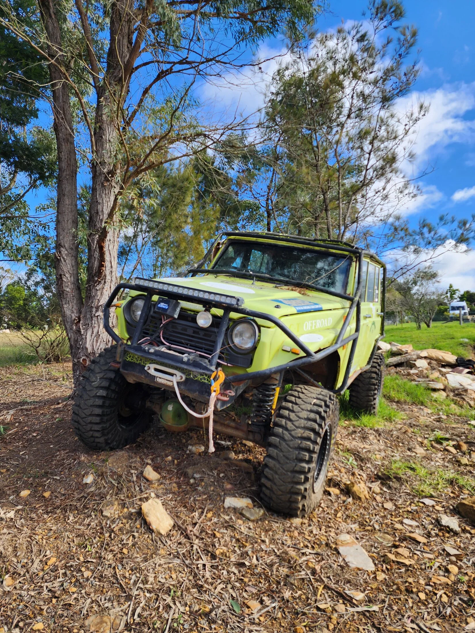

Green 55 is in need of a fuel solenoid and it's back on the tracks.
Reminds me of my old Crawler , Lot and lots of fun ! Bloody Hell mate !:beer::beer::beer::beer:

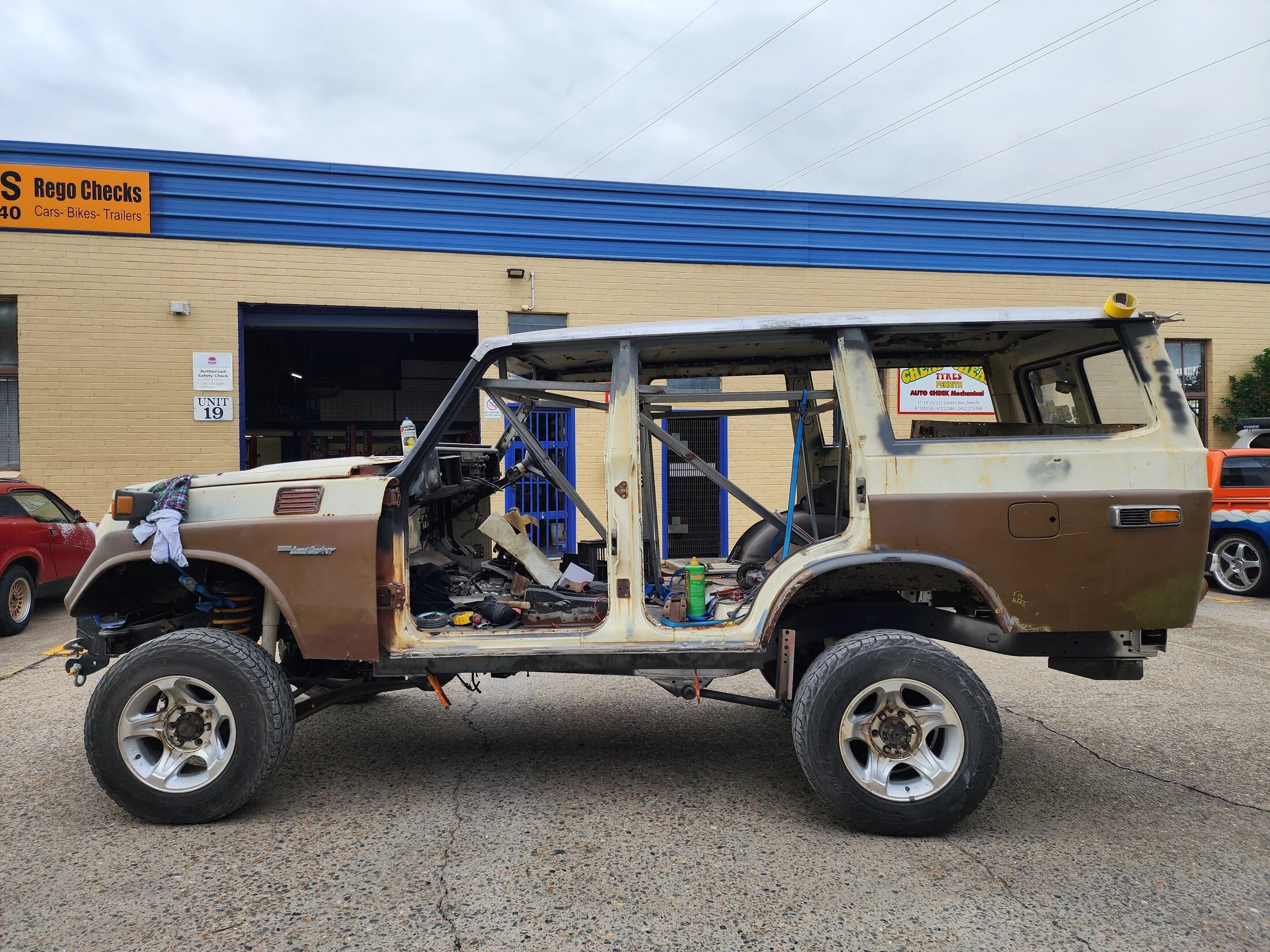

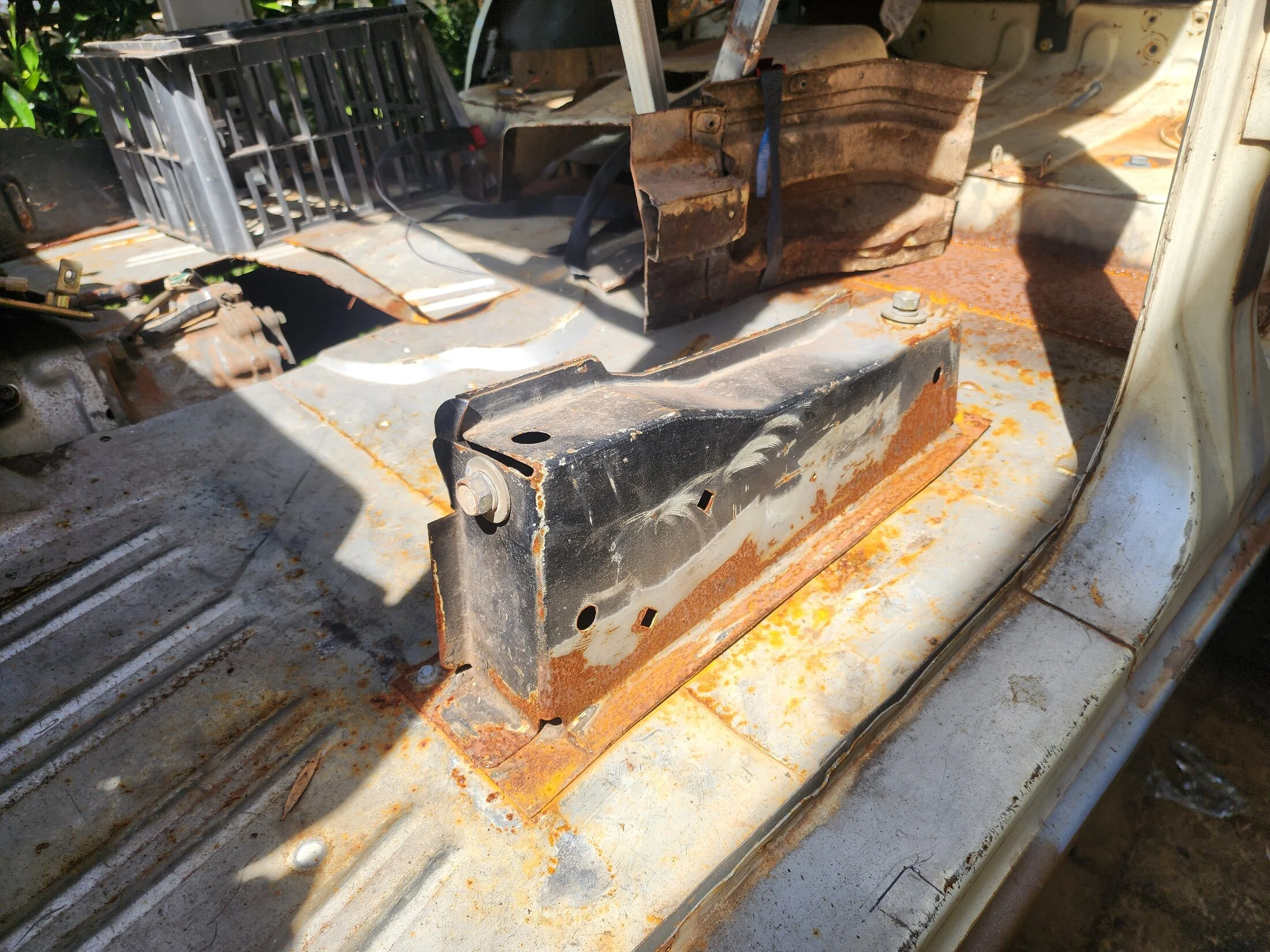

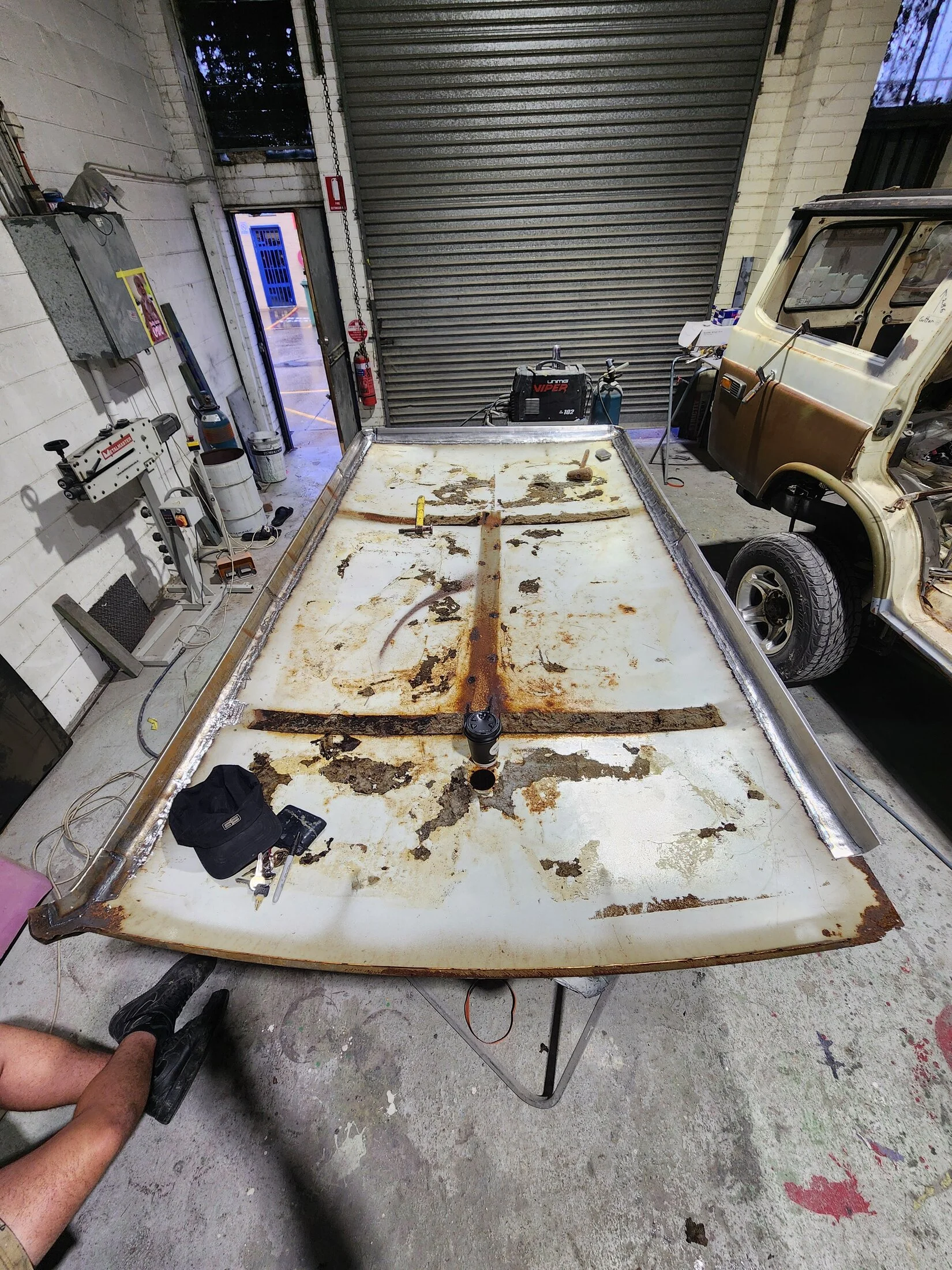

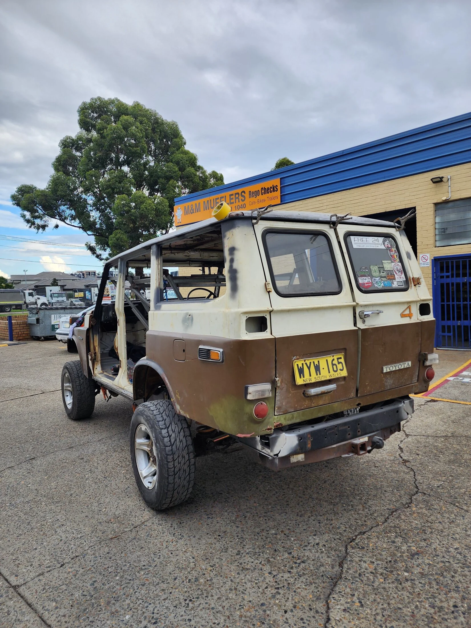

Tomorrow the 55 heads to have the rest of the rust cut out and repaired. Looking forward to putting this into primer this year.

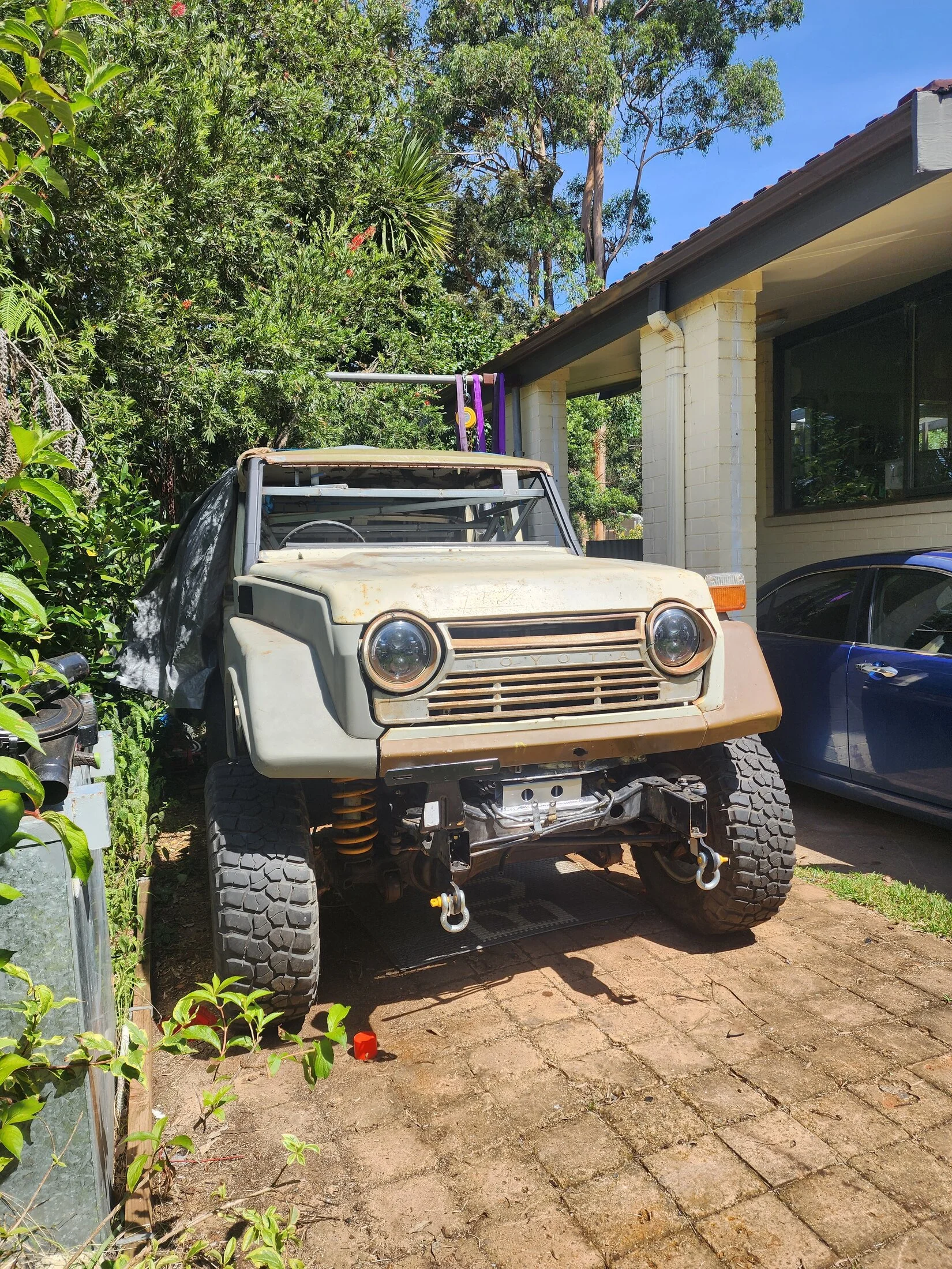

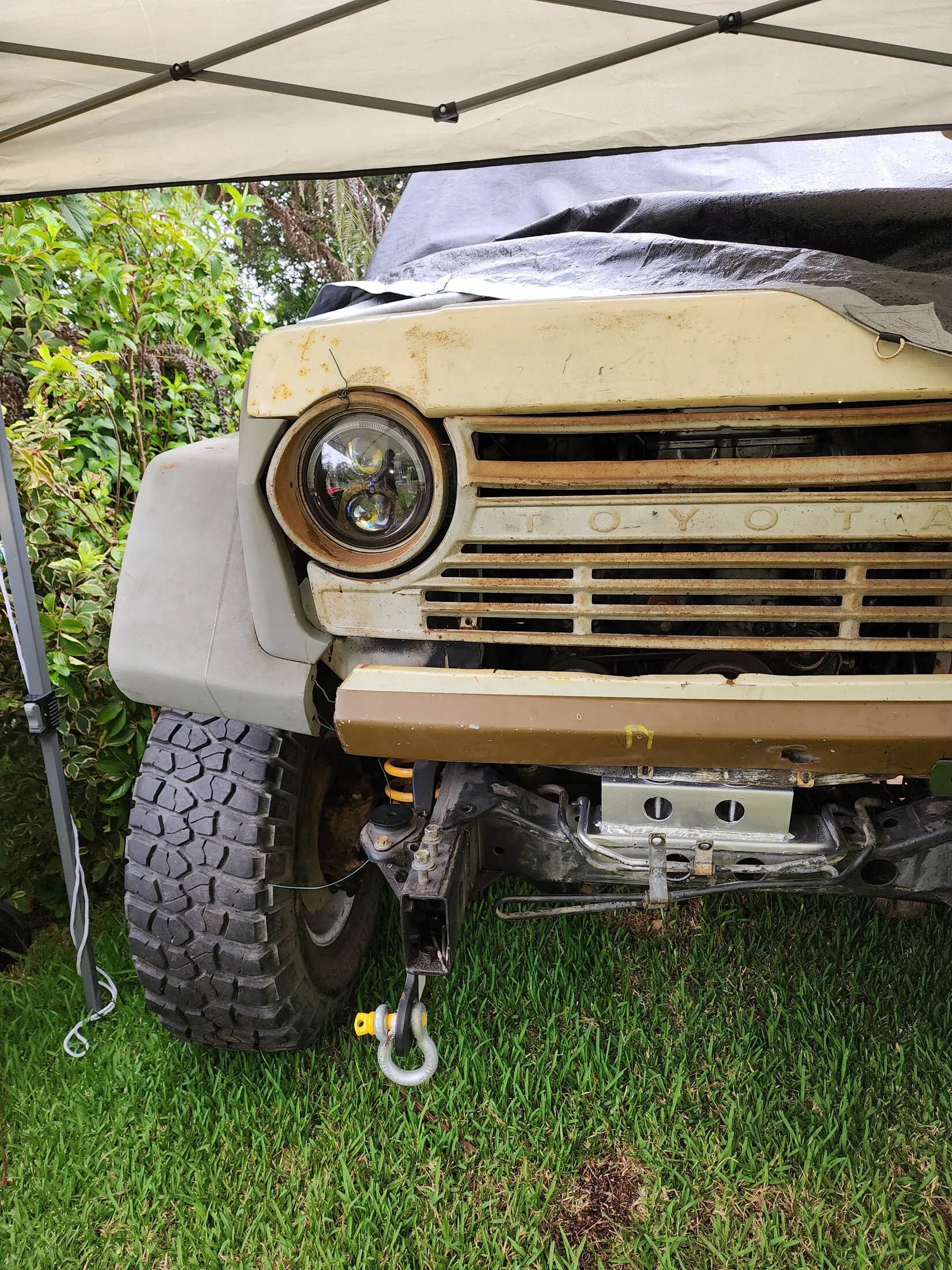

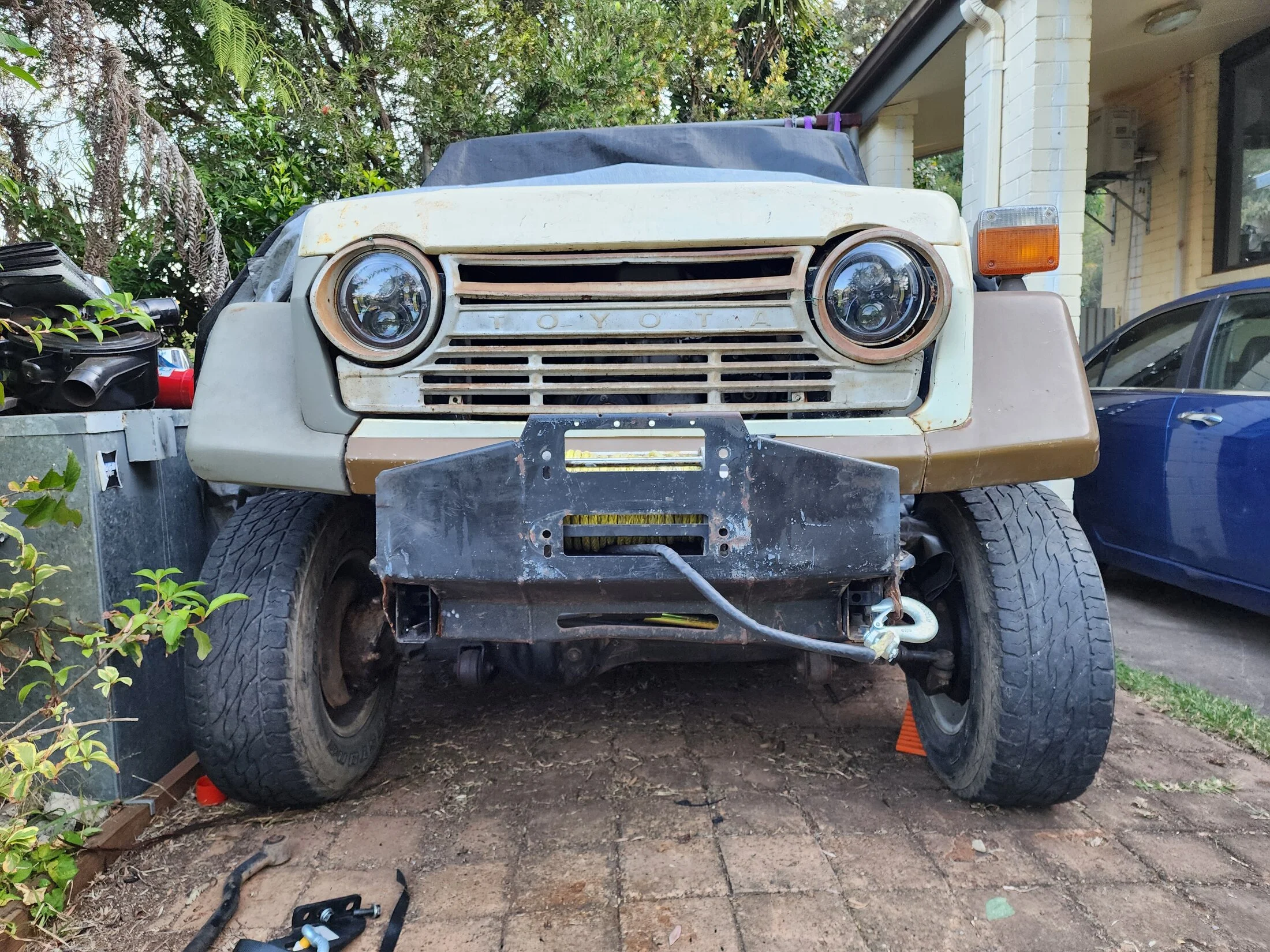

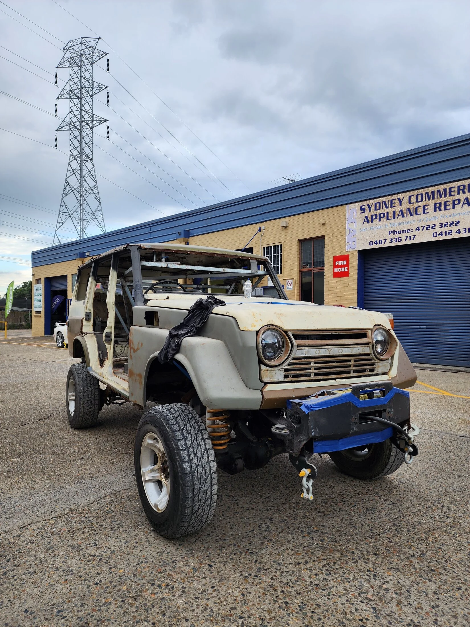

I am playing around with using a HDJ80 ARB Highmount bullbar to suit the 55 body, though I'm not sure it'll stay. Needs some tweaks.

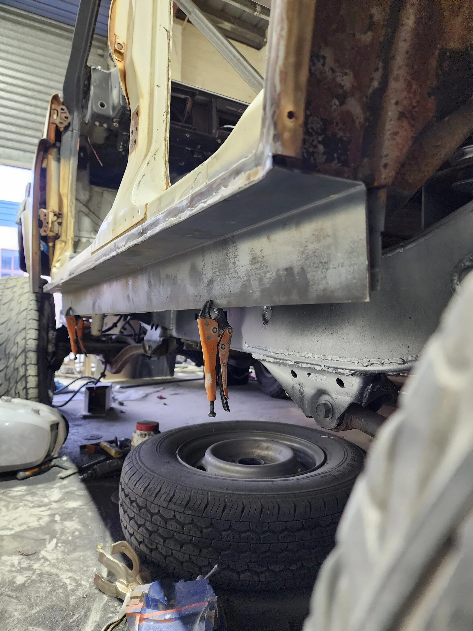

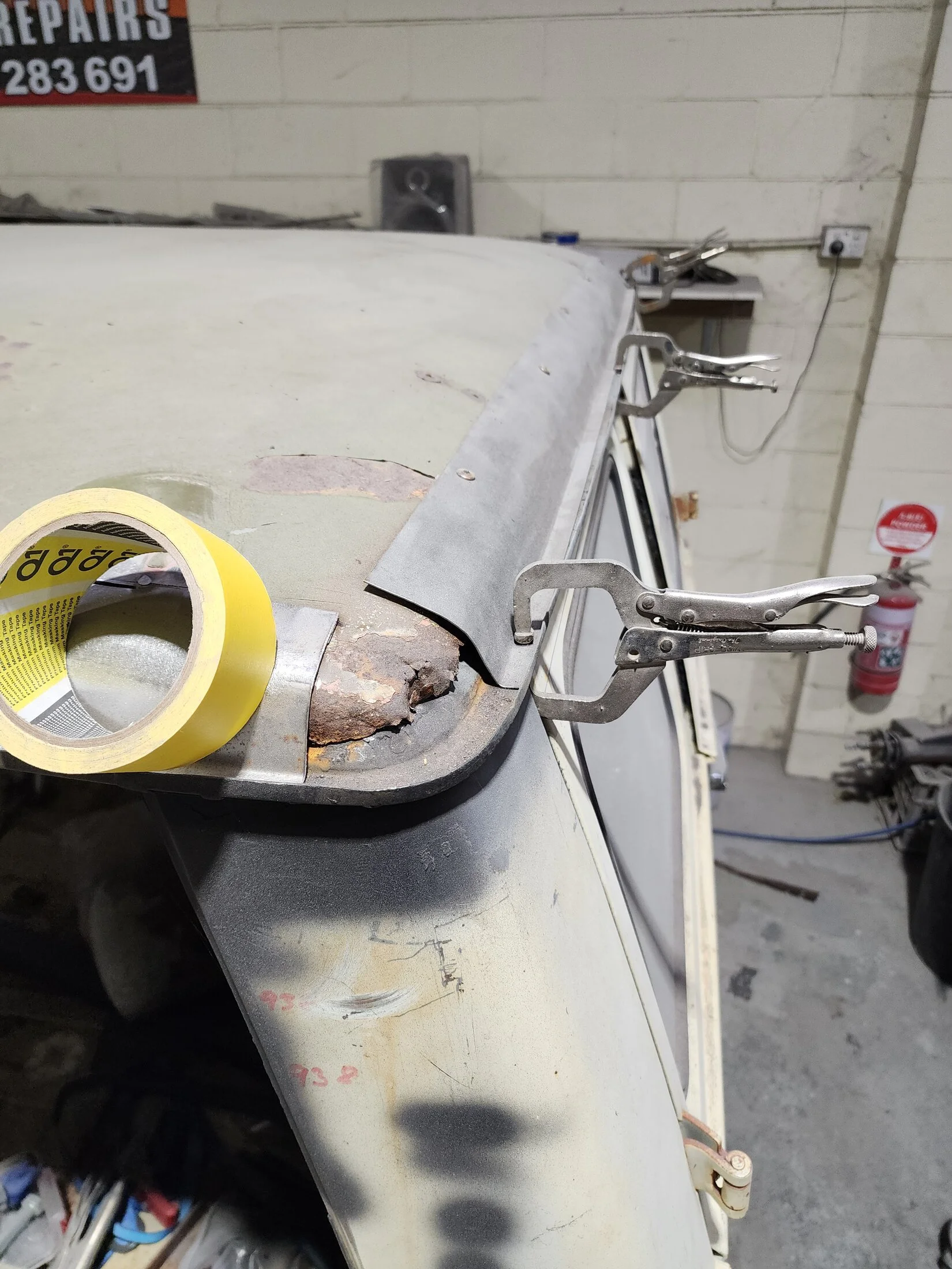

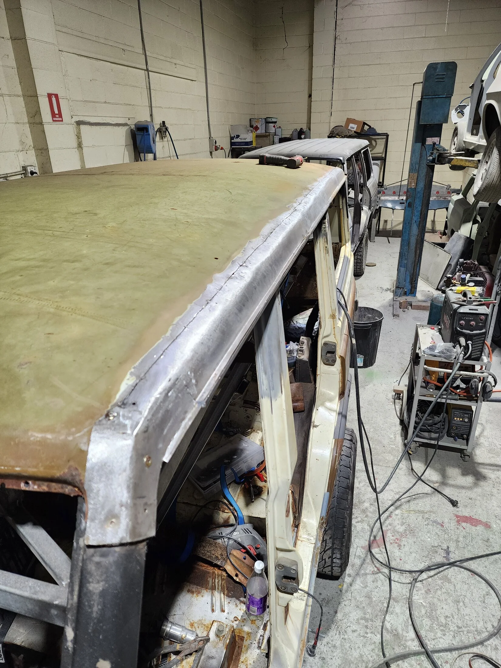

Passenger's Side Roof and body sills nipped up.
Onto the drivers side.
Bit of progress every day.

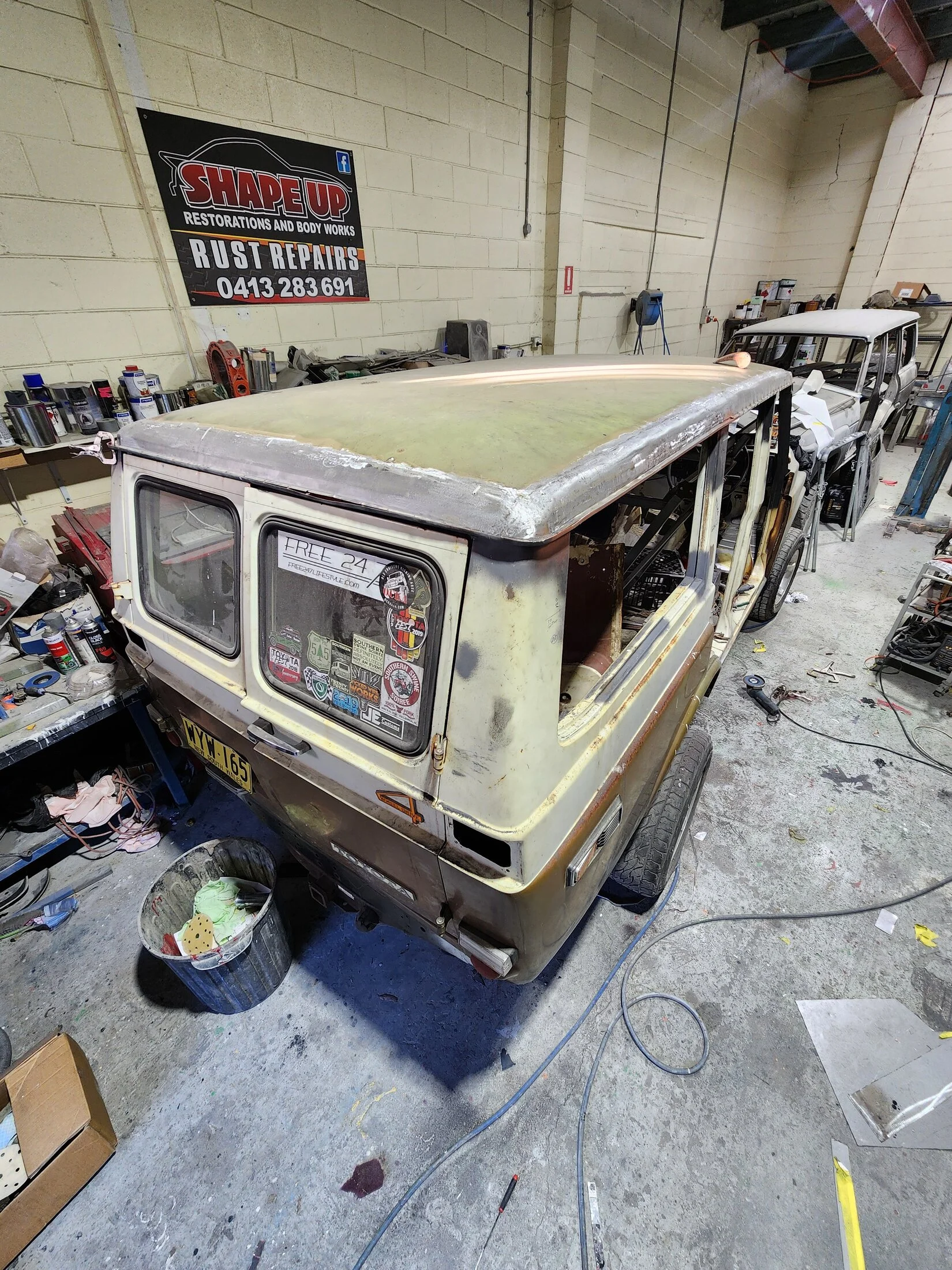

Should see some big changes with the seats back in to mock up the transmission tunnel & seating position.

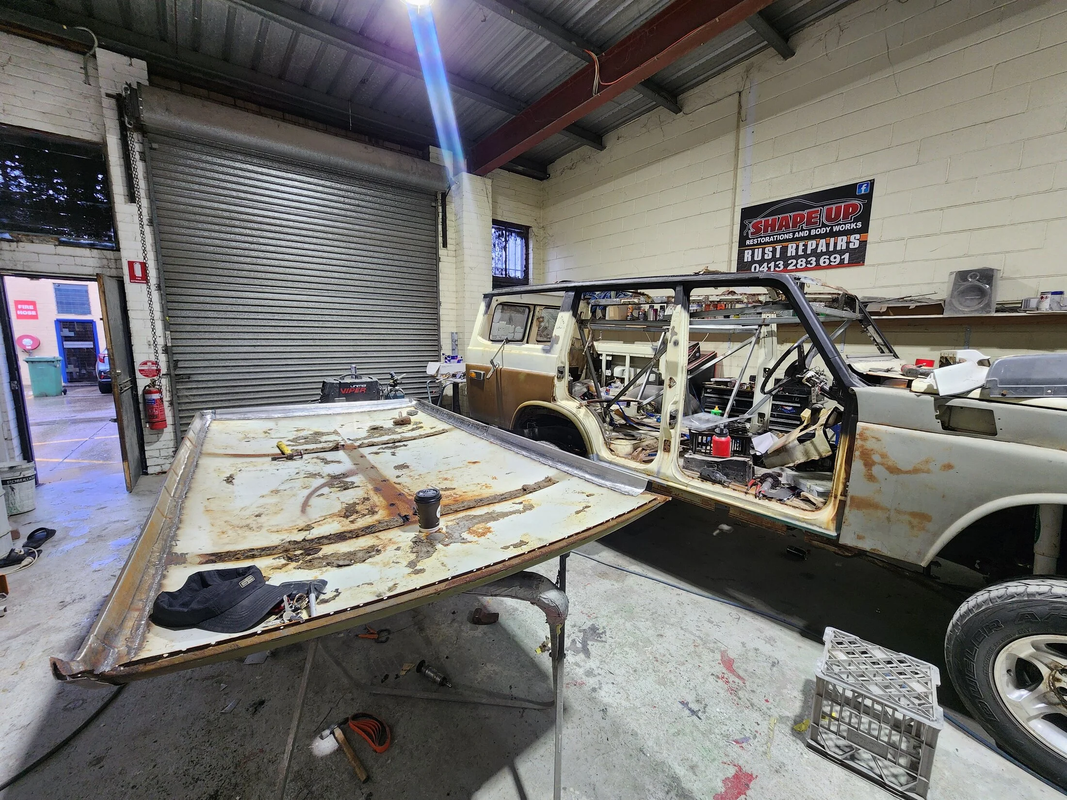

Edging closer. Into epoxy paint tomorrow then welded to the roof for the final time.
