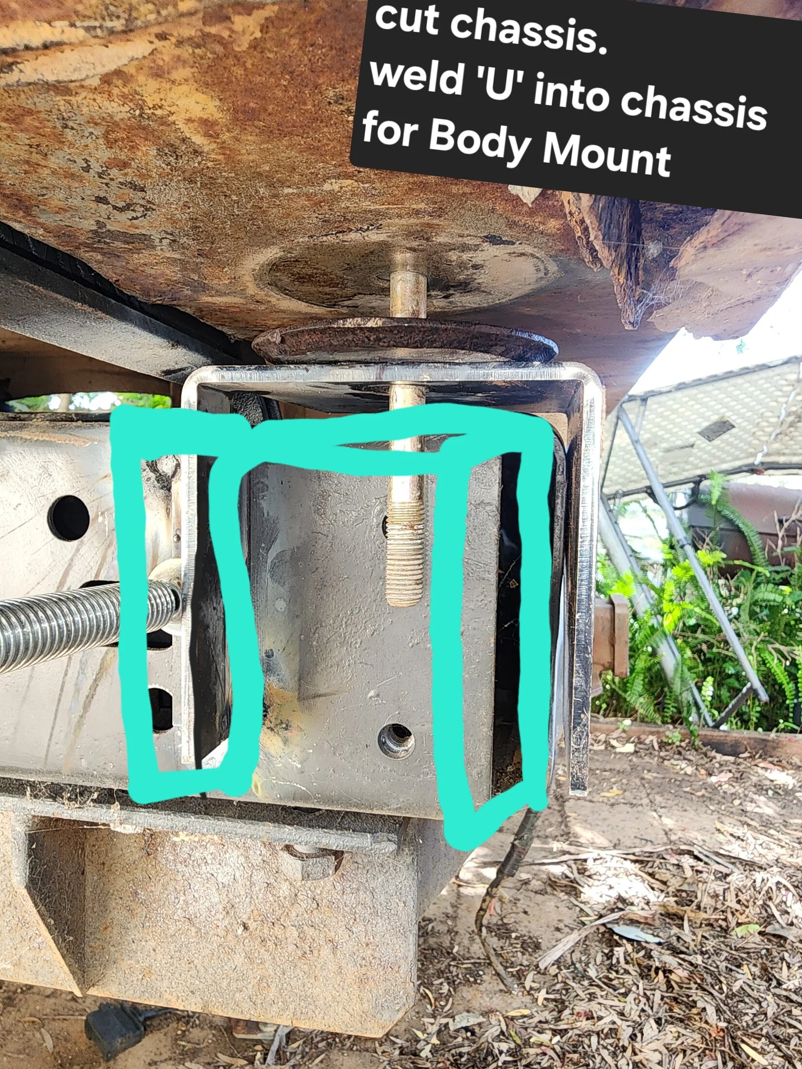

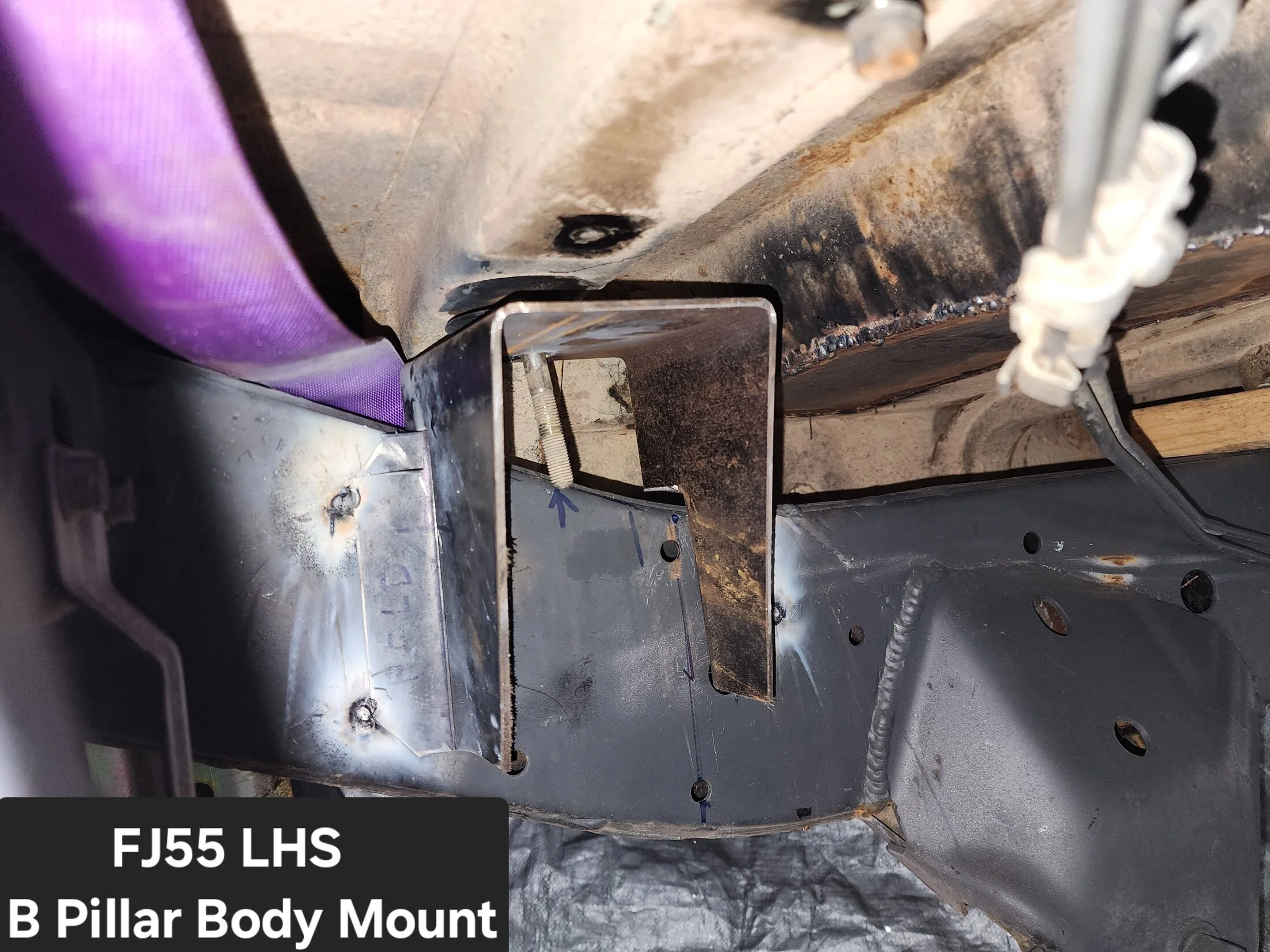

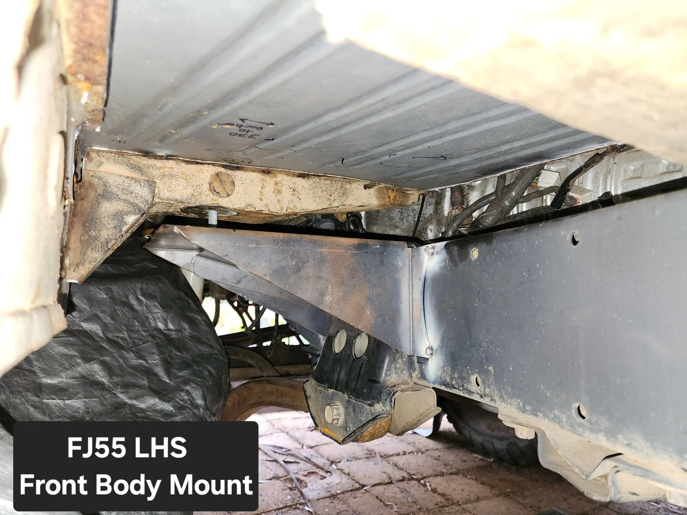

Body mounts have been laser cut, folded and tacked into place.
Trickiest mounts were over the radius arms & rear doors as the bolts run into the chassis. Rears will be redesigned after I get final heights once the body rubbers are installed.
Australian law requires an engineer to certify any welds to a chassis, which I should hopefully get signed off ready to burn in.
Pdfs for your files.
55/80 mounts.
The Engineener signed off on the chassis brackets. It's time to get cooking.
Rear chassis mounts will change as I'll need to cut into the chassis to make it fit.
