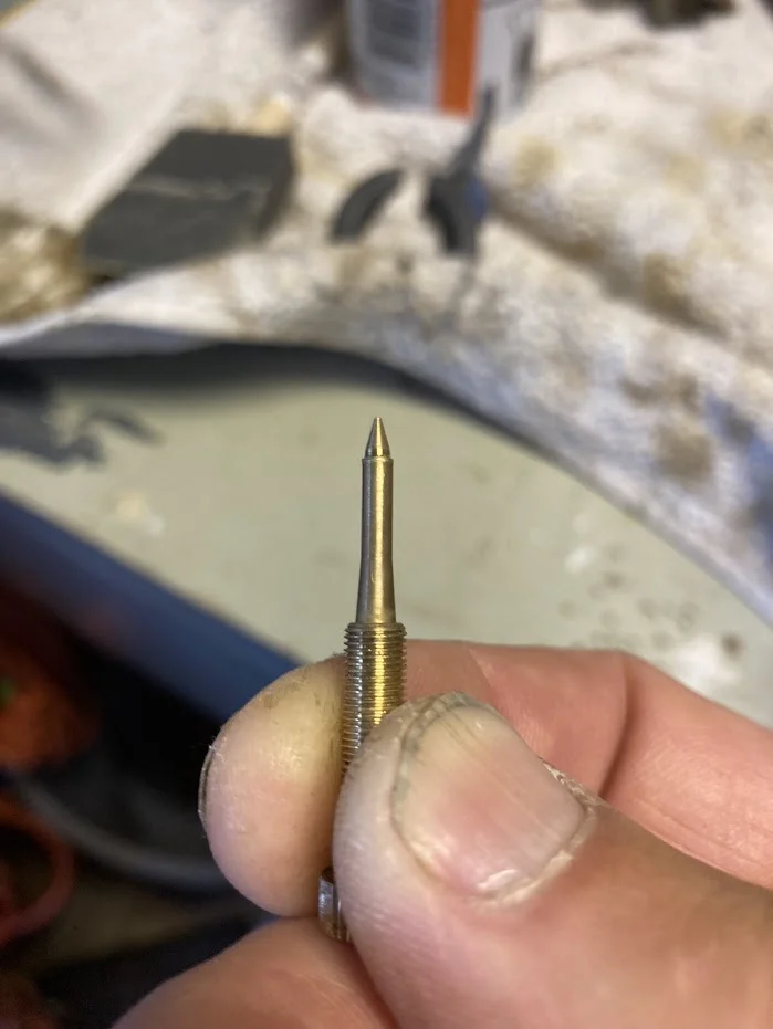

Incorrect - mixture screw is damaged. It has been hammered down too tight, way too many times. The tip needs to be a smooth, no step at all. If you're in a bind, chuck it in a drill or similar and shape the tip to a triangular point without step. There are a number of styles of mixture screws in rebuild kits and you have to ensure it actually seals up correctly when closed.

Hot damn I need to get my eyes checked, good find! I confirmed the numbers on the jets but not sure if anyone before me tampered with them.
I used the new ones in the kit only if they were the same numbers as the stock ones, I do remember the power jet? was off so I reused the original after cleaning it. I'm not sure I have the skills or the eyes to reshape this screw. Maybe there one in the rebuild kit, if not I'll p/u a new one.

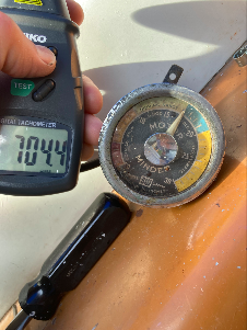

Just warmed it up got it to about 650 and pulling 15+hg. NO sign of vac leaks tho, spray bottle and also piece if card board over the carb kills the engine. At 650rpm I can still see fuel spewing in from the primary. is 15hg enough to pull fuel from the idle circuit?
15inHg means you are missing about 6-7inHg from a tight motor. 21.5-22 is a tight motor.
You’ve got leaks to fix first…start at manifold and work your way out.

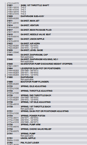

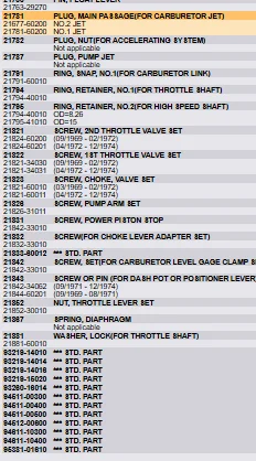

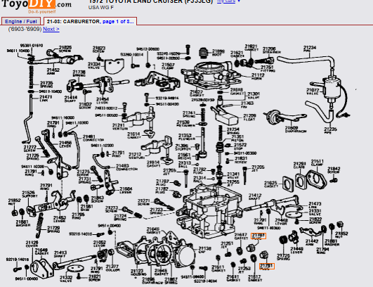

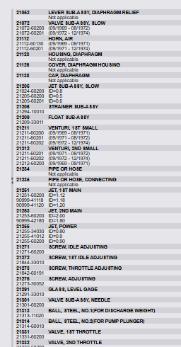

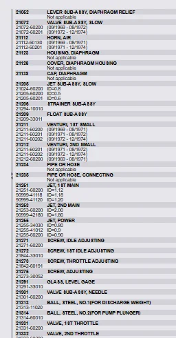

here is the nomenclature on a 1972 FJ55
@65swb45 / uncle Mark can better explain why some Land Cruisers came with a set / 2 / pair of additional JETS that were simply threaded into the back-side of each of the JET Service Plugs ?
any time i have seen this , there ALWAYS a different Spec. / orifice ID , but NOT all Land Cruisers have this little feature ?
When I rebuilt my carb, I found that mine did in fact have extra jets. Maybe for tuning at different altitudes?
