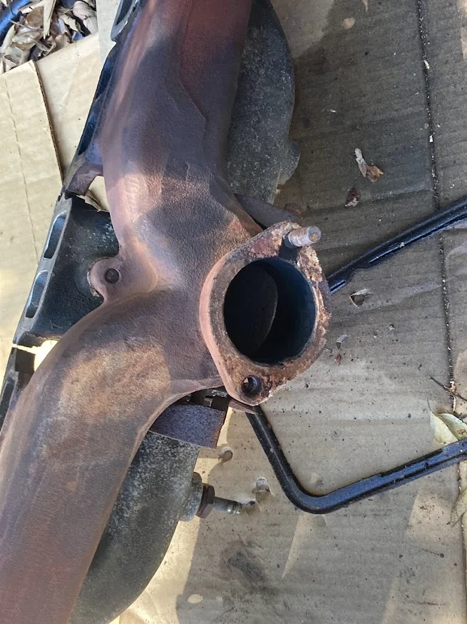

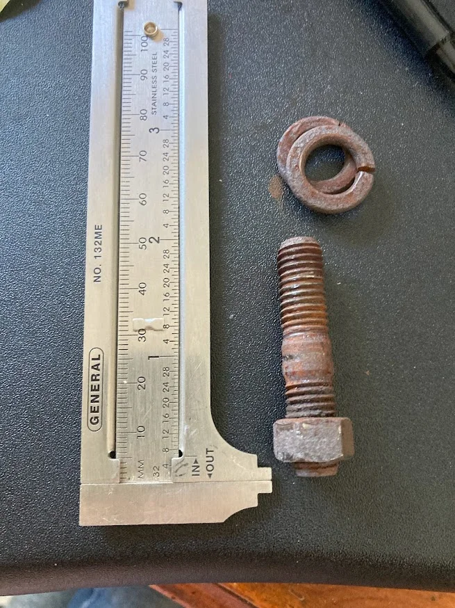

OK,. Back at it. I managed to remove the manifold to solve vac leaks and have a few questions. I am assuming the stud stuck on the manifold will come out w/ heat and slow removal via vice grips.

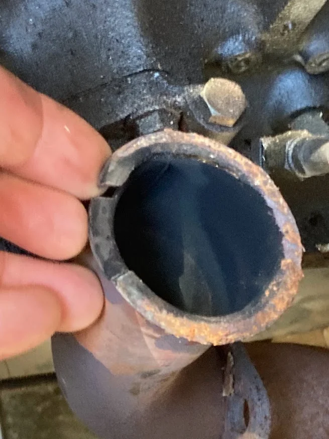

The lip of the exhaust pipe that attaches to the flange is cracked.(see pic) Best to remove and have that piece and have one made? or are these available ?
Also, for an OEM exhaust gasket. I know there are varrying opinions but thoughts on gasket seaker? install dry and torque to factory spec? looks like my heat sensor is stuck in the open position so sounds like I am good to just replace the gasket and reinstall same ....
Welcome to suggestions

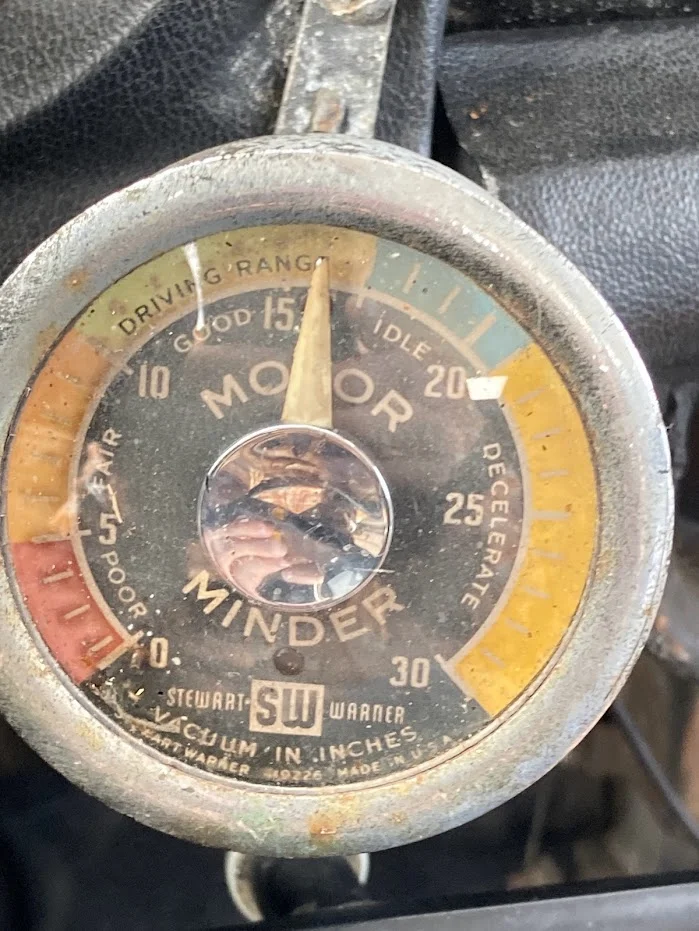

Solved that Fuel Pump issue with a new used FP. She starts and runs now but carb still giving me issues/headaches. Vacuum reads low (10). zero vac leaks that I can find. I took the carb apart and blew out the idle channel too which, didn't seem to solve the issue. fuel still coming from the primary, not the idle channel.
The carb only has a few hundred miles on it too. Sounds like its gotta come off again.
frustrating as F. :mad:
advanced the timing a bit more to get more vac, now its at 12. I unplugged a vac line and it does die. I can idle at about 840-900 rpms w/o choke but gas still from the primary.
no evidence of a vac leak. maybe a cracked intake manifold? i didn't see one when I had it off for the gasket repair.
Any ideas ????

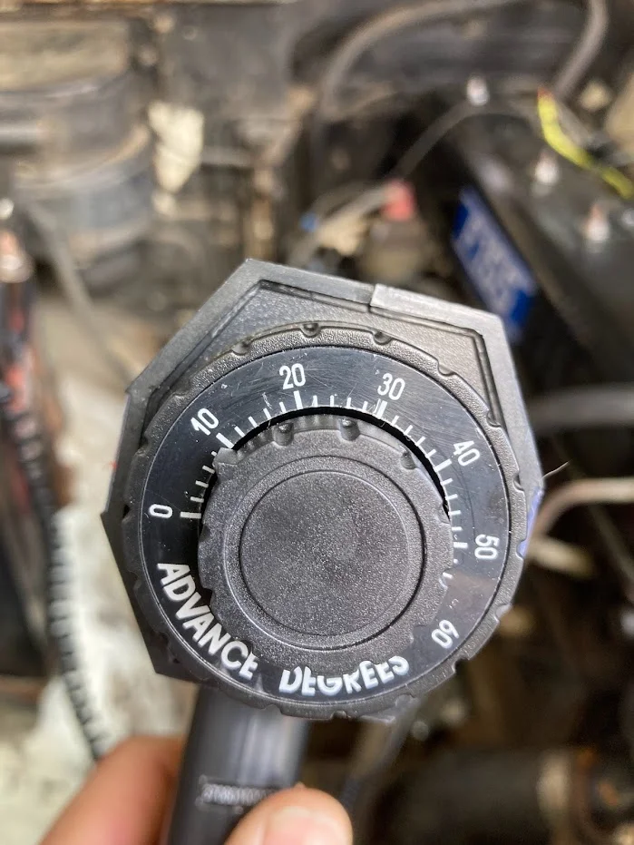

My base timing is 22*Btdc...
@Pighead what is that an indication of? I mean, why do you have to advance it so for? Maybe I should try that. Not familiar on how to use the timing light to measure how far advanced I am , have to read up on that. So did you keep advancing because of low vacuum or another reason?
I don't know why it works. For a long time before i got the fancy timing light, i timed by vacuum gauge. Advanced timing for best vacuum then backed off a bit if it pinged. I don't need to advance that far, it just runs better when i do.
My engine not quite stock.
Well that certainly worked to increase vacuum! Now its just above 15 but need to adjust idle down. More tomorrow. Hoping that's enough to get the idle channel to work 🤞.
Yup, advance timing and idle speed increases. Turn out idle speed screw to bring idle down. Repeat until it's where you want it.
ok, so I did that and got the idle to where i need it (700rpm ) w/ vacuum at 15. So happens that the primary is still delivering the fuel and not the idle channel. I did notice that I have a vacuum sound that wasn't happening before. The timing was actually retarded and when I thought I was too far advanced I was actually approaching 7 BTDC and ended up at about 9-10 BTDC. That said, does this mean that my issue is in fact a clogged idle channel? other than that seems to run better then it has since I bought it. :D
