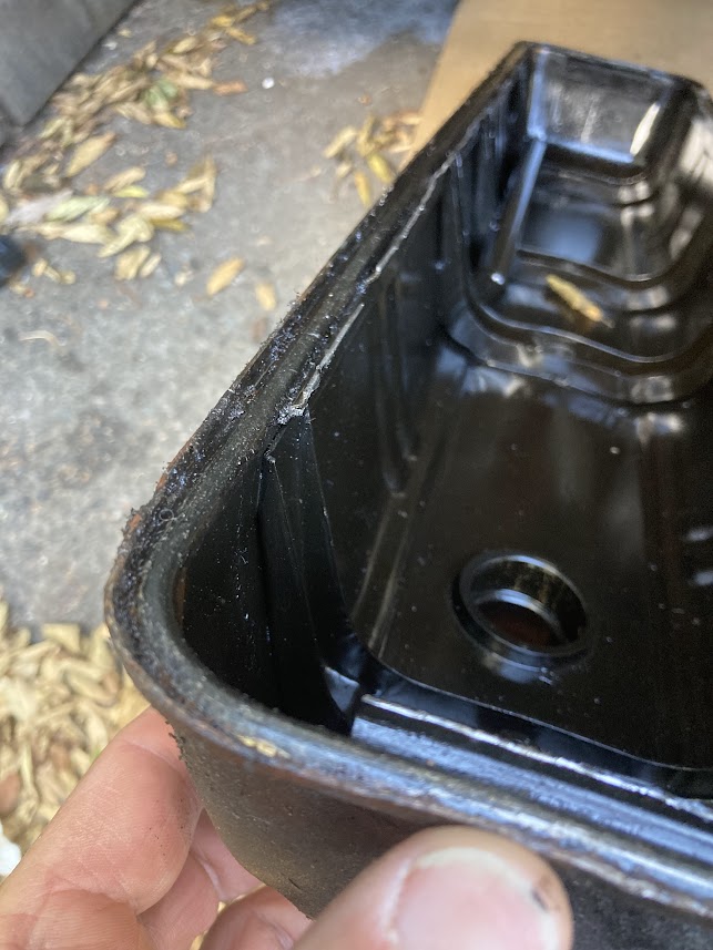

That indeed worked like magic. Now I need to figure out the best way to reinstall the VCG without any leaks.. Also, seemed the #1 lifter was making a small oil mess before I noticed. Put a rag there and was fine. Any best practices on the VCG?

show me cover style you have , the LIP under it / crimp area ...
this matters MOST !
this matters MOST !
u brake klean off the under goove well , clean ALL oil out
- use BLACK FIPG 00295-00103
TOP SIDE of CORK ONLY
- set with 4 NEW OEM TOP SEAL grommets
- Presto !
ZERO leaks , if the cylinder head surface is Dr. office sanitary of course
the fipg holds it from sliding around and sealeas top
- as u torque even down that Sheet metal will spread !
and move
i am Extremely HAPPY this is a cut and dry now issue Diagnosed topic , its a relief to see this , :)
because if it was prefect like my PERFECT NOS one , then ;;;
you would be very un happy to have to undo all your hard work ! is my point
this is a smoking gun ...🚨
-so now u know kid gloves baby steps to final dead end stop , that there is many years at the hand of a GORILLA !
well , you now know , and also know the pre-prescribed solution too
EXCELLENT Works here : :popcorn:

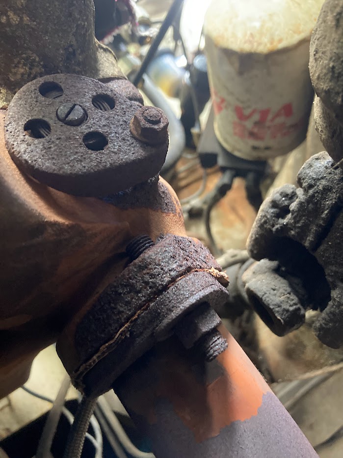

so I ordered a 1/2" 6 point 14mm socket to hopefully remove these exhaust flange bolts. Ive been spraying them with PB blaster for a few days. I was planning on using an impact gun to loosen them. I did see a video of someone very slowly walking the bolt out w/ a breaker bar. What are your thought on this? goal is to remove the bolts w/o breaking them off and have a bigger project on my hands. I'll heat up the flange before using the socket/impact or breaker bar/ big 1/2 inch rachet

the IMPACT Gun or Breaker Bar approach is NOT the way here ............no way jose !
- u WILL snap off both , and feel bad when it occurs ....:confused:
- only OXY-HEAT applied , fast , precise , and with a removal method all mapped out in-advance is key here WILL work well ....
- below is a TECH-VIDEO of me removing Rear Axle Carrier assy/ Differential Studs , i use pre-set vice-grips very very successfully ,
- all u need to do for the moment is remove each hex nut , which BTW look larger then 14mm JIS HEX TOOL size-spec . ?
- DRY-FIT each one with a 14mm Black 3/8" drive DEEP impact socket if u can ? the 1/2" drive impact is WAY too heavy duty here ?
- do u have a 3/8" battery impact or air tools 3/8" impact by chance ?
- remember , the NUT is the enemy needing OFF now , NOT the whole STUD , that can wait till later , NO way to heat it all the way through , so DO NOT try ...
- focus on the whole CHERRY RED factor i make a point of here below , it WILL be your ONLY focus , on the HEX nut itself there above , do not focus on the male studs ,
- Rapid Expansion of HEX nut is what we want , let the stud stay as cool as possible ,,
- you follow me on this so far here ?
