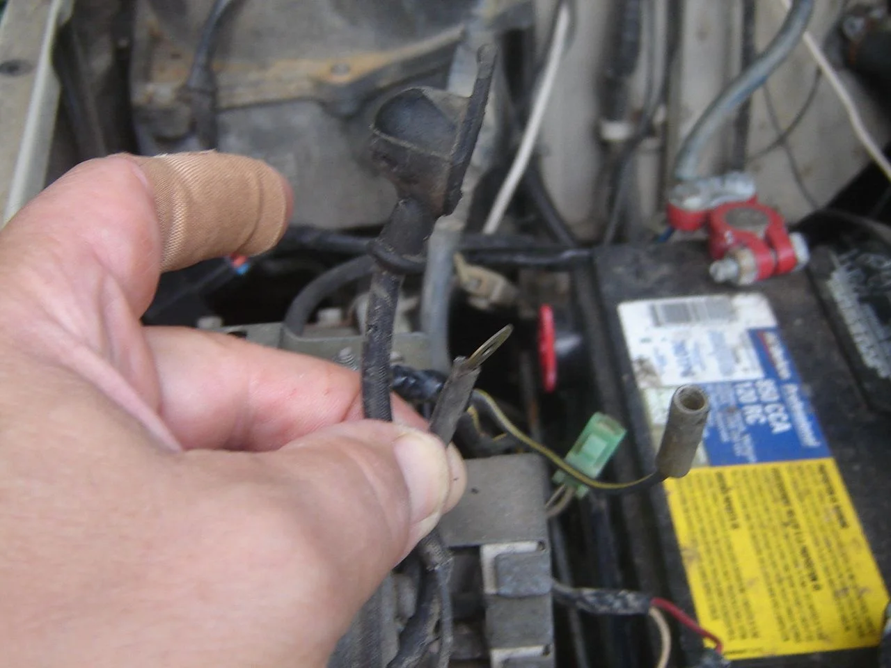

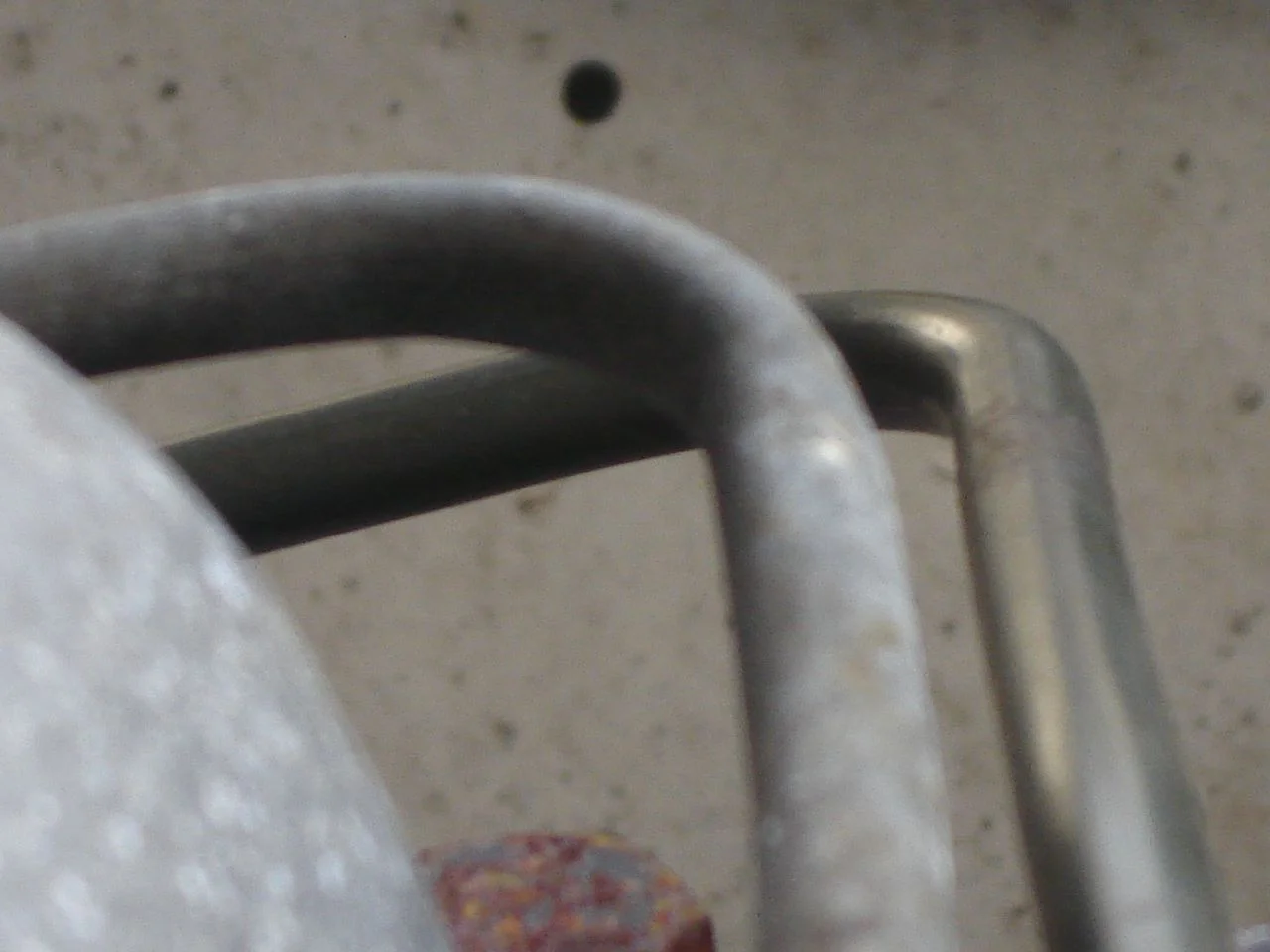

So today I opened the hood to start planning my next step to trying to solve this hot start problem. I was going to try to wrap the fuel lines with some rubber hose or maybe try to cobble up some sort of heat shield. I started tracing the fuel lines to decide how to proceed and their routing seemed somewhat odd. Both lines run very close to both the engine block and the top radiator hose. The alternator is new to the vehicle so I was wondering if maybe the person who installed the new alternator inadvertently rerouted the lines incorrectly? Also both lines looked slightly crimped in the bend around the valve cover en route to the carburetor. As far as the mention of possible coil issues, I noticed a few dangling wires and was wondering if someone could guide me as to what is going on with these

Someone say kinked fuel lines? Here’s mine. 77 with a 76 carb routed with a return line and I don’t have any heat related issues, although I occasionally have to turn a hot motor a few seconds longer to get it to fire. I usually don’t touch the pedal on hot starts. Headers & FJ60 big cap dizzy but otherwise stockish.

I too have a 76 FJ40 and experienced the same issues. My remedy was wiring a direct line push button start switch to the starter (GR starter). For some reason I wasn’t getting enough amps to the starter when it was hot and didn’t want to chase wires. Test me fix out by turning your ignition switch to on and then cross over the starter terminal to ground and see if it starts. If it does, it’s a cheap and quick fix.
