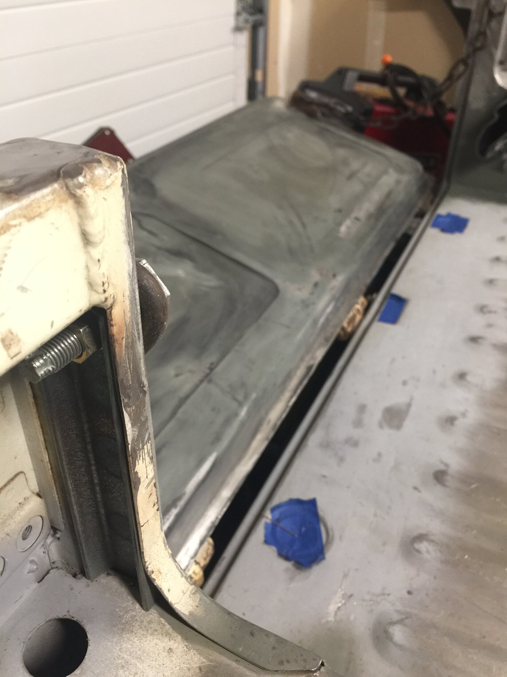

Need some advice.....what's the cleanest best way to make an old drop down tail gate fit my 1980 Fj-40? I have one I bought many years ago and would like to install it on my body off restore since I'll have the top off most of the time. Seems to be a little narrow (no overlap) and I assume I'll have to round out the bottom corners to fit right and move the LP mount from left to right. Want a clean look ! Thanks

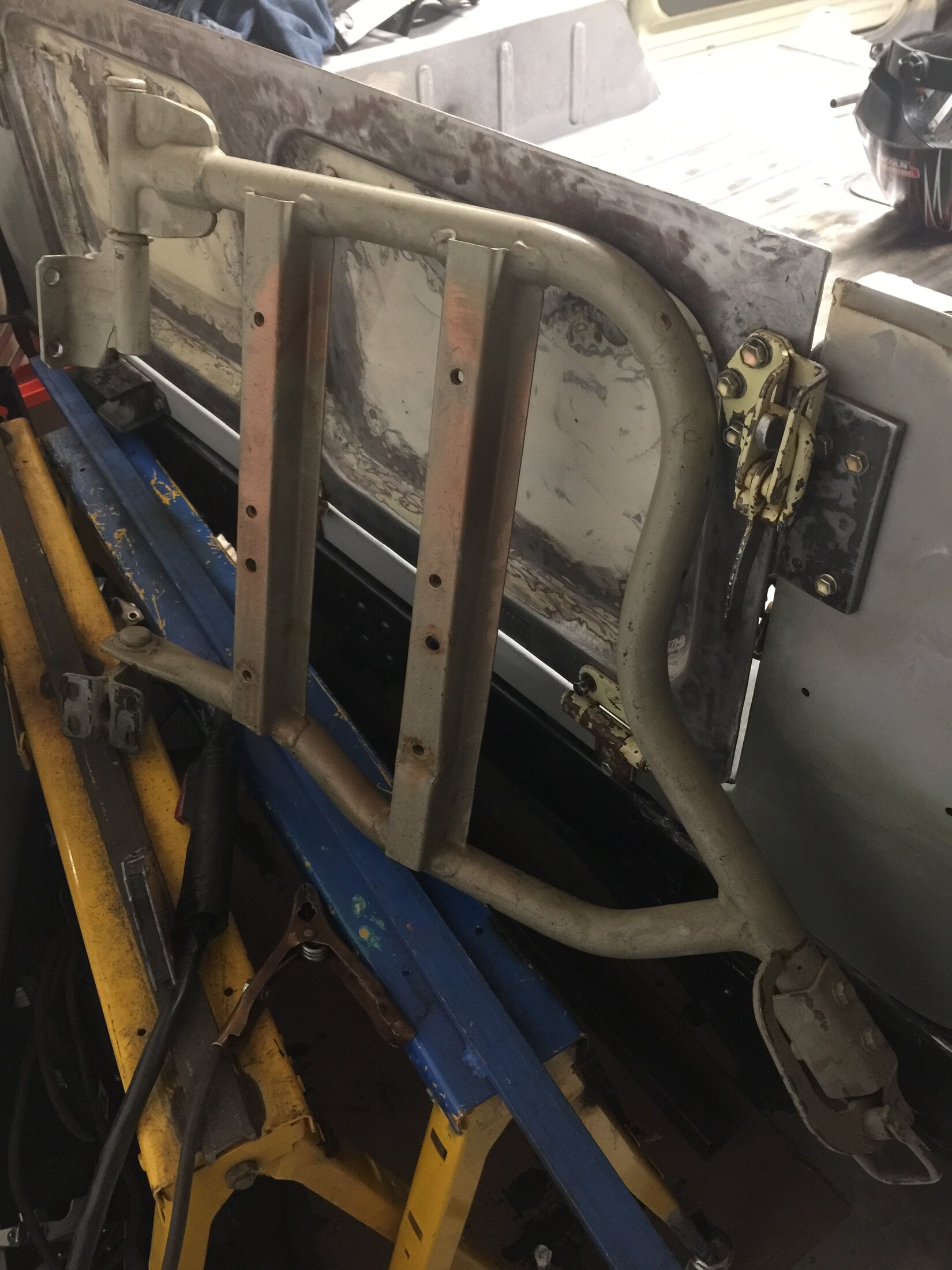

I'd be sure to make it functional. If you're doing major work to the tub nows the time to do it. I'd use nutserts or captured nuts for the hinges. I've been using a plate across the back forever and tierd of it.
There will be a working tailgate soon. I'll be altering the amby doors for the top.

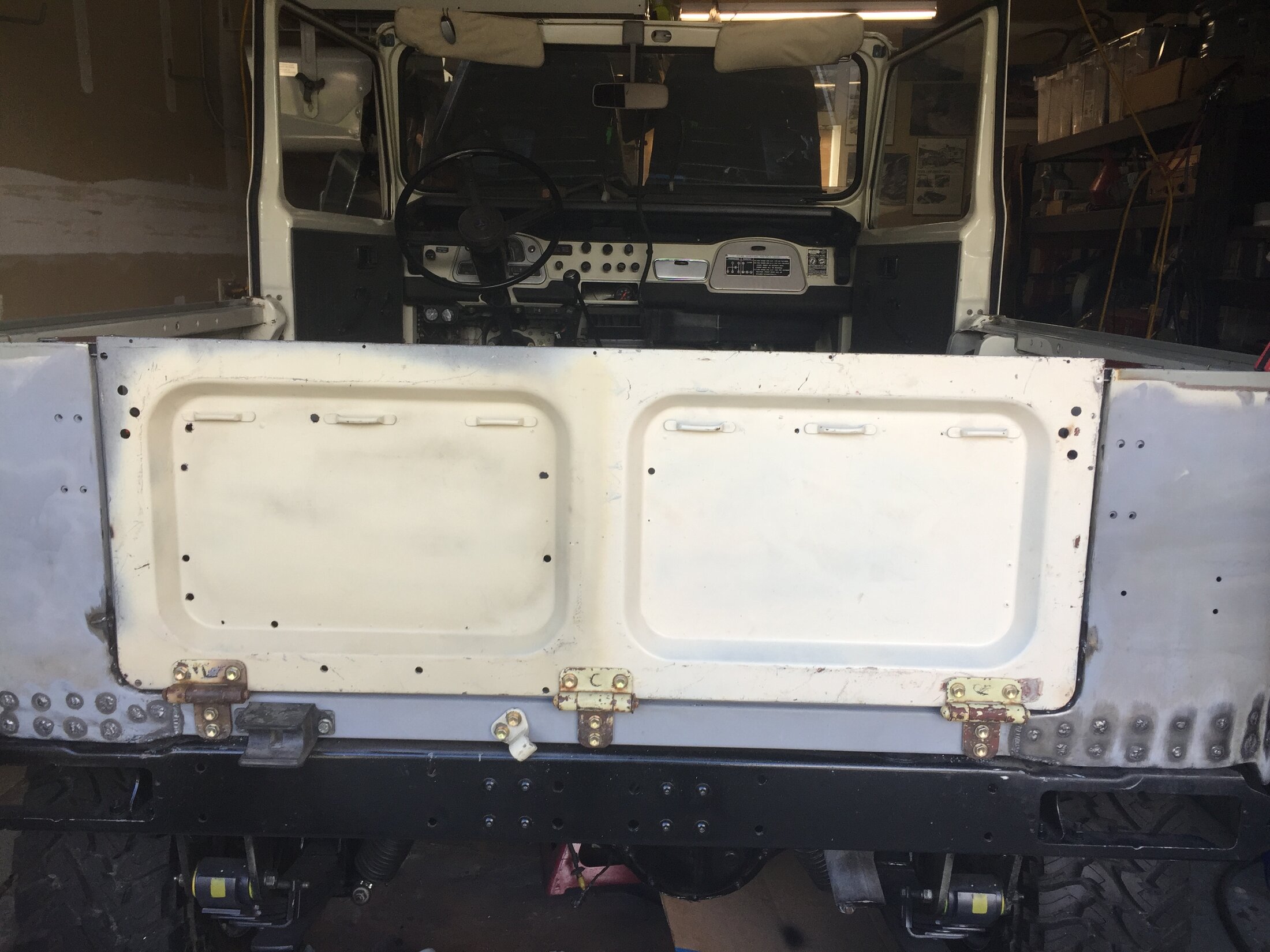

I have the tub off and new rear sill as well as qtr panels from CC. Tub is about to be epoxy primed etc.... tailgate has basically zero rust though and about to strip it down and dry fit it for holes and alignment. I guess the first thing is to round the corners and fit it inside where the ambulance doors go. Wondering if I need to stiffen the chain mounting point on the tub to make it solid.

Those six holes in the hinges. How are you going to drill and locate? Will you be using sheet metal screws, or bolts into an adjustable bolt plate. It looks like taper headed screws at one side, and bolts washers on the inside.
I added a tailgate to my 79. I used nutserts/rivnuts for the hinges and the existing ambulance door mounting locations for the catches. The hinges I pounded flat so the tailgate sits flush. You will also need to add the Chain mounting location for the tub. BTB sells these.
