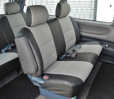

Middle row seat out of a Toyota Previa fits like a glove between the wheel wells. It is made to be removable in the mini van, so be sure to get the floor mounts for it when you are at the scrappers.

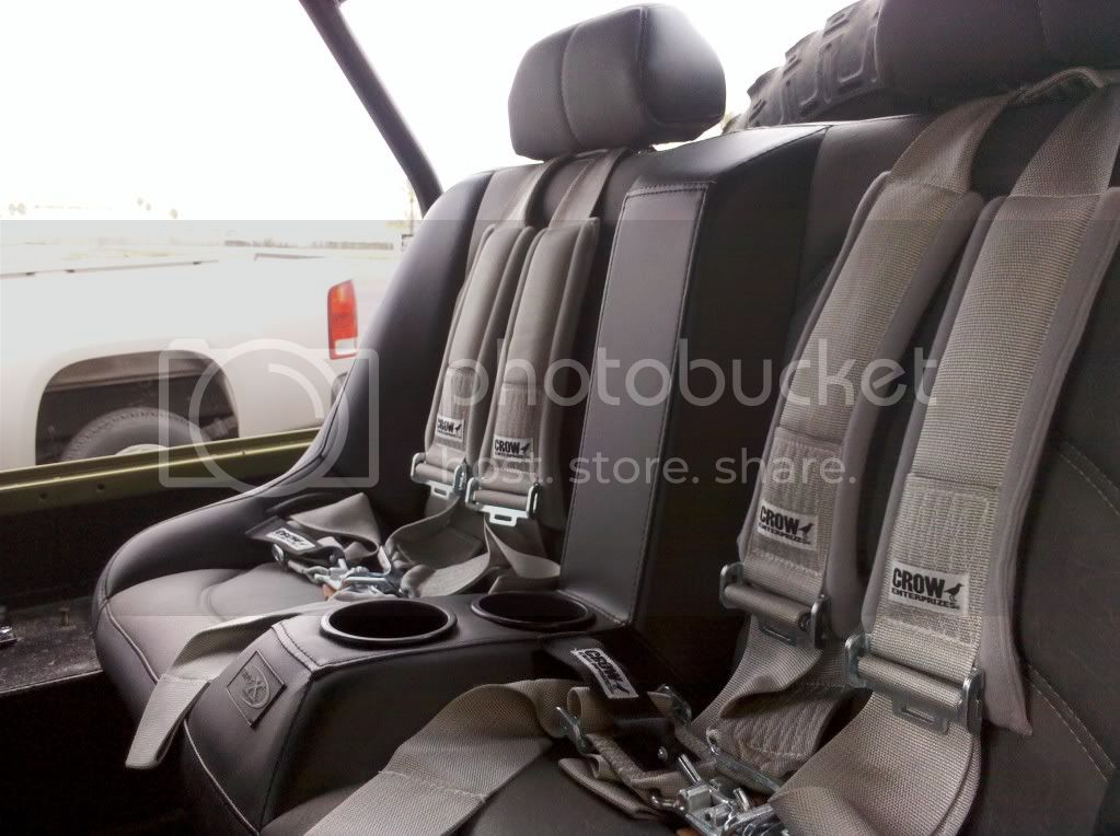

I went this route and the seats are actually pretty reasonable. Triple X seats in phoenix. they will build them to any width you like. my kids fit perfect!
Does anyone know how this seat was mounted? Between the wheel wells or resting on top somehow?
MAD40er: Do you have any pictures of the Previa seat installed in your FJ40? If so, please post because it seems like a good option. What did you pay for the used seat? Thanks!
