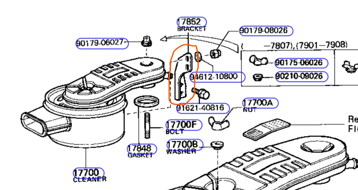

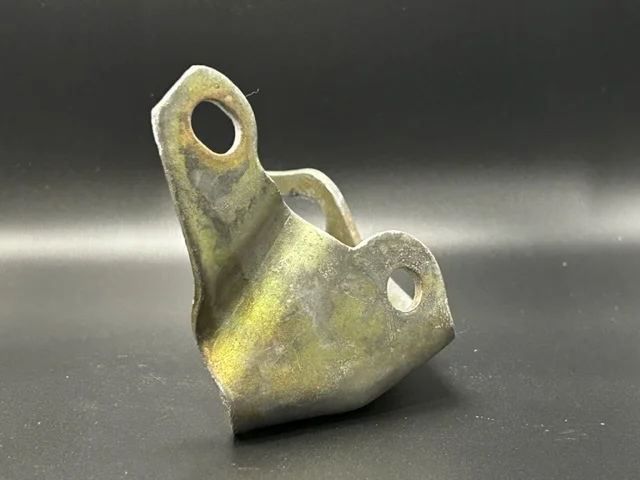

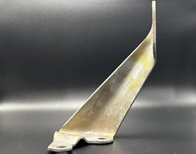

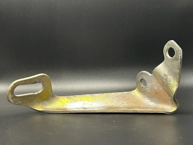

For those looking to simplify or streamline their engine bay by installing a Non USA Air Cleaner Assembly from an 8/80 + FJ40 17700-61081 (8/80 - 10/82 Paper Element).

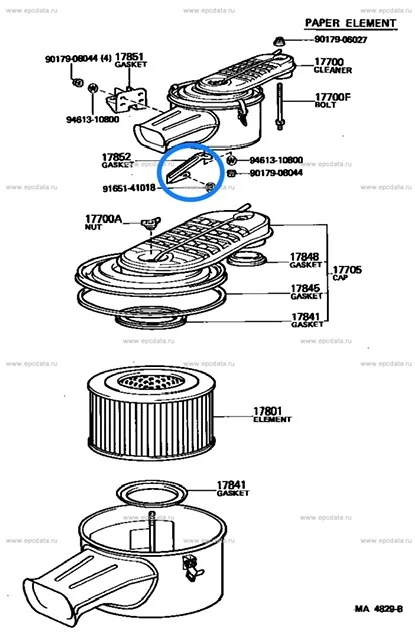

There are two brackets:
The primary support 17851-61020
The lower support No. 2 17852-61020

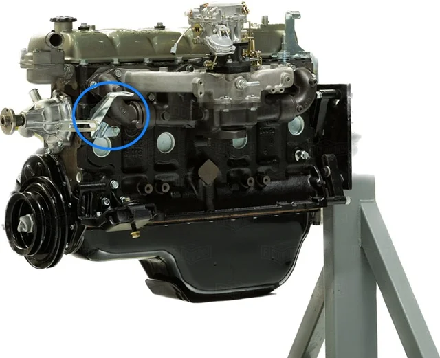

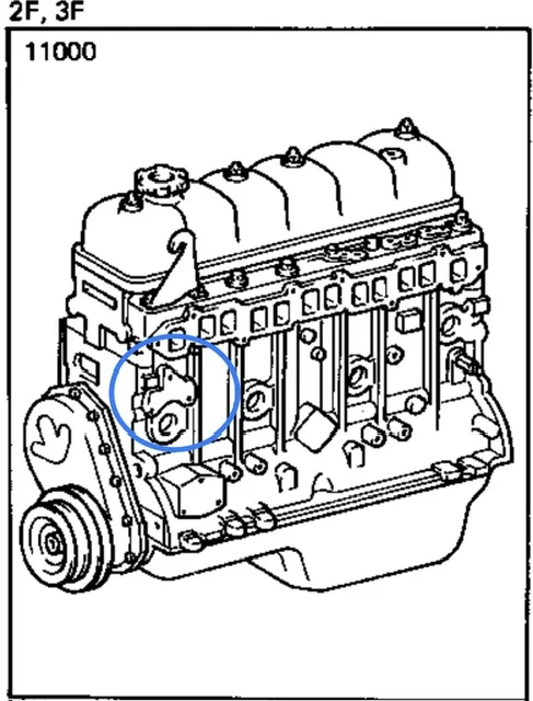

The lower bracket attaches to the bottom of the air cleaner assembly and to the engine block. Only engine blocks after 8/80 (11411-61013) will have the necessary mounting bolt holes as shown.

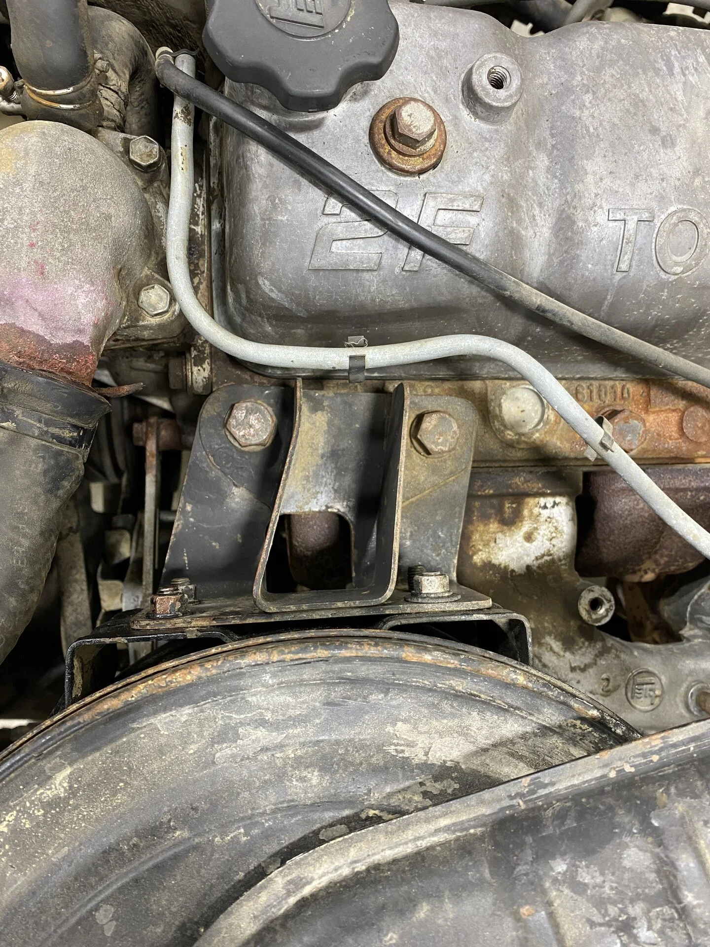

My Saudi spec 1983 FJ45 has factory PS and that style air cleaner. I will attach some photos of the mounting brackets later when I go down to my shop.

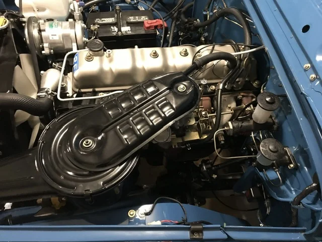

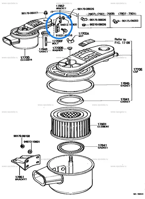

Good you posted this because I've been scouring for a similar bracket, but for 75-80 cyclonic in ROW markets.
17852-61010
That other bracket 17852-61010 shows applicability for 7/79 -7/80 for air cleaner assembly 17700-61080.
1/75 - 4/78 does not show a bracket for air cleaner assembly 17700-61010…
When you find the bracket, please post it... Curious to see where it mounts.
Now I have to buy a new 2F motor to mount my bracket to. 😂 …

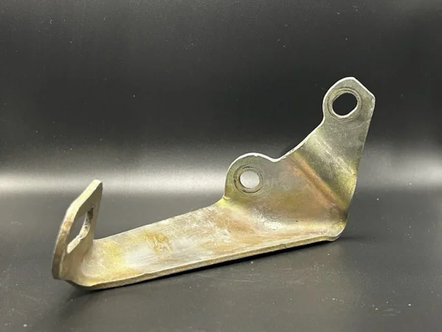

There were a few changes to the round air cleaners over the years. Bracket 17852-61010 (7/79-7/80) was used for extra air cleaner support and attaches to a bracketed stud on the rear side of some of the the air cleaner cans, and then to two tapped holes on the outside of the intake manifold. Of course the air cleaner that originally came with the engine may have been substituted over the years.
