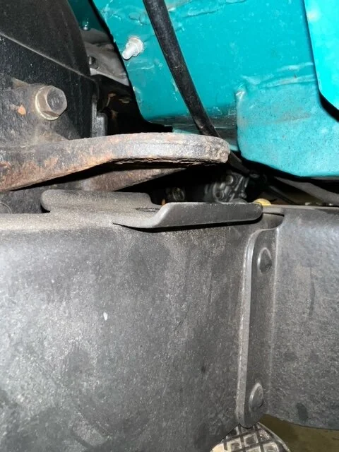

any help for my mechanic - wondering but went / should now go here:

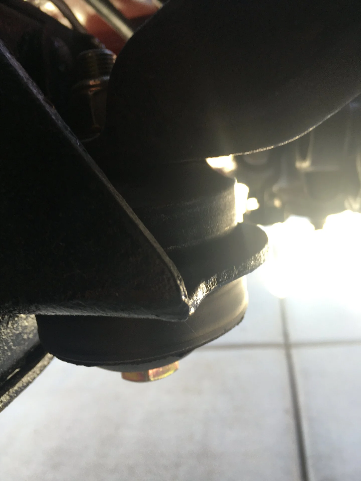

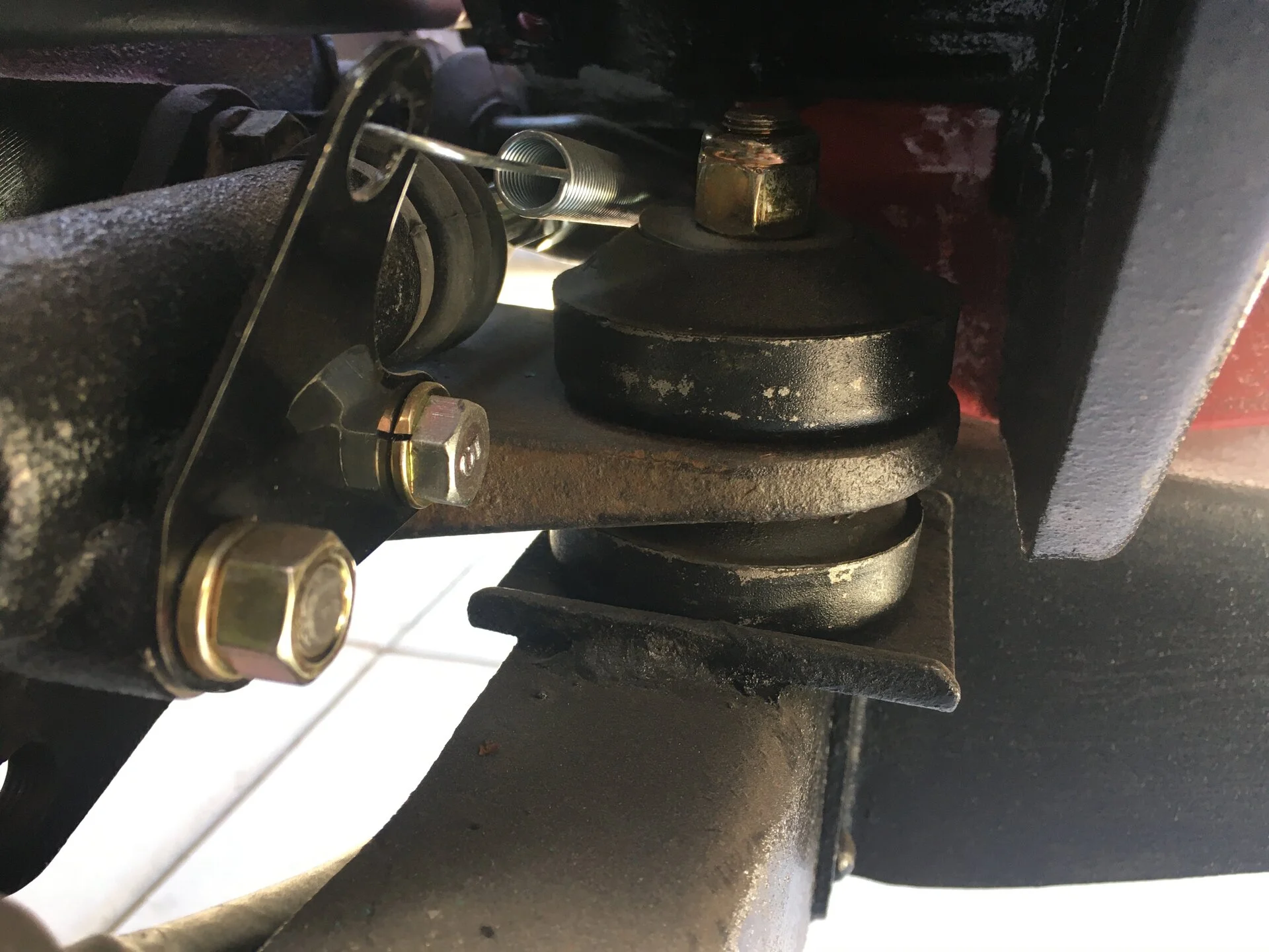

thx, any reason a builder would take them during a 2F mosely swap?They stack like this
View attachment 3498772View attachment 3498773
Cruiser outfitters has these as well, and they can help with tech questions.
My guess is they were going to replace them with new, and just forgot. Buy some new & s/b an easy install. May need to jack up the motor a bit…but no big deal.thx, any reason a builder would take them during a 2F mosely swap?

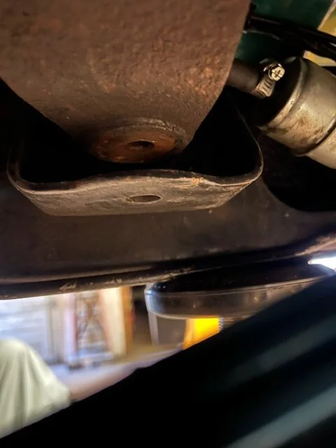

Question….did you drive it like that? What was holding up the transmission/transfer case?any help for my mechanic - wondering but went / should now go here:
View attachment 3498709View attachment 3498708
for 3 years. my mechanic (old) installed the mosely 2f mated with the hz55 5spd trans.Question….did you drive it like that? What was holding up the transmission/transfer case?
Doesn’t seem like it based on the driveline hanging above frame and not resting on it so it would be nice just to see how the trans is hung.^ ah, missed that 5-spd, that explains the gap. So the OP @TuckerHudson doesn’t need or should even use the rear mounts?
OkYou have to show us your configuration for trans mounting, we can’t guess and tell you. Factory would be pucks in the aforementioned location which is no longer applicable.
