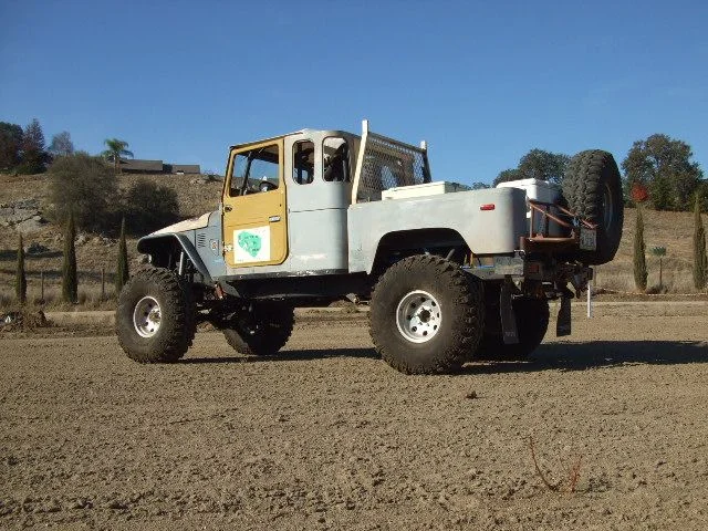

Laying out the Cargo area for camping gear, trail spares and tool boxes and camping gear.
Apparently, I'll pack light ;)
(looks 800% better with the doors amigo :) )
The boxes are empty. I have enough stuff to fill one of the orange containers and one and 1/2 of the square containers.
The rest is for your gear.
I have to do the mock-up packing so I can start on the roof/bed rack. Im hoping to get my RTT mounted low enough so you can still use the rear view mirror.
I love my wife dearly but she asked "does it get cold enough in Alaska that you do not need a cooler?".
:doh:

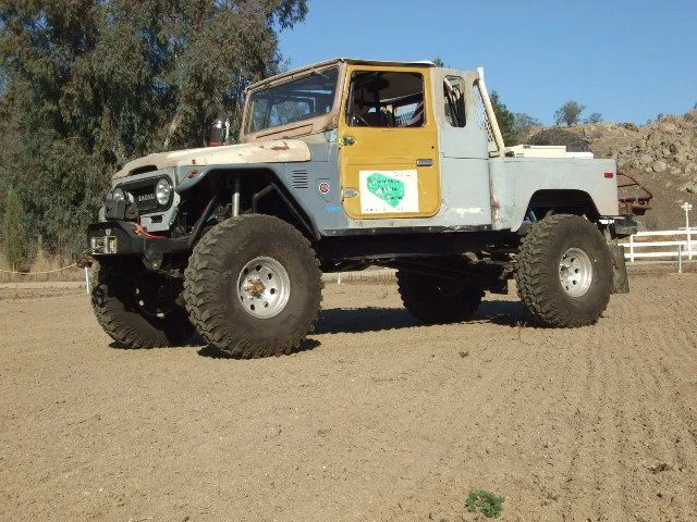

Pure Poser Shots
The roof rack doesn't look bad in person or with 10,000 acres in the background.
LOL
what are doors?
are them those things i put on during the winter?
The doors keep out the Alaskan mosqueeeetos and the river water :hillbilly:
it rains in my truck with doors and a top from gaps in the doors, not sure how much water mine would keep out. lol.
i dont know anything bout them alaskan skeeters but the little (huge) horse flys we get in areas down here will eat you alive!
and we need more progress on this, dont be lazy!!

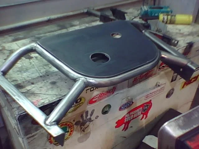

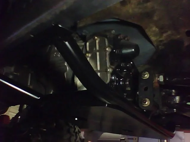

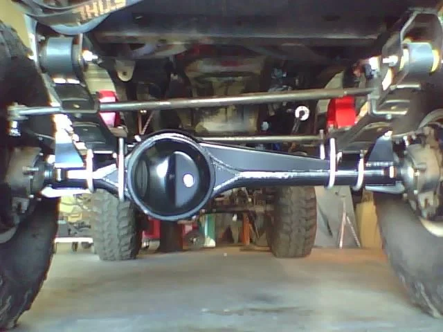

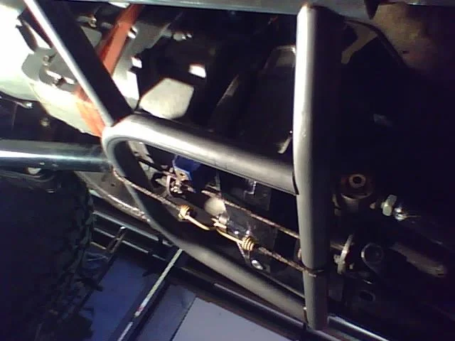

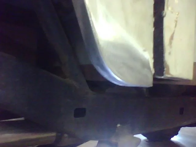

A few pics of the shock towers.
With the added springs to handle the added weight, my 14" Bilsteins were limiting my travel. These towers split the shock travel and allow for 7" up and 7" down.
Those are Marlin Crawler Gussets.
The steering stops are welded top and bottom so they do not collaps.
