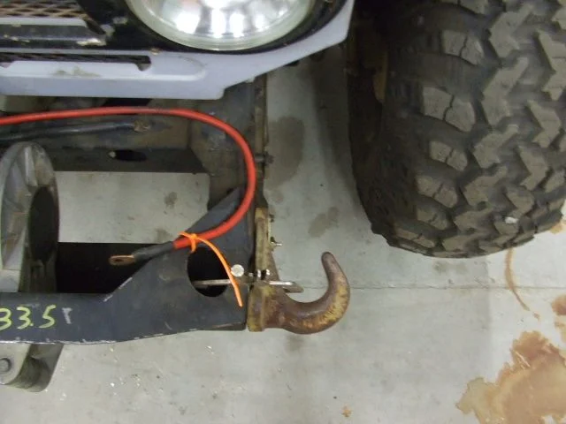

Do I need 4 of them?
4 will let the engine breath real easy, and at ebay prices not break the bank. New the cores are $212US each. 4 will be good for up to 600hp :D

4 have been ordered and should be on their way

They're out of the way as far as approach angle, and would mount direct to the frame. Seems like a good choice to me.
I was thinking they might have come off of a train :D
