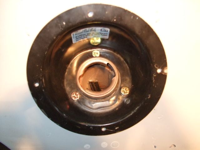

Fuel fill neck stand pipe is next. I started on the front tank since it is the primary tank.
Mockup was done with PVC pipe. I cut holes in the bed floor for the fill pipes. I used 2" pipe for the down pipes.
The Burp pipe installed.
In the bottom picture you can see it installed deep enough that you can still fit the diesel filler hose at the fuel station in the fuel fill pipe.
It is really hard to see but it is angle cut and bent in such a way that fuel will not flow into it while fueling.
