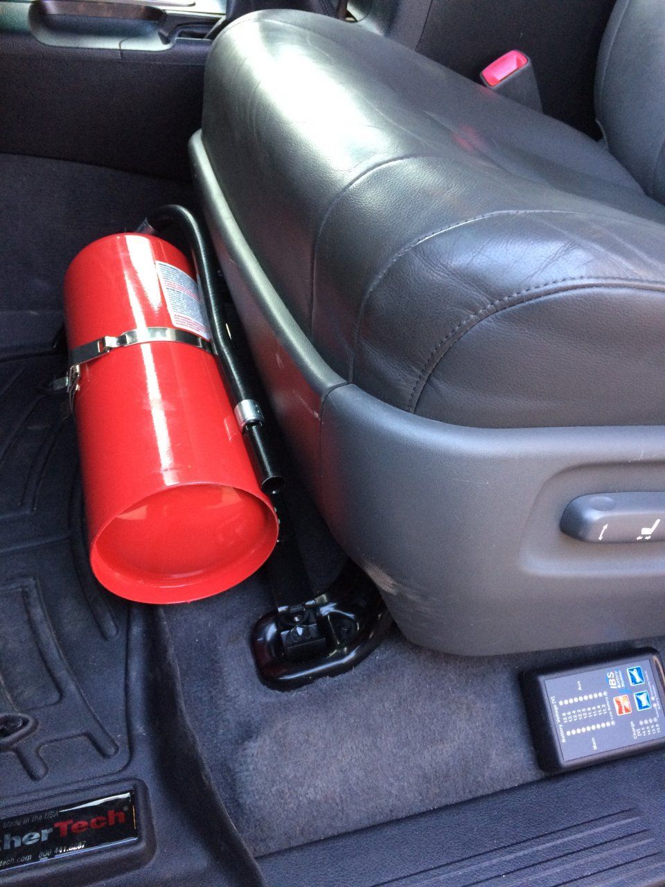

Thought I'd post another "Wheelchair Mod..." -This one for quick access to an extinguisher:
If you have short & tall drivers...this might restrict how far forward you can slide your seat (though you can take the extinguisher off if you absolutely MUST slide it way forward. It uses the mounts that come with various extinguishers, so if this larger one I have mounted is too big, you can always mount a thinner or shorter one. So far, I'm pretty happy with this setup. Heck, if you had a fire after a bad collision, you might even be able to flip the rubber hose upward and flood a cab fire without even removing it from the base...
Made by these guys:

The reason I mounted it on the driver's side is because, due to the unusual sliding mechanism on 200 seats, the unit does not move with the seat. So this limits how far forward the seat can go.
Since I am nearly always the driver, I didn't want to limit the forward movement of the passenger seat, since it gets pushed forward to fit big cargo sometimes.

Did this bracket fit without drilling, bending, cutting or otherwise modifying the bracket and/or vehicle?
Yes. It fits without any modification.
All you do it remove the bolts at the seat base...add this bracket...then replace the bolts.
You do end up leaving the plastic cover off of the seat base where the bolts are, but I have never once given this any thought post-install. Visually, it is insignificant next to a fire extinguisher and Weathertechs. I suppose if you REALLY wanted the little plastic cover on there, you could modify it, but I frankly didn't care.

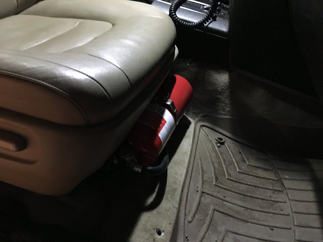

Love the idea, and this isn't unique to this mount but how secure would those extinguishers be in a collision? Does anyone make a vehicle-rated release clamp? The ones posted look like a home grade clamp used for mounting to a wall.
This is a legitimate concern, and why I mounted mine using H3R hardware which is NHRA Accepted and designed to Mil-Spec 810G and tested to withstand 27G in all directions.
Universal Fire Extinguisher Seat Mounts | H3R Performance
Extreme Duty Quick Release Brackets | H3R Performance
Here's what mine looks like mounted:
And after pulling the "Pull To Release" flag:
With the extinguisher released, the seat can be moved all the way forward without any obstruction from the mount.
The mount allows the reinstallation of the seat rail front covers which makes for a neater looking install than some other brackets.
Simply rotate the mount upwrads a little - easy with the Nylok nuts which maintain an even tension - and the floor mats are easily removed for cleaning.
I've run this setup for several months now and have had no problems with use or interference with my feet.
