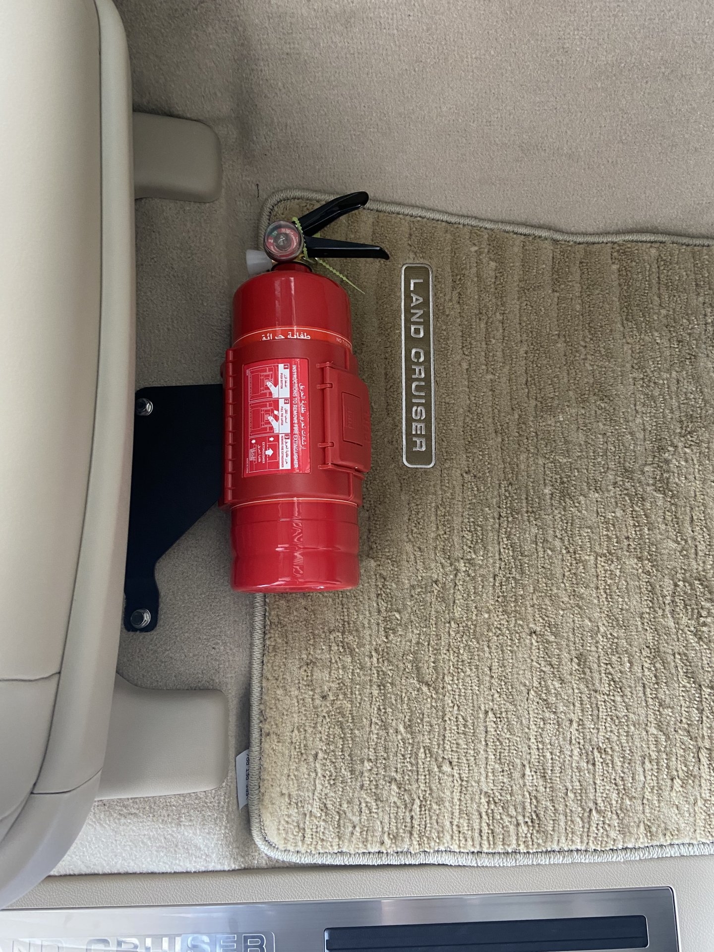

Hey Charlie. I have the H3R base but am using the standard clamp that comes with the smaller extinguisher (not the quick release version that others have with the red “pull here” tab). This standard clamp mounts to the base that the quick release mount connects to. There are lots of options to put bolts on the base so decent chance yours will work. I have the H3R 1.4lb Hal Guard. I don’t think they make the quick release mount for this smaller extinguisher, but I know they make it for the 2.5lb Hal Guard. Attached is the picture in my 2018 LC. I must say the base was super easy to install and I like the idea of having Hal guard up front since it doesn’t leave a residue when used. Hope that helps.

So there are apparently two different fire extinguisher mounting options. Neither available for purchase. Both mount to the floor with what look like self tapping bolts.
On the floor directly in front of the passenger seat, part#: febra-lc200-17
Along the transmission hump up in the passenger side footwell, part#: febra-lc2vx-18 (see attached pictures). This version is used on the LX570 as well.
The Toyota parts center here in Abu Dhabi told me the parts aren't for sale individually, it would seem to be a dealer add on. They've put in a request for me to find out how I can get them, but I'm not holding my breath.
I'm going to head to the massive junkyard in Sharjah next weekend to see if I can acquire some of these mounts. Maybe I'll bring them back to the states and attempt to have a metal shop reverse engineer them.
