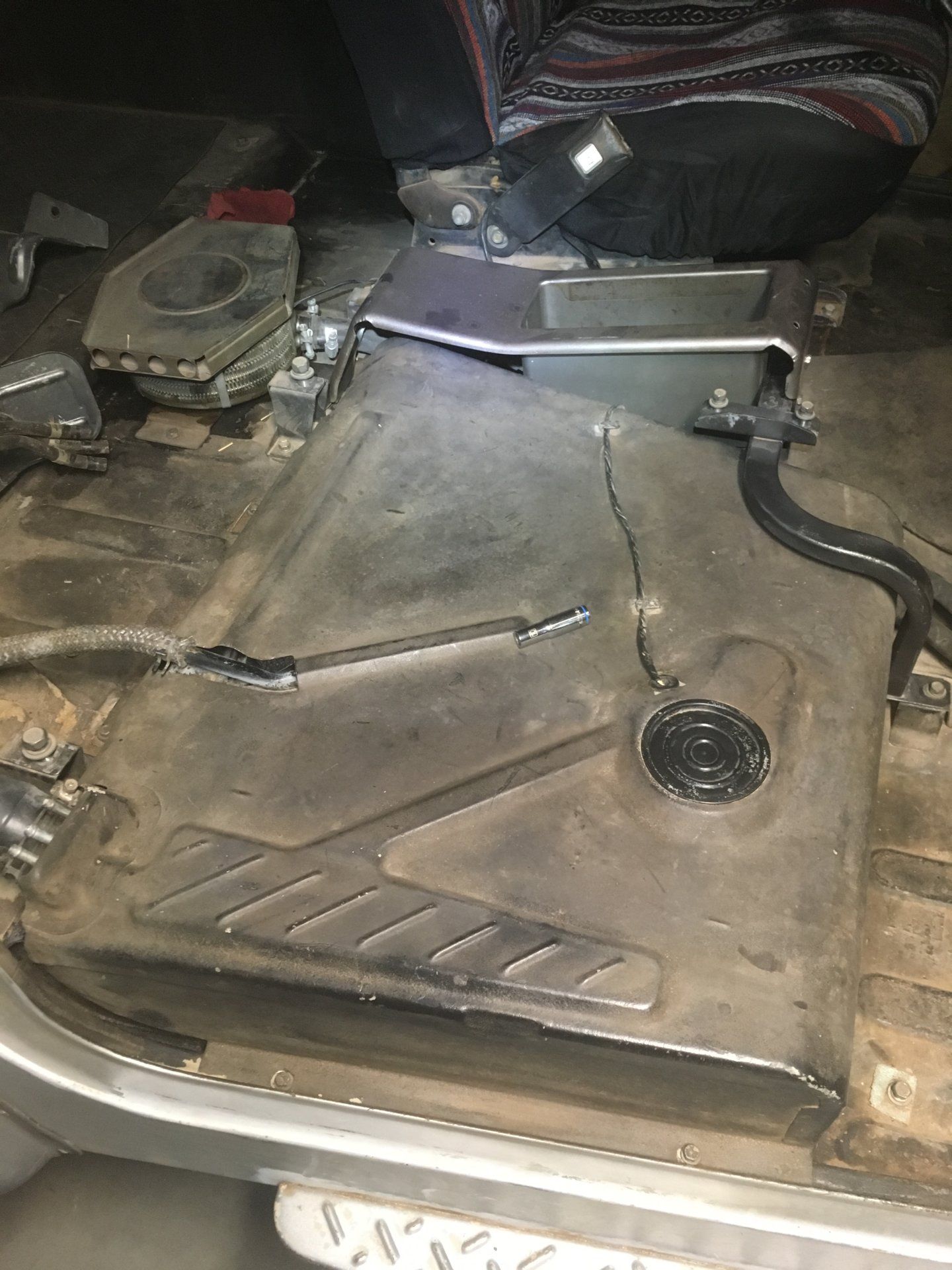

Got some parts in! Plus the gas tank has been cleaned so tons of stuff can be reinstalled!!

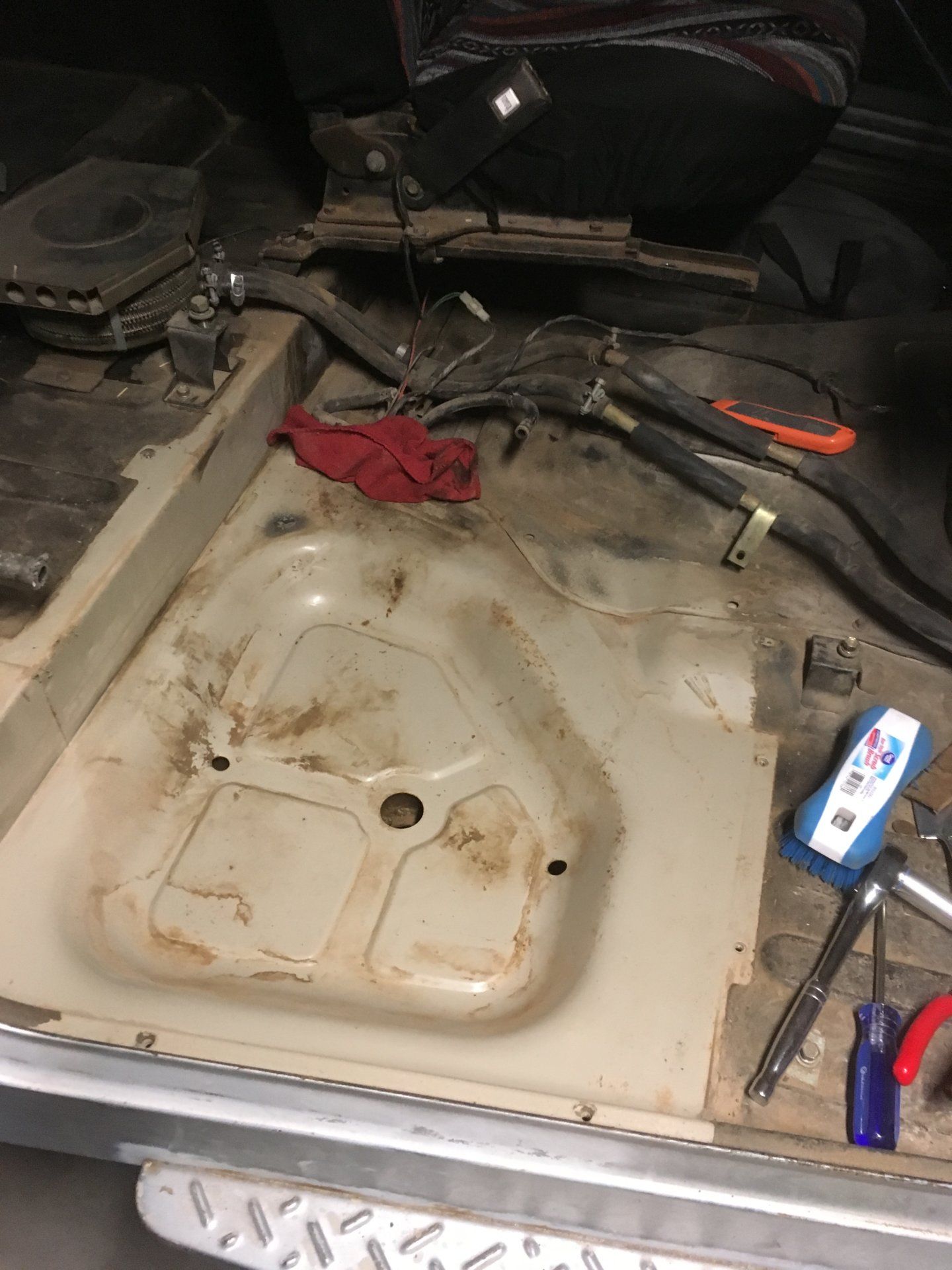

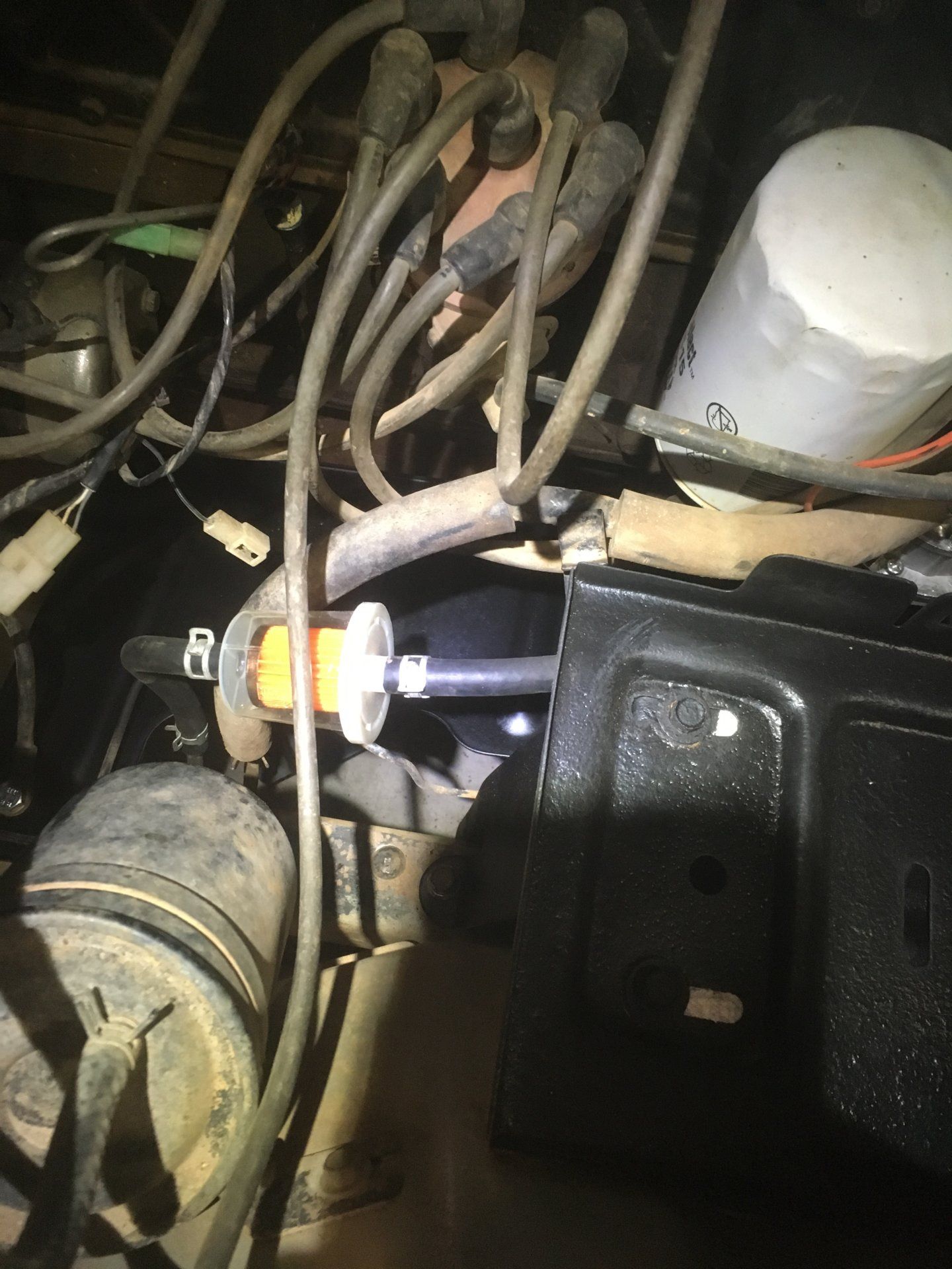

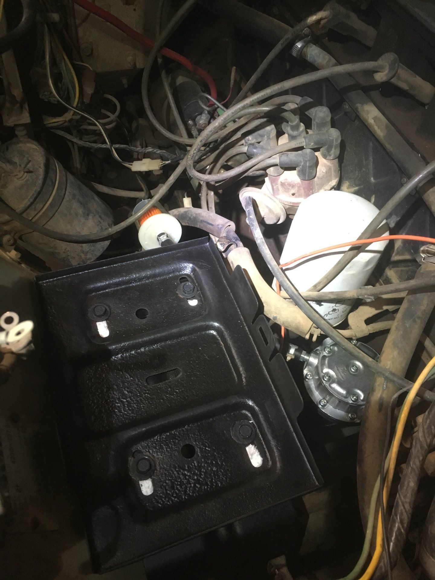

I put in the rest of the replacement soft lines, installed the gas tank on felt, replaced the fuel pump, reinstalled multiple armor skid plates on the passenger side, reinstalled the battery mount, reinstalled the seat, and finally got to put the windshield hold down hardware on!!!!!
Well he runs pretty good now, but when I shut it off and turn off the key, it keeps sputtering for a bit, then stops... on the plus side I touched up the original dealer license frame.

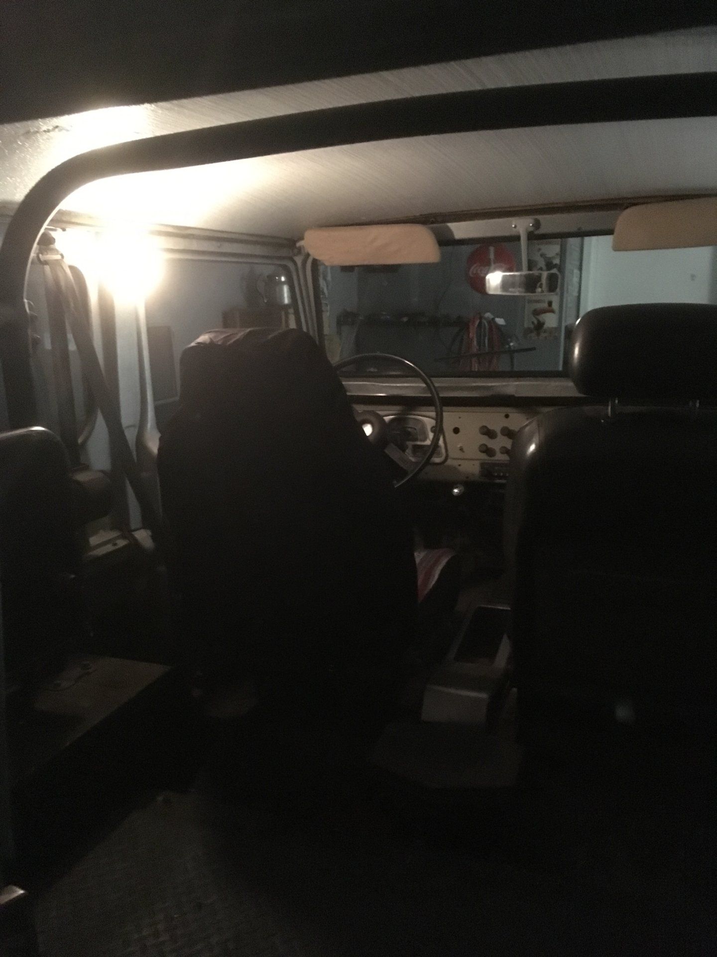

I haven’t got my timing light yet. But I did get in my OEM wiring parts from @Coolerman !that let me wire in my new cabin light! And I got s few small parts from Toyota.

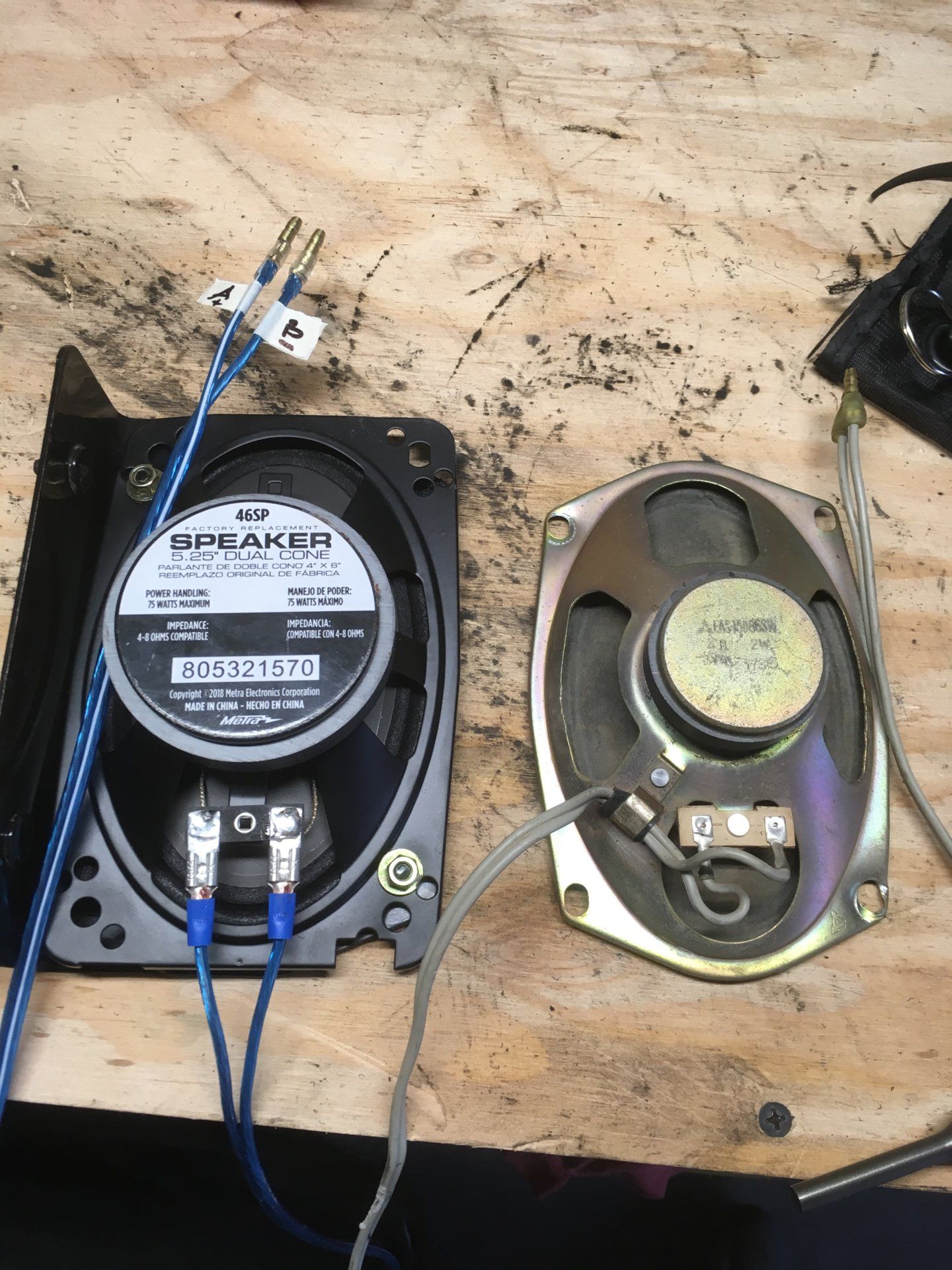

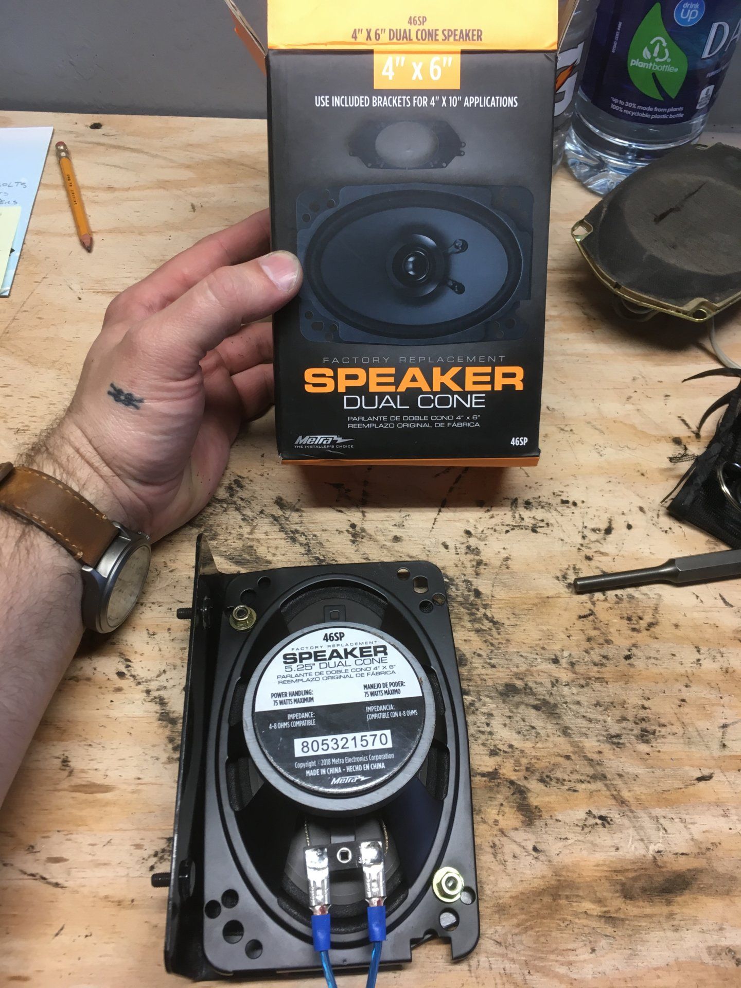

The radio works!! I now have an OEM AM radio with an aftermarket speaker. It’s in the same place and everything. I used OEM male terminals from @Coolerman to have the speaker work with the original radio. It’s loud too!!! Thanks autozone.
