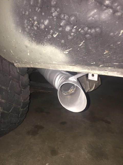

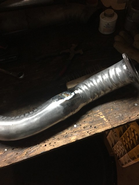

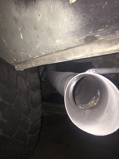

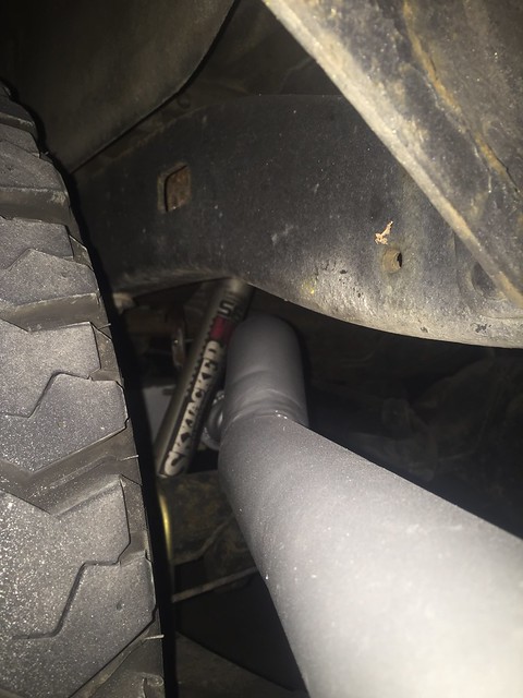

Finally have some after all this talk. Got to working on the exhaust this weekend since I had some time to fix my mistakes from when done originally. Funny thing is, it was approximately a year ago when I did the first attempt, took my time this time. Definitely helps having my own welder and space to work, regardless of how small the work area is.
Of course, I didnt get a whole lot of pics because the phone was sitting on the shelf playing music the entire time. But welded up myself a nice section of exhaust. After running the short, stubby over axle pipe for so long the system is SOOOO QUIET now... really kinda miss the sound.

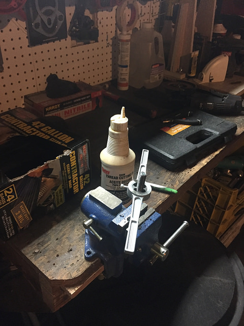

Even went so far as to thread my own piece of 3/8" rod for the hanger at the end....
Untitled by Greg Fisicaro, on Flickr

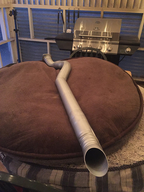

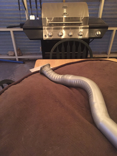

Then once everything was done it got a nice final painting of VHT Flame Proof SP117 (flat aluminum) which is apparently made for exhaust parts.
