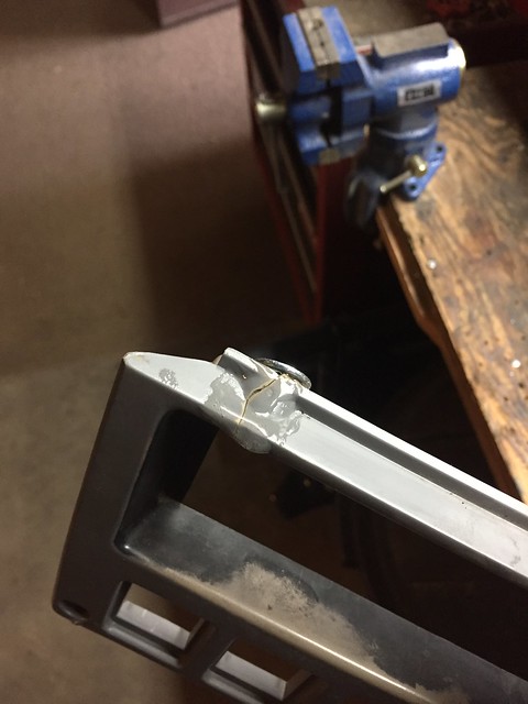

Then while I was in there I decided I was going to set to the task of fixing the broken console surround. Ended up playing hookie today and played with the surround to get it all glued back together with some plastic weld. Plan is to sand it down once it sets for a day and then repaint everything.

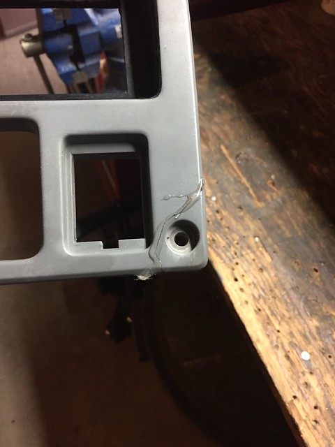

While I was at it I decided i was going to try to reinforce the holes with some small washers glued to the back side. Think that inside the hole from the front would be better but getting something the exact right size for in there would be interesting to say the least.

As you can see mine was broken pretty bad with the last pic/piece barely holding on by a thread. Next project will be some L-channel to fix the rear lip between the body and the lower gate.

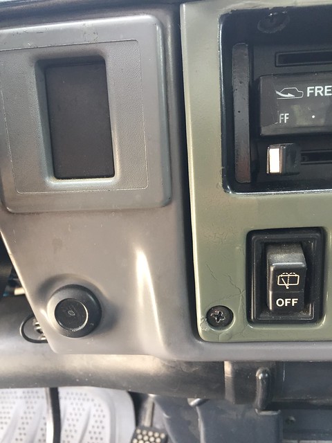

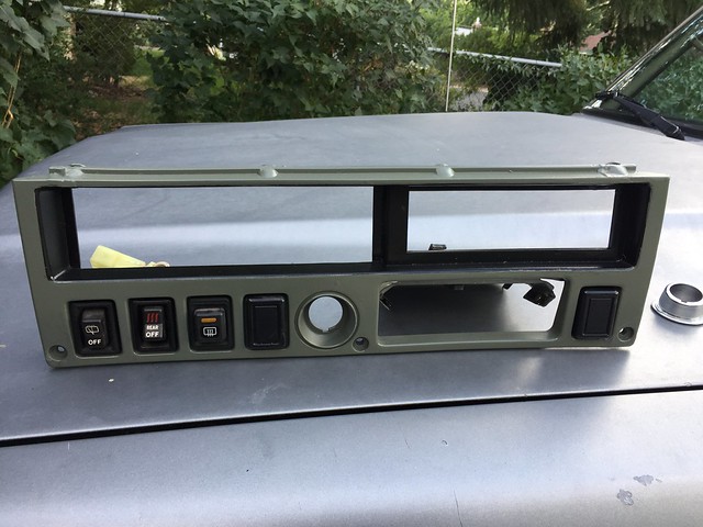

So here is the final fix after gluing, sanding, painting, etc... The color is a bit different, more than I originally thought so I may respray it if I can find a good piece to compare against. The gray is actually just plain old gray primer from Rustoleum with a Rustoleum clear sprayed over it. Black is plasti-dip (only black I had around).
Untitled by Greg Fisicaro, on Flickr
If you look at the grey compared to the other pics you will see it has more of a green tint to it making it quite different. I will be installing tonight and then will do an interior pic against the gray of the rest of the dash for better comparison.

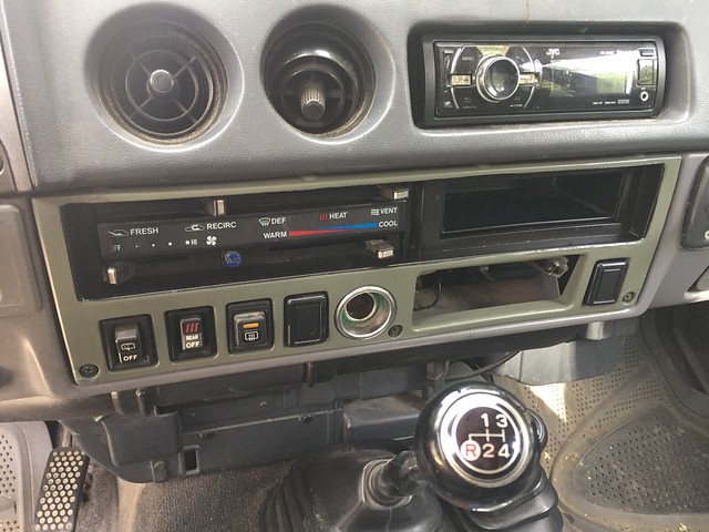

And here is the final product installed... much better representation of how different the color is... Debating now if I want to pull it again, do some sanding and then re-apply a more "gray" color...

And that crack is filled, just a bit of a paint run next to it and then not completely sanding off all the glue/epoxy.
I don't think I could stand that much difference in color myself. I'd have to repaint it.
Yeah it is eating at me, but not going to have the time for a little bit so it is going to have to stay. Other option is that I leave the switches attached for those things I need, like the cig-lighter for charging and rear wiper switch while I resand and paint.
