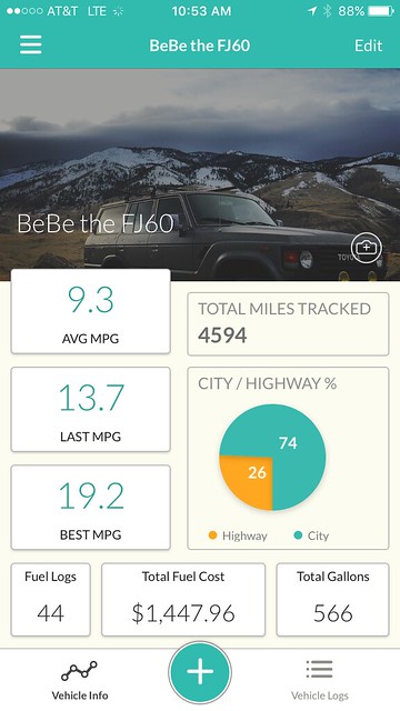

From Carson to Hawthorne is like 120ish miles of 60-70mph highway and was able to pull 13.7mpg for the trip (according to Fuelly) so she is right within the original specs for gas mileage. Just wish that the around town mpgs were a little better as normally I don't hit the highway for more than a few miles if at all.
