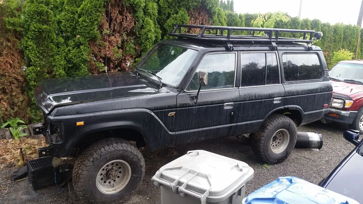

Now I will pressure wash my HJ to get it ready for brakedisk rebuild, new corn is planted so no more 4x4 around the farm :( lol last error tracks were so deep the HJ had tons of mud and clay everywere.

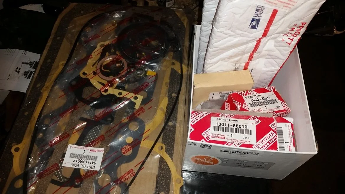

Parts arrived on Friday!
And my head from china is reported as SHIPPED, but still not showing up on tracking. Maybe next week?
New OEM head gasket weighs about DOUBLE the weight of what I removed. New gasket is laminated (5 or 6 sheets of metal) vs what looks to be a single sheet of steel on the removed one. Very impressed with the completeness of the engine gasket kit. It even included valve stem seals, copper crush gaskets for fuel line, injector seats (which I purchased separately so have a spare set now) and more!

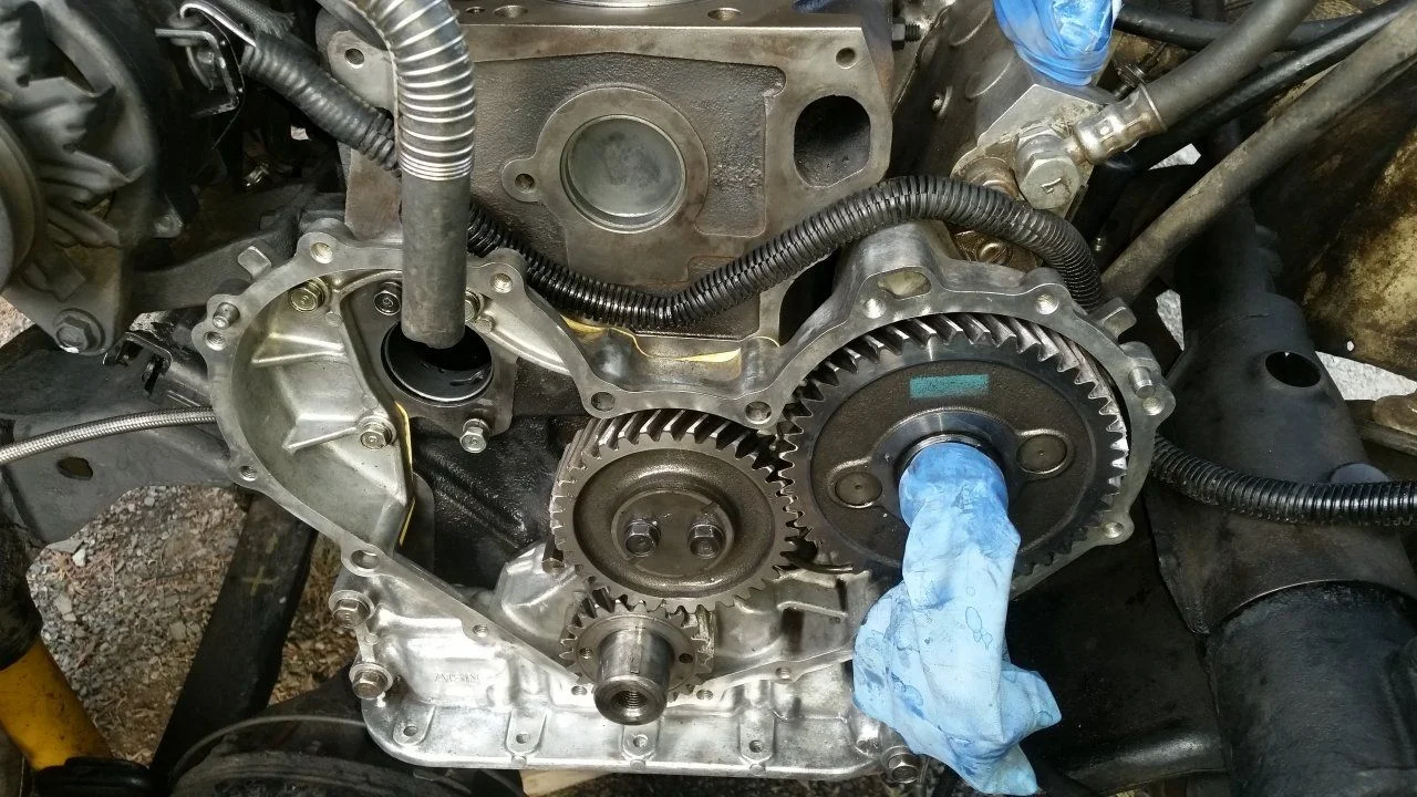

I did get the oil pump ring installed....
but so far that is it.

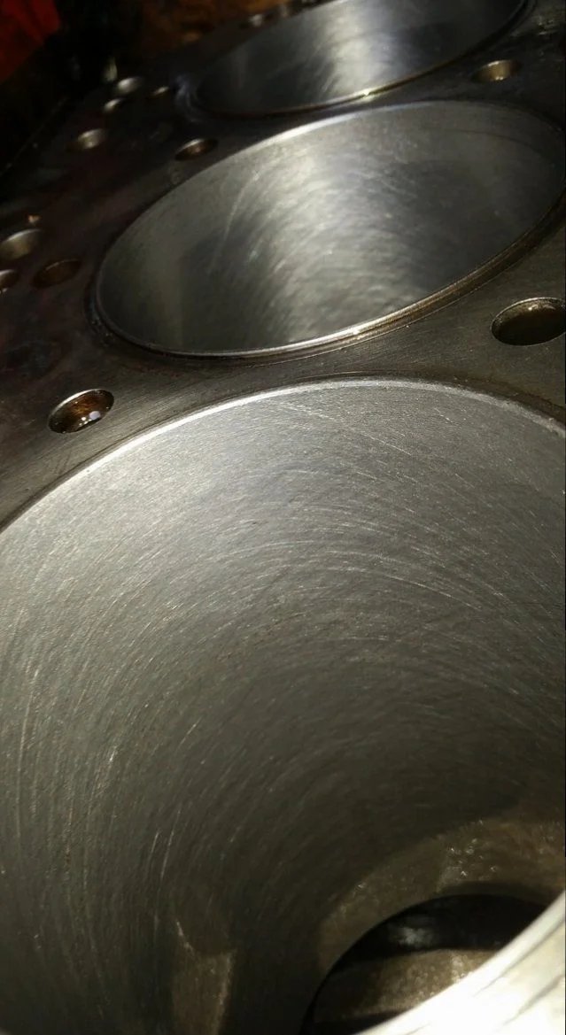

In the mean time, got the cylinders honed. 4.125" Flex hone and about 10 seconds each cylinder in the drill. Just simply a quick clean up.

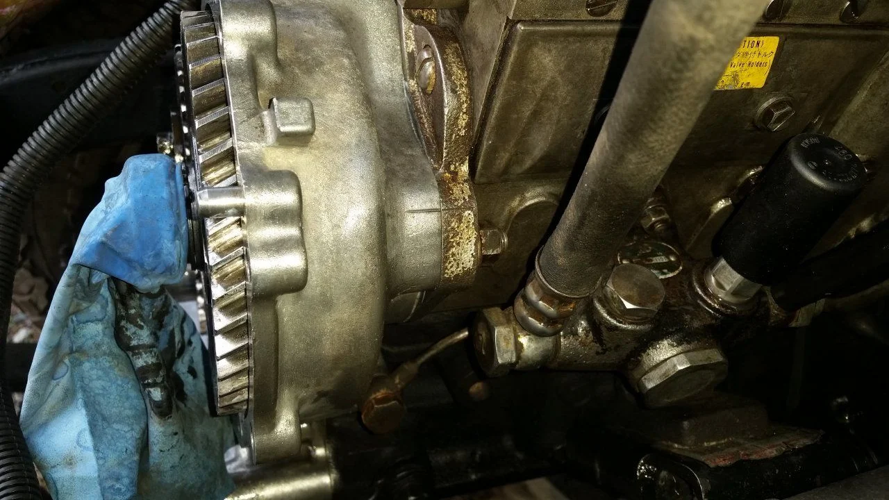

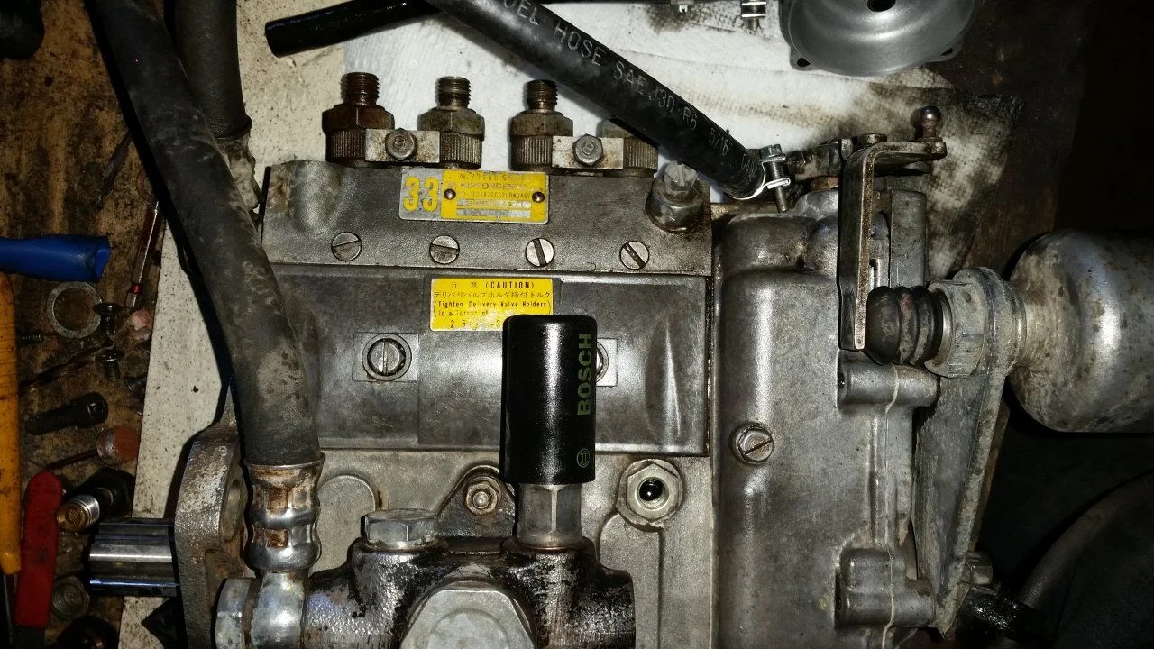

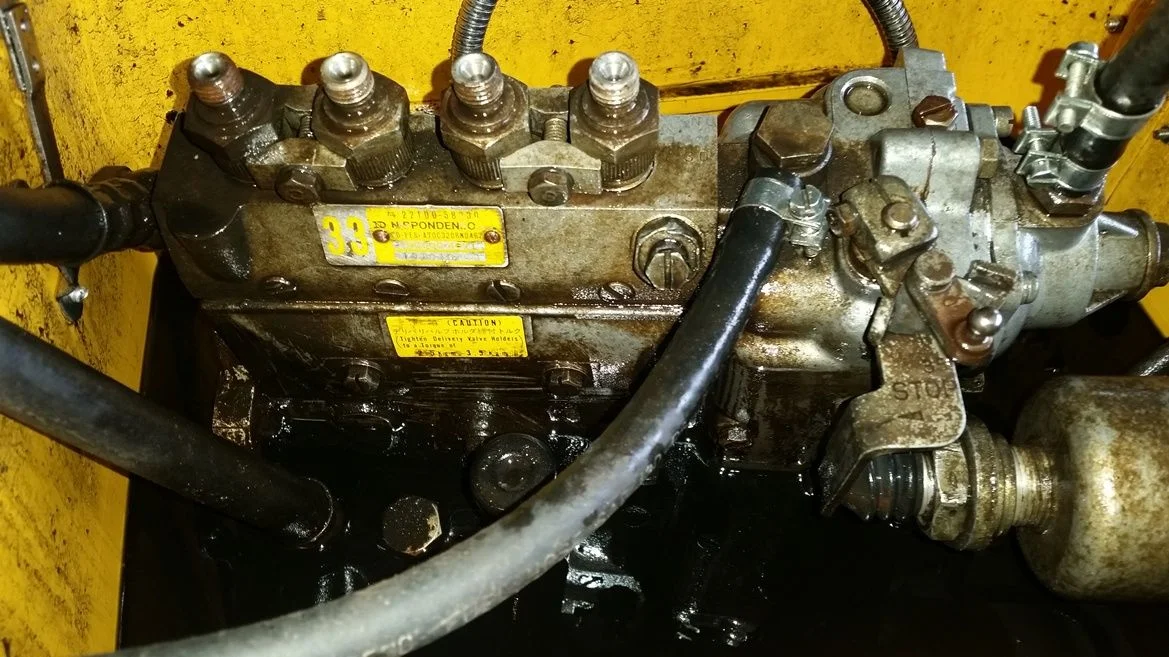

Got the injection pump out and started cleaning...

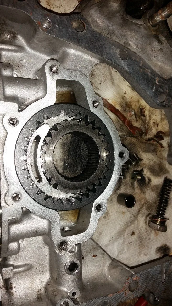

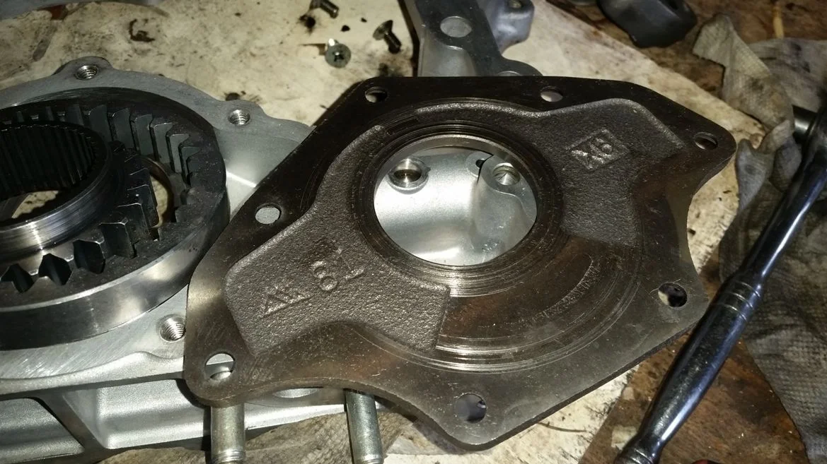

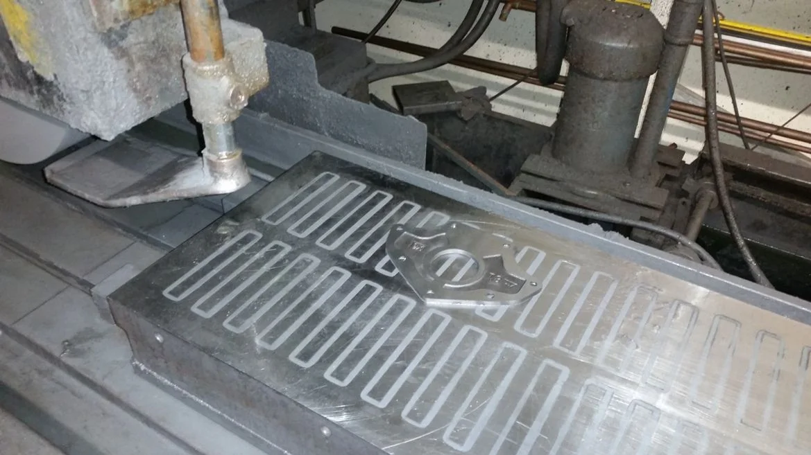

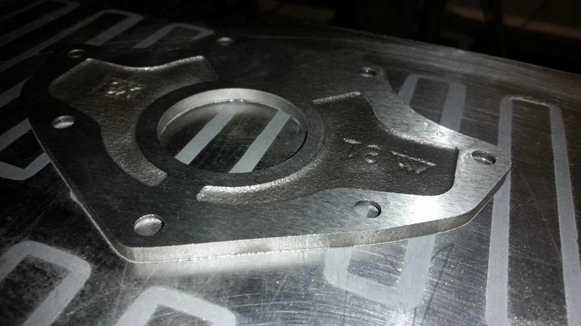

Now with new driven oil pump gear, need to clean up this cover plate that holds axial placement. Notice some scoring...... this is off my doner bottom end with 3XX,000kms and looks better than my 500,000km oil pump.
Now make it 'as new'

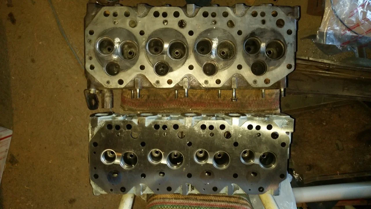

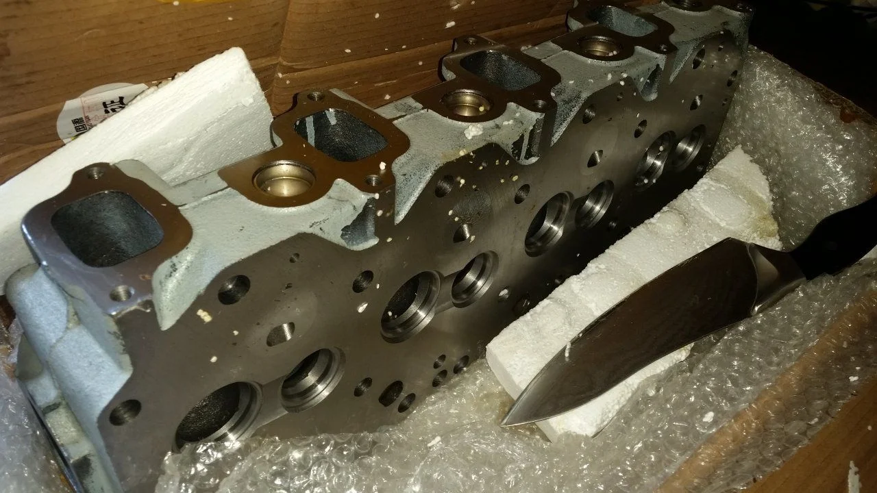

Got it!
Some moisture must have got in as some minor surface rust (wipes off with finger). First impression is all looks fairly good. Edges of ground surfaces are fairly sharp and some burrs are present..... All easily fixable. Also damn syrofoam EVERYWHERE!
And then I test fit the valves.... wondering if I may need to ream the valve guide bushings. Nope.
Notice anything different??? :bang:

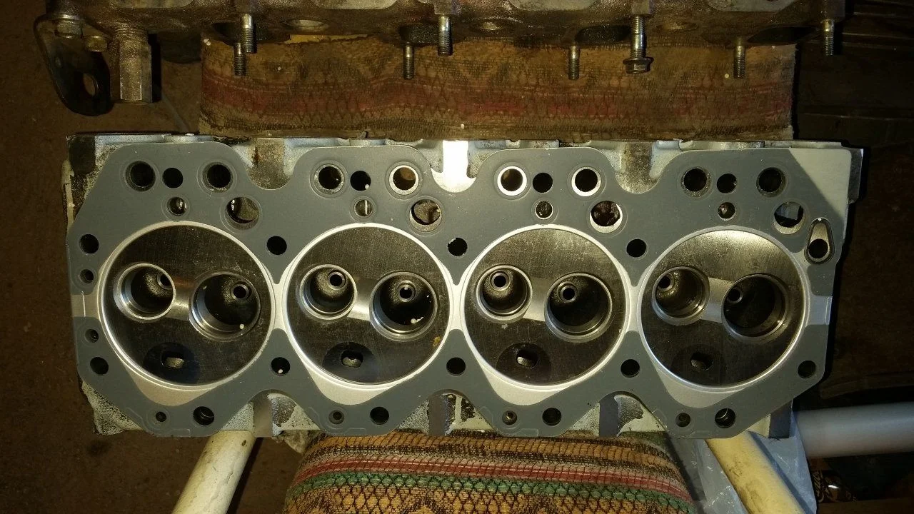

So close yet so far. The exhaust valve is a few mm too small!
Trying to figure what my options are now....
dude... that sucks
Your tellin me!

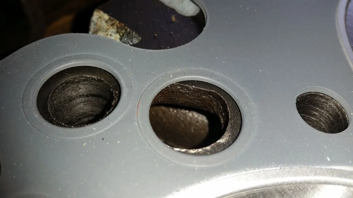

I also noticed this today.... You can see it in the pic above too, just hadn't gotten over the valve seat dia.
3 'D' shaped holes and one more round (4 in total) are about 2mm out and into the sealing ring of the HG. I have my doubts that it would seal at all. Big ole paperweight.
Options are running thin now.

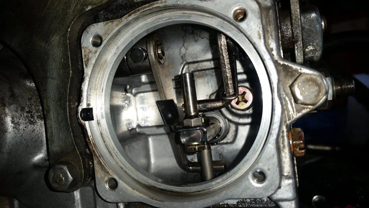

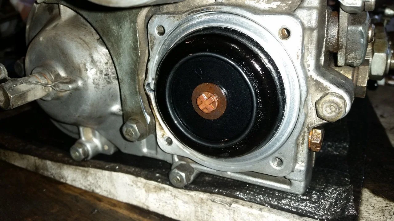

Diaphragm out and quick clean. There was lots of oil and carbon all throughout both sides of the diaphragm, although it looked virtually no different than the new replacement so the old one is saved as a future spare.
Reminds me that the carb was filthy when I got the truck.... one of the first things I cleaned on The Beast. I should probably take another look just to make sure it still looks that way.
Shot of carb cleaner worked well to remove the crud.
Diaphragm is installed
Then on to the inspection cover. Again some minor debris to be sprayed away. Shot of sea foam and looks like new inside (from here).

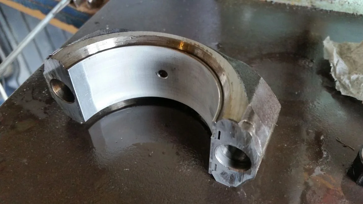

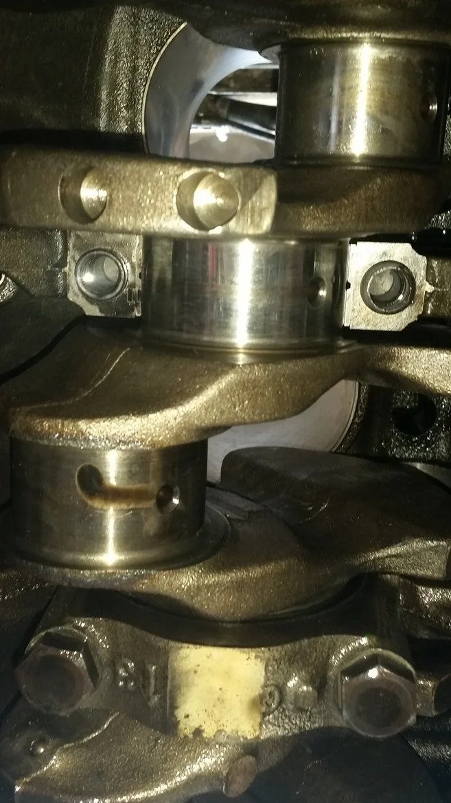

Need to get some plasti gauge tomorrow and check bearing oil clearances on crank shaft. Looks near new, as if someone has been here recently so I will keep the bearings to rebuild the spare bottom end if I can. No point throwing away good metal.

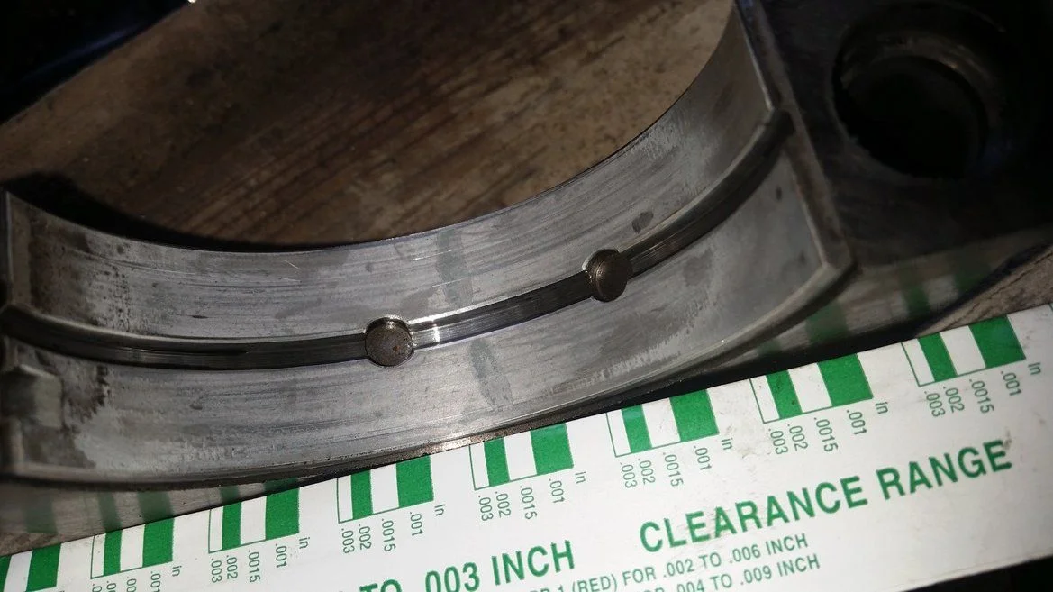

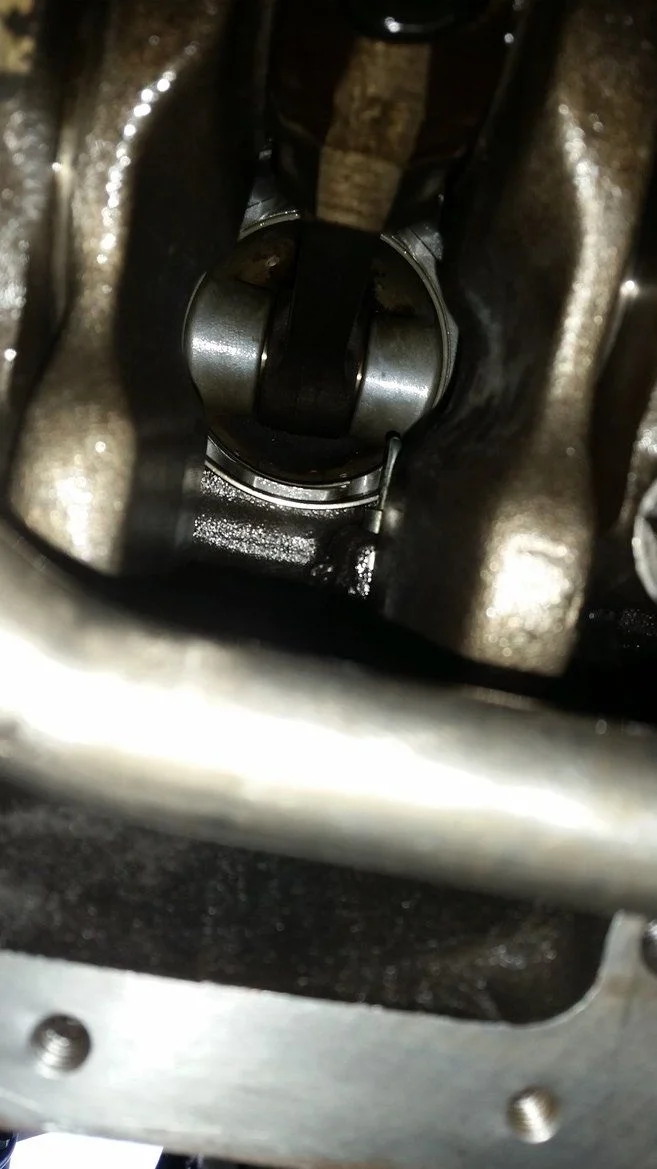

Journals look good.... Everything measures within spec. Healthy looking wear IMO. Plastigauge indictes .0015-.002" (I only plastigauge measured 2 of 5 bearings but all were cleaned and inspected) so good for another 1-200,000kms! (STD clearance is .0012-.0028 with .0040 as the limit)
look close to see/measure the impression

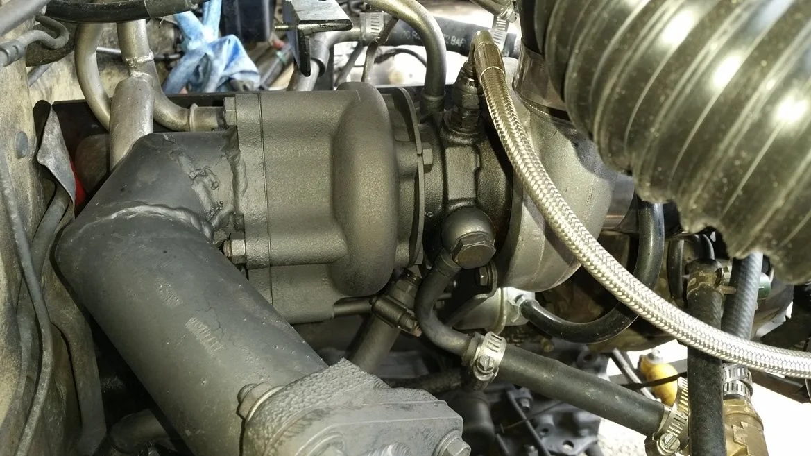

I also sprayed down engine/turbo/brake booster and manifolds (basically anything cast iron) with a dry graphite spray lube, as seen on IH8MUD. We will see how long it lasts, but sure looks way better right now than rusty cast iron it was (especially the turbo exhaust housing).
seal faces just need a wipe with a solvent rag to clean off the graphite.

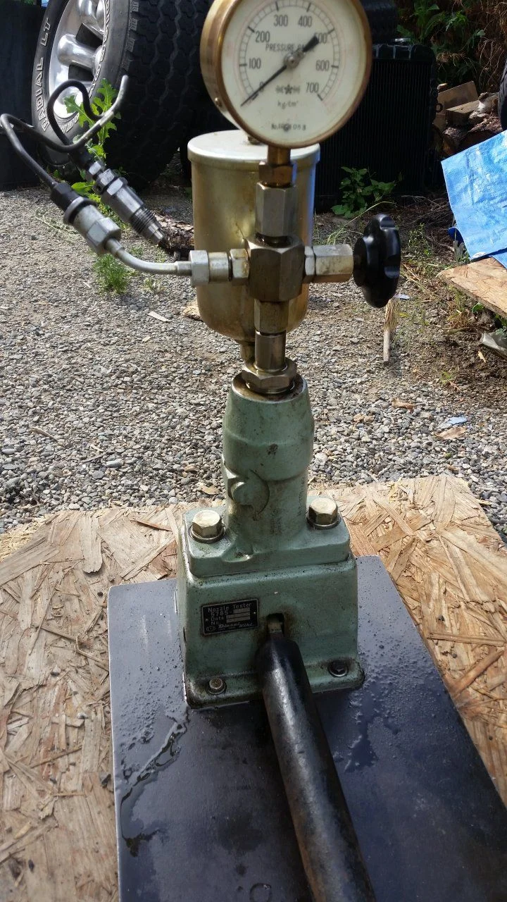

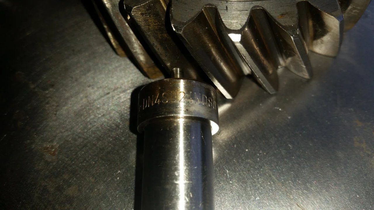

Got my hands on that injector tester. 1971 vintage unit been sitting on a shelf for years. Not sure on accuracy of the gauge but after making an adapter to mate with the 12mm x 1.5 injectors I was able to pressure them up.
I only tested two and they fail horribly. Nozzles drip by about 500psi and 'spray' at 2200-2500psi (according to this vintage gauge). Spray is very misty and loaded to one side so I will be looking for new parts... ND-DN4SU24ND80 it reads...

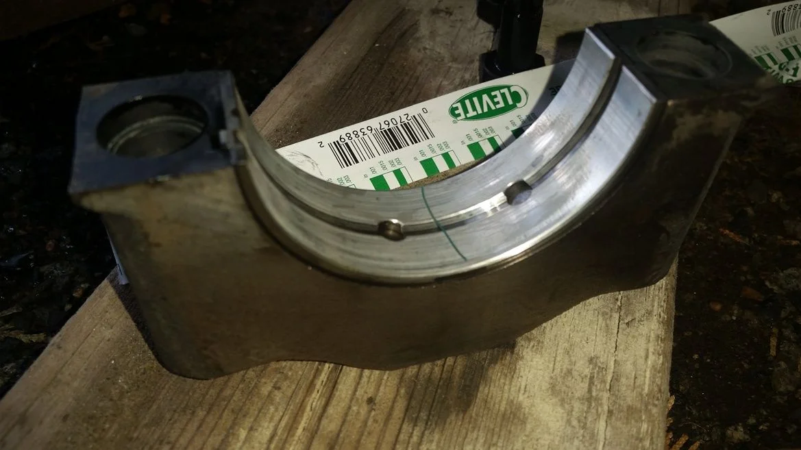

Plastigaged the pushrod bearing oil clearance and sorry no pics, but im gonna call it .0018". Checked 2 and both were the same so calling it good to go! Nice looking wear again....

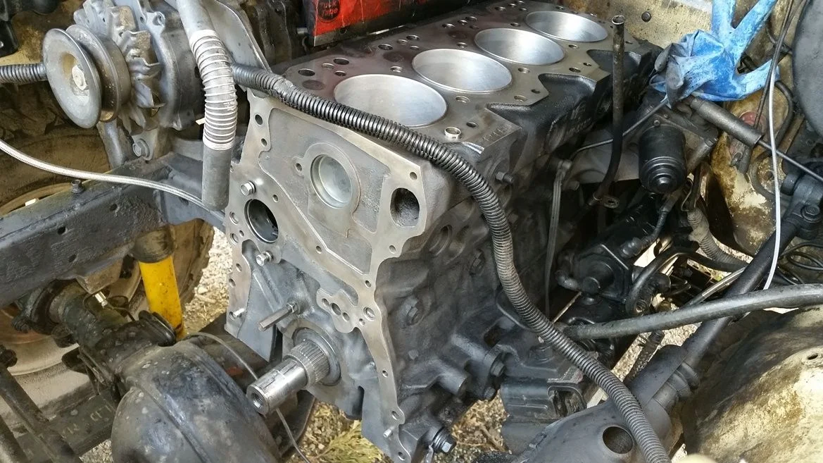

Pistons are in! Slid in with no difficulties at all, old hose on the screw studs to ensure no bearing journal damage and avoid the oiler nozzles and with a firm push with piston ring compressor in place (again no pics as I was on a roll with clean but oily hands as everything got lubed preinstall) all went back in place perfectly, just like its supposed to be.

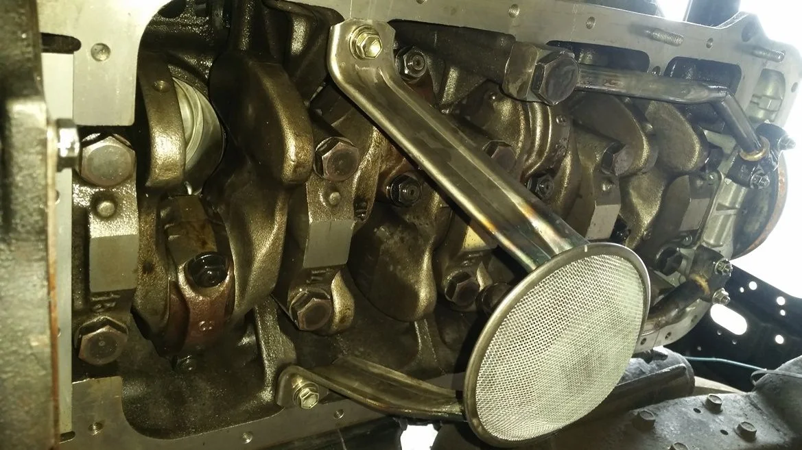

Shot from below.
And here we go.
Storm is brewing and wind is going crazy so I put 2 nuts on the oil pan just to keep all clean and top is wrapped up for now.

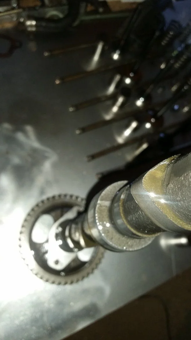

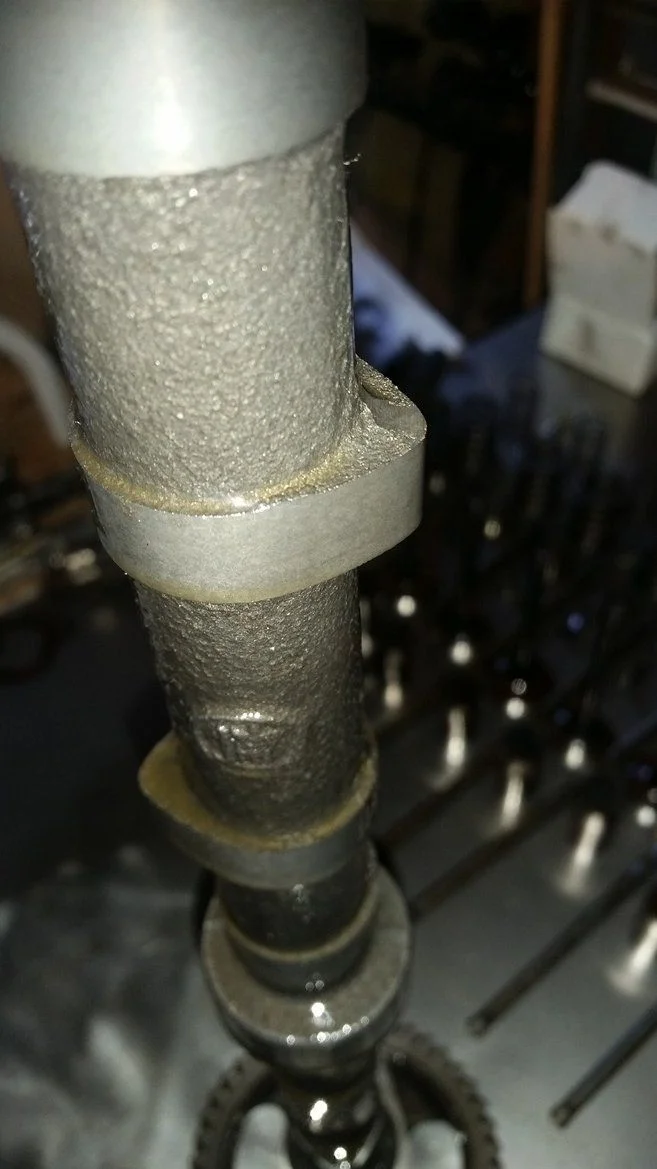

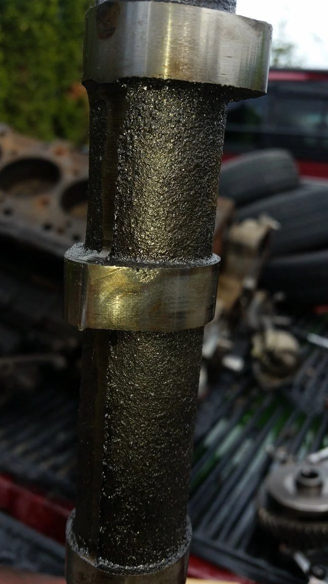

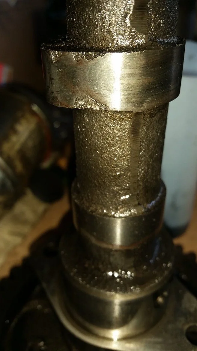

My camshaft as removed, not one lobe was within the FSM 'limit'
So I sourced a seized bottom end for this, way better condition and lots of extra parts! Several lobes are worn more than others (like 30 thou difference) though making 3 of the 8 lobes worn below the limit. Pic shows the worst of them.
Well, just got it back and like new! Hardened surfaces and all.
Not sure if I like the burrs/sharp edges on the new lobes. Might run a file on the corners to remove anything that may become debris.

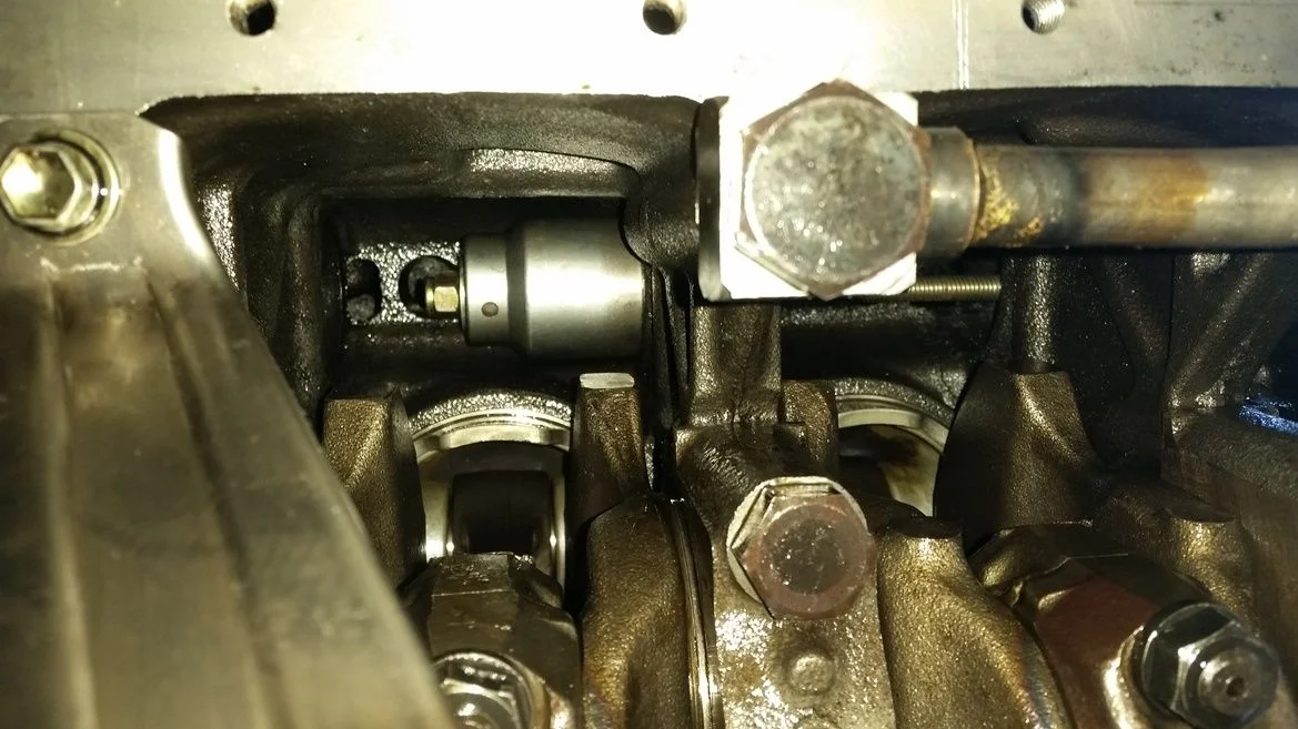

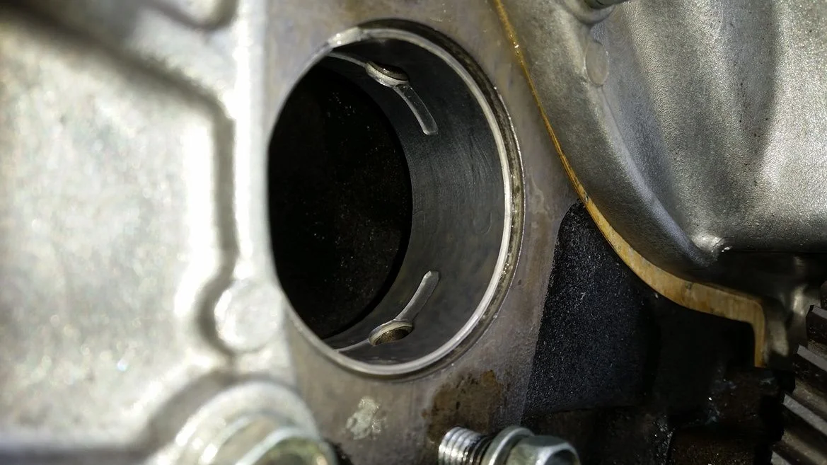

Thankfully I already did the rear main when the tranny was off and only bearing I can not access without separating the transmission is the rear cam bearing. Also thankfully the rear cam bearing is the best of them all, .0014 oil clearance with front cam bearing measuring at end of standard oil clearance .0029" (limit is .0040").
Realizing now that I should have done at least the front 2 cam bearings while pistons were out. Think I can get it done with all left in place. I will find out sometime this weekend hopefully.

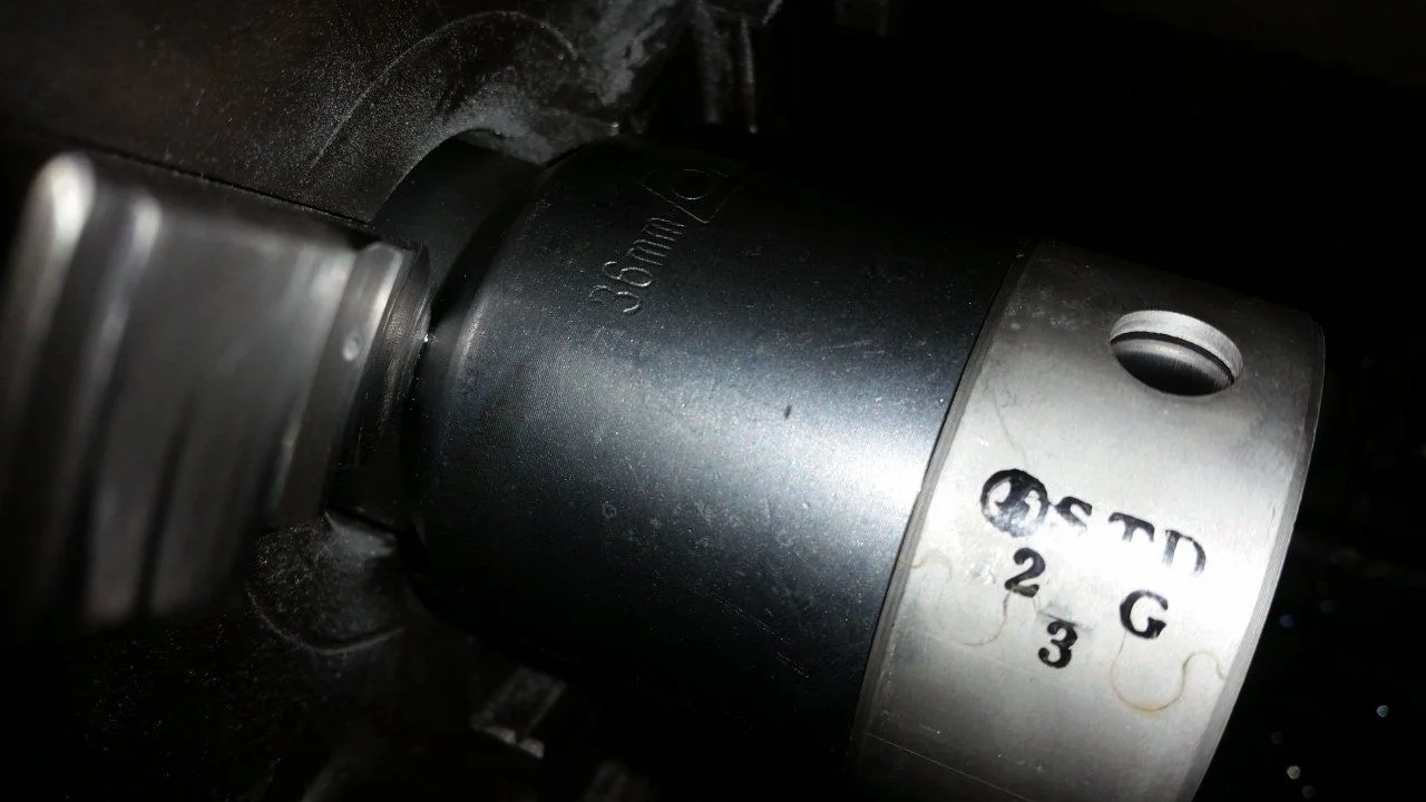

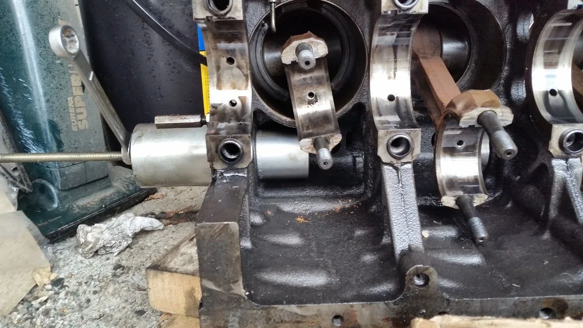

Made a SST to remove and install cam bearings. Simply threaded rod and a couple sockets
My first trial on my spare block.

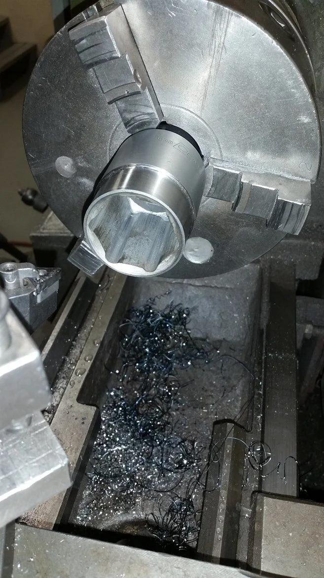

Although it pulled out nicely, the fit of the 36mm socket is not perfect and I am concerned damaging the new bearing while installing. So into the lathe for a little kiss, providing a square and true shoulder to install bearing with.
Installing the middle bearing in the block. Just enough room to get the 36mm socket in there and a hand.
And the finished product.
