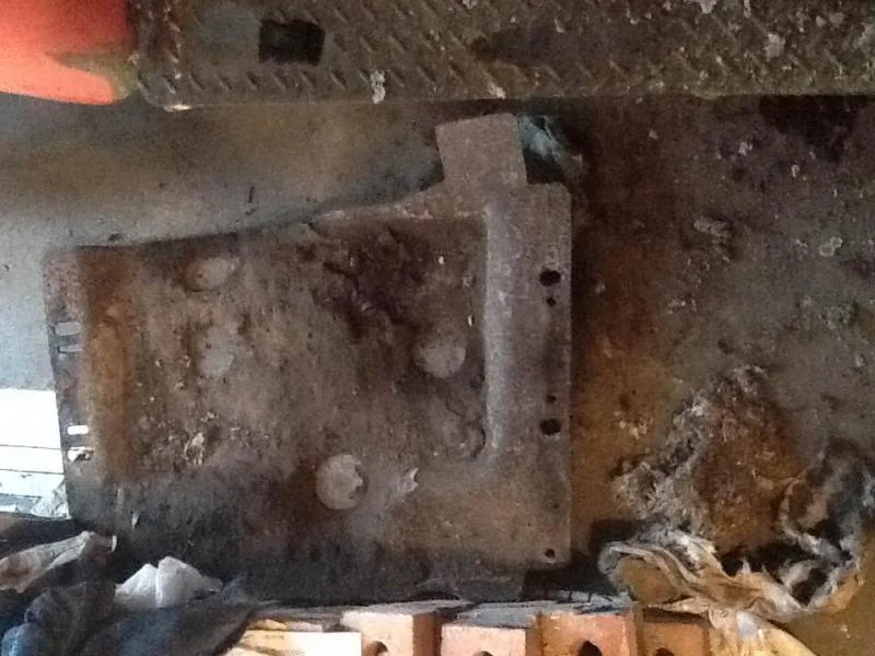

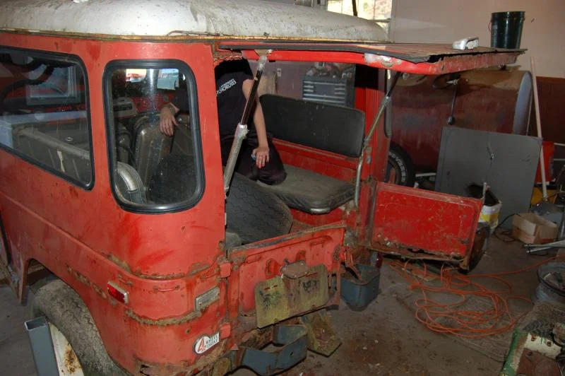

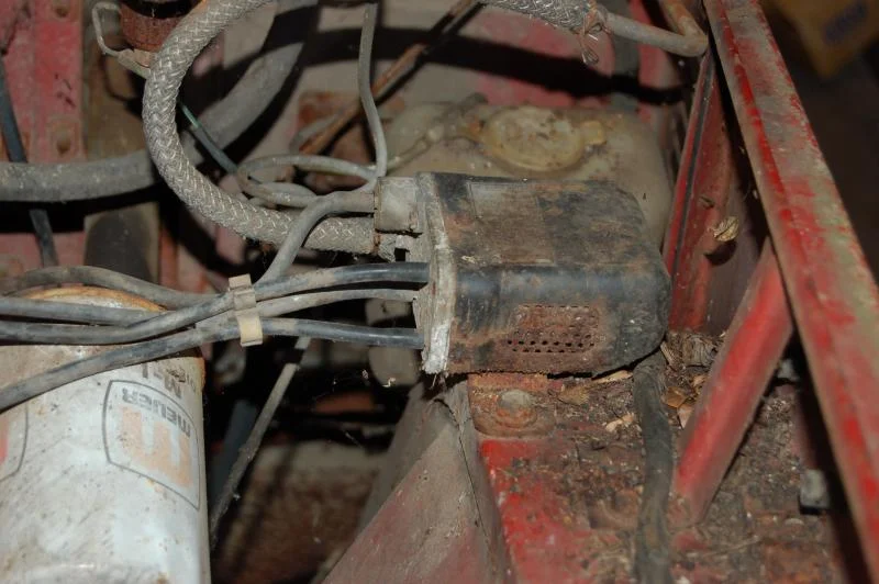

Since getting our daughter - CC's fj40 home we have been working on it a bit at a time, trying to find front disk knuckle assemblies and figuring out how to break free the engine. We finally got it to turn this evening! I snapped off the few remaining skidplate bolts, removed the clutch dust cover, removed the seat material-mouse nest and pried against the bellhousing and the flywheel with a pry bar. I've turned it at least one half of a revolution and it seems to be getting better. A couple more squirts of Sea Foam in the jugs seemed to help.
I found another giant mouse nest in the air cleaner element. It was stinking up the whole garage.
While I was working on the above items, Christina grabbed a ladder, vinegar water and a scraper and scraped most of the lichen blooms off of the roof. She had a couple of pretty large lichen piles!

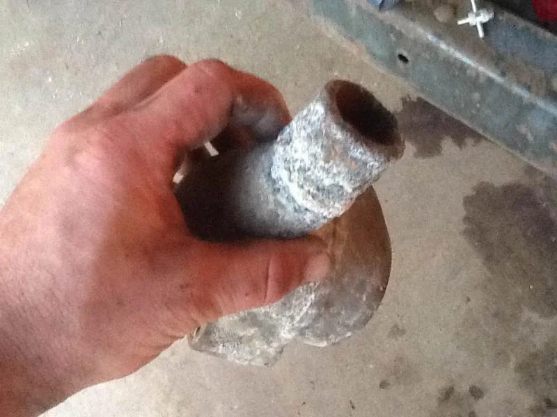

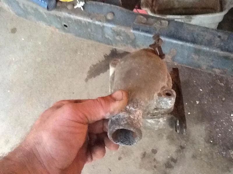

I also tried to remove the top half of the thermostat housing, but both bolts snapped off. I intended to take it to work to media blast and possibly weld fill. Would this one be better to replace?
Doesn't my daughter looked thrilled to have her allergies being attacked by old mice nests and lichen? (crappy pics via her IPad)
