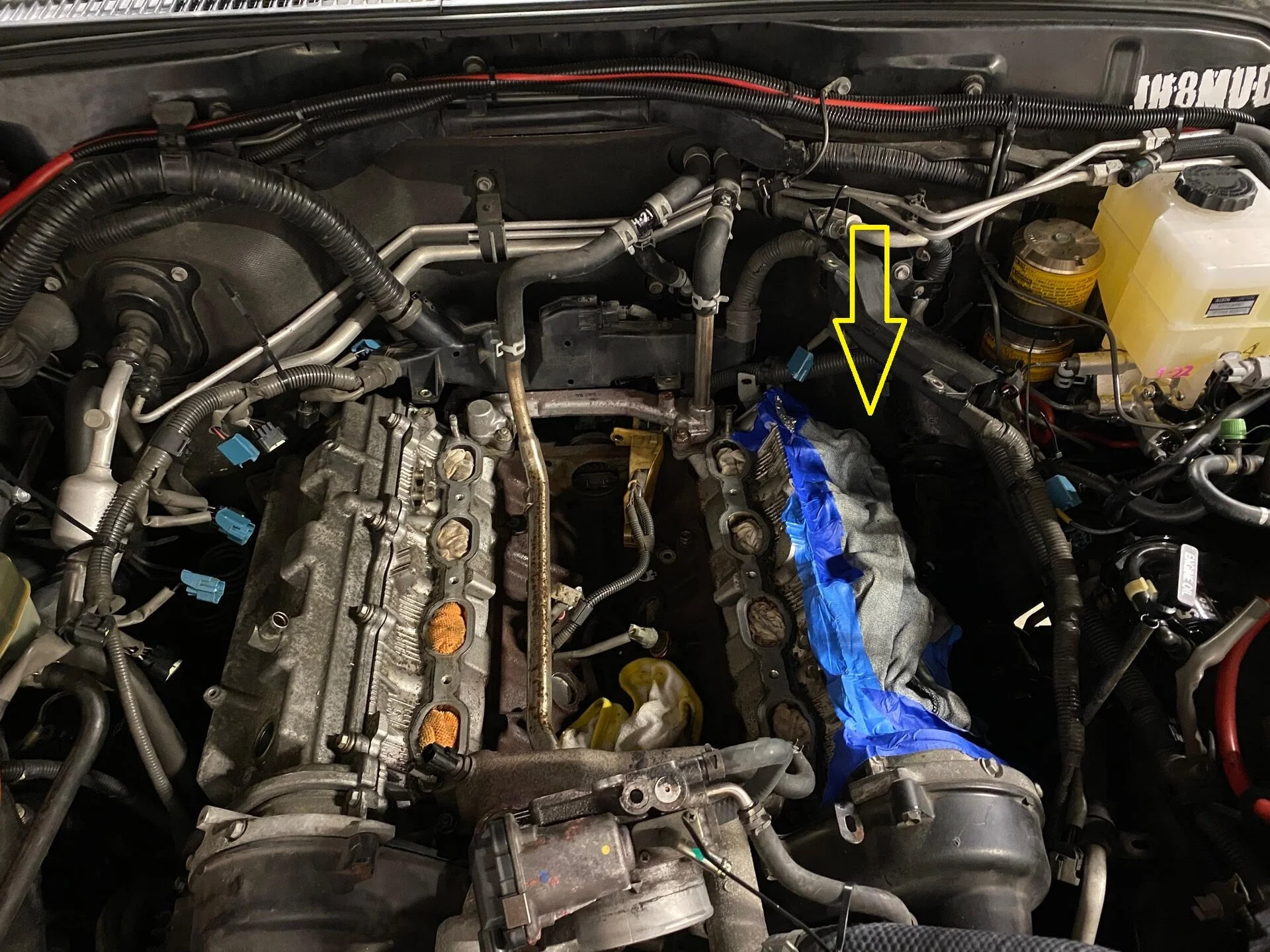

I went to replace the badly leaking valve cover gaskets on my 2004 Lx470. The driver's side rearmost valve cover bolt broke off in the head. I have spent probably the past 25-30 hours trying everything in my arsenal to extract it. I have attempted welding nuts to it several times, and gotten no further.

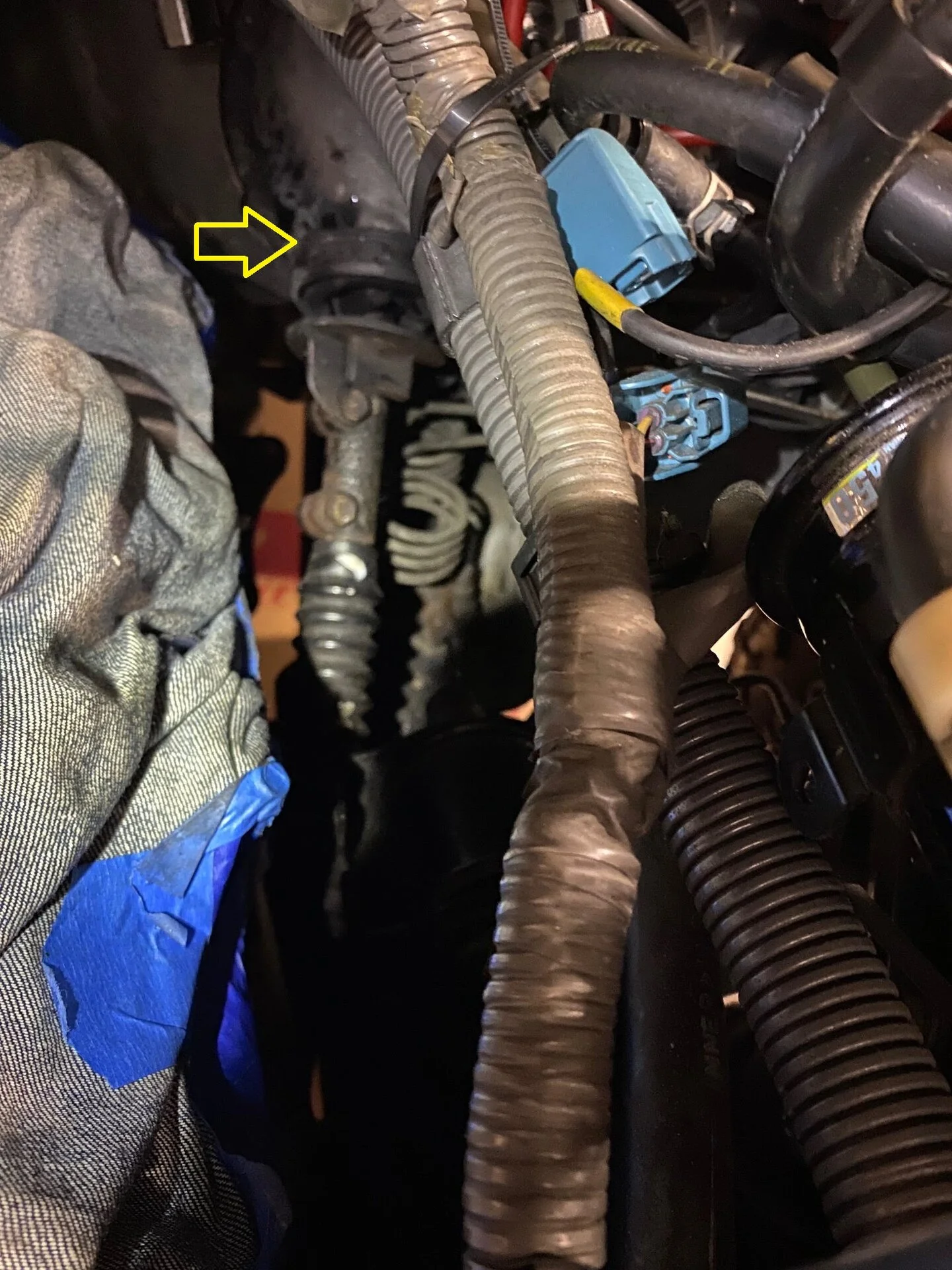

The bolt was almost out when it broke, only the last 1/4" of threads are stuck in the head. the problem is there is so little room to work in the area. I even bought a right-angle drill, but there are less than 2 inches between that bolt surface and the body of the vehicle, so there is no chance of a right-angle drill getting in there.

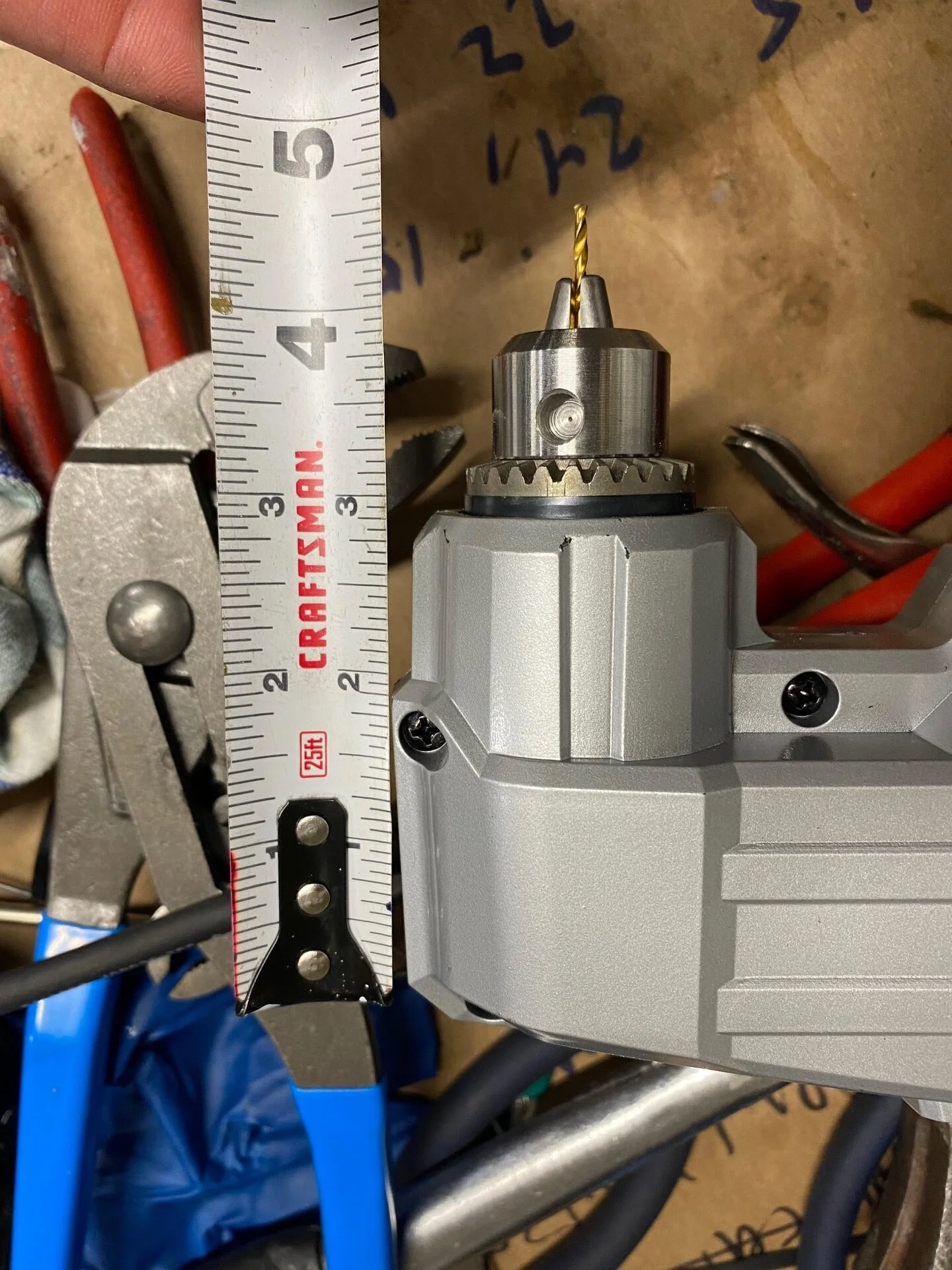

i just measured it and with the smallest bit its just over 2.5"
start on an angle or 'clearance' some more room for this unit

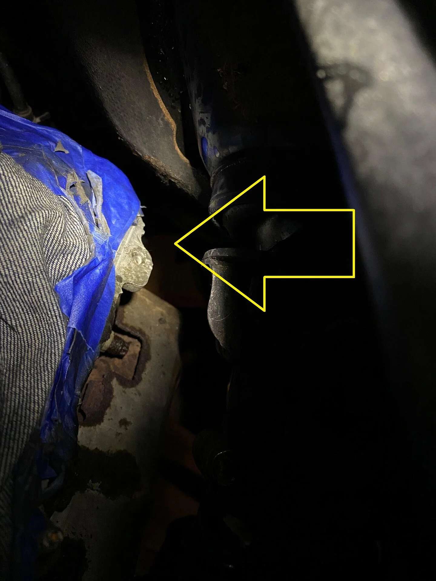

This pic makes it looks like the hole is through to the other side and the other side is open (as in it's accessible from the bottom)? If that it true, I'd try and drop the engine a bit lower and drill through without much regard for the threads. Once you have a through hole, you can put a through bolt with a nut on the other side.

Above is what I've been thinking too: Even a 8 mm nut and bolt would hold it. If you pull the engine out.... as a Mudder and your passion to fix things right with oem... be ready to break the bank! I can tell where this will head for simple bolt extraction vs.. replace... this and that "while" the engine is out!

Issue with fixing one head (with a complete head job), the driver's bank will have perfect compression while the pass is not can cause some vibrations. Since OP has no symptoms of head gasket issues, my advice would be to pull the engine if all options fail. Best would be to drill and at least install a self tapping screw there.

It looks like the angle is still favoring the engine side so coming from below may still be tough to get the drill in there, nice and squre. Would have to remove exhaust probably as well?'
OP mentioned just a few inches of space from above, not many options I can think of other than coming from below or having to pull engine but hopefully someone else will have a better idea

Temporarily removing the motor mounts should give you about an inch of additional room, and if you combine it with lowering the crossmember where the transmission mount is bolted to, you might get some more space. It'll be very wobbly there, you want to support everything using steady stands or wood blocks, go one by one and support before proceeding, and keep an eye on the cooling fan, remove/release the shroud before attempting that. Also keep an eye on the transmission links not to mess them up. I'd consider that a 2 people job, or a 4 eyes job actually.
But before attempting that, I'd try some cold weld on the bolt, and heating up the head a bit to see if the expansion of the aluminum together with some mechanical movement of the bolt back and forth will get that piece moving out in the threads. As others mentioned, trying to cut a slot on the bolt and using a tiny screw driver, or continuing the painful attempts to insert a bolt extractor in that limited space, as hard as it is, It's better than removing this engine.
