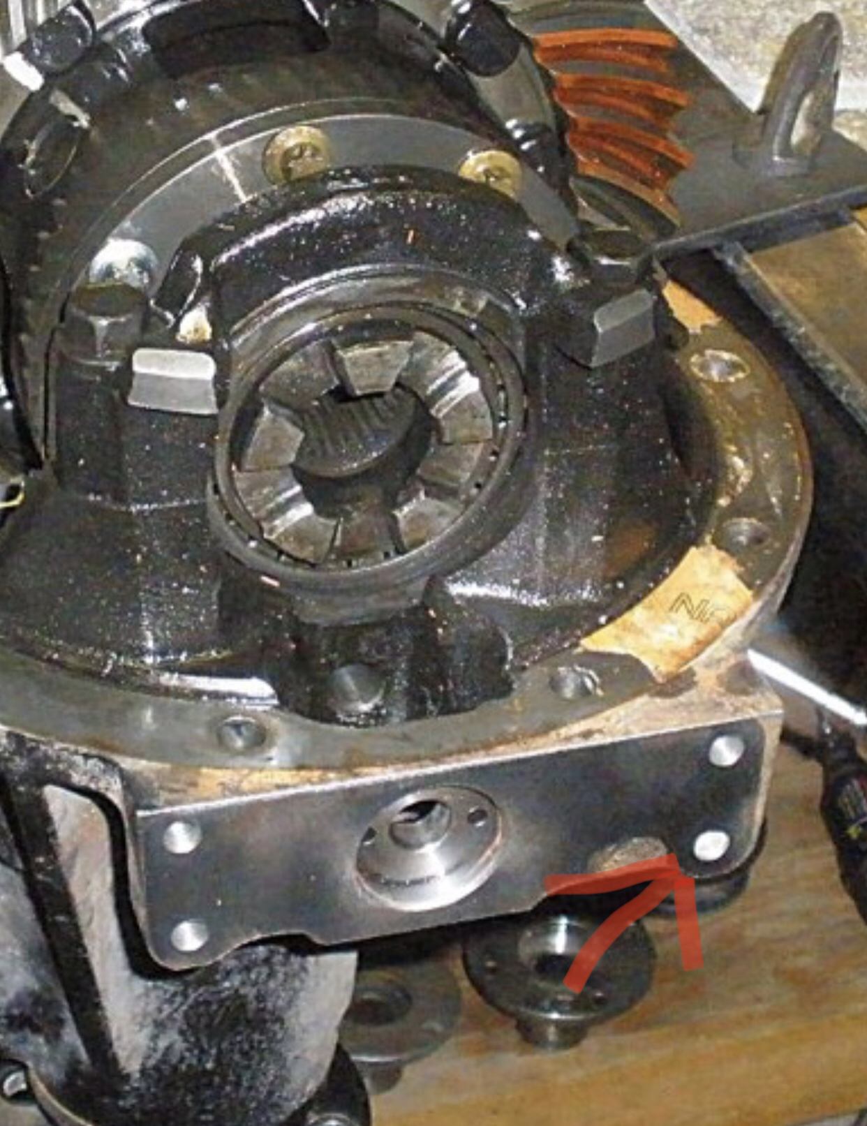

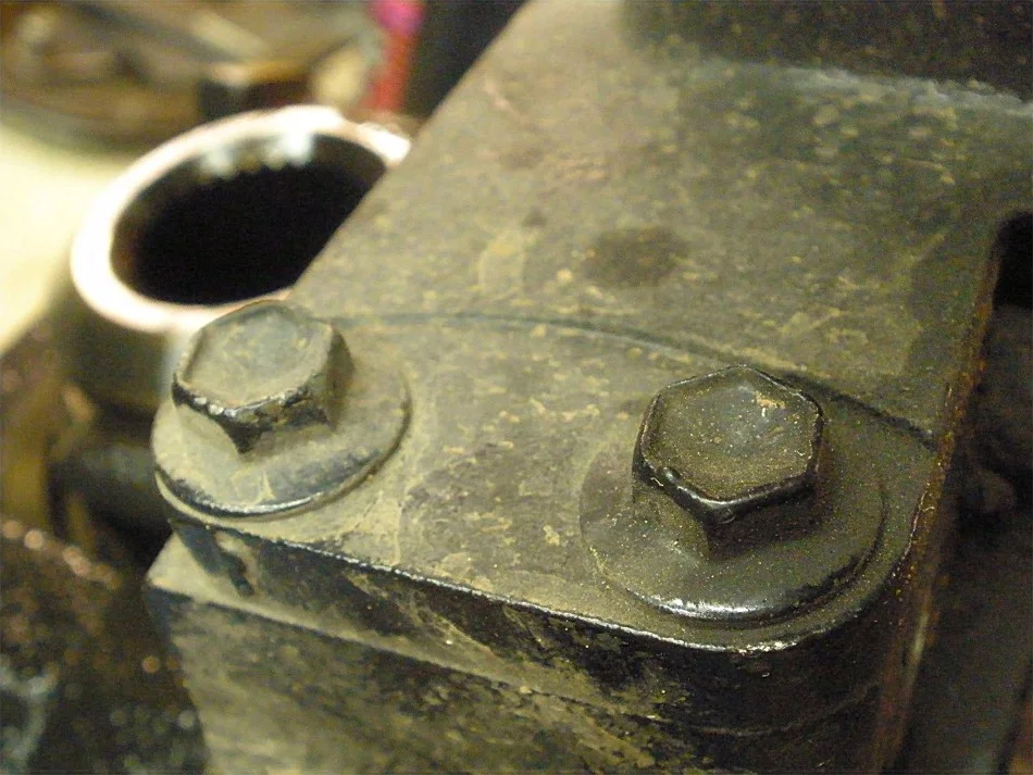

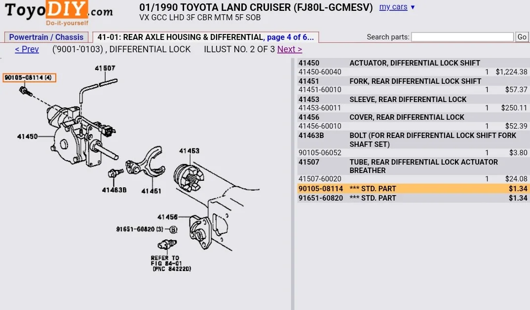

I pulled my rear diff lock motor and I mangled the heads of two of the Elocker motor bolts trying to remove them.
I think they’re a 90105-08114. Can anyone confirm the part number or recommend an alternative?
1996 fzj80.
This is them and where they go.
Thanks!

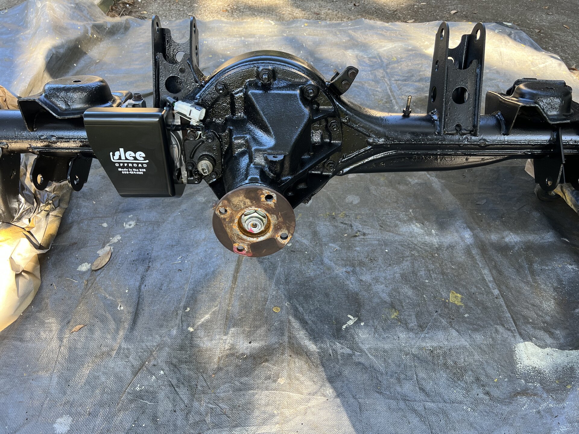

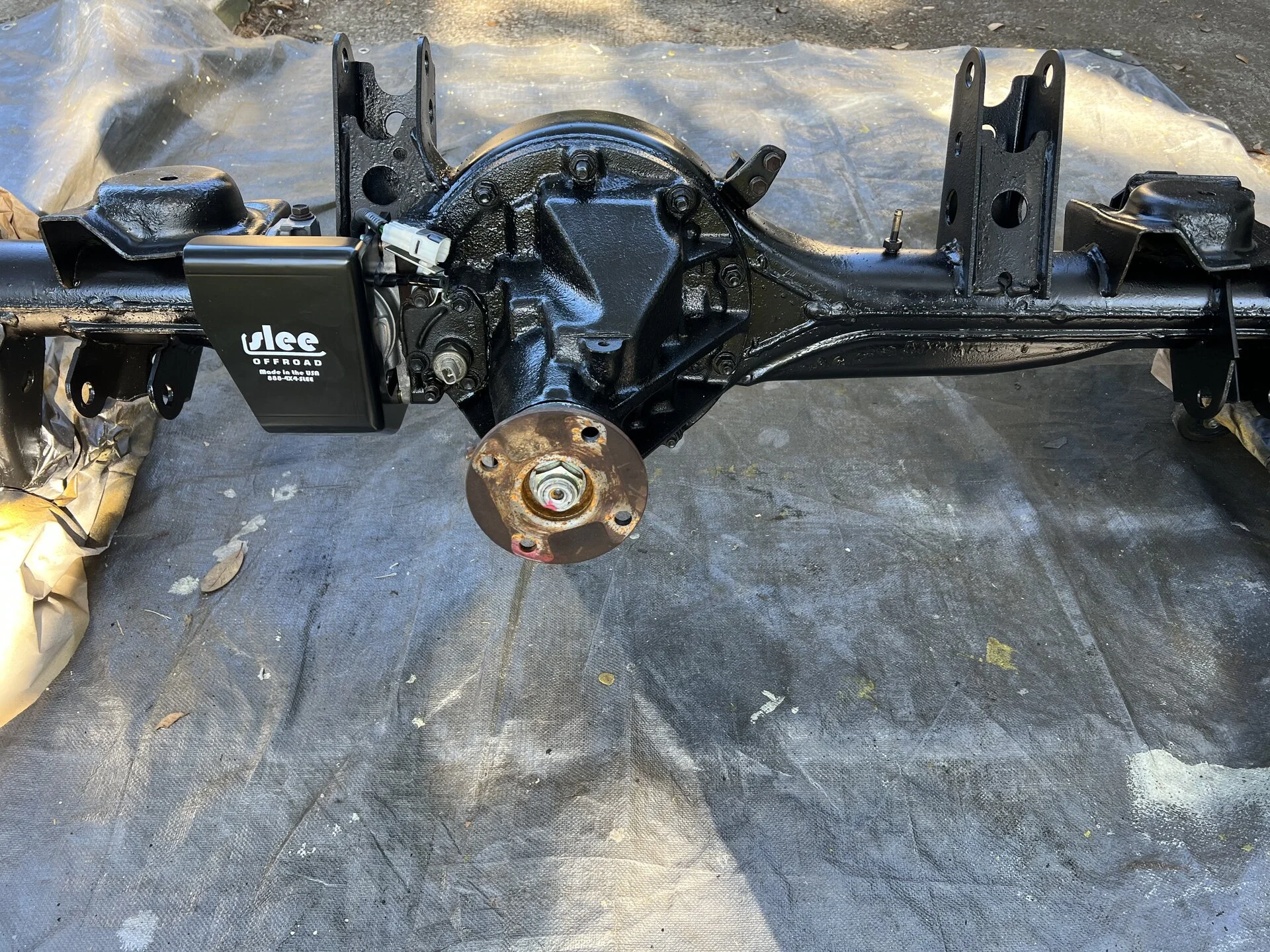

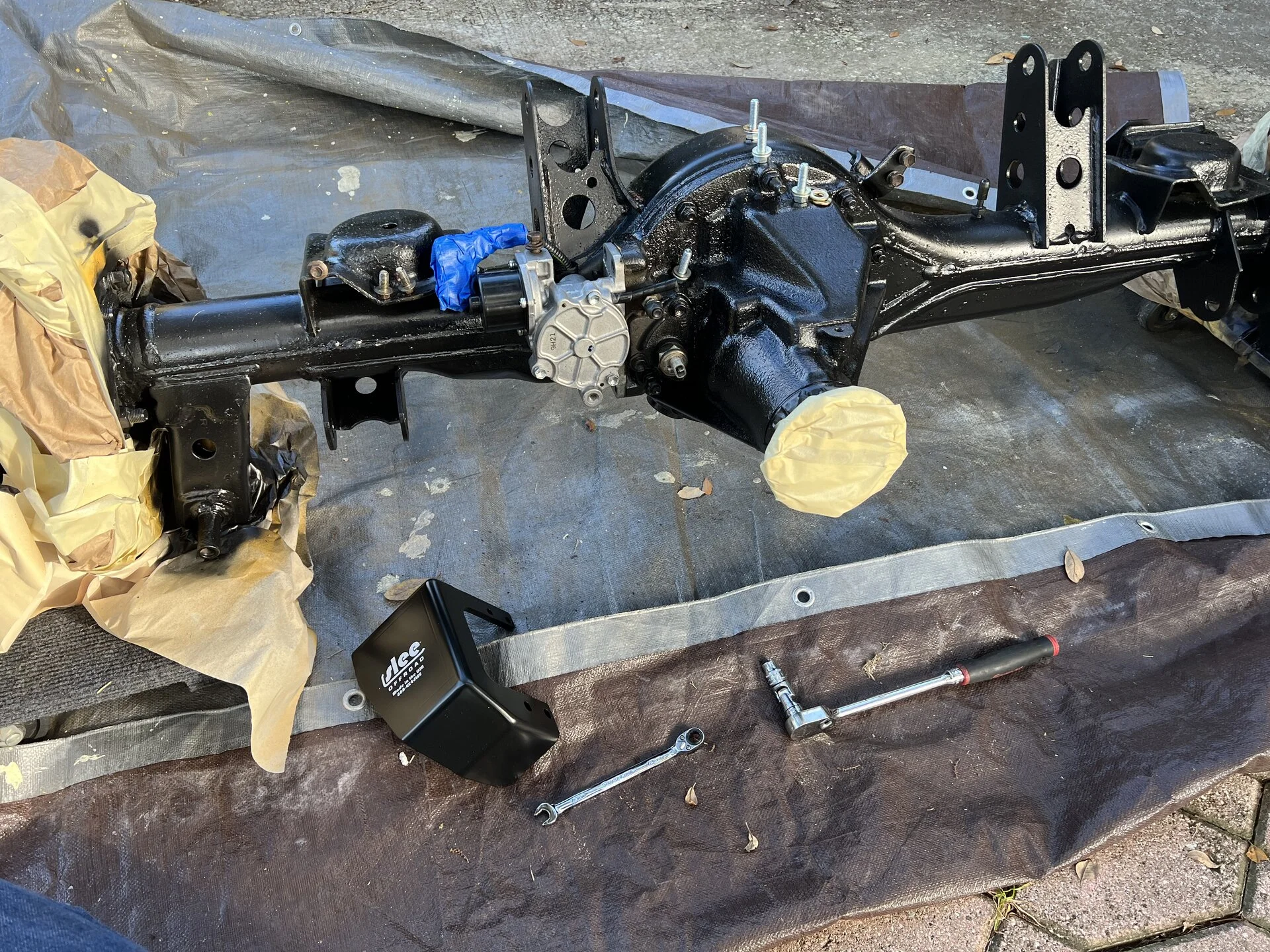

But if you buy the Slee locker guard - the hardware they supply is 4x 13mm tad bit longer bolts to mount the locker guard using the 4 holes. In this pic I had the 4 bolts from Slee on top of the housing

@ERG80 - to wrap this up and for google to bookmark for all eternity :
90105-08114 (10mm) has been superseded by 90105-08328 (12mm)

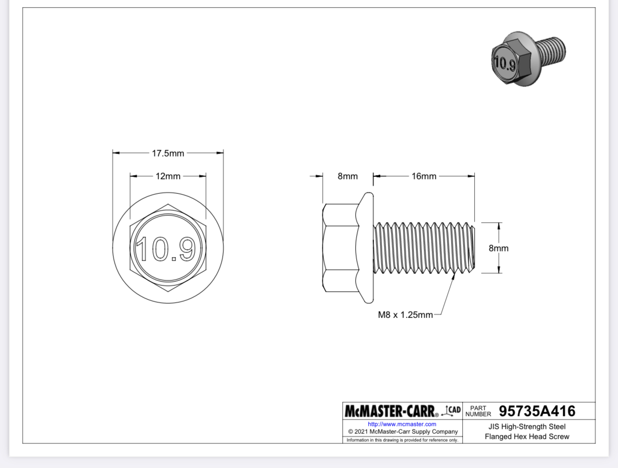

Bolts are 8mm,1.25 x 16 mm
With a 12mm wrench size 😉

So, you're saying the thread is unchanged with the superseded part? Just has a larger head?
The part number suggests 8mm thread I believe
90105-08328. Pretty sure 08 denotes 8mm

Looks like McMaster Carr has an option that fits those specs too.
