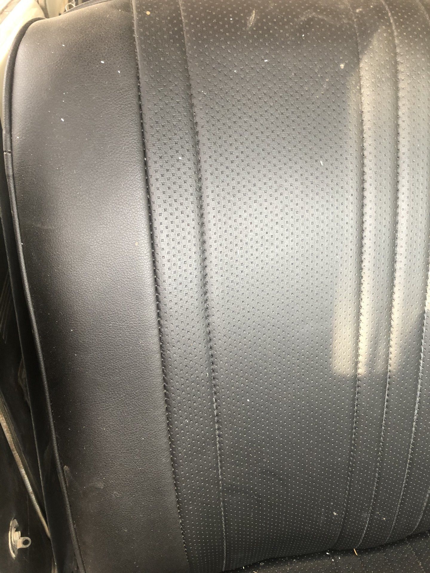

I hope this is a good image of my interior by popular request.

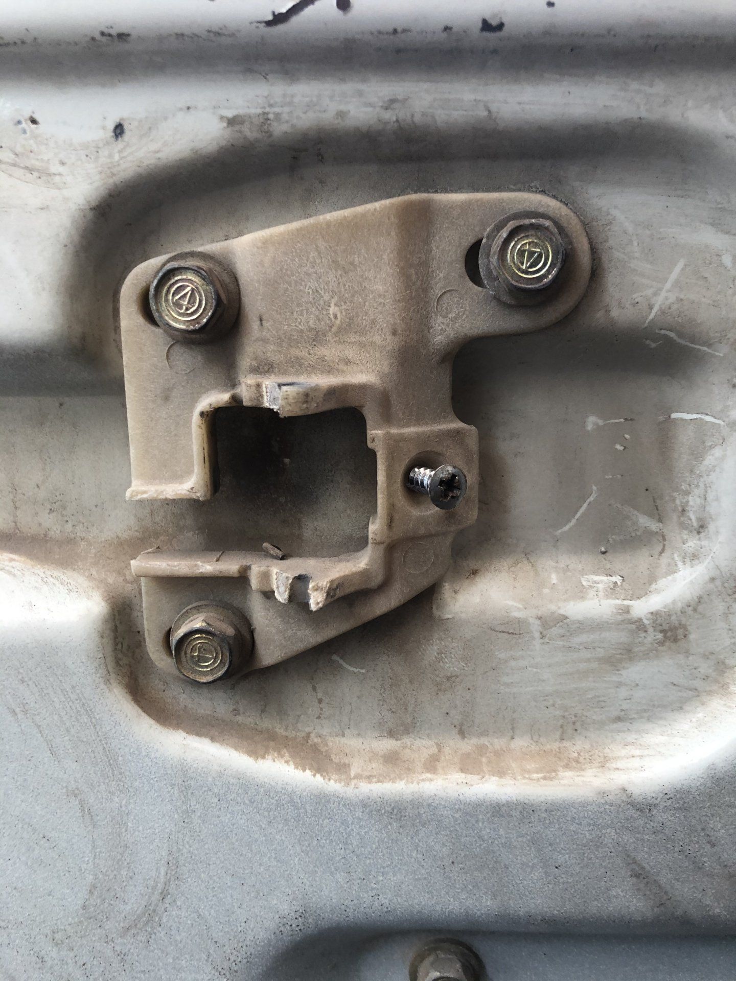

I gotta find a lead on this plastic handle holder driver side.

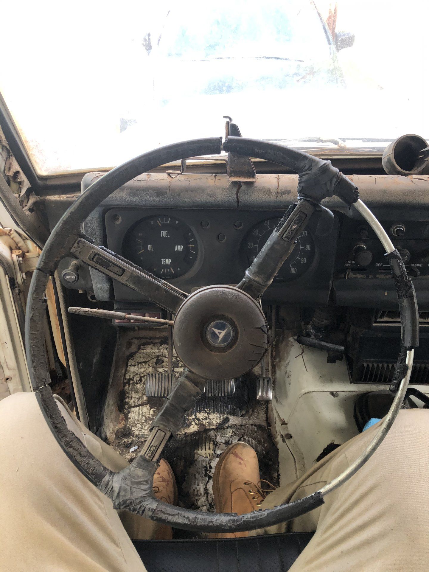

I believe this steering wheel will clean up real good after I apply some shoe-goo.

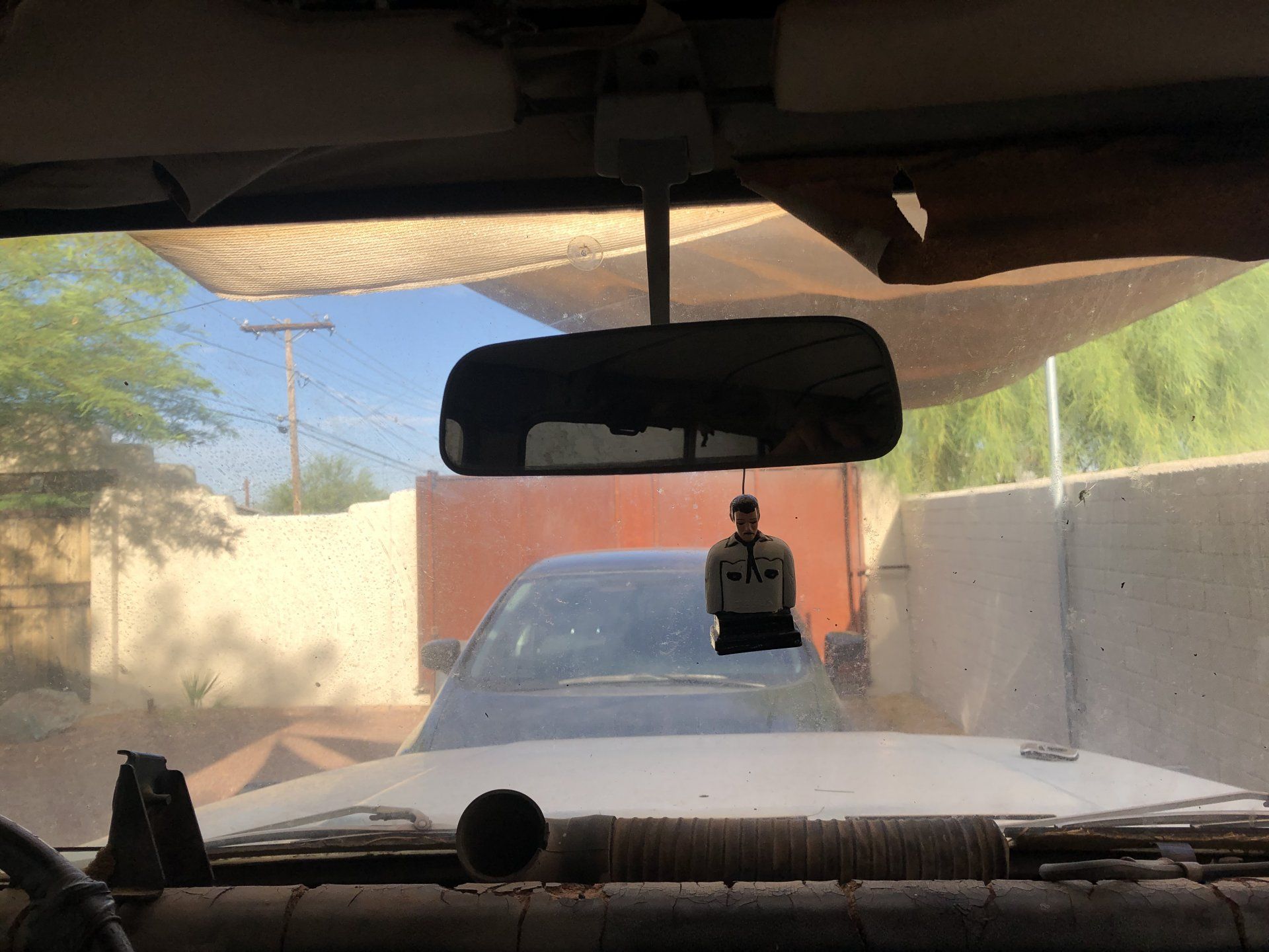

I also have this guardian angel to have my back at all times. Jesus Malverde is a folk hero in Mexico, known as a Robin Hood-type character and saint for narco traffickers. Although I am not currently a drug trafficker, Mexican iconography is very appealing me. Kind of like the eagle or the rebel flag, or whatever for Americans. It’s ironic that this 55 is actually border patrol colors, in essence. Mexican nationals call the border patrol “La Migra.” Maybe I can get a Migra vanity plate for this rig.
I’ve heard DEA folks say one “tell” when looking for drug couriers along our Interstate highways is a Jesus Malverde dashboard statue or hanging air freshener. Keep your lawyer’s phone number handy.

View attachment 2376696I gotta find a lead on this plastic handle holder driver side.View attachment 2376697
I believe this steering wheel will clean up real good after I apply some shoe-goo.View attachment 2376698
Guy on here was making plastic handle

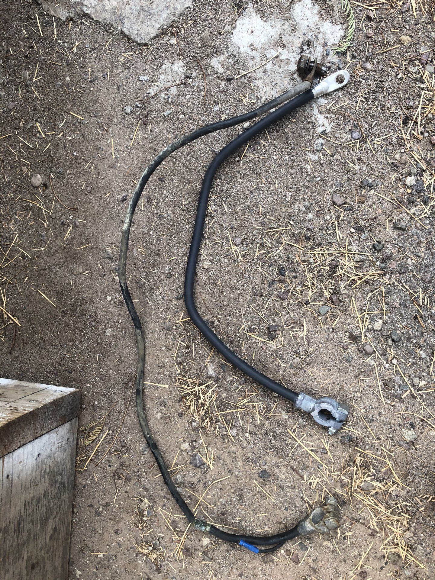

Rock Otto forgot the Vaseline when they put it in on these battry cables.

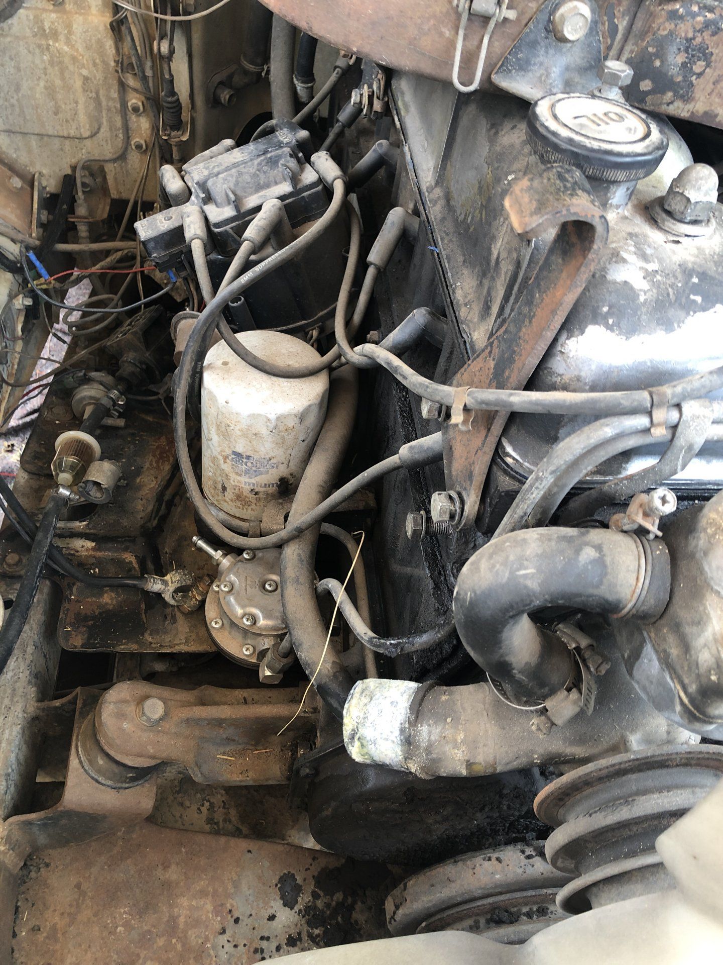

I guess from the original owner, they put a corvette distributor in this pig, which will likely stay put, because I’m a big fan of 80’s metal.

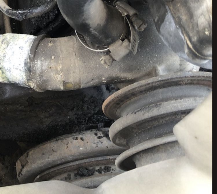

one thing thatI observed was a hose from the water pump being rigged up to this port. I guess this water pump was not meant to have an oil cooler, so the PO looped that hose straight to this port
