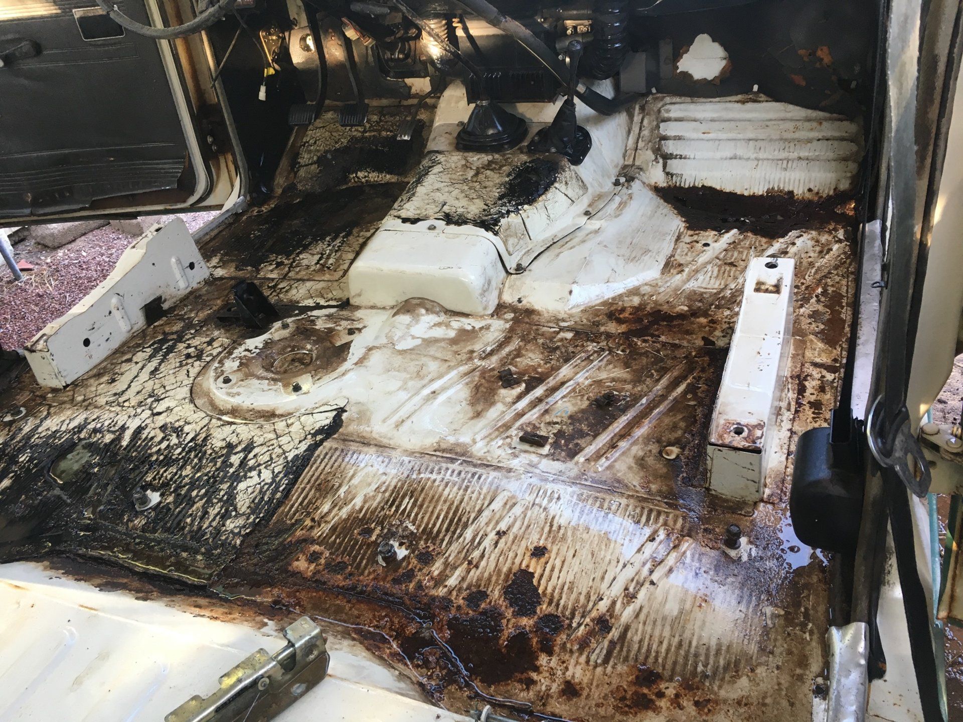

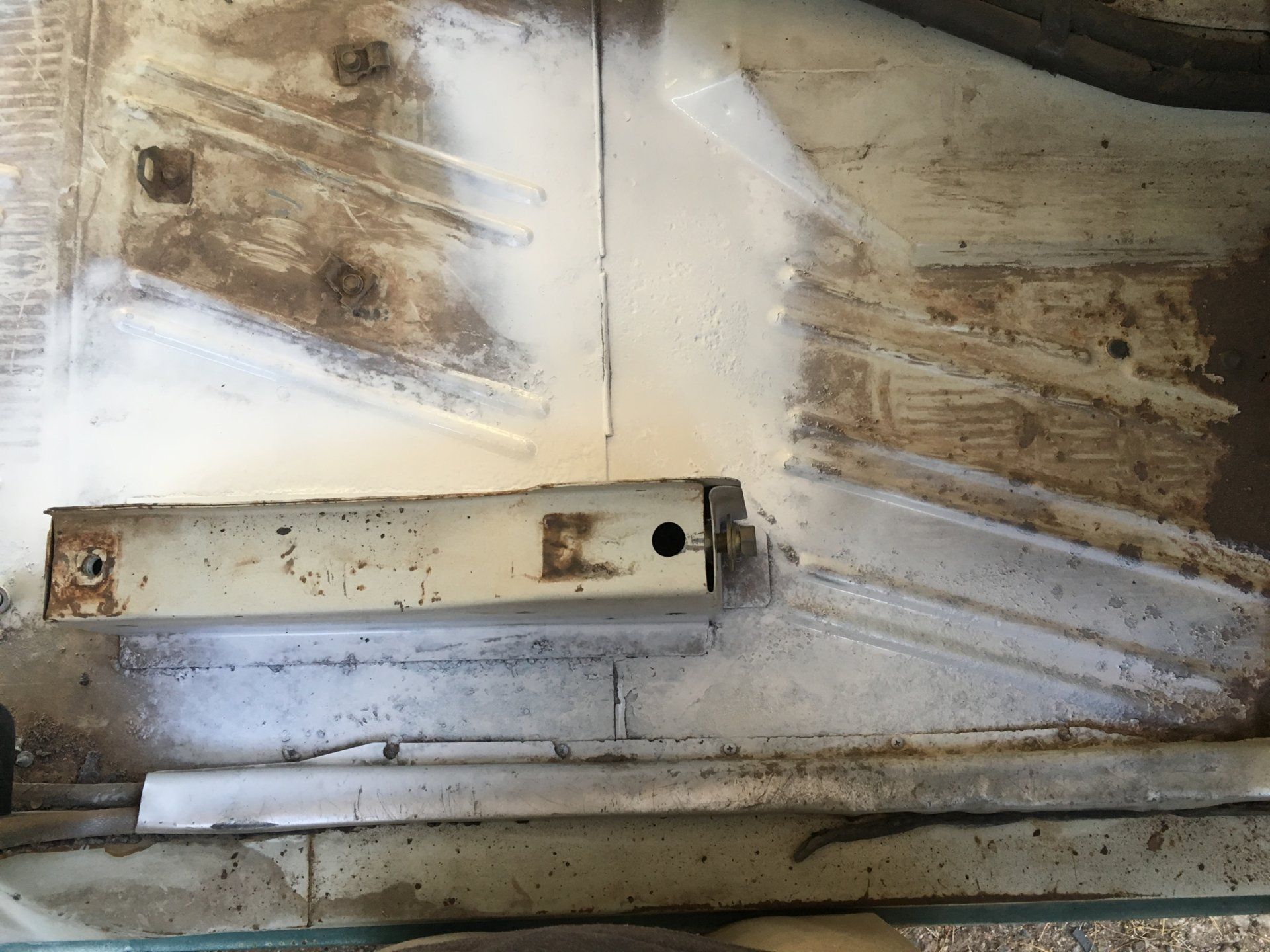

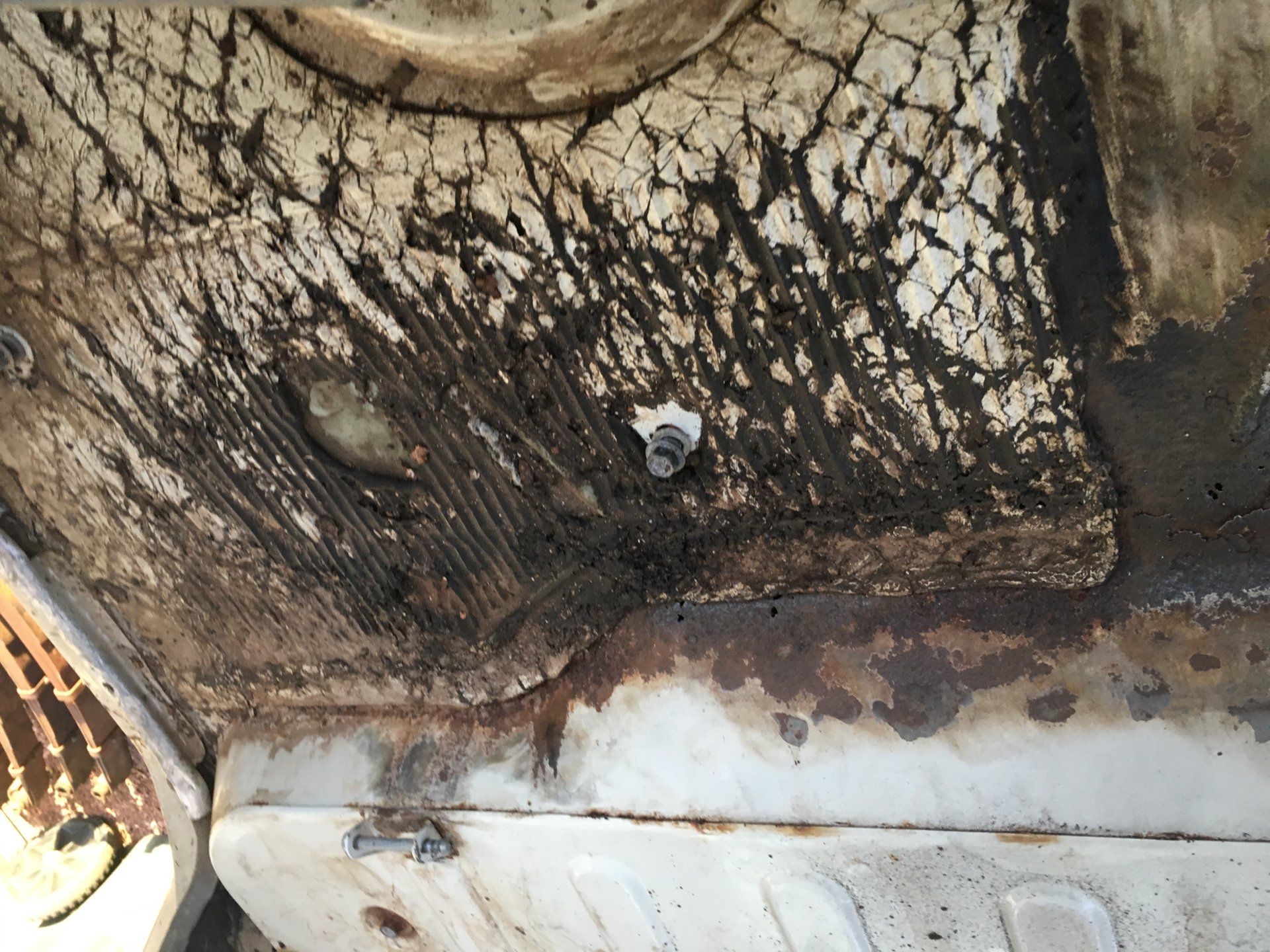

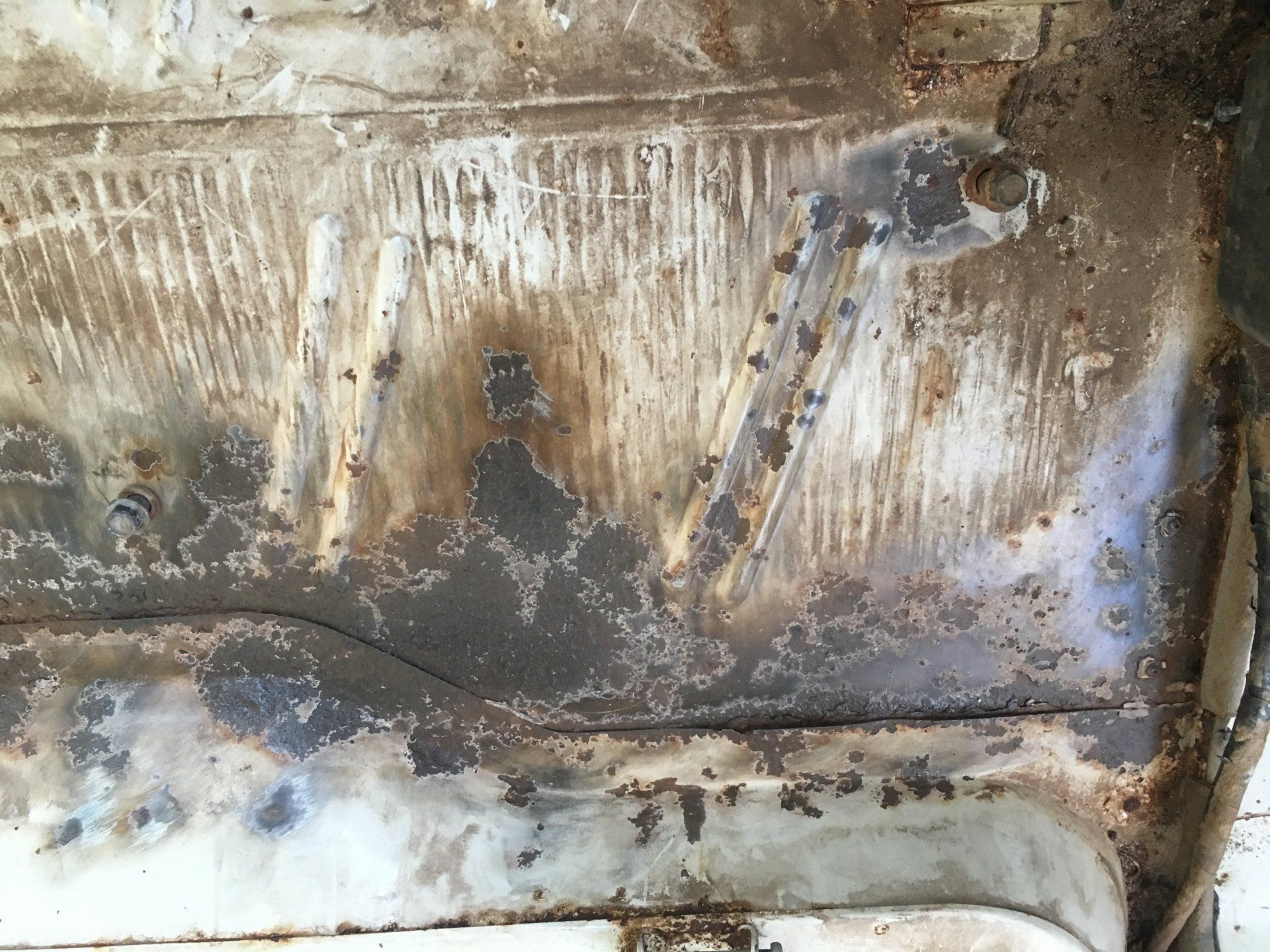

Today I bought a grinder to rip through some dope ass patiner in the cab. I feared grinding right through the truck and to the ground. I just didn’t know where to stop. It was surface rust on chip rust. Does anyone know where it ends? To not leave it vulnerable, I sprayed it with some white paint/primer combo I found lying around. There was some spots that rotted through, which concerns me; I might not win all those car show comps . Sad
Anyway, I hope I can do shackles when the bushings come in, since auto fab is not my strong suit. Actually, I have no strong suit. In anything. At all

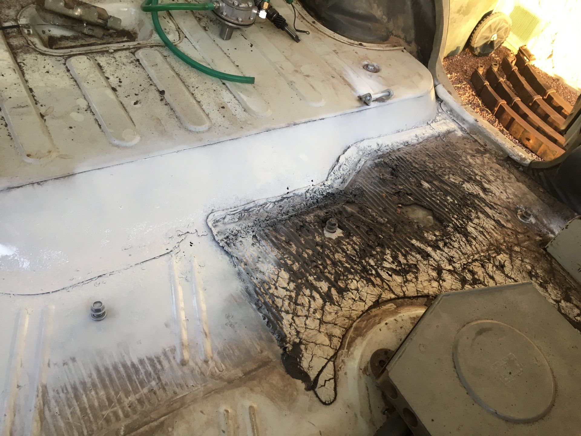

If you’re looking to have about the greatest time conceivable working on your Pig, you should break out some scrapers and screwdrivers and peel that tarry floor coating off! Don’t forget to spend some time (a lot of time) cleaning with soap and water and then a wipe down with lacquer thinner before painting. It’ll adhere better and last longer.
Man, I haven't been getting my notifications on my now favorite thread. To catch up, old wheels out back, new in front (sounds like the def for a mullet) would work as long as not a rotating need. That rust is minor I think. Do what @wngrog said and fluid film the crap out of it from here and the body will outlast you. My piggie is a '76, exactly what I wanted.
Haven't tried it but have heard dry ice makes the tar coating shatter with a light hammer blow
