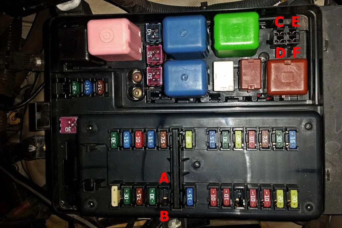

Troubleshooting instructions for newer UZJ100/LX470
Connect a wire from battery 12V post to the F terminal (see picture below), then try to start the engine. This kit will not help if the engine doesn't start with the above wire connection (assuming the battery is fully charged and good connection from battery to F terminal). This is the kit you need if the engine starts.

HELLO medtro,, I AM TEMPORARY RUNNING THE CABLE FROM BATTERY WITH TOGGLE SWITCH SO BATTERY DOESNT DRAIN AND CAR STARTS WITH NO PROBLEM..I ORDERED AND RECEIVED YOUR RELAY KIT AND INSTALLED IT CORRECTLY AND CAR WONT START... WENT BACK TO THE DIRECT CABLE CONNECTION AND CAR STARTS,, YOU THINK THE RELAY ON YOUR KIT IS DEFECTIVE?? ANY TROUBLESHOOTING TIPS???..I WELCOME YOUR REPLY
The kit was bench tested numeral times. It is possible that the relay was damaged during shipping. It is also possible that you may have connection issues. I will send you some instructions to trouble shoot this.
