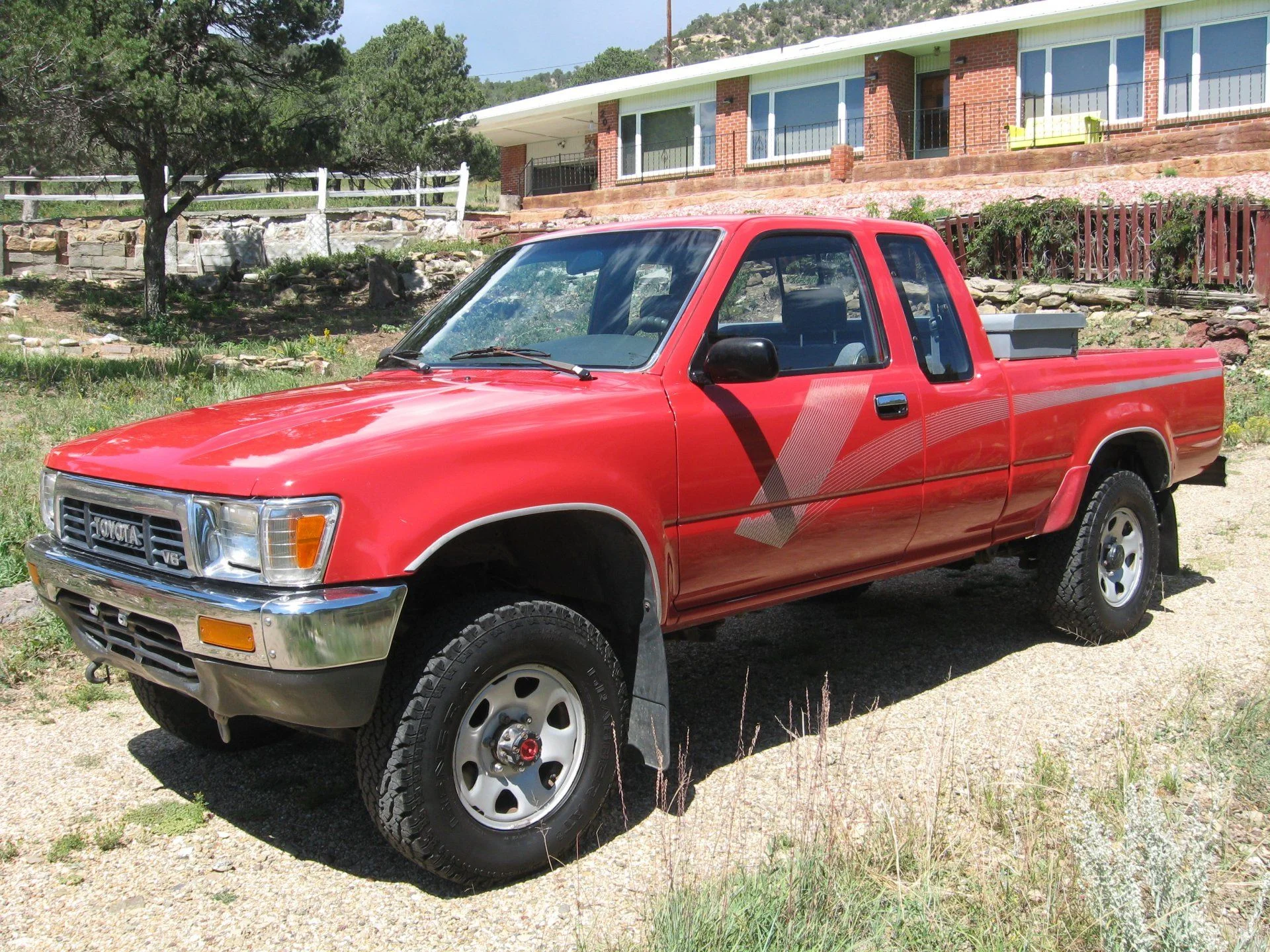

89 pickup with later Tacoma steel wheels (year unknown). No spacer, no rub, no bother.

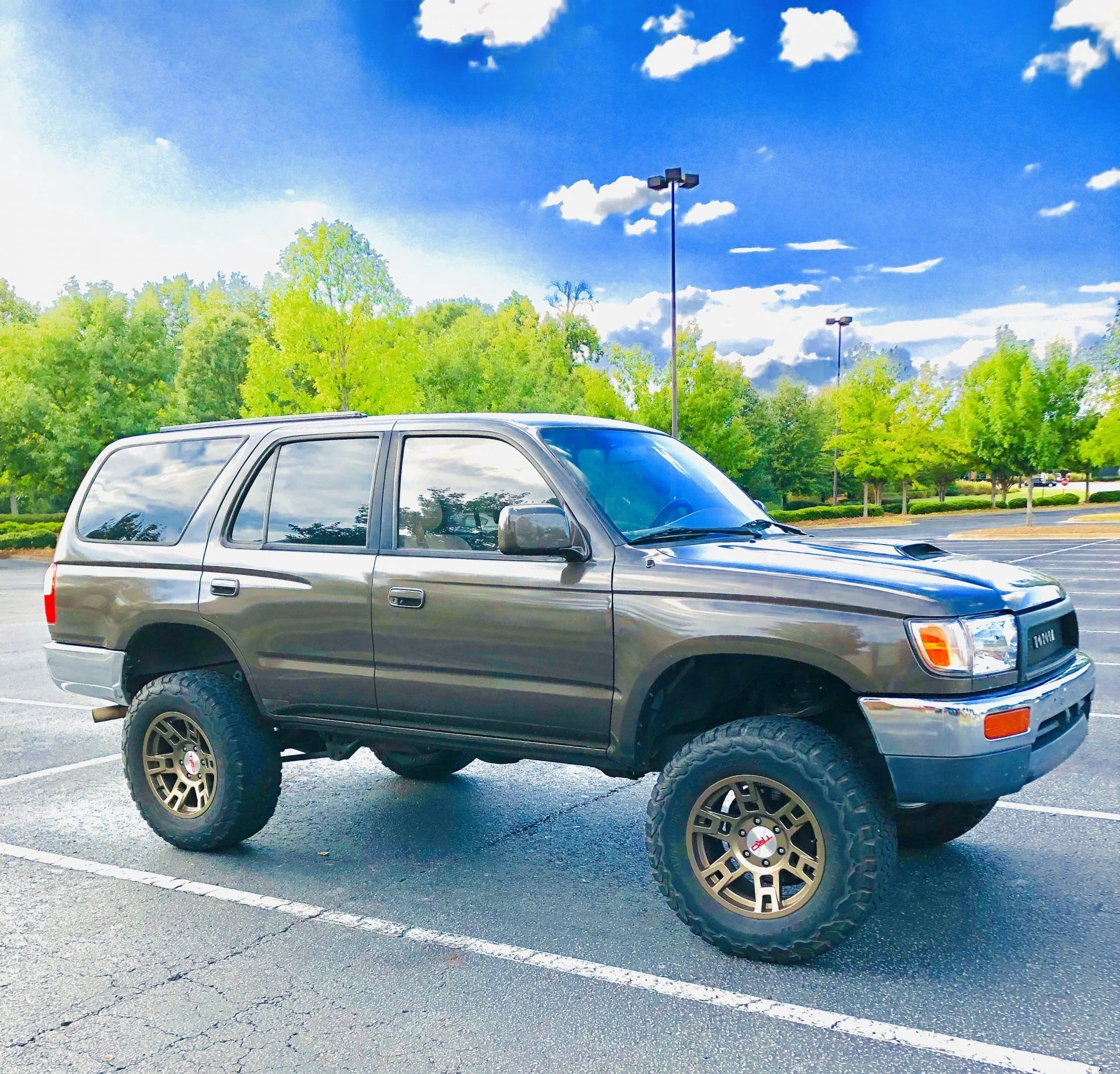

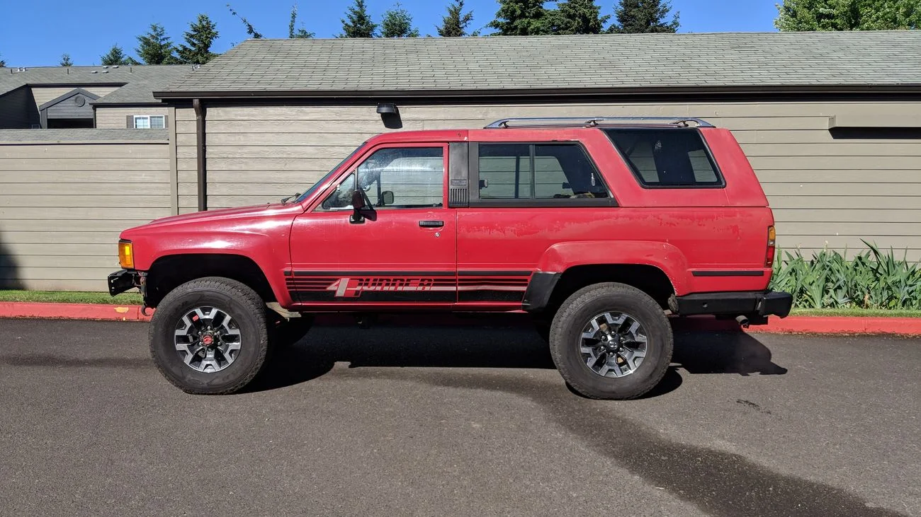

2017 TRD Tacoma Wheels on 1986 IFS 4runner
Old post but worth a try. What rim and tire size was this? Tacoma rims seem to have 16, 17, and 18 now.

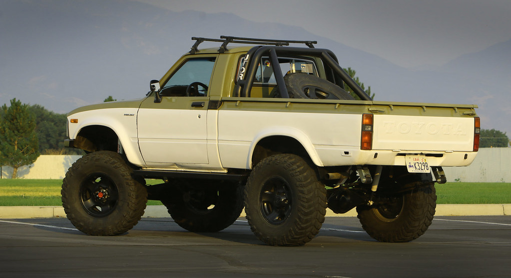

Didn't see this combo, but still think it's one of the best. This was my first Runner that goat stolen last year. PO told me they were rare factory black TRD wheels, but I think he was FOS. Never the, less, the looked great.

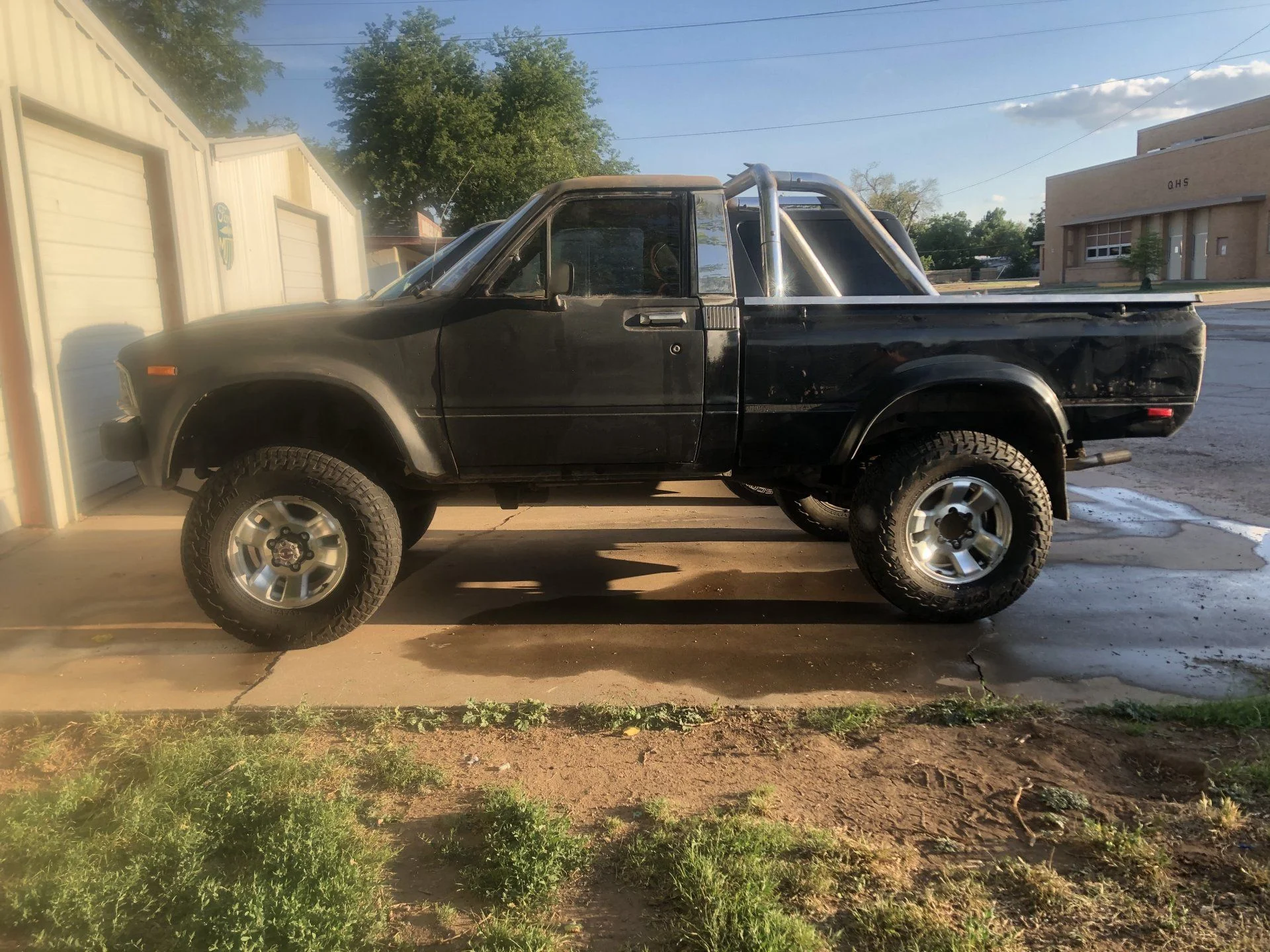

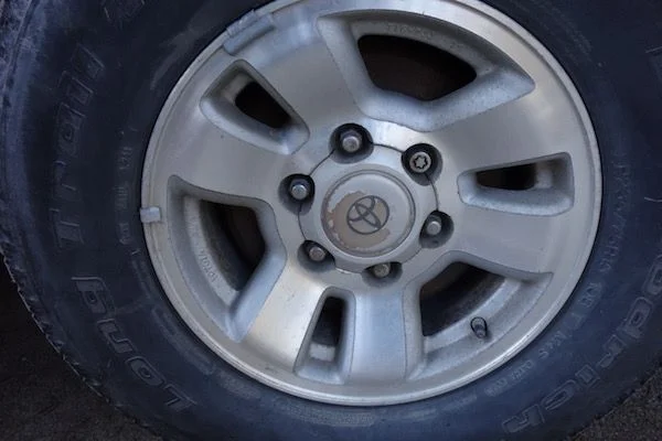

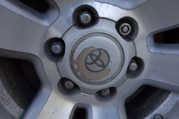

I just went to buy new tires and was told that I'm using the wrong nuts on the alloy rims! First I've heard this since I bought my truck in 2007. I have a 1998 Toyota Tacoma EXTRA CAB SR-5 3.4L M/T 4WD. The charts say I need OEM Part Number: PTR2734060. Advance Auto Parts says I need Dorman Chrome Acorn nut #711-301. Any suggestions out there for good aftermarket lug nuts for my truck tires (pictured)?
You could go to a dealership and ask them to show you the proper nut for those wheels. I rarely take for granted anything tire store people tell me.
Good info. I just took off one of the wheels and will check the holes tomorrow. Thanks. And trip to the dealership is in order!
