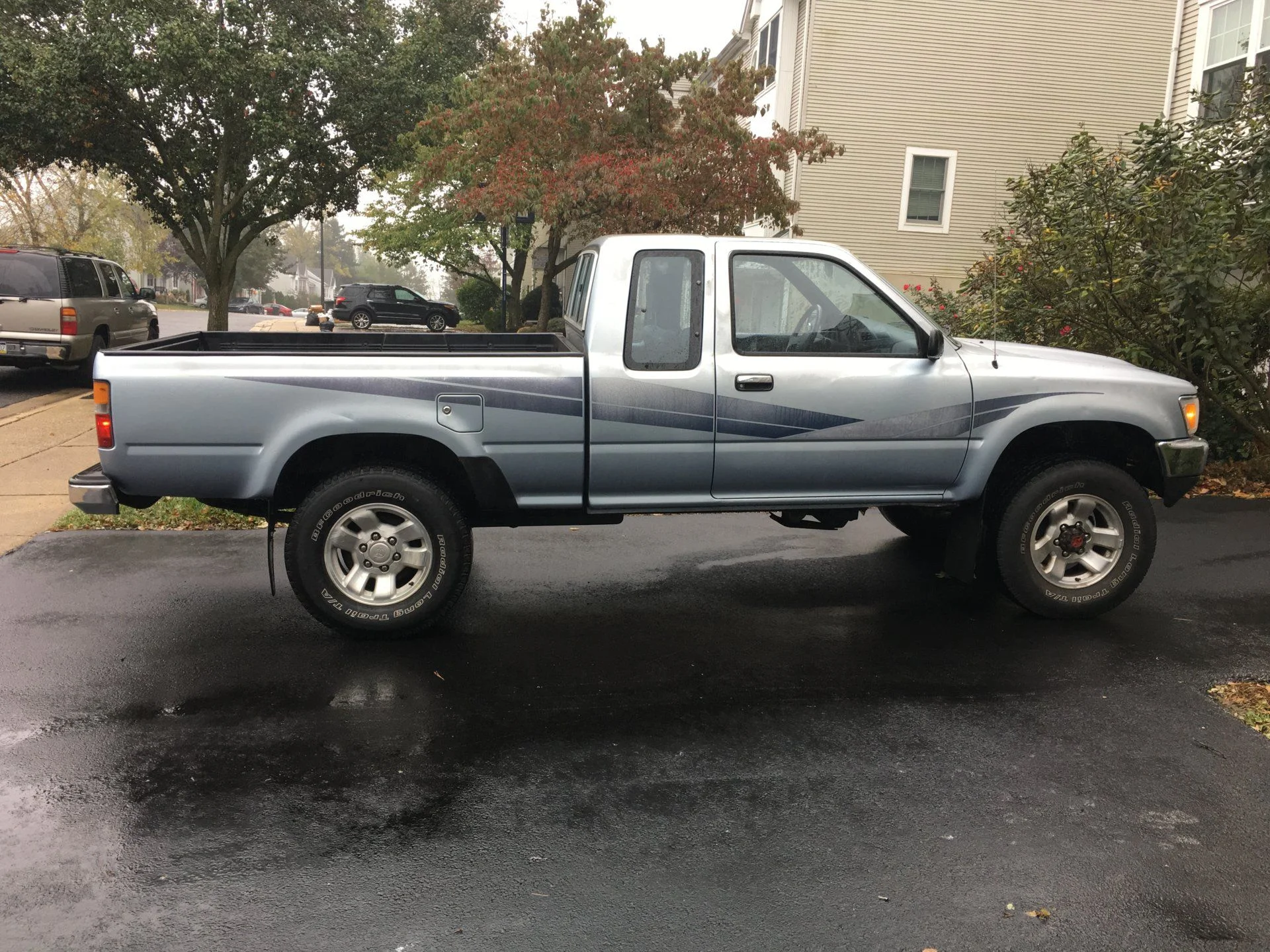

Looking to add these wheels to my 90 SR5 extended cab pickup, my mechanic says they require special lugs with a longer or deeper shoulder? Has anyone else run into this issue?

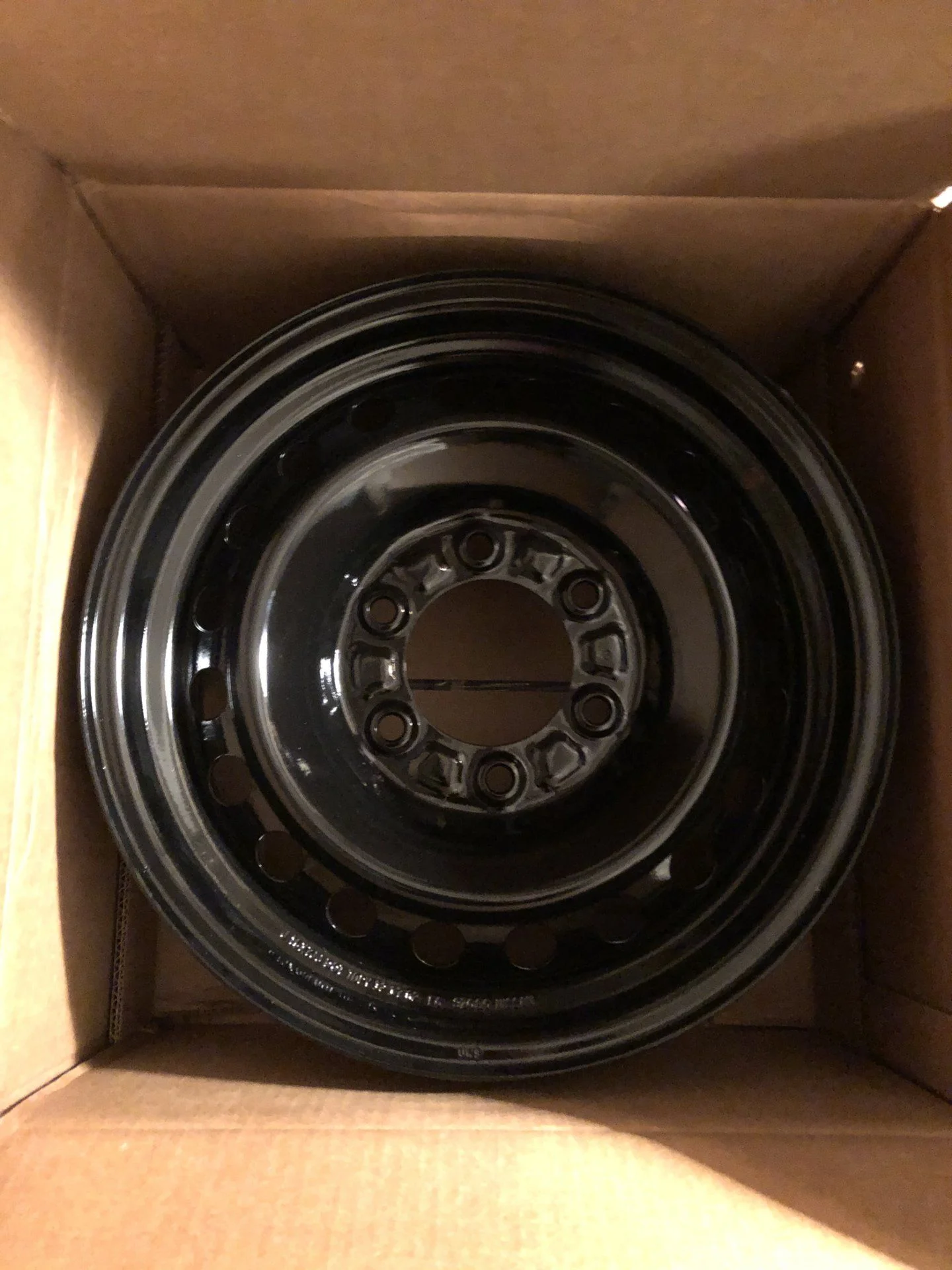

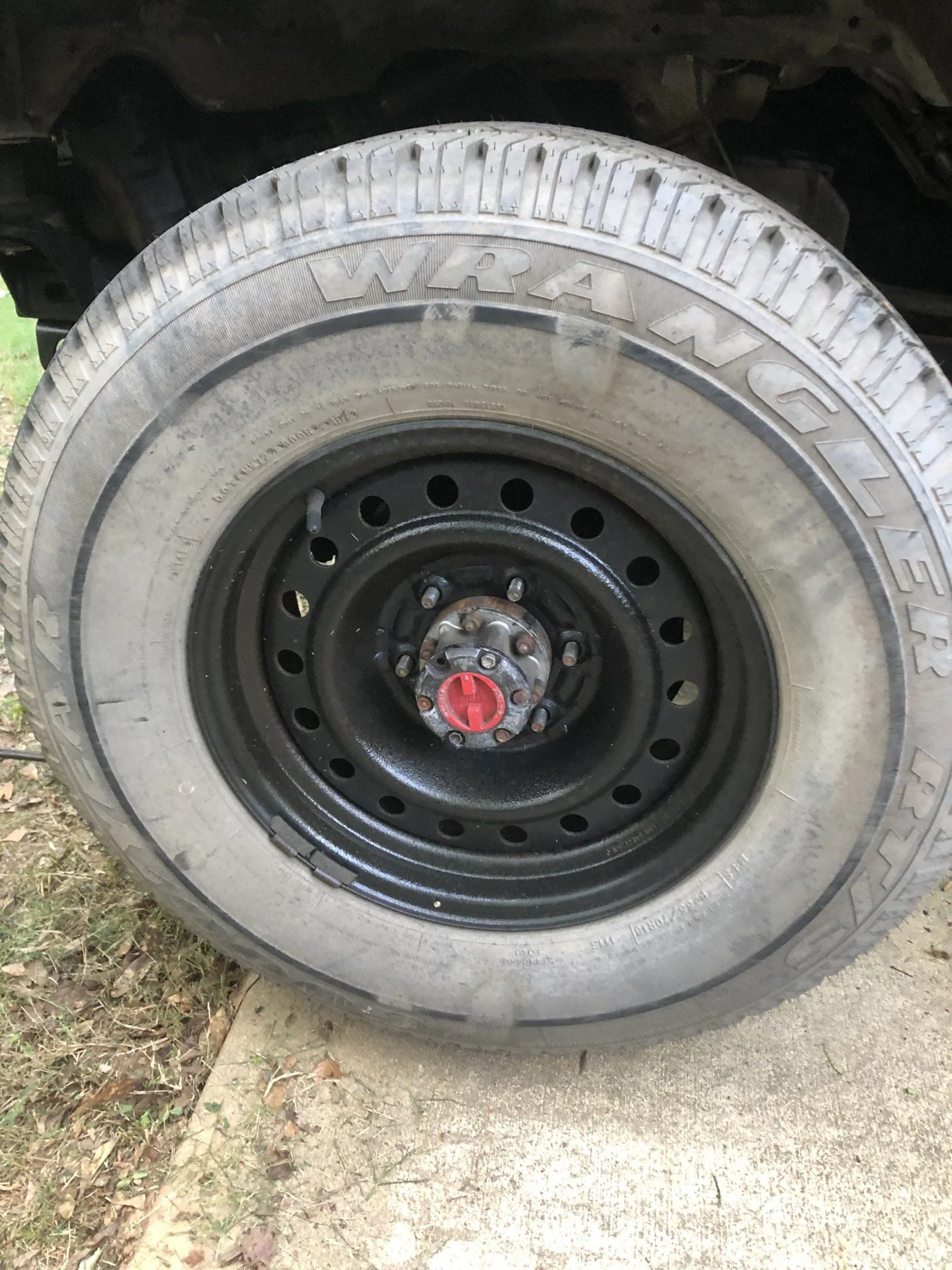

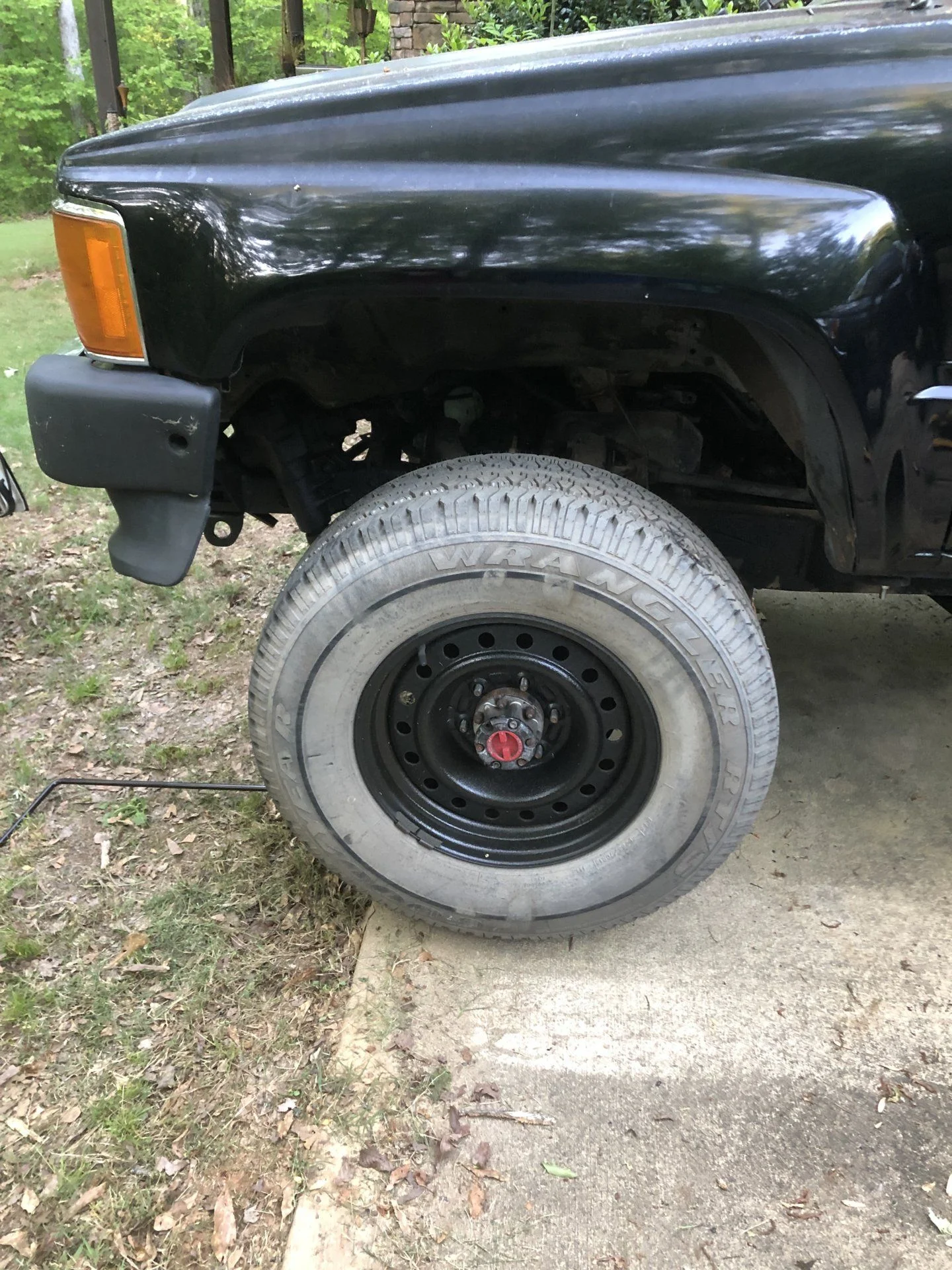

I can tell you that this 16” Toyota steel wheel (used as spare on 3rd Gen 4Runners and Tacomas of same vintage) DOES NOT fit on the front or back of a stock 1989 (first gen) 4Runner. Center bore is too small. The similar-look 17” steelie from the FJ Cruiser fit fine. This 16” would need a 2” spacer in front and a 1” spacer rear.
This 16” steel Wheel has the same issue, and also suffers from being the most hideous wheel Toyota ever made.

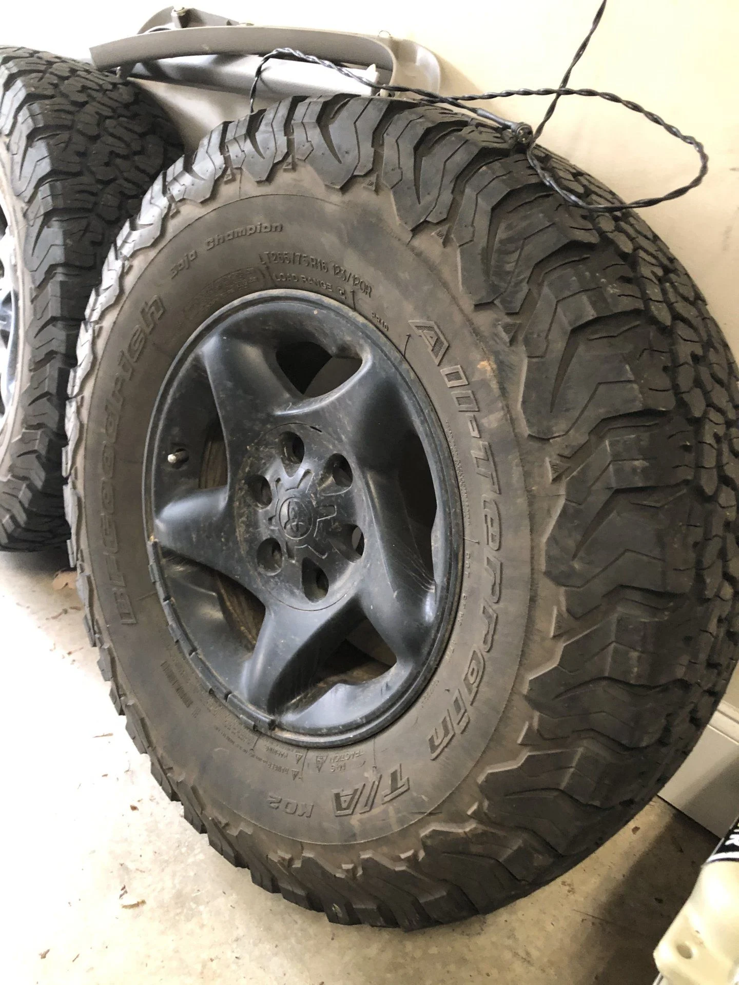

Still running the 15” OEM Land Cruiser (disc brake) Steel wheels with 31x10.50r15 as per below. I own the BFGs above and want a direct-fit 16” OE-looking steelie for them.

I can tell you that this 16” Toyota steel wheel (used as spare on 3rd Gen 4Runners and Tacomas of same vintage) DOES NOT fit on the front or back of a stock 1989 (first gen) 4Runner. Center bore is too small. The similar-look 17” steelie from the FJ Cruiser fit fine. This 16” would need a 2” spacer in front and a 1” spacer rear.View attachment 2265732
This 16” steel Wheel has the same issue, and also suffers from being the most hideous wheel Toyota ever made.View attachment 2265735

Always thought the same. Bought the BFGs on the directionals without a second thought. Bought the 16” steel wheel in the box without a second thought. Was shocked when neither would fit over the front Aisins or even over the small center of the rear.
Three of us were test fitting. Neither worked. Tried a 1” spacer on front...no joy.
The Land Cruiser and FJ Cruiser wheels fit fine. 🤷‍♂️
I’d guess the SFA front Aisin hubs are smaller in diameter than the IFS Aisins, but I don’t know that to be fact.

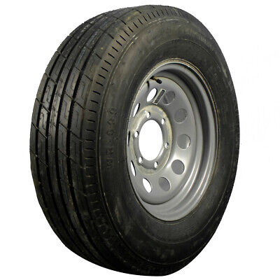

Finding a set of alloy wheels that I like in 16X6, 16X7, 17X6, or 17X7 with appropriate offset has been nearly impossible. There are a couple OEM 16X7's & 17X7.5's that I can tolerate, but for what they're asking for those I want to like them a lot more before spending that much. Lately I've been looking at trailer wheels. 16X6's in 6 x 5.5 are everywhere within that realm and they reportedlyall have a 4.25"-ish center hole. Most have a 0mm offset, which I haven't yet modeled but I think will work given the taller tire. Just need to find some that I like that will look period correct.
So confused. I mounted the spare 16” from under my 1998 4Runner and it fits like a glove on my 1989 4Runner. It seems identical to the wheel that failed to mount a few posts above...difference is the center bore is just over 4” where the new wheel (in the box) has a center bore just under 4”.
Anyone have any idea why there is a difference!?
Design change that came late. Made the hole smaller since late trucks no longer have a wheel hub that they need to fit over. Does Mr. T denote the part rev level in their part numbers? If so you should be able to figure out which revision you need.
