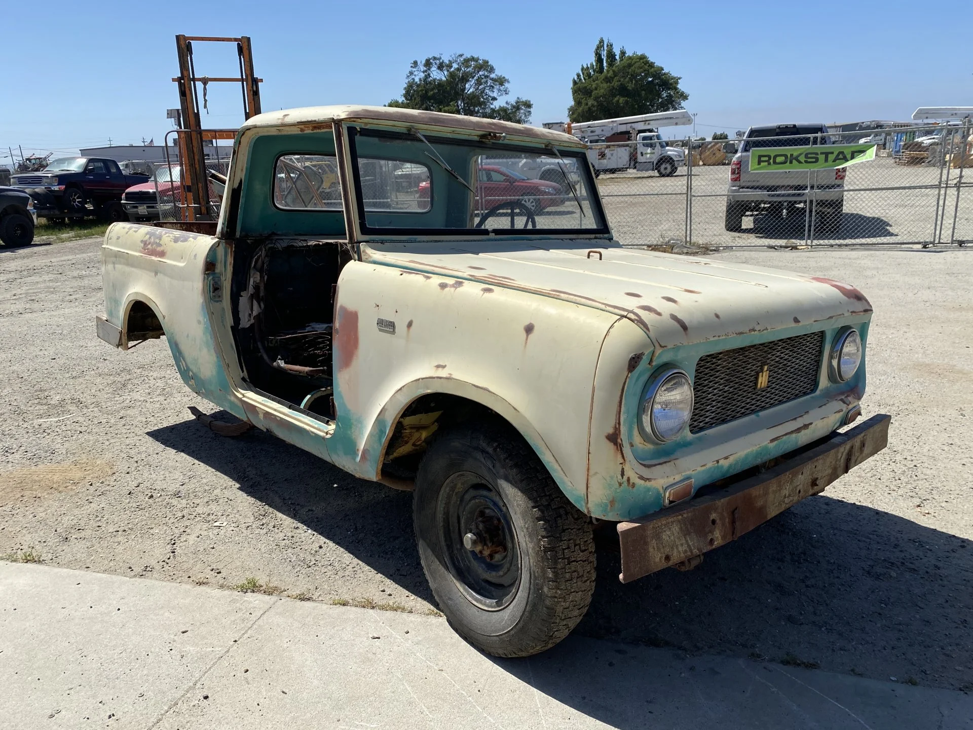

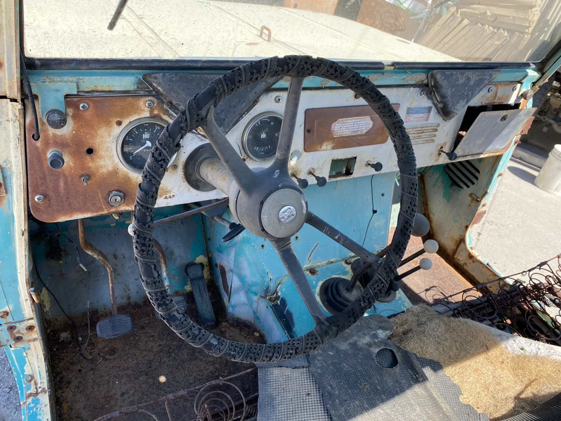

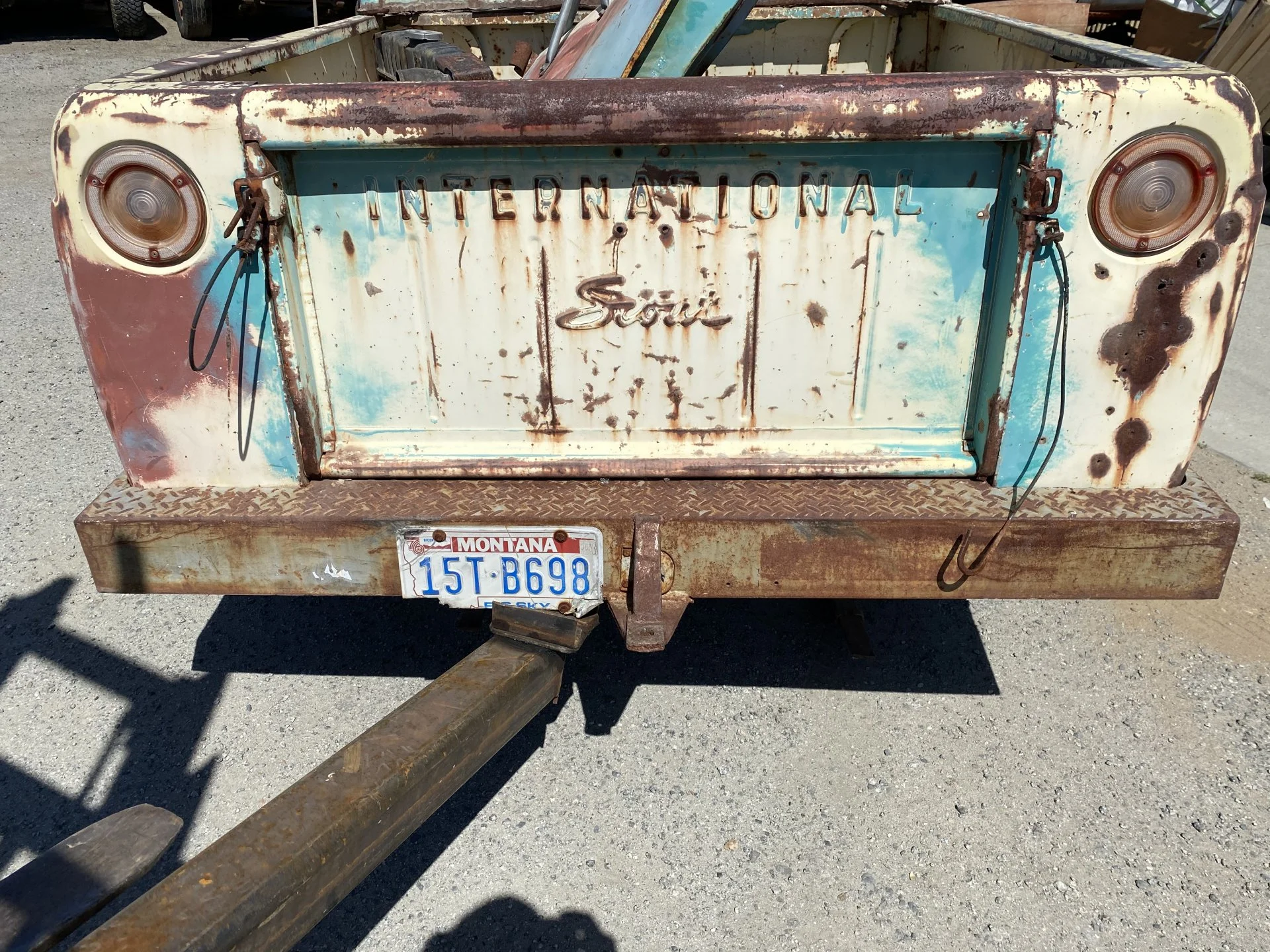

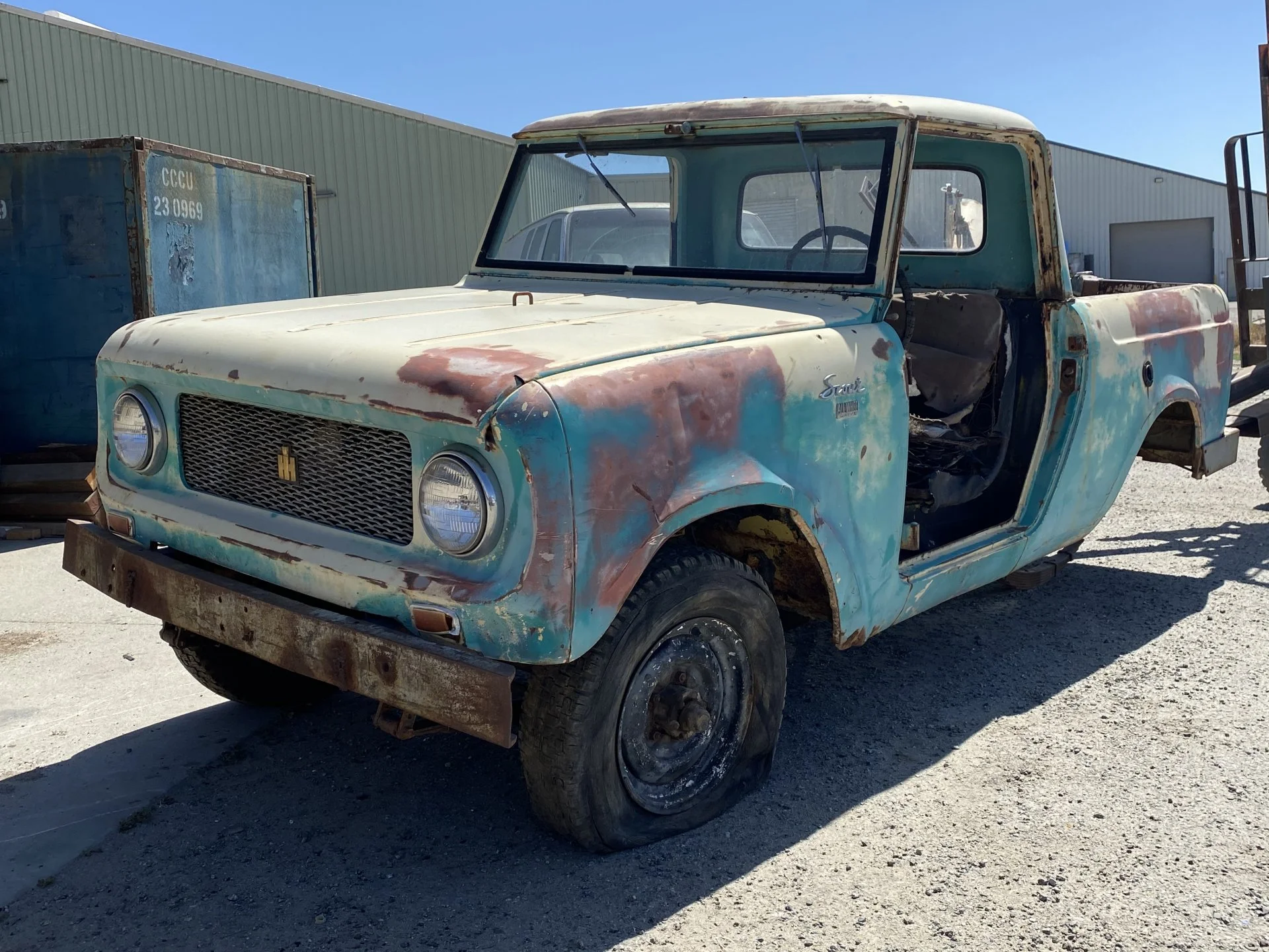

Mark, at least it's not a Jeep! 1965 Scout80 that is getting FJ60 axles, a 4.3/H42/splitcase. It is getting CJ leaf springs though! Should be a unique little ride, I've always had a eye for the half cabs, and I paid as much for this Scout as one would pay for a bag of bolt off of an FJ45. There is a reason Landcruisers of the same era are more sought after than Scouts, they are twice the rig a Scout is on every level. So much more robust.
Sorry for the de-rail @Birdhead

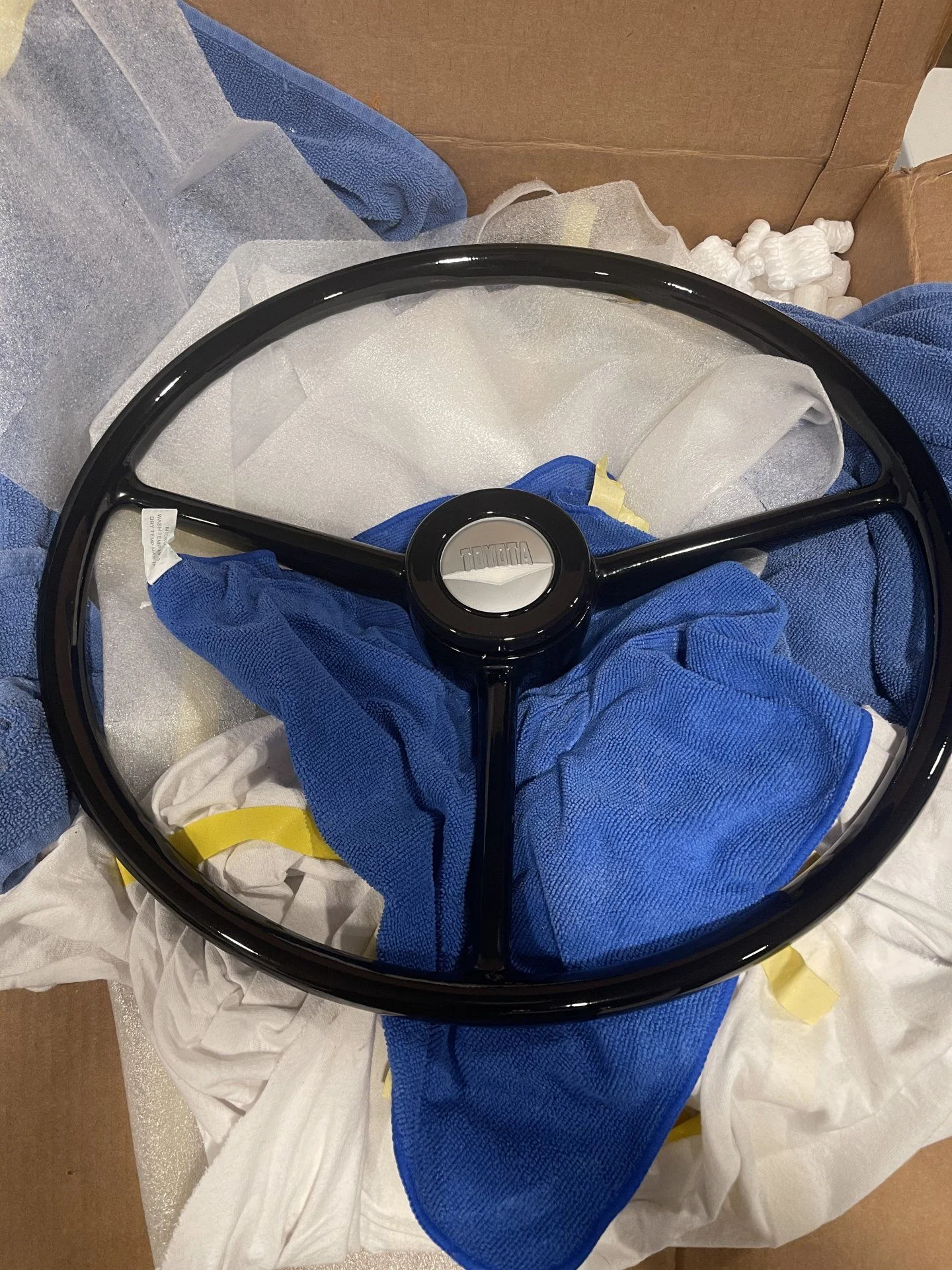

So, there’s a pic of the steering wheel! Wadda ya know.😉
