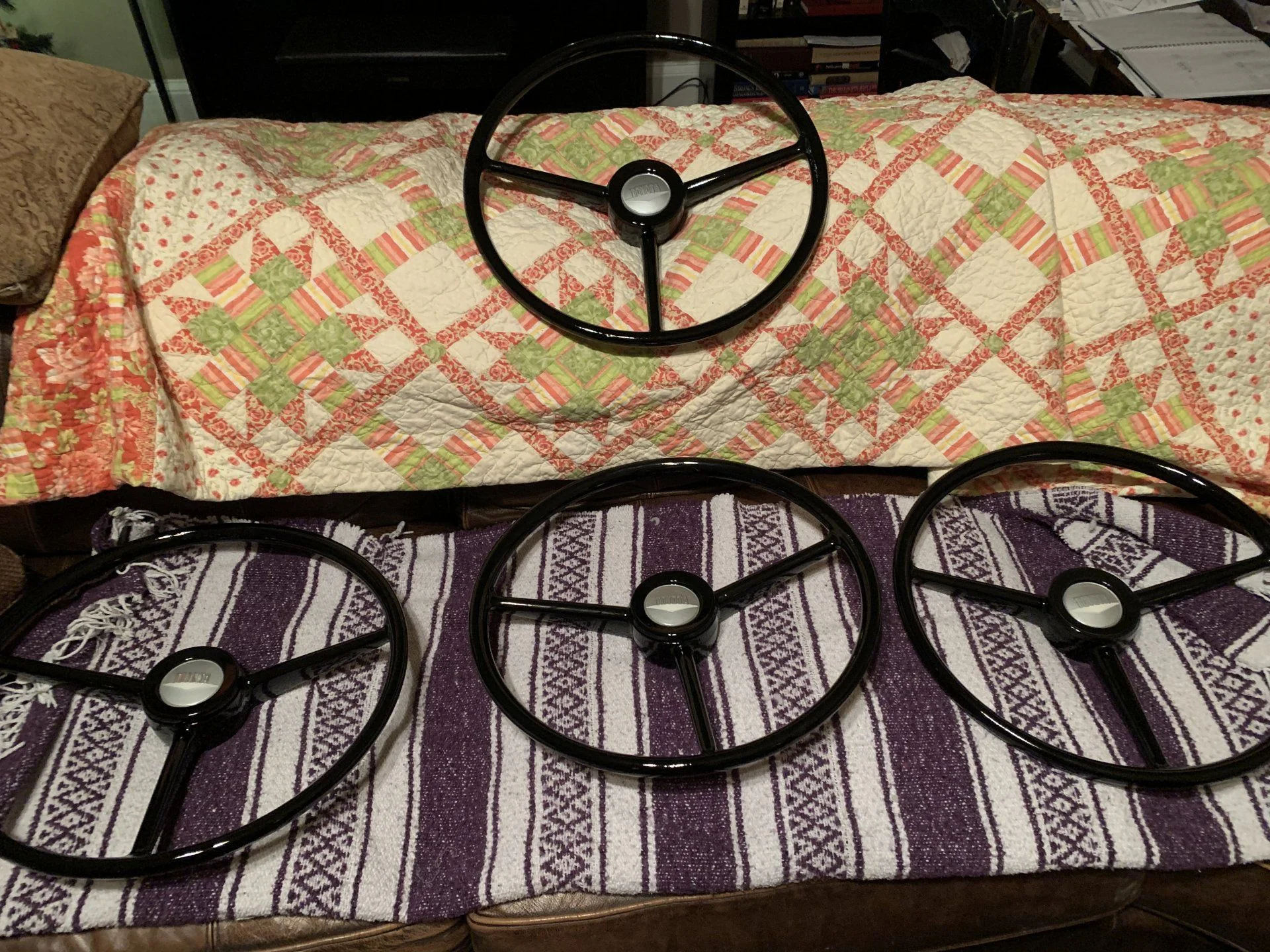

I’m finishing a batch this week if your wheel needs work, call/text and Leave a message if I don’t answer. Here’s the latest.
Just finished a batch for a customer, I’ll have two or three finished this week if anyone is interested.

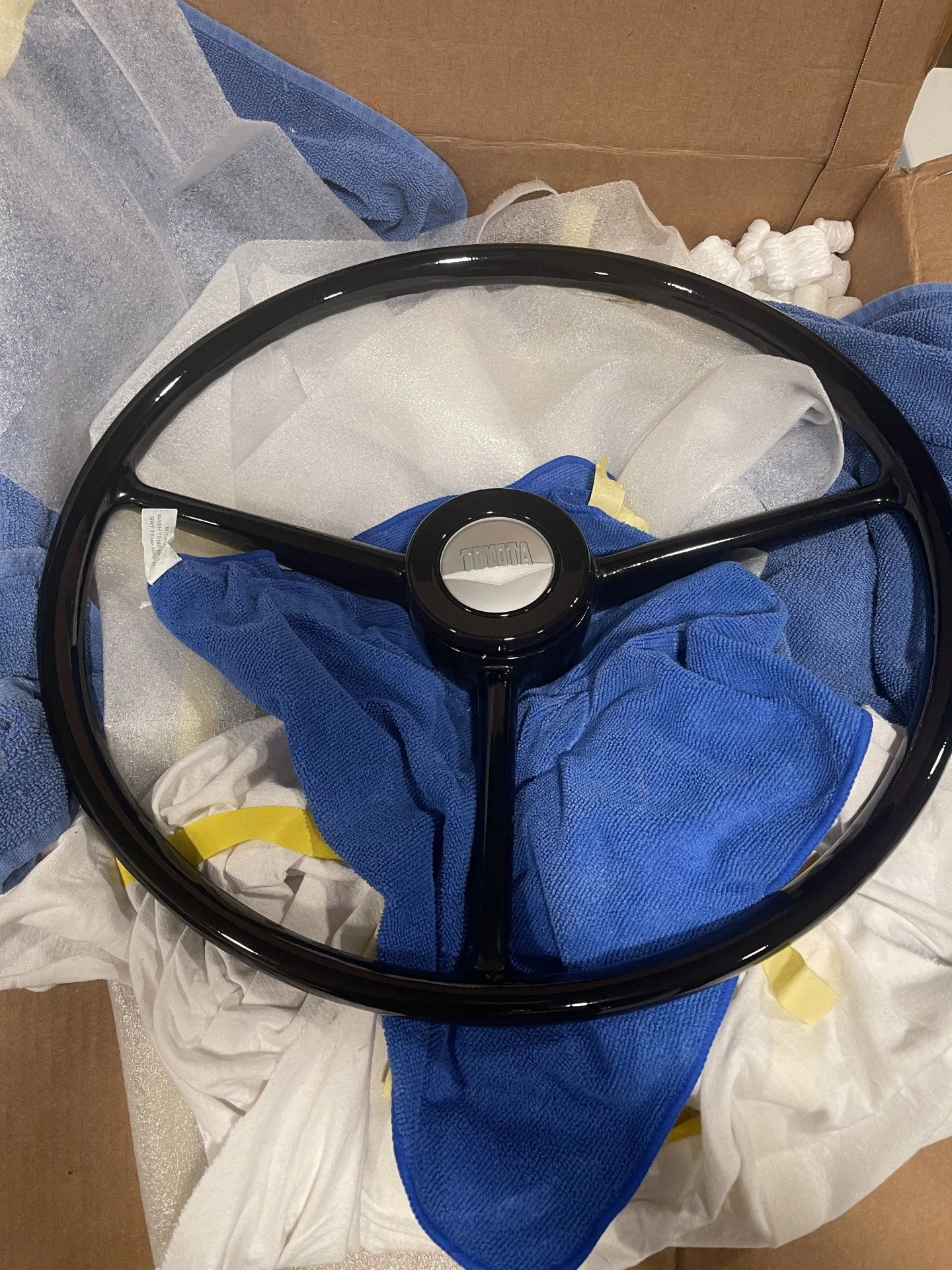

Just waxed it, packed it and it will ship tomorrow. I think you’ll be very happy!

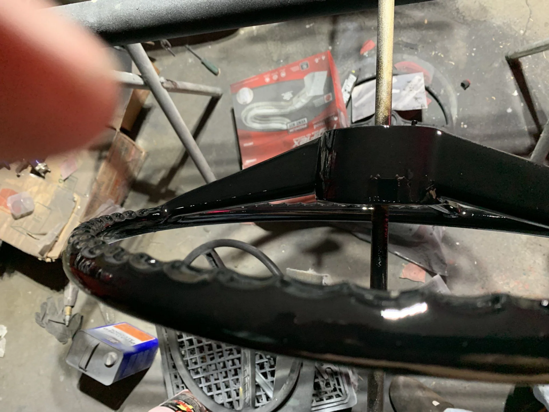

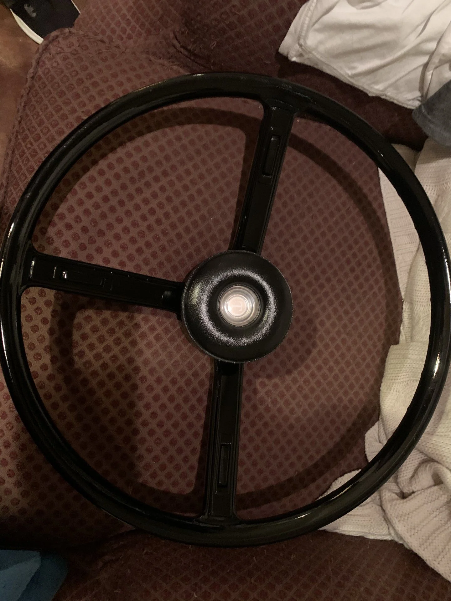

If you have a cracked 72 and earlier steering wheel and want it restored, I'm on my 4th now my avitar is my second one. You pay shipping both ways and I'll have it done in two weeks. I would like to do two more and I think I will have it mastered. So if you want me to restore yours just get in touch. I use PC-7 epoxy to repair the cracks it tolerates heat & cold (expansion & contraction) best and hours of sanding with up to 2500 grit paper. If you want more pics of my work contact me.
