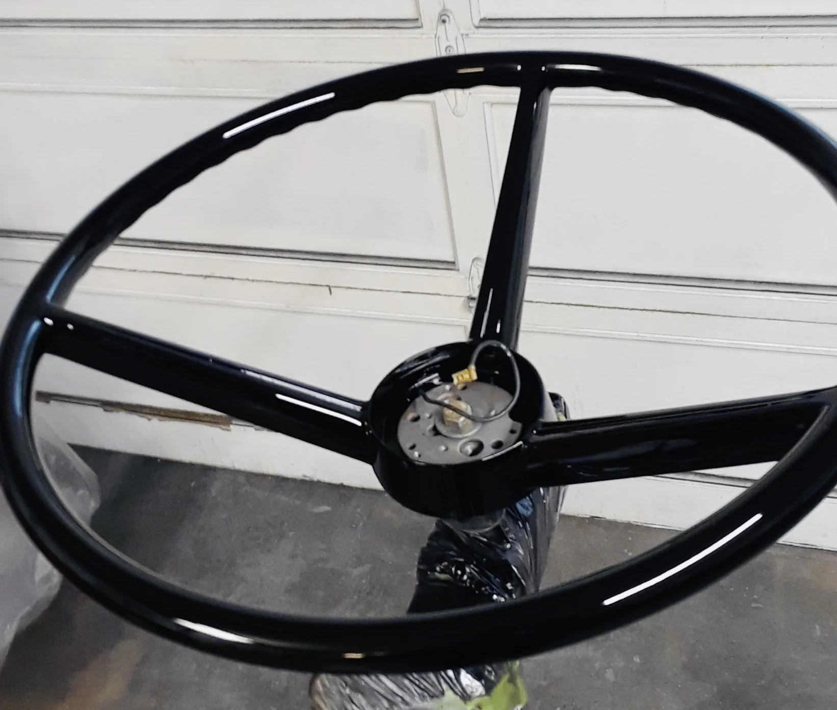

Early fj steering wheel restoration
What’s wrong w/ this picture?
And it doesn’t include the horn button!

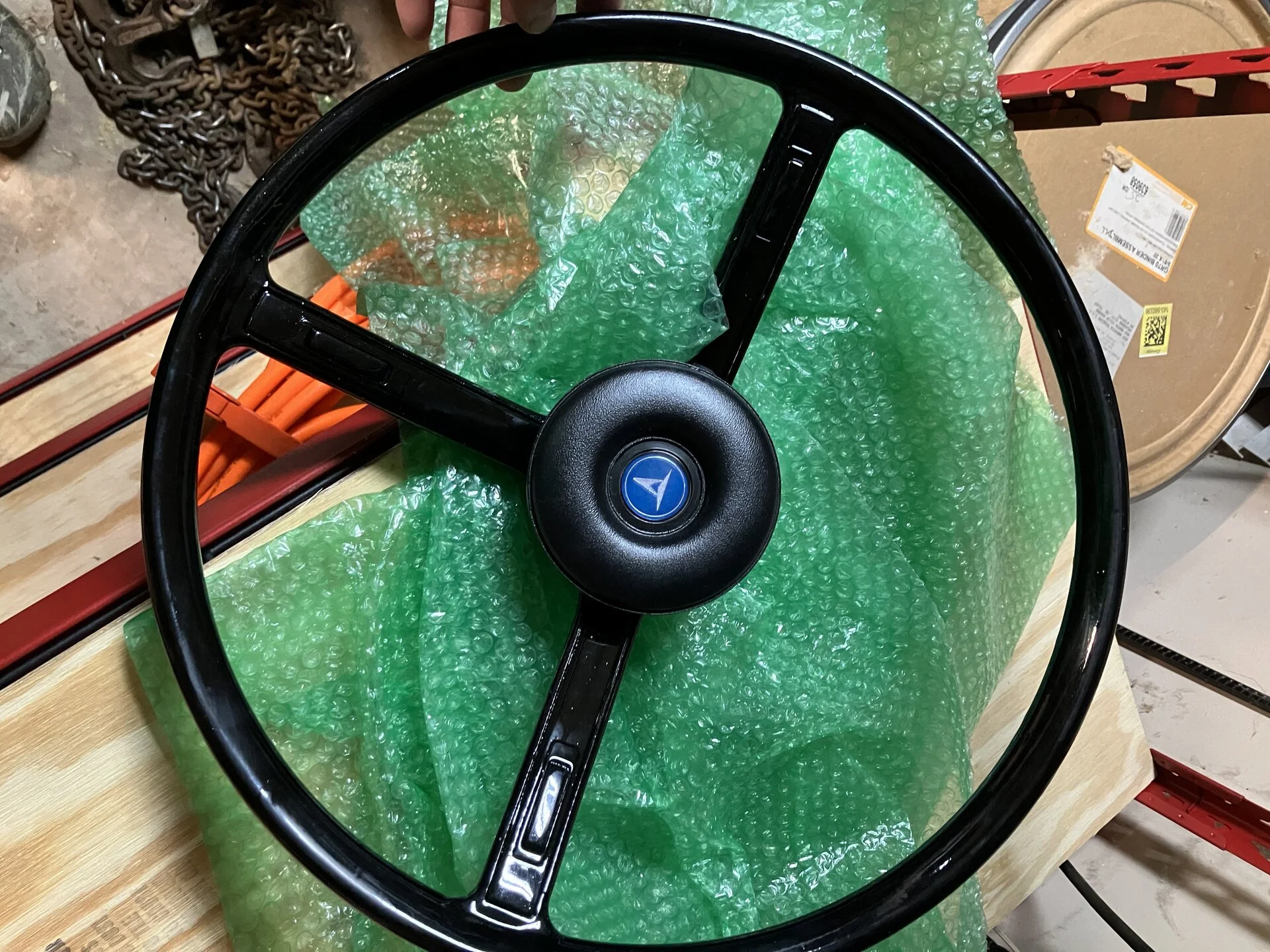

If you have a cracked 72 and earlier steering wheel and want it restored, I'm on my 4th now my avitar is my second one. You pay shipping both ways and I'll have it done in two weeks. I would like to do two more and I think I will have it mastered. So if you want me to restore yours just get in touch. I use PC-7 epoxy to repair the cracks it tolerates heat & cold (expansion & contraction) best and hours of sanding with up to 2500 grit paper. If you want more pics of my work contact me.

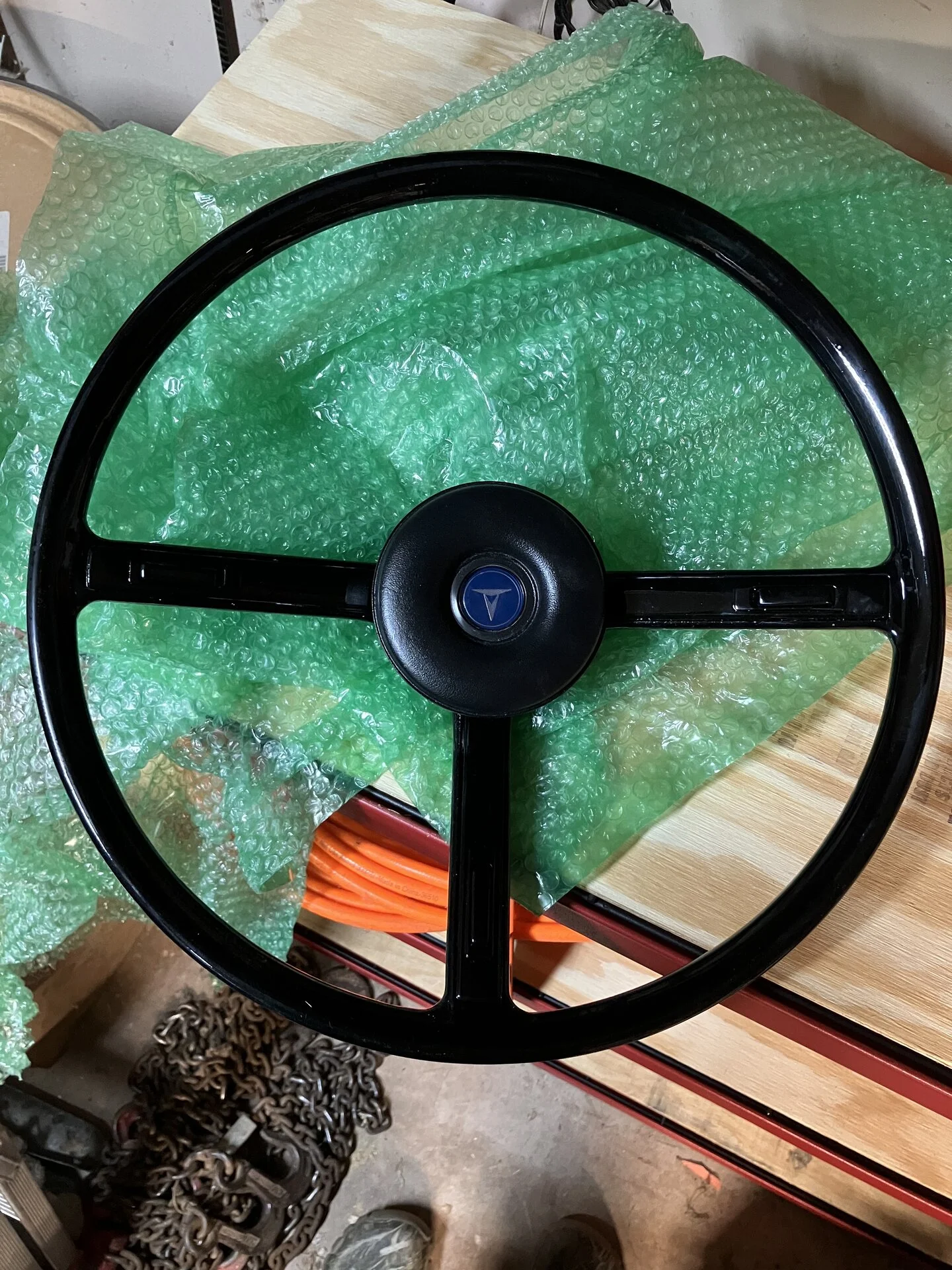

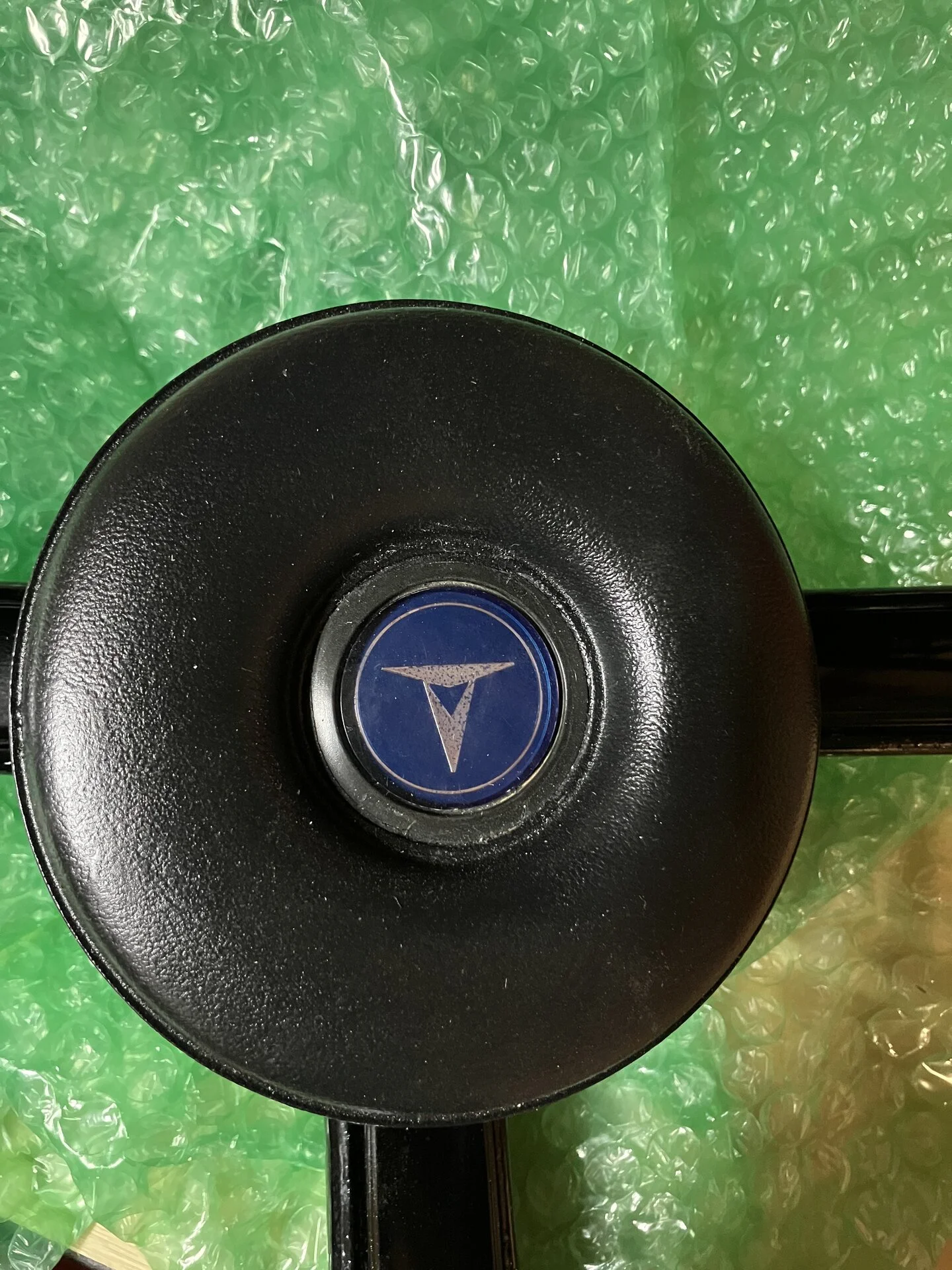

Is the black center ring and the plastic piece in the middle available to replace? Is that an option you offer?
A friend is getting ready to try to print some of the plastic pieces and I have a few of the metal rings.

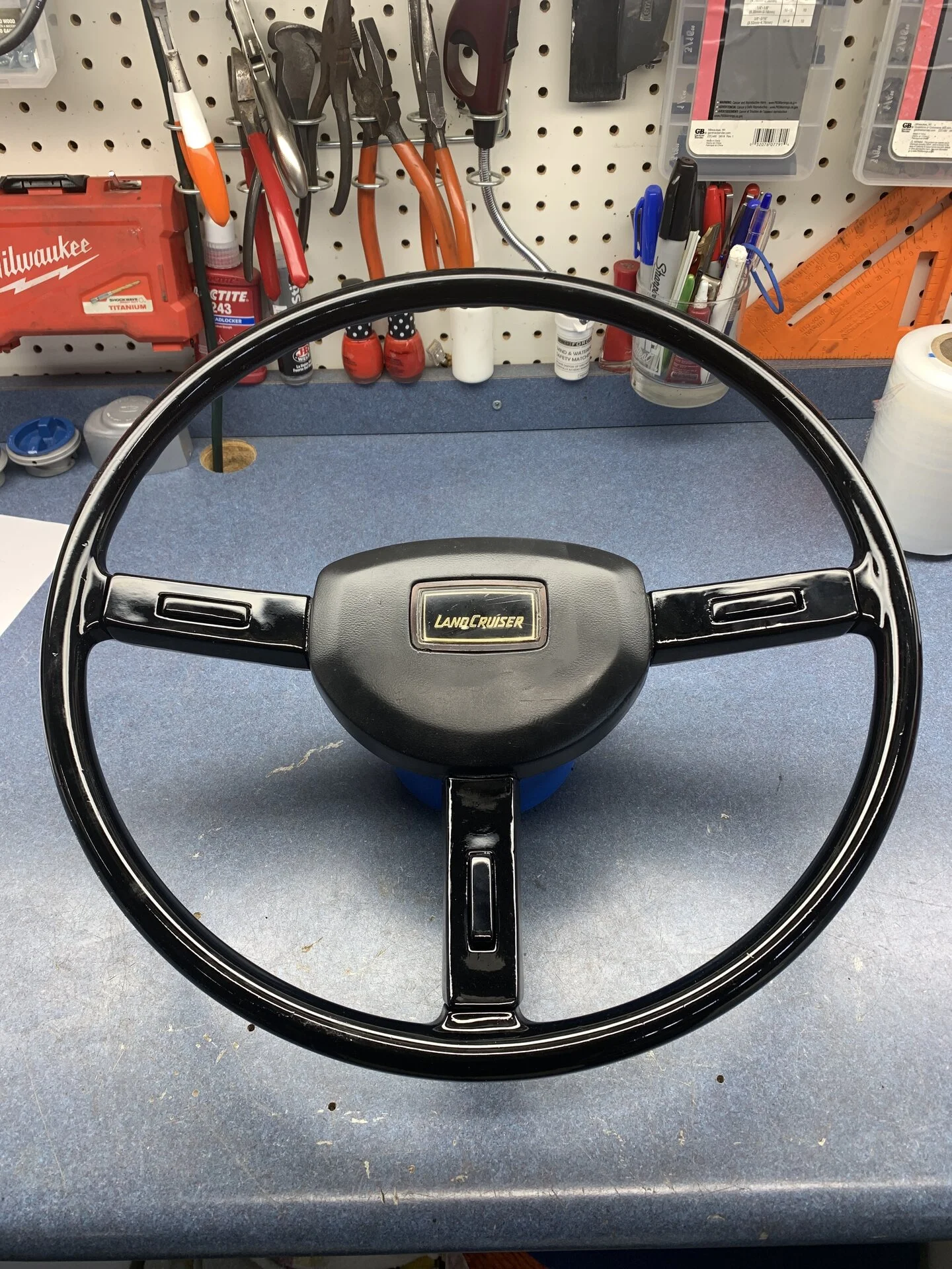

I just got my wheel back from @Birdhead last week and it is absolutely stunning. I am no where near the point of my restoration that I am in need of my steering wheel, but I didn’t want to wait to only find out that he no longer re does them, like @Rainman and the brake lines. So I went ahead and sent mine to him and I am blown away by his work. Great guy to work with and he’s a local Oklahoman like myself. If you are in need of steering wheel repair, @Birdhead is your guy.
