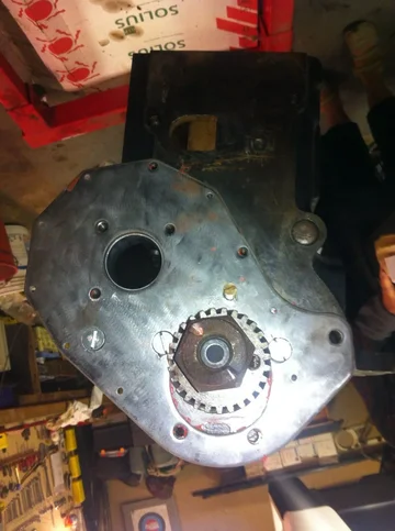

last news, i finally found the F135 and his 3 speed gearboxe, from dubai
RHD version , maybe coming off a japan FJ45 firefight because if the rear pto
If it is from a firetruck Japan probably a low miles well maintained engine. Did you get the oil fill tube? That would not have been your standard tube with the PCV fitting. Can see the two slits on the valve cover. The oil fill tube would have second long tub going down and open to the atmosphere. As air moved across it draws air from the crankcase. The two slits on the valve cover is where the air came from to replace that which was being drawn out the crankcase. The PCV (positive crankcase ventilation) would have a hose from the oil fill tube to the intake below the carburetor. A tube ran from the air cleaner to valve cover to provide filtered air. The PCV valve itself was to be sure air/fuel mixture didn't make it's way into the crankcase and cause a explosion which it the whole purpose of the System to prevent to begin with, blow-by in the cylinder some how igniting and blowing a hole in the block. Seen many posts of how a long compression engine was still running fine. Without a ventilation system a crankcase explosion would be real.
the oil filler tube is missing, i will search for the good one
can you post more information on it ?
