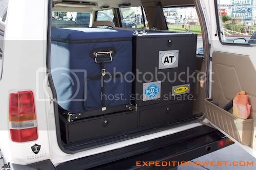

Here's the newest offering form Adventure Trailers. They made their debut at the SEMA show this last week. I will be calling the shop on monday morning to discuss various options and pricing.
As of right now all I know is that they are a composite material that is lighter than steel and come in various sizes to fit a variety of vehicles. They are pictured in Scott Brady's Disco of ExpeditionPortal/Expeditions West.
Bomber!!
Bomber!!
Saw them...great potential!
lighter than steel, modular to setup however you want, and built by top notch folks who know what they are doing..
I am already in line!
I saw these at SEMA and had them take measurements on my FJC to make sure it will work...sure enough the modular platform will work great in a wide variety of rigs....

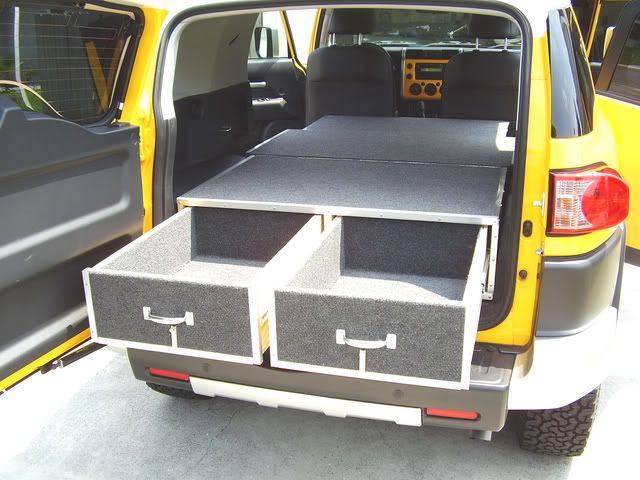

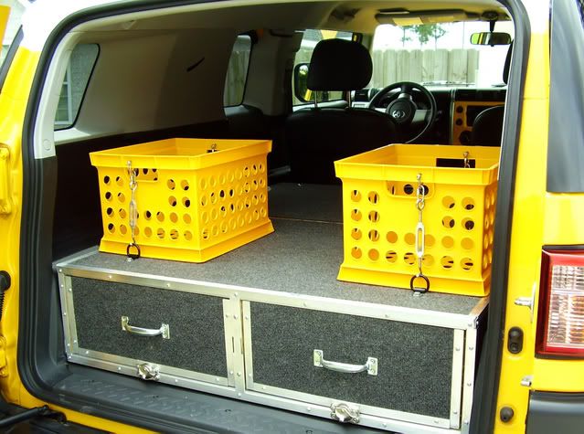

This was designed for an FJ Cruiser, but the concept could be translated to a 60, 80 or 100 series.
Thats nice! did you build or buy? Buy, where? Build, give a little more details, I have an 80 but looking to build a removable system similar to this one. Thanks
Love the build ! Great work!

Wood is also much much lighter then steel. I am a big fan of wood. If built correctly wood is Very durable, strong, and It is also relitivly inexspensive. I cant comment on the quality of the Adventure Trailers system. Other then to say that the Latch/pull hardwere look like it is Southco, Witch is top notch stuff. I just thought that it was interesting that they say "lighter then steel" Steel is heavy!
