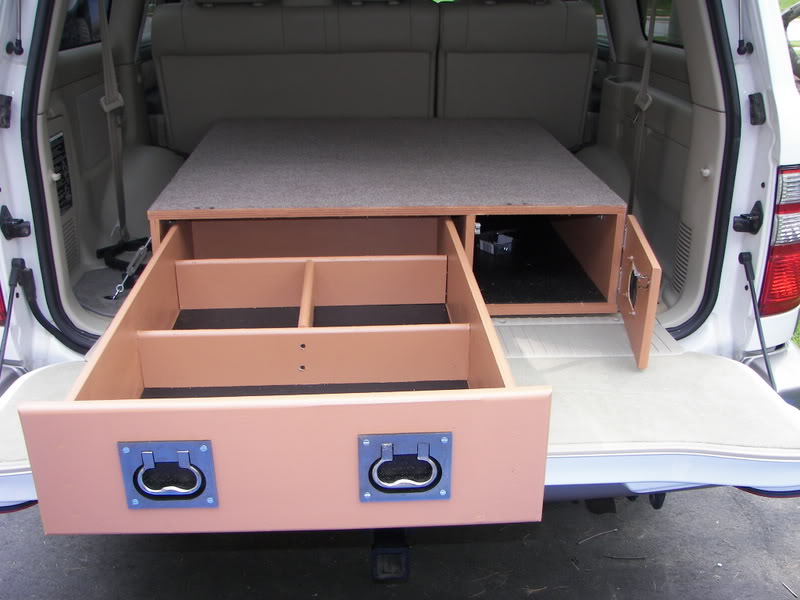

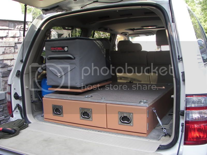

I just finished mine today. I left the spacees on the sides open for gear and spare parts. The drawers are as long as the back of the cruiser. I used ball bearing tool box rails for slides. The deck and uprights are 3/4 MDF. It is fastened to the floor with 1/8 angle. I am still waiting for the carpet. Seems heavy duty, with all of my gear and the spare tire it weighs 268 lbs. Only about 55 lbs more than the box I used to have back their.
I put foam padding under all parts that contact the floor. The over center latches keep the drawers from rattleing and take the weight off the rails when closed. Just thought I would put a post and some pictures.
Ben
