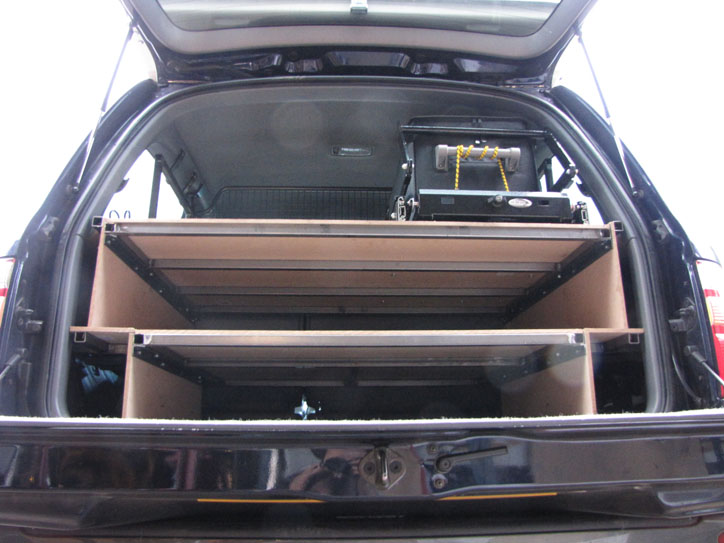

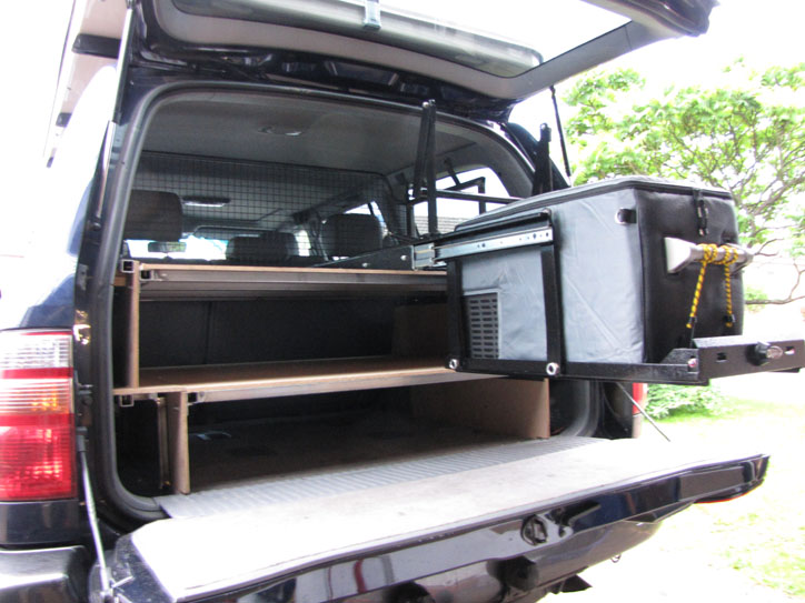

Fridge Slide
Just got one of these (in the UK). Saw it demo'd at a local supplier, never thought to ask about weight. No wonder the delivery guy didn't look happy when it came, must be 25kg + . Makes sense now I've got it, a big fridge full of stuff must take a lot of supporting but I think I might have gone with a different solution if I'd realised the weight before purchase. Not installed it yet so I can't give you feedback on using it.

Couldn't agree more. "Stupid Expensive" sums it up until you realize that the AO quality is simply superb. Besides, the earlier comments were spot on; $500 in woodn'goodies + labor, time away from wheelin' and you're just about there on a set of AO drawers. Further, if you think you can beat the steel frame drawers with some home made ply wood stuff on washboard roads at 40+mph...think again. There is simply no comparison. I wish I'd saved the pics of the HM Plywood drawer that turned itself into kindeling on my last trip to the Oregon Outback. The AO system is seriously solid, locks effectively and I bought the fridge slide out which works flawlessly and provides convenient access. Only drawback is that the fridge slide out chewed up the cord on my Engle 45qt and rendered it useless half way into s trip to DVNP (well... actually it was operator error... I just wasn't paying attention and reefed the thing in there when I knew there was something blocking the slider... dumb). Buy it. You won't regret it. :steer:
