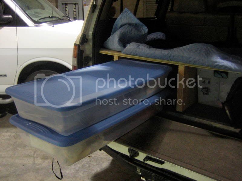

Here's a completely inelegant solution. It is, however, cheap, removable, modifiable, and functional. I've had it for about 9 months and it has performed spotlessly.

I gotta say I like it. Functional and removable. Best of all if you wanted to take your time and test out different gear storage configs you aren't stuck to any one setup. Last, with the base setup that you got wouldn't take much to build some drawer slide and drawers and dress em up purty like these other fellas once you get comfortable with a storage arrangement for your gear.:cheers:
Aye...I can go with bins, or without bins, use a tall bin or stack two short bins....
...and if I get sick of it, it's firewood.

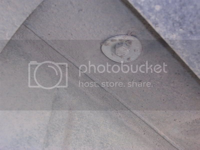

BTW the ring tie downs are a waste of time they are always buried under gear. I added two sections of unistrut on the inside of the tub for tie downs.

The bolts thread into tee nuts hidden by the carpet

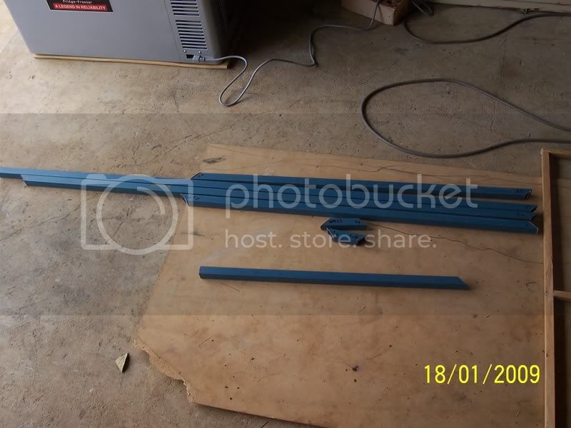

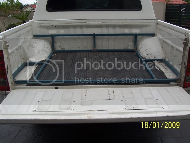

Out come the timber and tape to whip up one of these, a template
A few cuts later i had a pile of steel :shock:
Then got the welder out of thw cobwebs went to bunnings and got a roll of gasless wire (i hate it but it works)
About 3 hours later i have this.
Will have some more done this weekend.

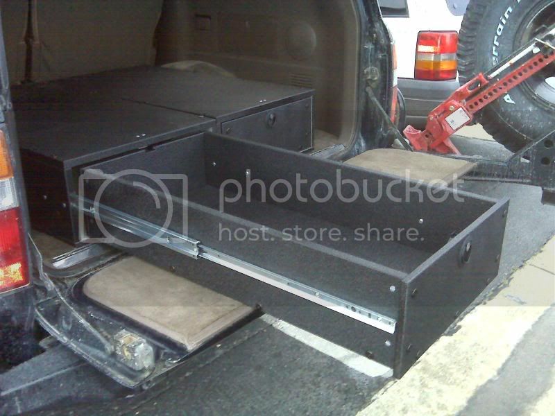

That drawer is awesome!! I was torn between 1 or 2 drawers but I ended up designing it for two. How are those slides? Are they smooth?
Thanks!!
Yes very smooth.
Now if Kevin can get me the tailgate before the next run I'll be set.
Thanks!!
Yes very smooth.
You'll be in heaven once you get that tailgate. They're incredibly strong too! I dropped my old H42+split case right in the middle of it ( 1st gen plywood lid ) and it only flexed.
I designed my drawer to fit the side panels as well. Seems like too much space in those quarters to waste.
