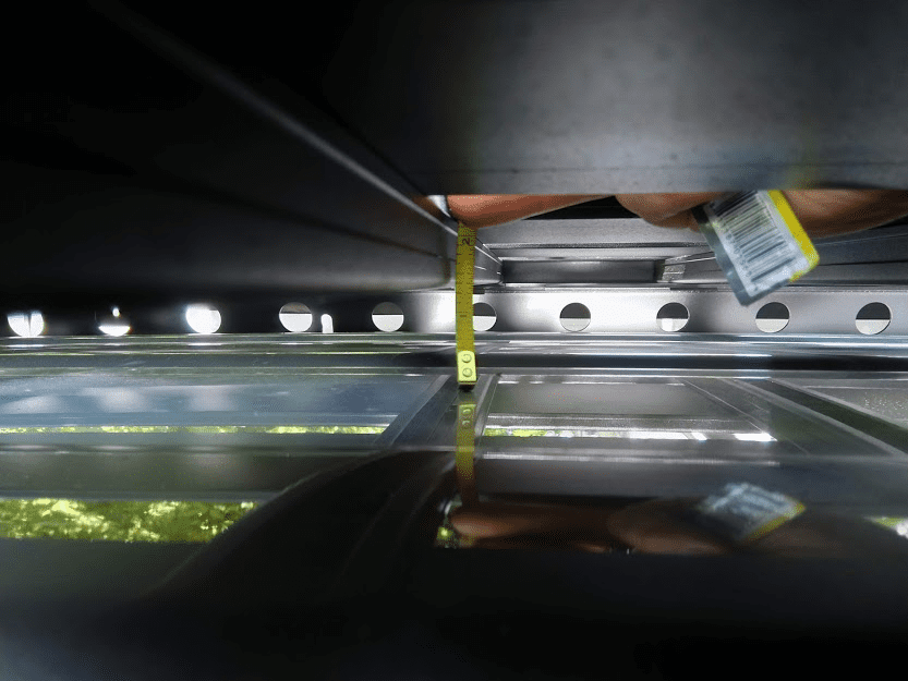

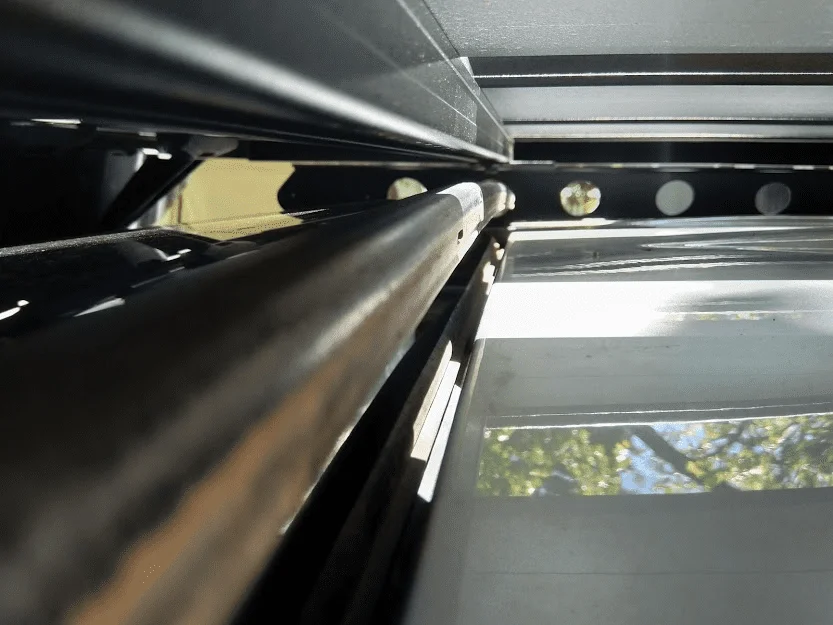

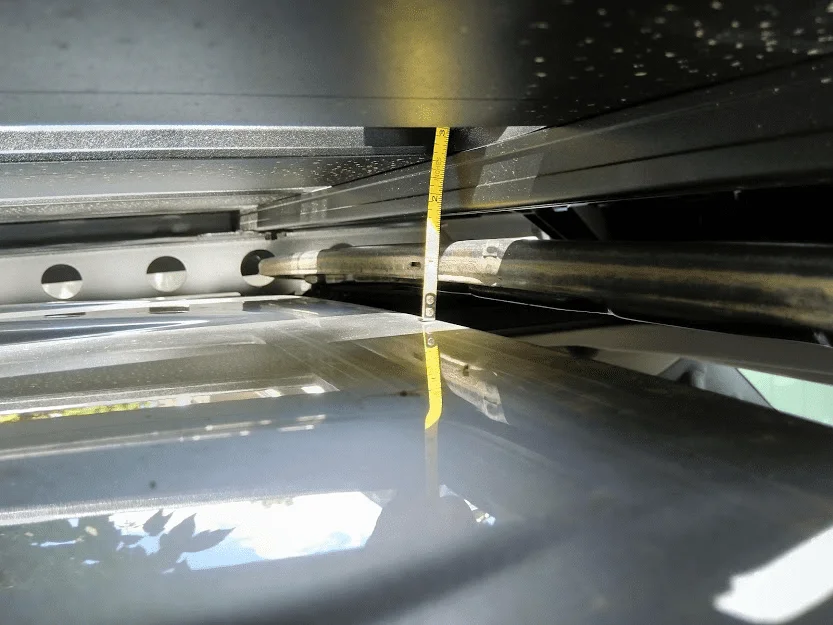

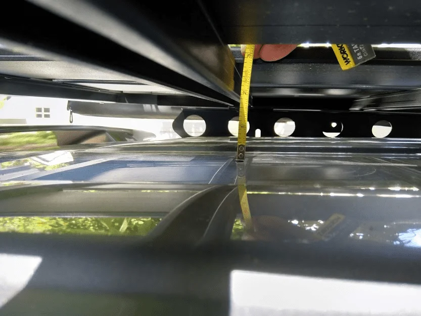

Here are some clearance photos from the roof to main crossbars of RR Pioneer Platform tray, which mount the platform to the backbone.
REAR: about 1.75"
1996894
CENTER: about 1.25"
1996895
FRONT: about 1.75" too, here glass is also tilted open and clears crossbar bu about 0.5"
1996896
And as seen from driver side backbone rail
1996897
Yu
If I am looking at that correctly does the backbone rail end up at the middle of the sunroof?
Yup....
It's like 8" fore (of the front pair of holes) and 8" aft (of the rear set) of the factory mounting holes. Pull the covers off your factory rack and see where the holes are...

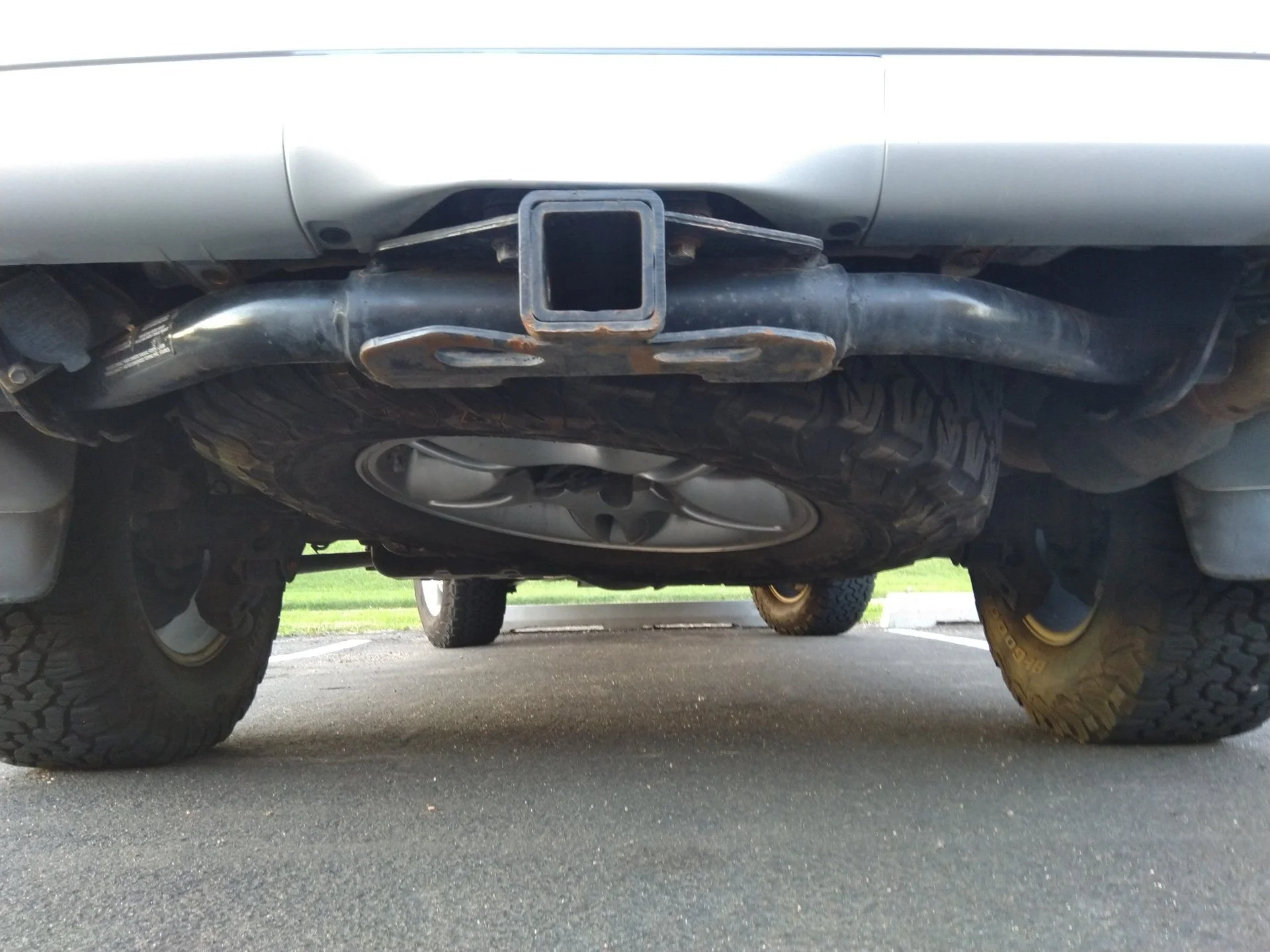

I was visiting my parents (and therefore was ill equipped to do a tire rotation myself) last month and was due for my 5-tire rotation. I was able to do my oil before the big trip but figured I'd have the shop do.tires.
Anyhoo.

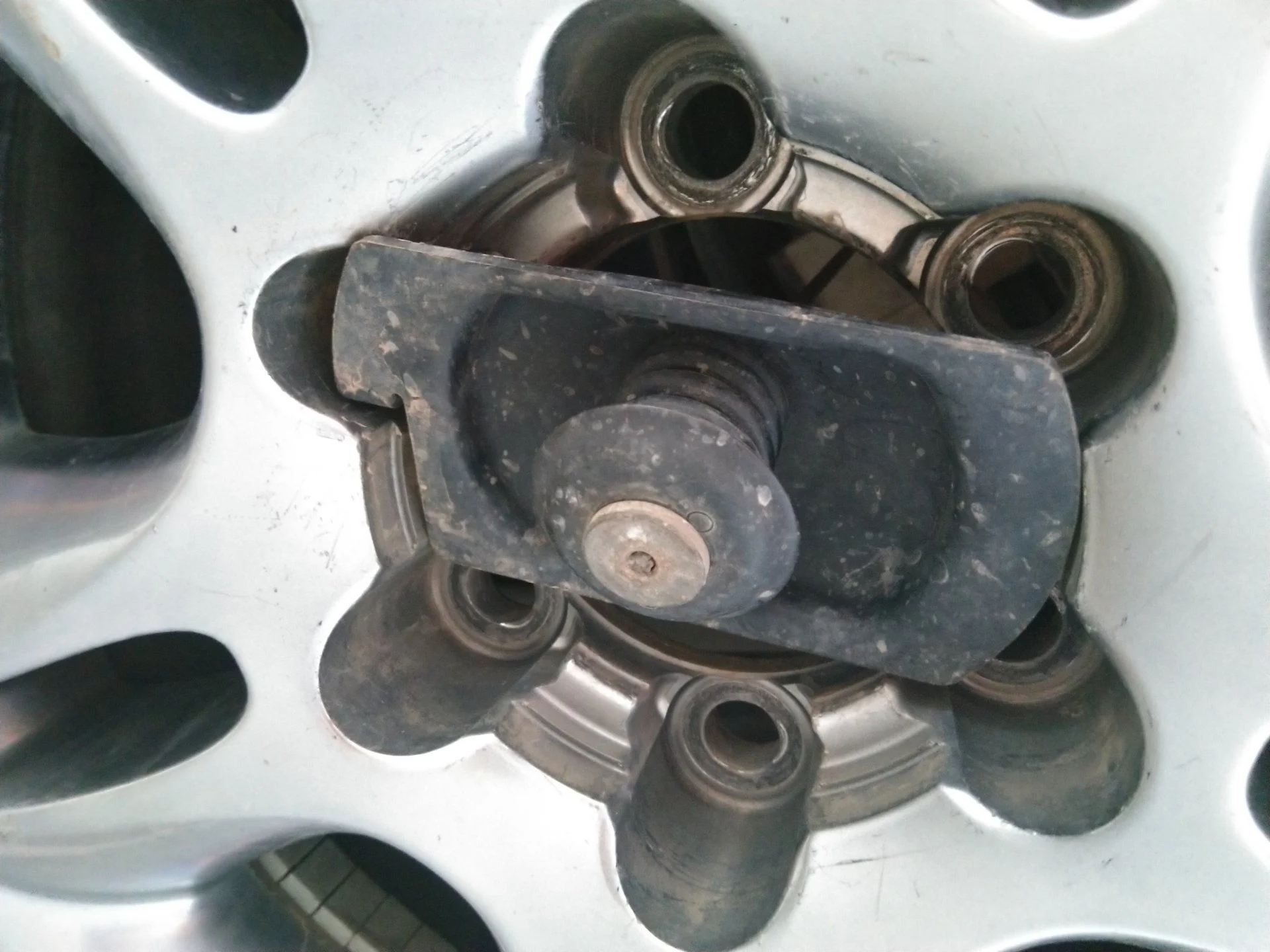

I gave them a picture of my preferred 5-tire rotation pattern and asked that everything be aired to 35 psi, the spare too.
I didn't check the pressure for a couple days until.i'd started my 1,000 mile return trip (they aired everything to 40.or40+; lame) and I didn't check the spare because i trusted a tire shop to know how to mount a spare (they'd said "it's a little tight getting the spare back up there." I'd said, "yeah, especially when those tires were new!")

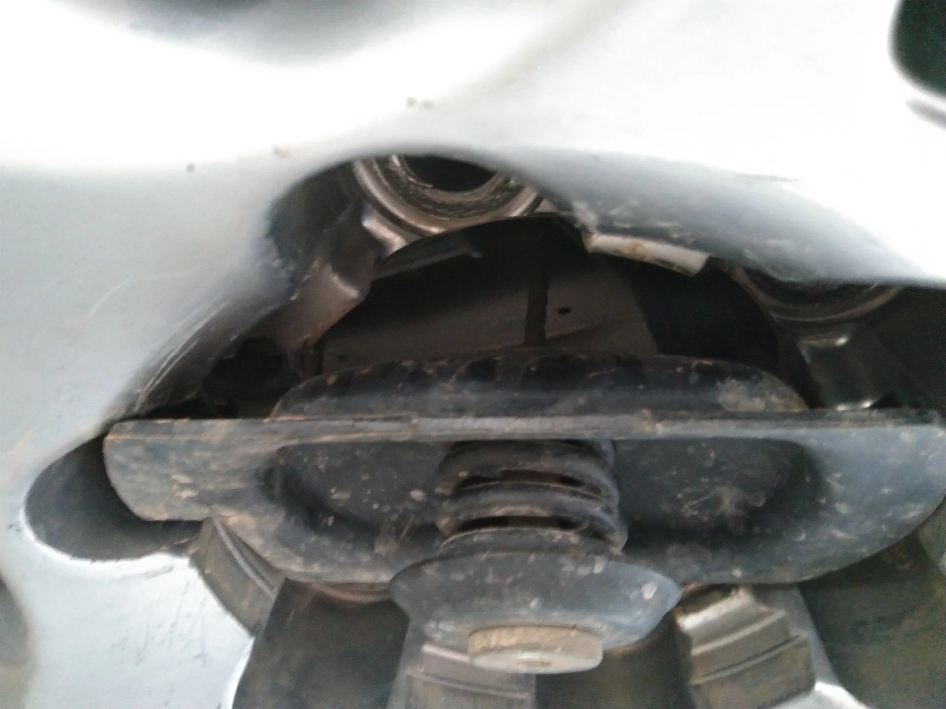

Turns out (1,500+ miles later) they botched stowing the spare! The damn thing could probanly fall out (a friend's 4R spare fell out on a trail in Moab, he never saw it again)!!
What the eff, people! Does anyone care about the quality of their work, or following up on employees in the service sector? It's a sad and real trend in reduced quality.
It's probably confounded by my middling age and preferences in doing things right....and my curse of orientation to details.
Okay, I'm done...
Here the shoddy work I noticed this afternoon.

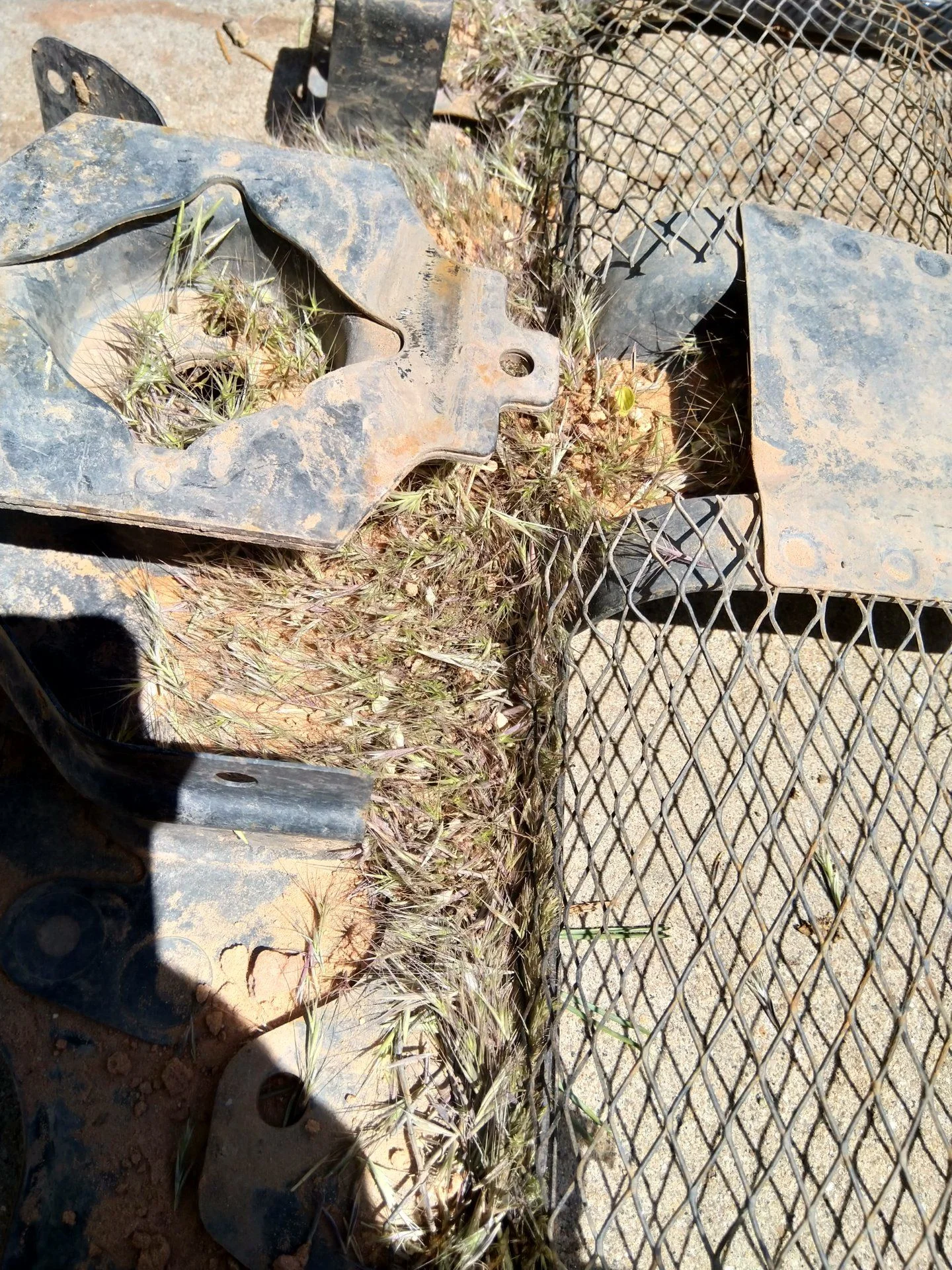

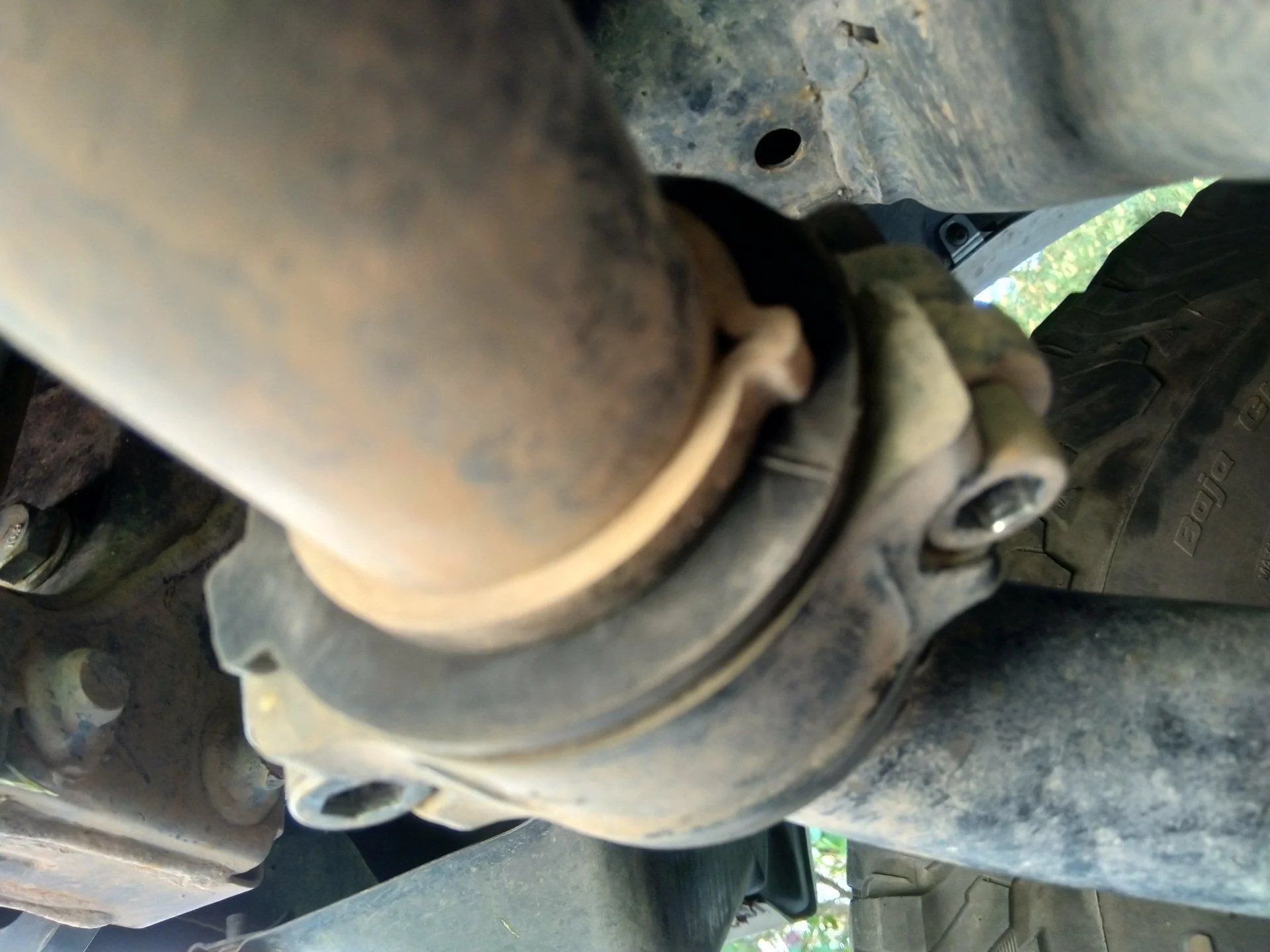

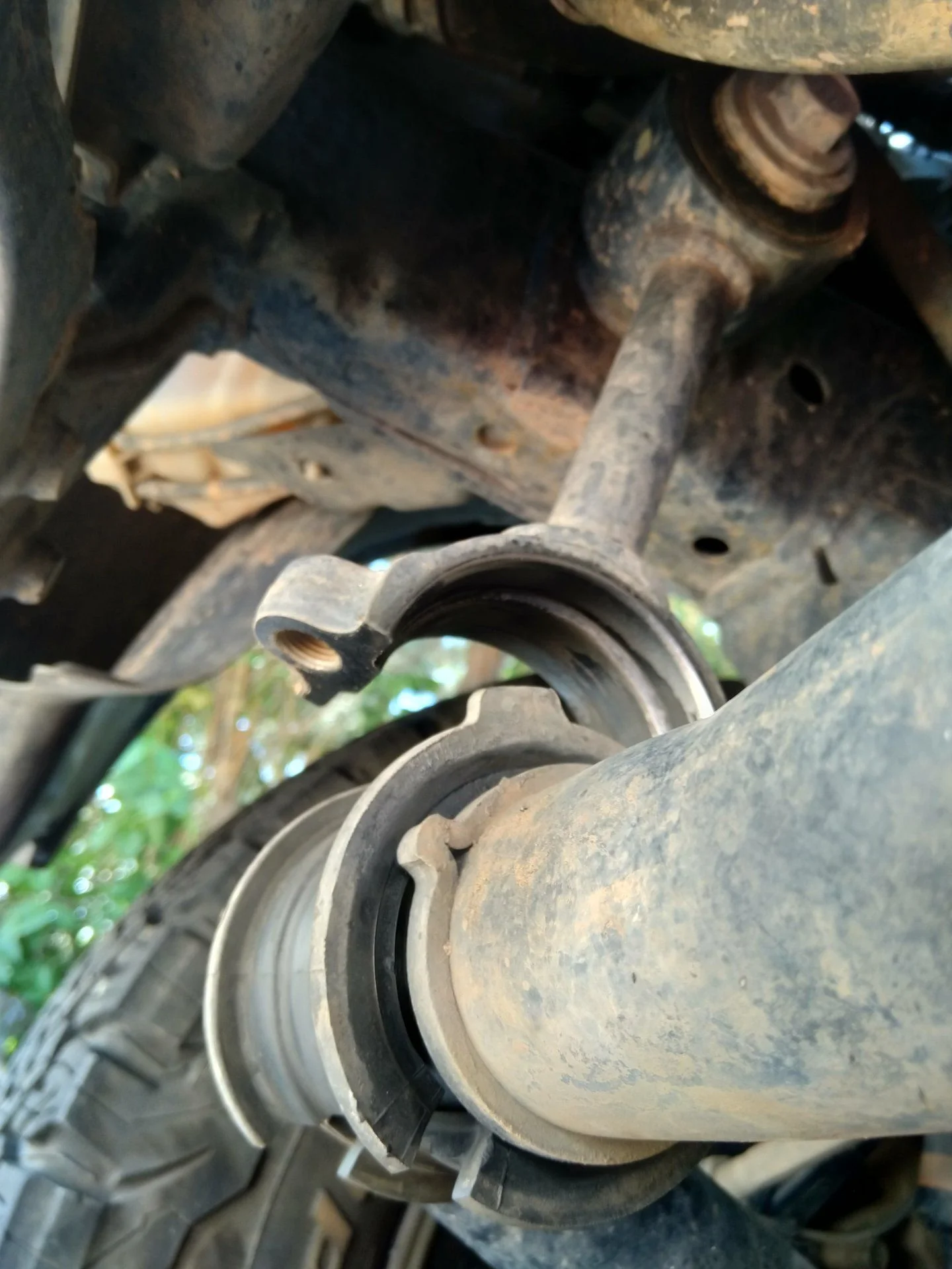

Finally got aroumd to changing my KDSS FSB bushings because of clunks. So now, I've done rear KDSS, front outer and front KDSS. I should probably look at control arm bushings soon too. 🤔

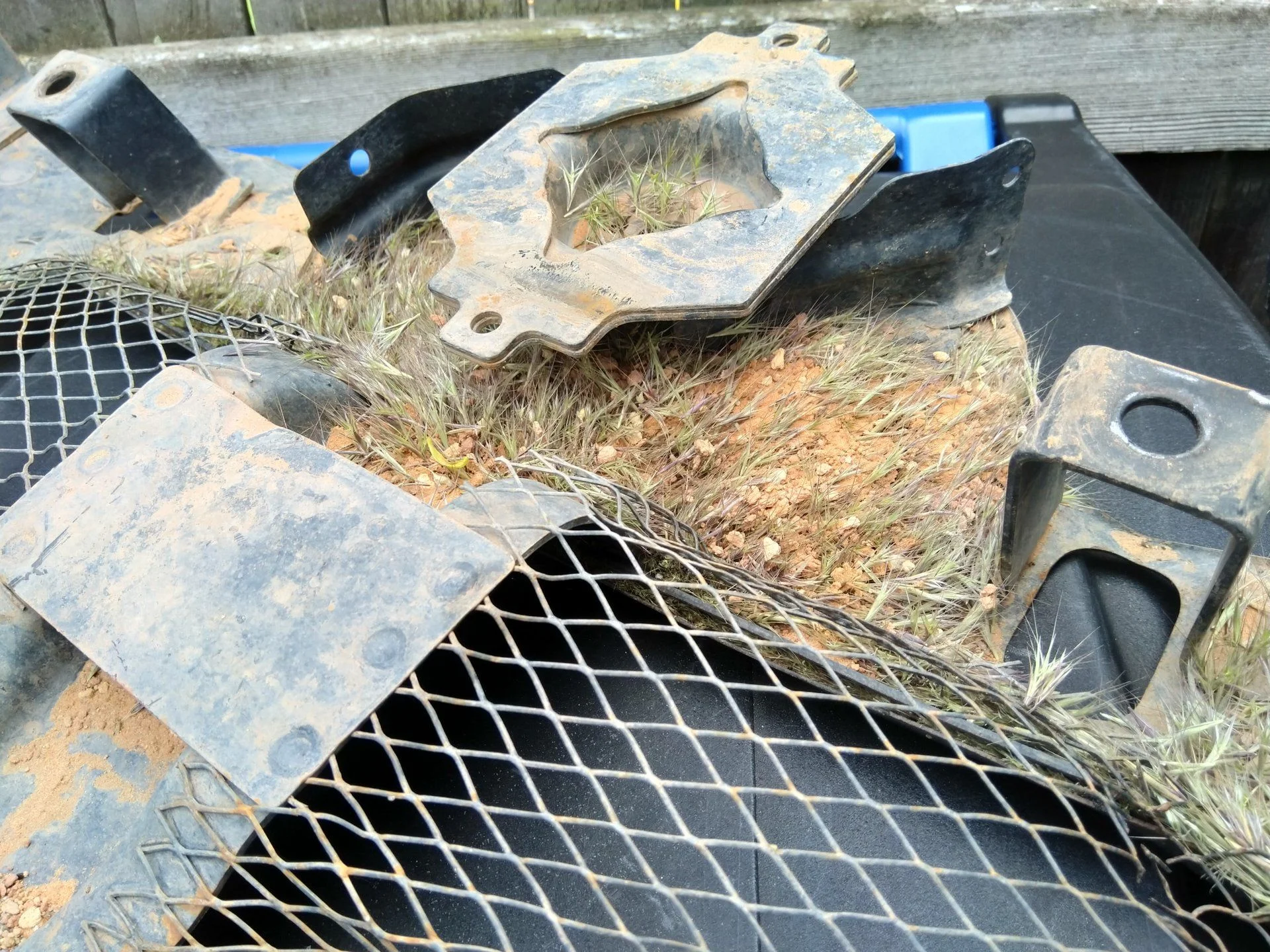

And boy is that stock skid plate a nasty grass catcher/collector (invasive species spreader)!!! 🤯😬😫
