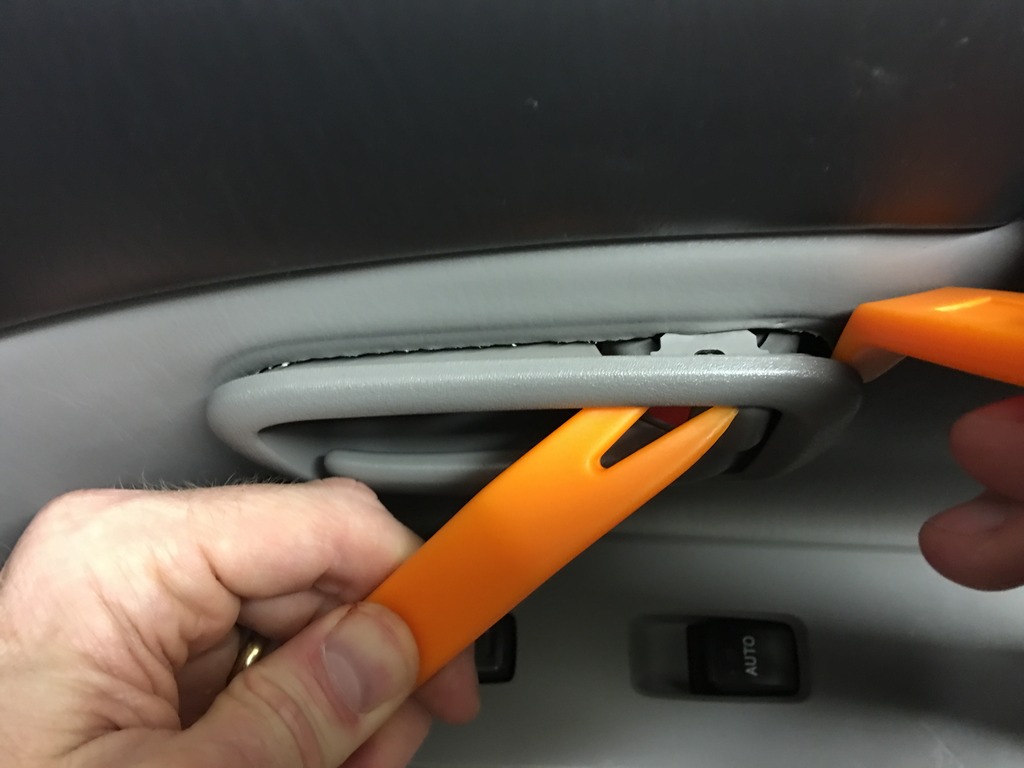

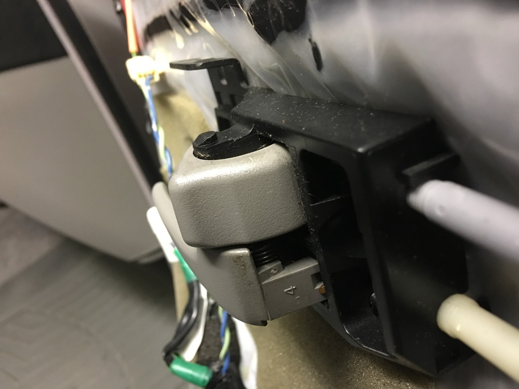

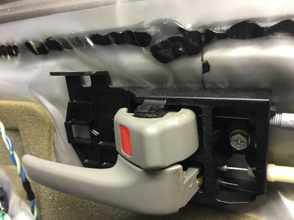

Chiming in to say thank you for this write up. I took my door panel off for the first time today and you made it easy for me. Here's a couple more pics of the door latch trim and how I got it off easily.
1. The black nub that sits just above the lock switch is what you have to overcome.
2. Another angle so you can see it better.
3. As I'm putting pressure on the right to pull the trim piece out, I insert the forked tool under the nub and it pops it out pretty easily. There's a nub on top and bottom, but as soon as you get this top one released, the whole trim piece comes out easily.
Great pictures! Thank you
