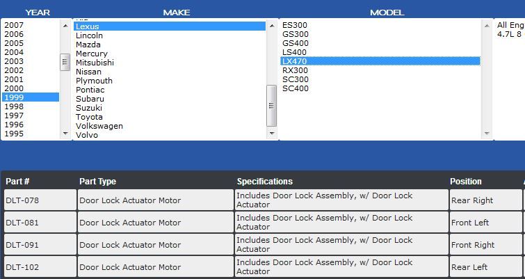

Below is a screenshot of Aisin's part numbers for the LX470 actuators.
Again, Rock Auto says these are equivalent part #'s:
DLT-078 = 69050-60060, 69050-60061, 69050-60062
DLT-081 = 69040-60080, 69040-60081
DLT-091 = 69030-60080, 69030-60081
DLT-102 = 69060-60060, 69060-60061, 69060-60062
Anyone know which Camry actuators I should order? I need to do passenger front and driver rear door, but I'm leaning towards just doing all of them since they will fail sooner than later anyway.
