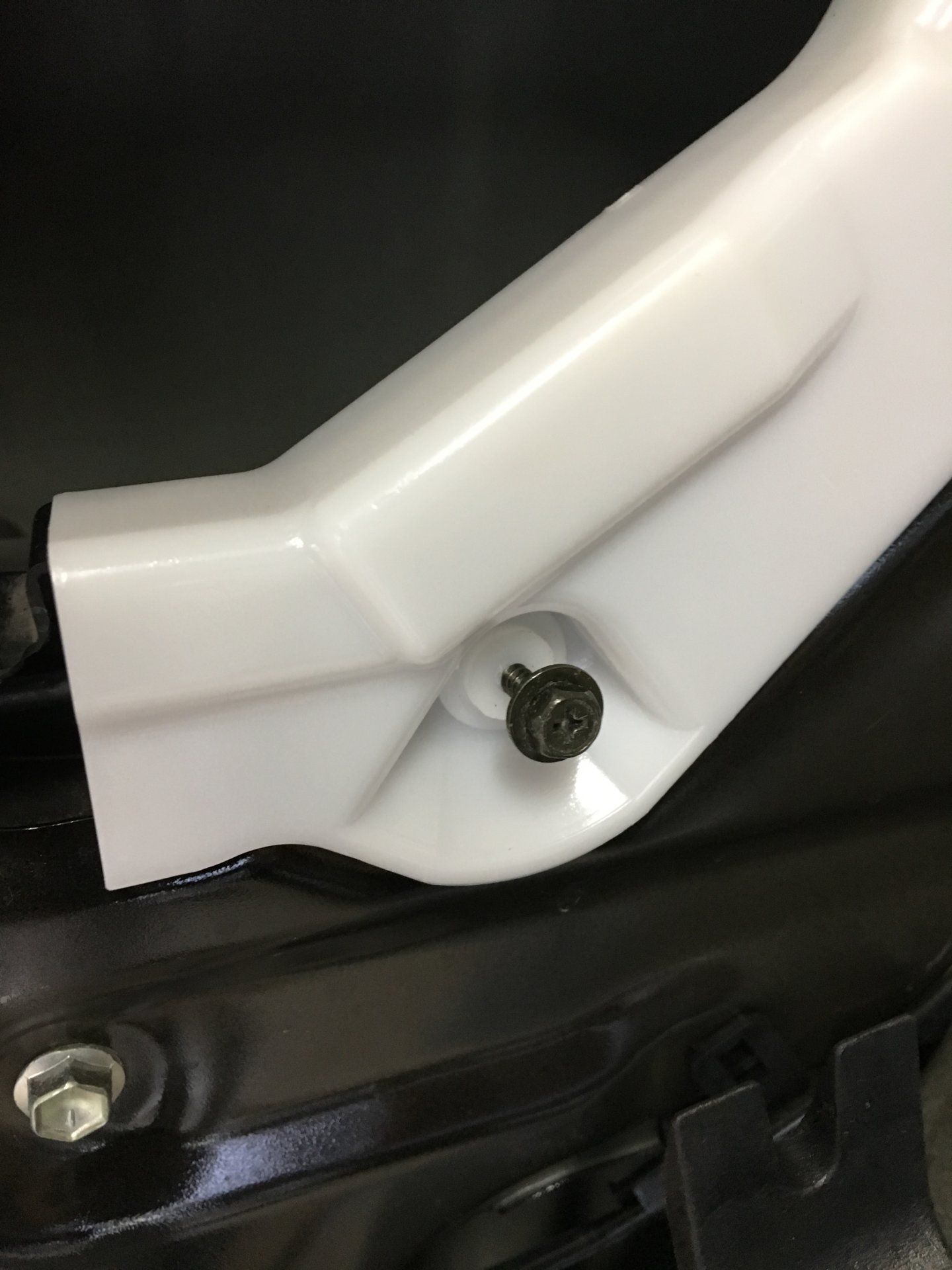

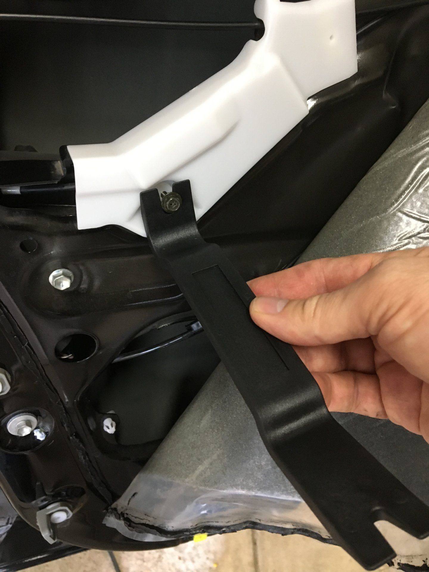

I replaced my driver’s door actuator today. Regarding that SOB white plastic cable guide, here is how i got it off without breaking it.
I heated everything up with my wife’s hairdryer, then drove one of my doorpanel screws a few turns into the plastic plug/rivet. With the screw set, I pried it out of the door with minimal drama. The right side popped out pretty easily once the other side was free, but I used heat there also.
