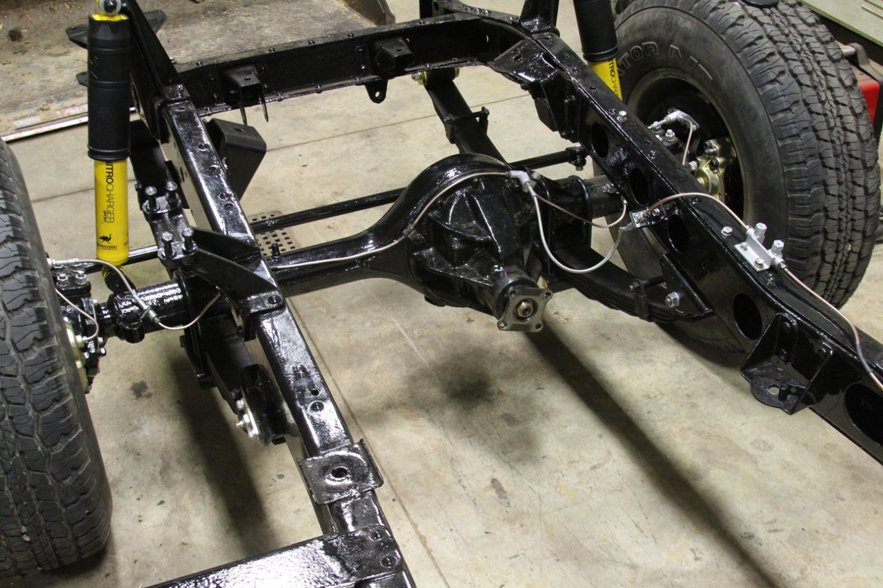

But when I moved up to the front axle I noticed the fitting would not thread all the way into the block/diverter. See that big gap between the copper washer and receiving block?
I pulled the rear line back off and compared the two ends. . . sure enough one is longer than the other. It was by pure chance that I put the shorter one on the back axle first when everything seemed like it was going normally.
I headed back outside to look over the parts axles I have in the yard. . . both the front and rear drum axle lines were tight against the copper washer. I had saved all the old pieces removed front the '78 disc axle so I dug those out and what do you know -- One is longer than the other like the new lines! The "longer" fitting line appears to have been from the front axle (looking back at old pictures) and it appears the hose never threaded all the way in originally judging by the clean/dirty areas on the fitting. The fitting appears to snug up against the inside of the receiving block the way the steel line nuts do -- perhaps a change that came along with the disc axle?? I lost an hour plus trying to figure all this stuff out.
After the brake hose adventure I thought Id try to torque down all the nuts on the axles/frame/etc. How much harm can a torque wrench do, right? I didnt think much until I stripped the threads on one of the shock mounting studs with a bad nut -- luckily I was able to remove/replace it with another from the parts frame in the yard -- chalk up another hour or so for that process. I stopped taking pictures at this point.

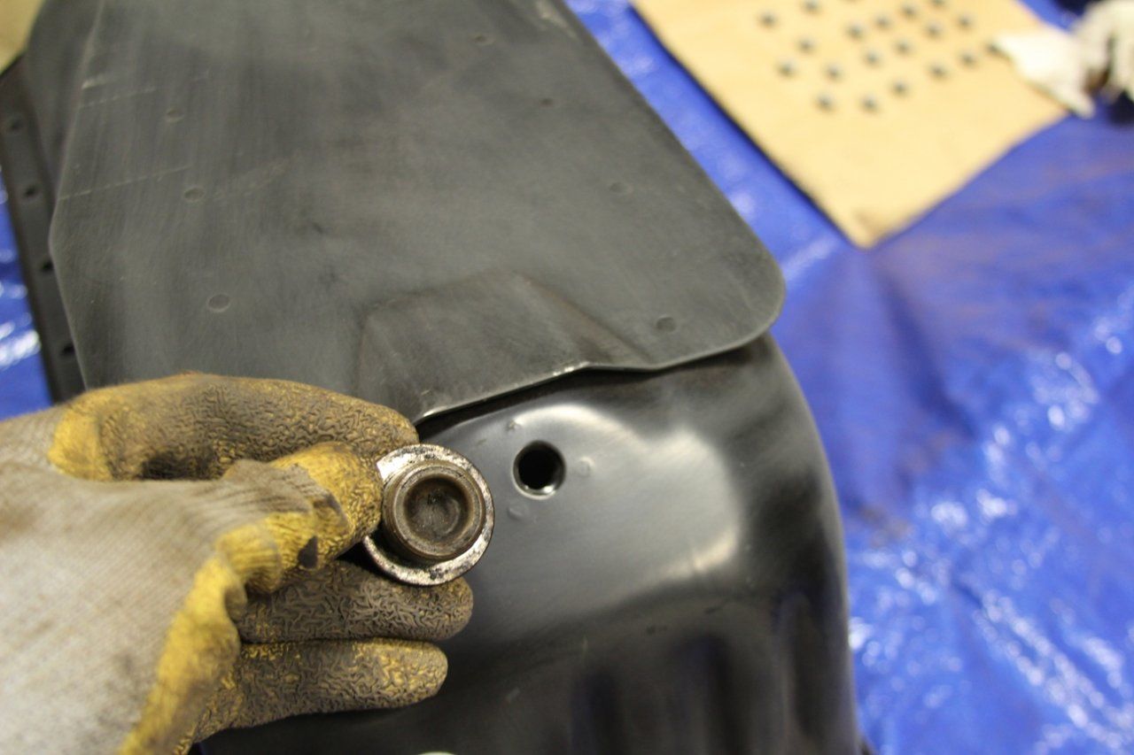

And just in case anyone was worried that I was going to re-use that crusty old oil pan. . . fear not. A new OEM Pan from Cruiser Outfitters has been patiently waiting on the shelf. The old oil pan was seriously rusty on the sides and I have read enough about bent gasket flanges and leaky skid plate welds that I did not want to take any chances.
I thought Id be clever an reuse my old oil pan plug but it does not look like that will be happening. Apparently Toyota decided that the oil did not need to drain out in 15 seconds so they made the hole smaller on the new pans. Looks like I will be putting another part on the need to order list.
