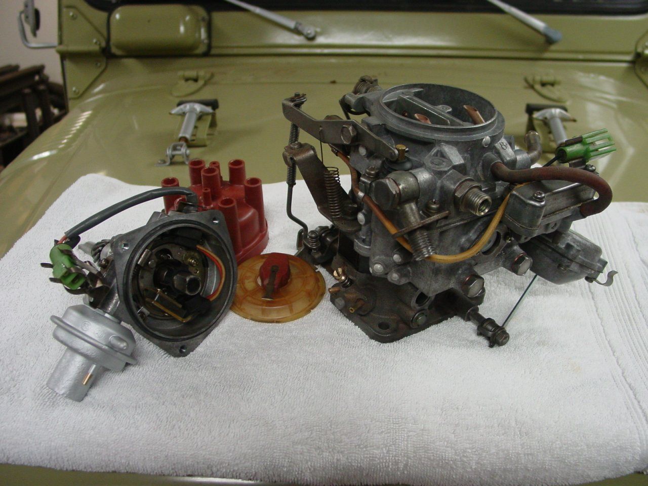

Engine management system is complete. Carb will be tested and package will go in mail tomorrow.

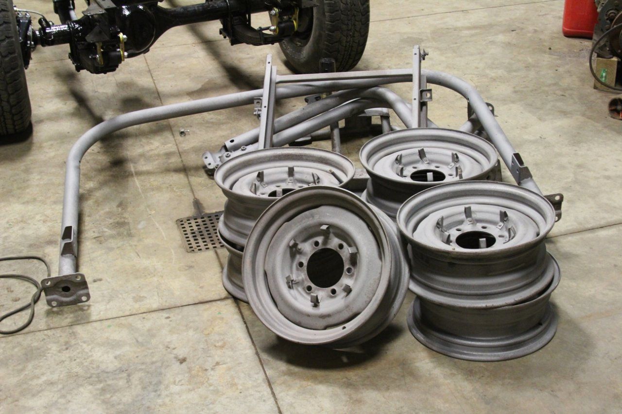

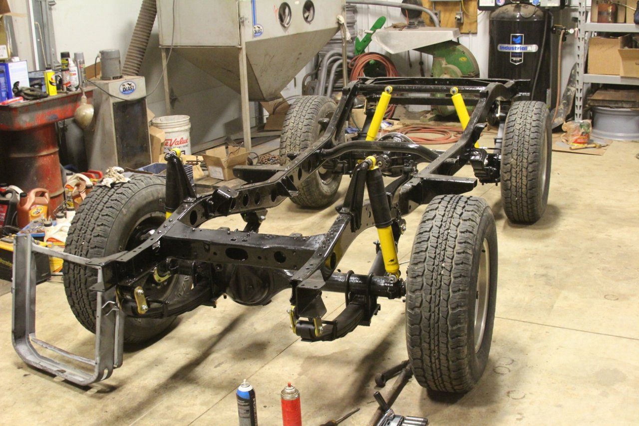

Had a little time this afternoon to spend in the shop. . . with the painted frame, rebuilt axles, and new OME lift all in one place I could not resist bringing some of the pieces together. It was quite the ballet/balancing act using jack stands, the floor jack, and overhead lift to get the rear axle installed. I started with the frame on jack stands and installed the fixed portion of the rear springs (the new bushings were a tight fit!). I put a couple rims/tires on the rear axle, rolled it under the frame and then lowered the frame so I could install the rear shackles. I then raised the frame back up to "catch" the rear axle on the springs and put the new U-bolts on to tie everything together.
While the Aluminum American Racing style wheels look rather fetching I will be going back to Stock Steel Rims with hubcaps. A keen eye will see the wheel studs are too short (with the disc brake conversion) for these rims anyway -- I did check the steel wheels and there is plenty of length for them. The OEM rims are still at the sandblaster and I couldnt justify sending the money for new tires anyway at this point in time. . . when I am closer to driving and moving I will give the new rubber a closer look.

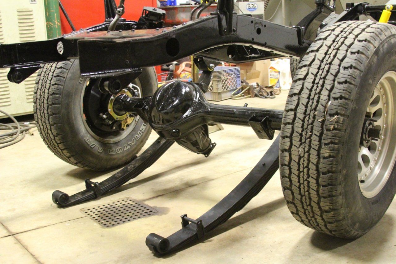

This week's progress did include mounting the front springs/axle to the frame.

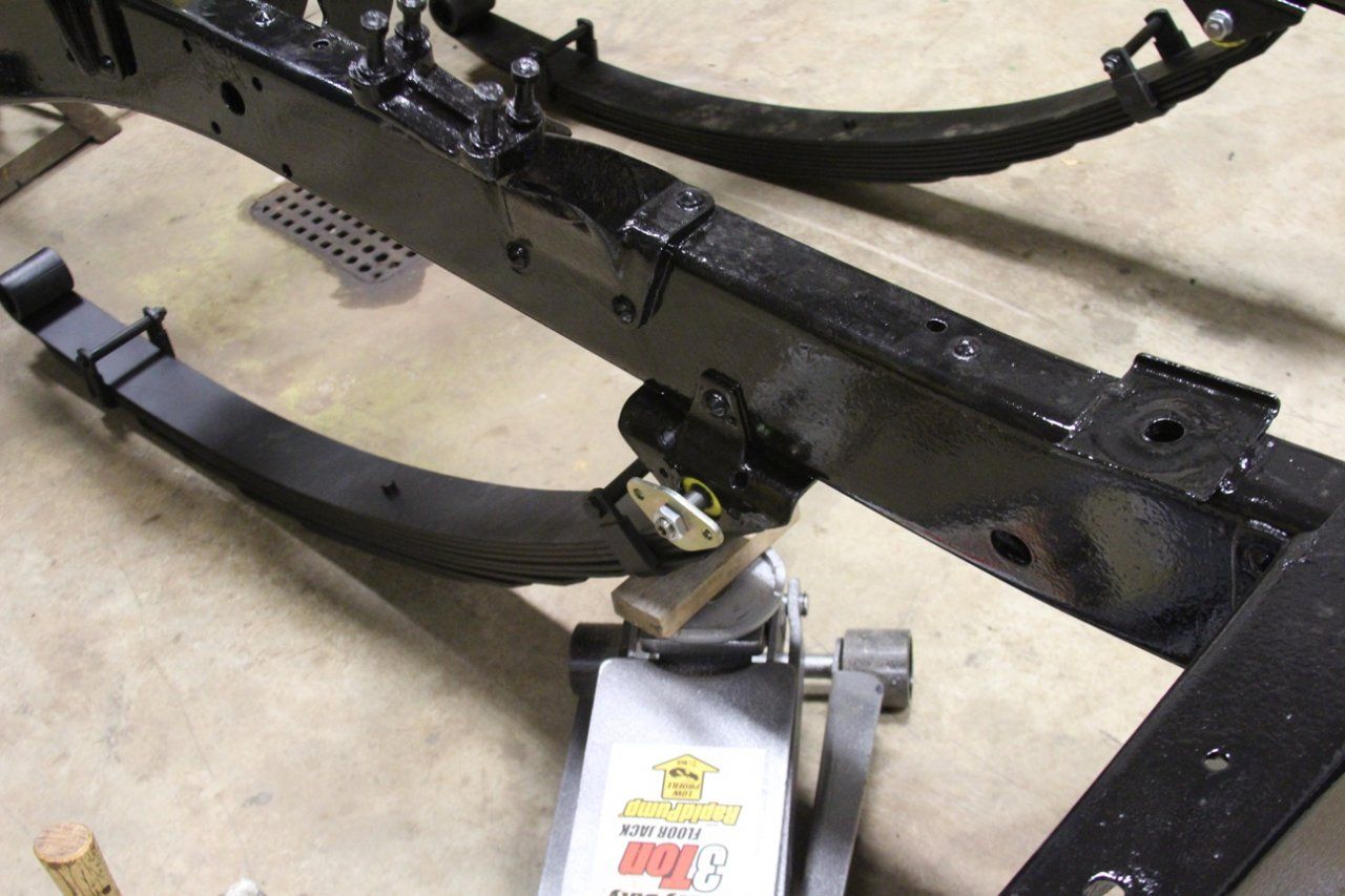

Just like on the rear I started by mounting the fixed end of the springs to the frame. The floor jack helped to squeeze the new bushings into the spring hanger.
Once the fixed portion of the spring was in place I rolled the front axle under the front of the frame -- this was more difficult than the rear axle because I do not yet have the rod attached to the steering arms; the front wheels wanted to pivot in all the directions I did not want them to!
The frame was lowered and the front shackles attached. The frame was then raised up to "catch" the axle on the springs and the U-bolts were installed. It is very satisfying to see a rolling frame sitting in the shop! Thanks again @cruiseroutfit -- the OME lift and axle rebuilds looks great with your help! Progress will probably appear to slow down some from here. . . cleaning and prepping all the small parts is very time consuming.

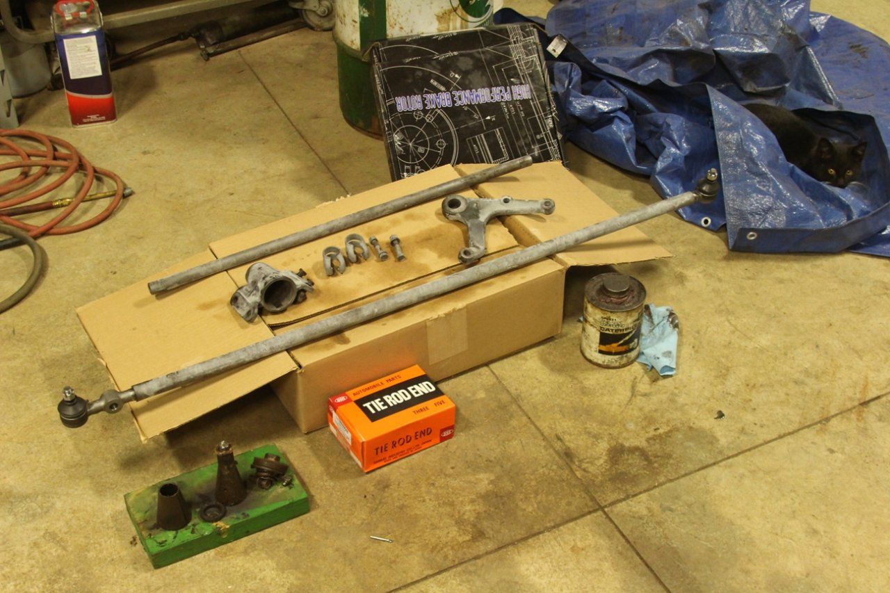

After standing/looking at the frame for awhile I focused on the steering linkage. I know power steering is another popular conversion/add on. . . for now I am staying with manual steering. I do not plan on the truck being a daily driver (power steering then a must) and want to get a feel for it in its original state. Manual steering might also be discouraging if a friend or other family member had thoughts of "borrowing" my 40! :nailbiting:
I am usually competent when it comes to taking things apart. . . I was a little too aggressive with the BFH on the steering center arm spindle though. It was tight/probably usable the way it was but grease was seeping out thru the seal at the bottom and I wanted to address that. I heated the idler arm, wacked around it with the hammer, and used a large brass hammer to eventually pop the splines of the pin out of the arm -- I always try to leave the nut flush with the end of the piece I am hitting against but I managed to mash the two together and broke the idler pin right in half when trying to remove the nut. Put a center arm rebuild kit on the list of things I need. . . the list seems to be getting longer the further along I get!
I am usually competent when it comes to taking things apart. . . I was a little too aggressive with the BFH on the steering center arm spindle though. It was tight/probably usable the way it was but grease was seeping out thru the seal at the bottom and I wanted to address that. I heated the idler arm, wacked around it with the hammer, and used a large brass hammer to eventually pop the splines of the pin out of the arm -- I always try to leave the nut flush with the end of the piece I am hitting against but I managed to mash the two together and broke the idler pin right in half when trying to remove the nut. Put a center arm rebuild kit on the list of things I need. . . the list seems to be getting longer the further along I get!View attachment 1361775
Center arm rebuild is really easy. After rebuilding the knuckles, tre, center arm, steering box and upper drag link, I can feel a difference in how smooth and tight everything is just rolling it around the garage.
I agree Jdc1 -- it should make a difference. I did not really think the steering had a lot of play when I was driving the truck around (the truck that I am using the parts from) -- but I cannot say that I ever made it over 35mph with that one. The ball joints were in obvious need of replacement when I pulled the old ones off though and there was a small bit of wear in the knuckles.
I had planned on replacing the seals in the steering box; is there any other "rebuild" that I should consider or wear points to look for in the steering box itself?
