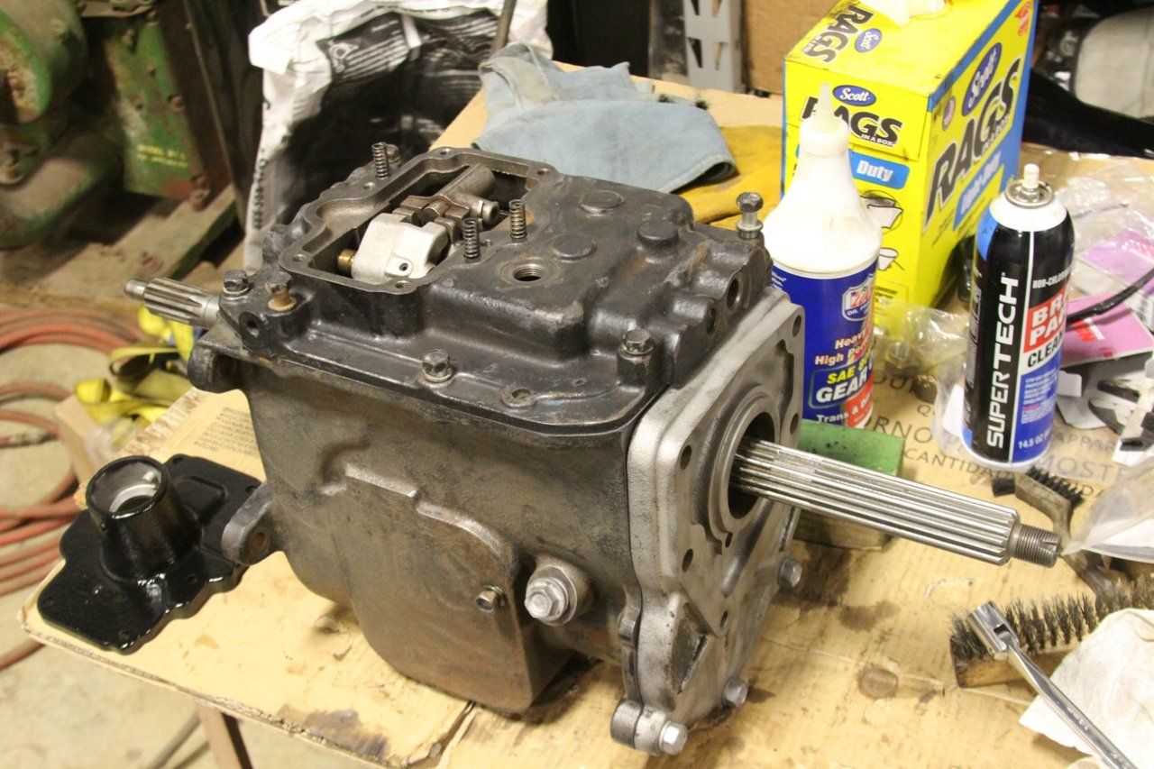

Next was the installation of the new rollers to the inner input shaft where it will ride on the output shaft. A good bit of grease helps hold them in place as well as a snug fit. . . I was worried that they would all drop down into the bottom of the transmission case when I went to install the shaft but they slid in fine.
A little tapping with the brass hammer had the input shaft installed in no time. Luckily I did not forget to install the new synchronizer.
Next I moved onto the counter shaft bearings. The front bearing matched up to the original just fine but there was something different about the bearing at the back of the case. It took me a minute to realize the bearing came with a new roller flange on the inside -- it was at this point that I also realized I had not removed the old flange from the counter shaft. I thought I could get away with leaving the old collar/flange on the shaft and just putting a new bearing in place.
I thought that I might be able to get away with using the new bearing on the old collar/flange, but there are some differences between the two in terms of roller/spacer thickness (new = shiny silver, old = goldish tint) so they will not just swap out.
This is where I left things for the night. I figure my options are to reuse the old bearing (last resort -- no point in putting one old bearing back in with everything else new), or try to remove the old collar/flange from the counter shaft WITHOUT having to pull all the pieces back out of the transmission again. I think if I heat it up with the torch I should be able to get it to slide off with what access I have. Stay tuned and we will see what tomorrow brings. . .

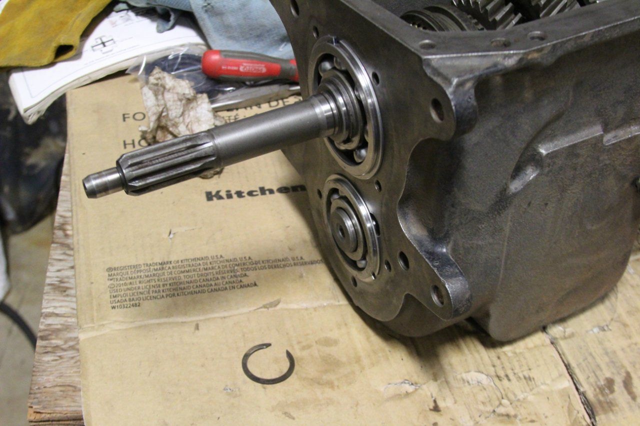

At this point things were looking good, but I found another problem when I went to install the front bearing. (Another post coming).
I installed the front bearing, but I found I was not able to advance the bearing far enough on the counter shaft to install the retaining clip.
The only explanation I could come up with was the counter shaft needed to move forward. I sort of confirmed this to myself by looking down into the case to see the counter shaft gear was not centered under the output shaft third gear (red arrow). I know camera angles can make a big difference but I was standing directly over top of both.
The old bearing on the counter shaft did not have the large retaining ring that limited how far forward into the case the bearing could move. . . so I removed the ring and that allowed the counter shaft to move forward enough to center the gears and allow me install the front retaining ring on the counter shaft. Picture of large outside ring removed and rear counter shaft bearing moved forward:
And picture of counter shaft gear better centered up with third gear on the output shaft:

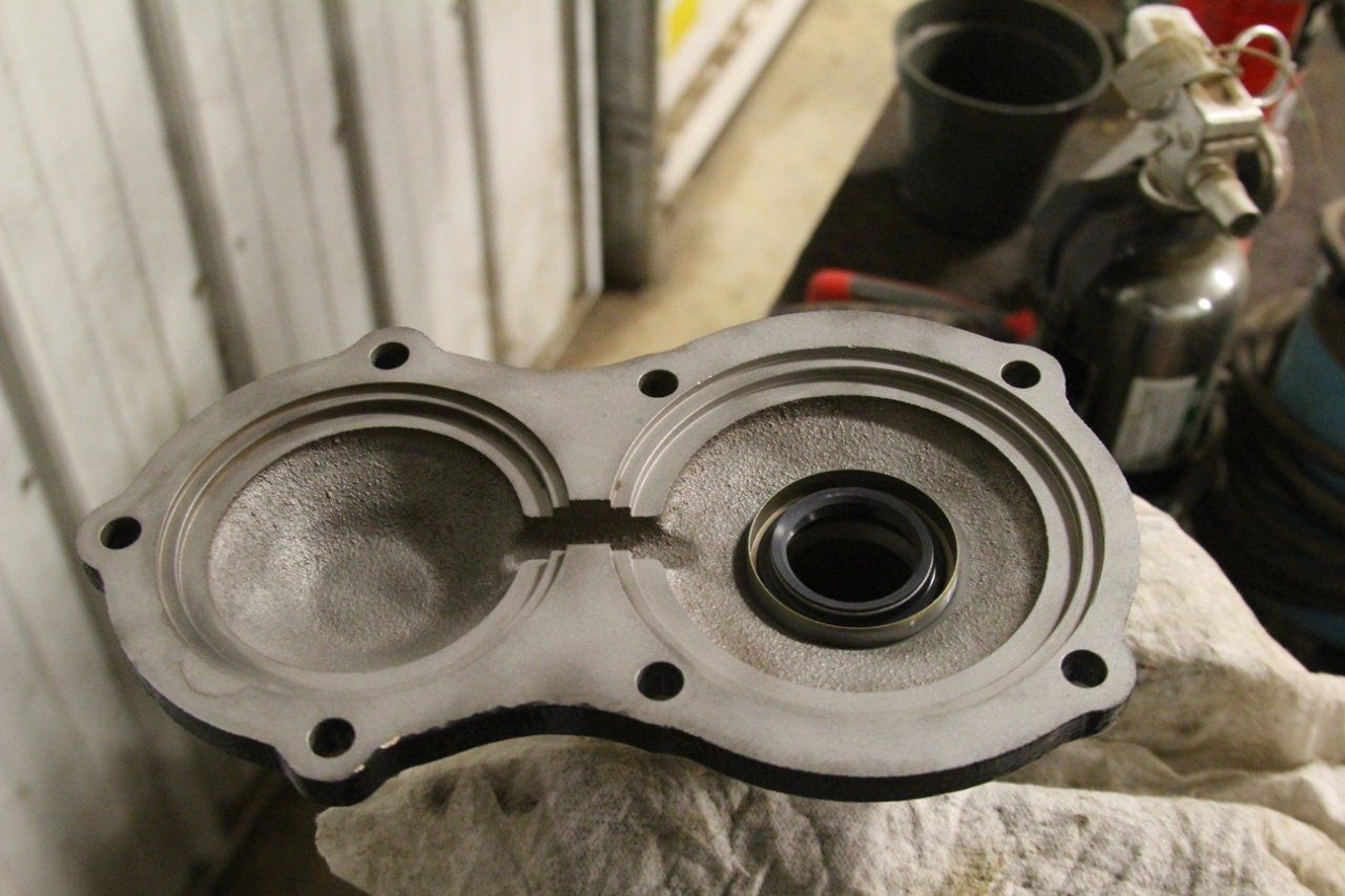

Installation of the input shaft seal in the front cover is a little backwards because you are installing the seal from the backside. Usually you drive the seal on the large face from the "dry" side. . . I found a narrow socket to fit down in the seal to install it from the back. The seal is just sitting on the front cover for the picture and is not yet installed -- wanted to show the orientation.

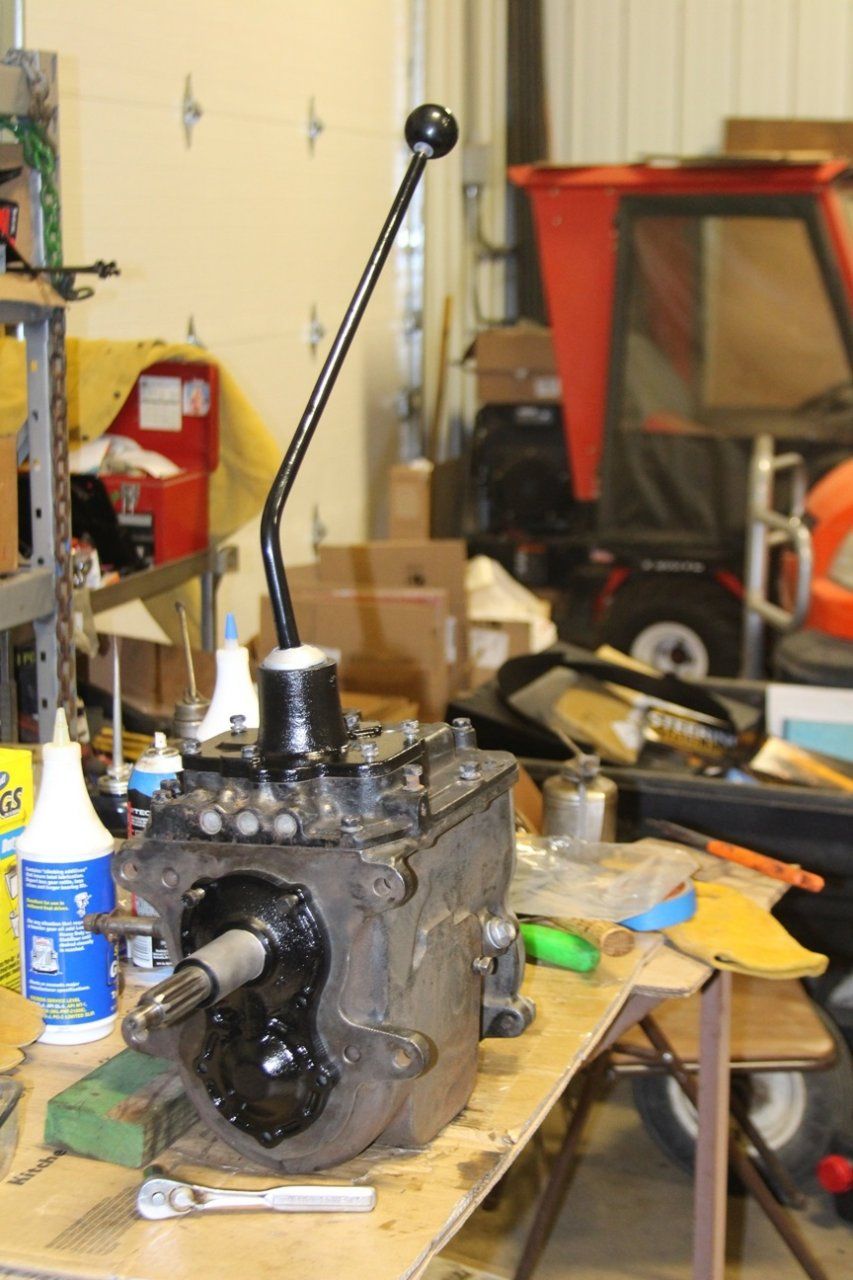

And finally put enough together to test out shifting thru the gears. . . at bench top speeds we are all good! The plan is to clean up a few more of the cover bolts before final assembly, install the transmission on the engine, and then paint. Just ran out of time before the dinner bell rang today.

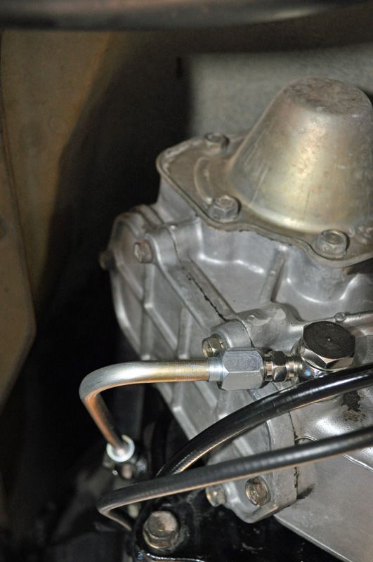

Bypass Tube, Tranny to Xfer
After seeing the bypass hose that used 18mm banjo fittings in my thread on bypass hoses, I was intrigued about their versatility in this application. I took a different approach in that I wanted to see if this could be accomplished using 3/8” seamless tubing and two 18mm banjo kits that had a -6 male 37 degree fitting at 90 degrees. The M18 banjo kits are for a Garrett Turbo.
It took a couple of iteration to find the leg length from the transfer case to the start of the bend and then the bend angle. I use an Imperial Eastman tubing bender model 364-FHB-06 and found that if I left a 3/8” gap between the back of the flair and the frame of the bender and then bent the tubing 97-99 degrees it lined up with the banjo fitting on the tranny. I then marked the tubing at the end of the male flair and you see the results.
The original bypass hose I had made has never leaked and did not need to be replaced. I did this as a design challenge to see if it would work.
What I really like about this design is as follows:
Simplicity
If you have the tools it is a straight forward project you can build yourself
Compact design
Durable (I used Corrosion-Resistant Steel Tubing coated with a thin layer of yellow zinc dichromate)

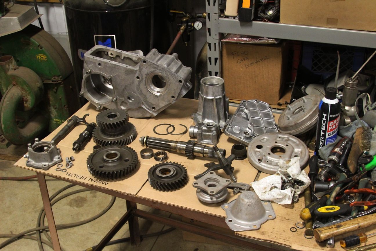

Stepping back in time a bit. . . I had to pull the transfer case from the back of the transmission after removing the stake nut, spacer, mounting bolts, etc. Mostly wanted to post this picture because I more or less had the same puller shown in the service manual. . . that almost never happens!
Set the transfer case on the work table for its makeover. It appears I never had a pto drive gear installed (unless it fell out and rolled away while I was not looking) -- just the drive gear, spacer, and outer bearing.

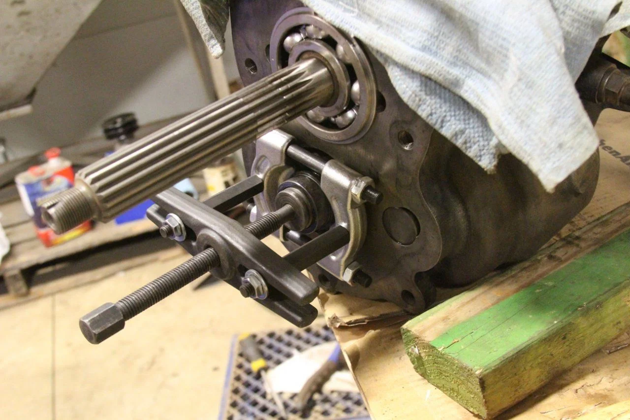

Pulled the stake nut and E-brake drum off. Things do not look too bad on the inside. . . much better than the rear axle drum brakes looked!
Pulled the E-brake housing and speedo drive. I know this is all mostly nut and bolt stuff at this point but the pictures will help me remember how everything goes back together. I will make sure to take the speedometer drive apart to replace the tiny o-rings on the inside as I think that is where one I my leaks originated from.
Removed the speedo drive housing and the front axle drive nosecone and shifting fork. The shifting collar is direction specific; orientation noted.
Moving onto the inside in the next post. . . more to come.
Looking down on the inside one can see the orientation of the idler gear and drive gears. Removing the high/low shifter fork and shaft is not difficult; just pull the cottar key, unscrew the insert to relieve pressure from the spring/ball in the shaft detents, remove the locking tab on the outside of the case, and tap the shaft rearward (downward in picture).
With the shifting fork removed I was able to pull the output shaft and gears. Have new bearings in a rebuild kit from @cruiseroutfit that will be installed when everything goes back together. Tried to take a picture of the placement of each component of the output shaft before pulling everything off.
Removed the lock tab from the transmission case and I was able to tap out the idler shaft. Looks like the shaft had some wear; good thing a new one comes in the rebuild kit. There is a plug on the backside of the transmission case that popped out when I tapped the idler shaft forward, once the plug was out I pushed the idler shaft rearward out of the case. The o-ring on the shaft was letting oil leak by. . . one of the main reasons I decided to give the whole thing a rebuild.
I still have to pull the front drive pinion out of the nose cone but more or less everything came apart quickly. I spent about as much time cleaning up the transfer case as it took to get everything out of it. I was tempted to clean it off in the blast cabinet but I have a "nothing with bearings on the inside" policy when it comes to sandblasting parts. A little bit of time with some solvent and a wire brush cleaned it up nicely. Having a hard time deciding if I should paint it with the Alumi-blast that I used on the starter/alternator or give it a coat of clear. I will probably wait until most of the parts are back on before I make that call.
Will work on getting everything else cleaned up this week and hope to start putting things back together.

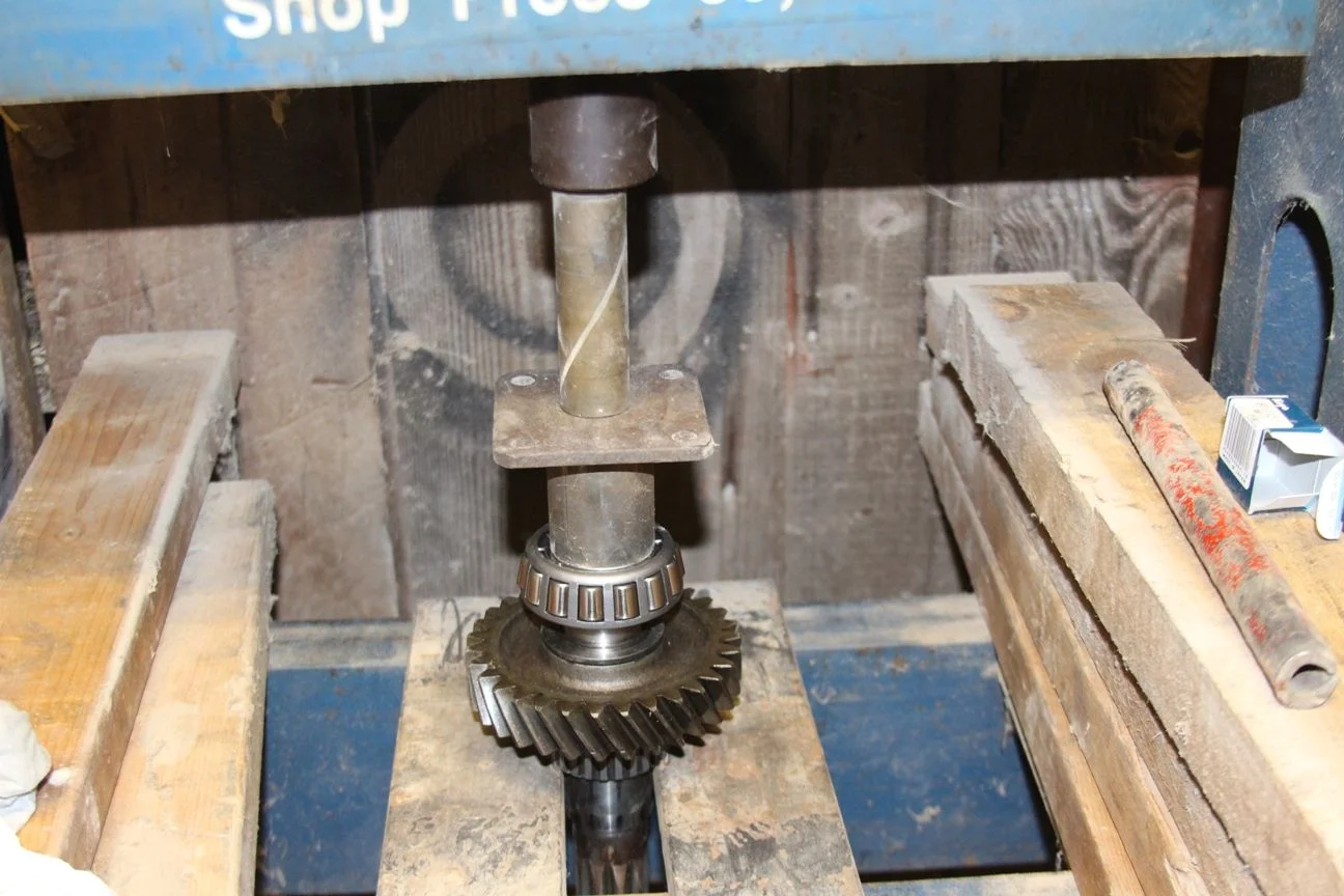

As far as my progress I did paint the E-brake drum, speedo housing, and other non aluminum parts today. I also had a chance to install a couple bearings on the transfer output shaft. I actually used my little baby press to install both the front wheel drive pilot bearing:
And the first output shaft cone bearing:
I pressed in the races into the nosecone and transfer case as well but did not take pictures. . . I think you get the idea.
Sorry about the dusty conditions on the press, it sits in my garage at home next to the chicken house and only gets used a couple times a year. I picked it up at a garage sale years ago for about 50 bucks and it works great for little bearing projects like this when I dont want to beat on the bearing with a hammer. Takes me back to the days when I used the big electric/hydraulic press to pop dozer track sprockets off final drives. . . those took a little more pressure to remove -- in fact I can remember sneaking outside around the corner of the building when parts would be super tight and the pressure was higher than I felt comfortable standing in front of. Even though youd expect it I would still jump when the POP came and the two pieces came apart. . . ahh the good old days!
