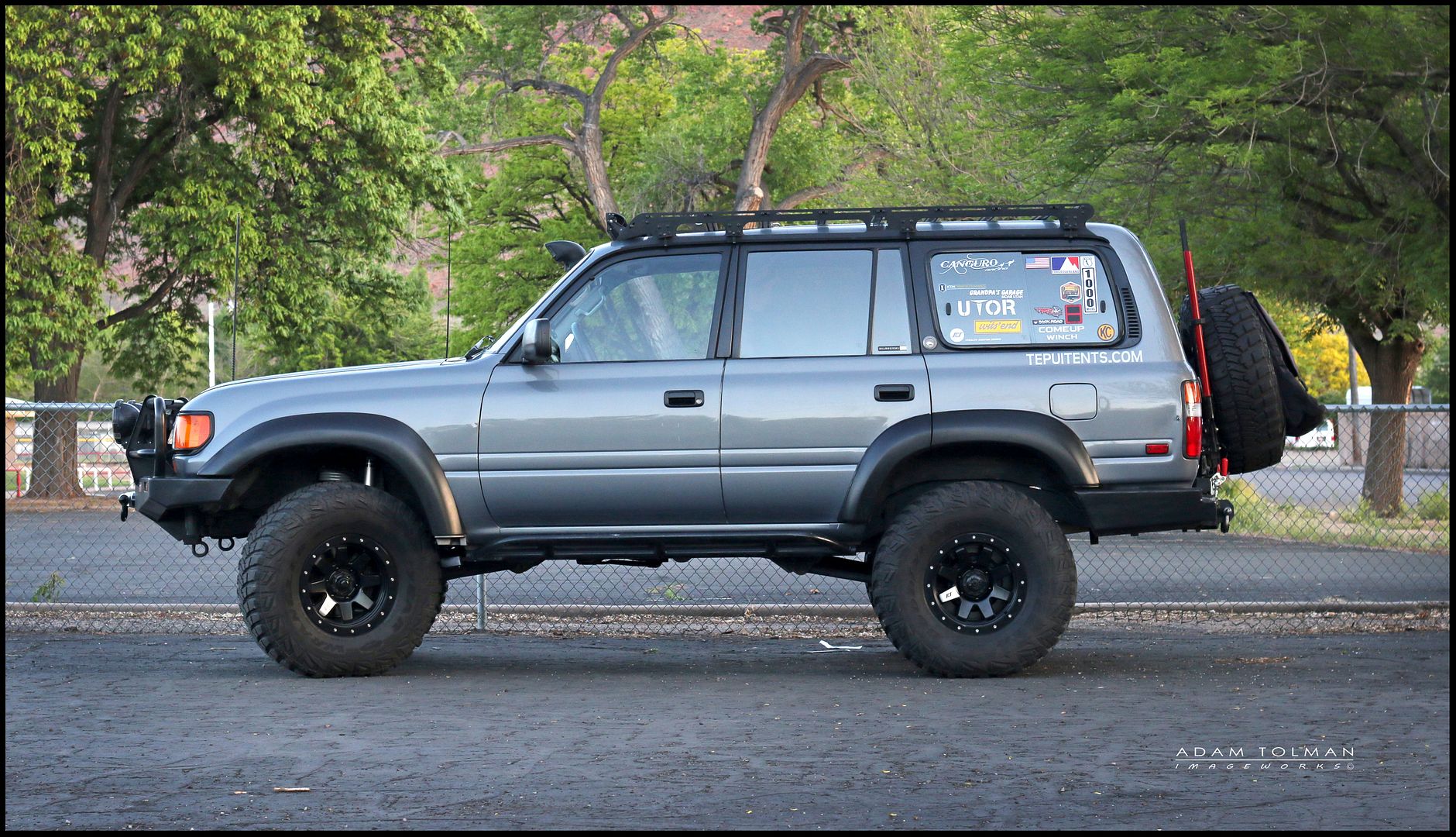

Here's a bit of height comparison of my current 80. First pic is with OME J springs (3-3.5") with 2" coil spacers, OME L shocks. So roughly 5.5" of lift on 35's. Looked good and wasn't terrible in the dirt and went were I wanted.
This pic is after I pulled the OME stuff and installed the stage 1 Slinkys 3.5" with the heavy rate coils, 2.0 shocks, NO MORE COIL SPACER. So I lost about 2" of ride height but gained almost 6" of suspension travel. The decreased ride height made the truck much more stable. As I mentioned in my last post, the performance was a massive change with the Slinkys over the OME. This picture is an empty truck inside.

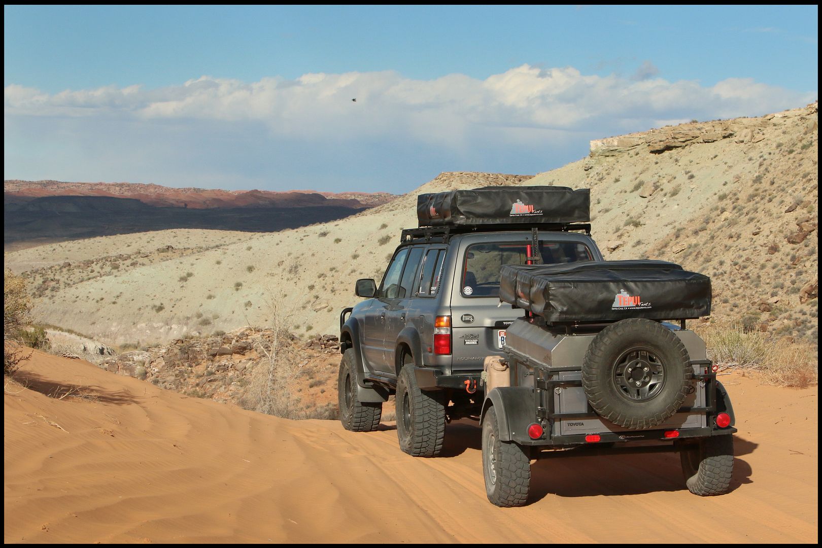

My truck is on the heavy side with bumpers/winch/rack/fridge/CO2/other gear and often a RTT and pulling a trailer. It handles the loads very well with almost no sag even fully loaded. My speeds in the dirt are easily 40-50% faster with the Slinkys.
fully loaded
They flex pretty well too. ;)
