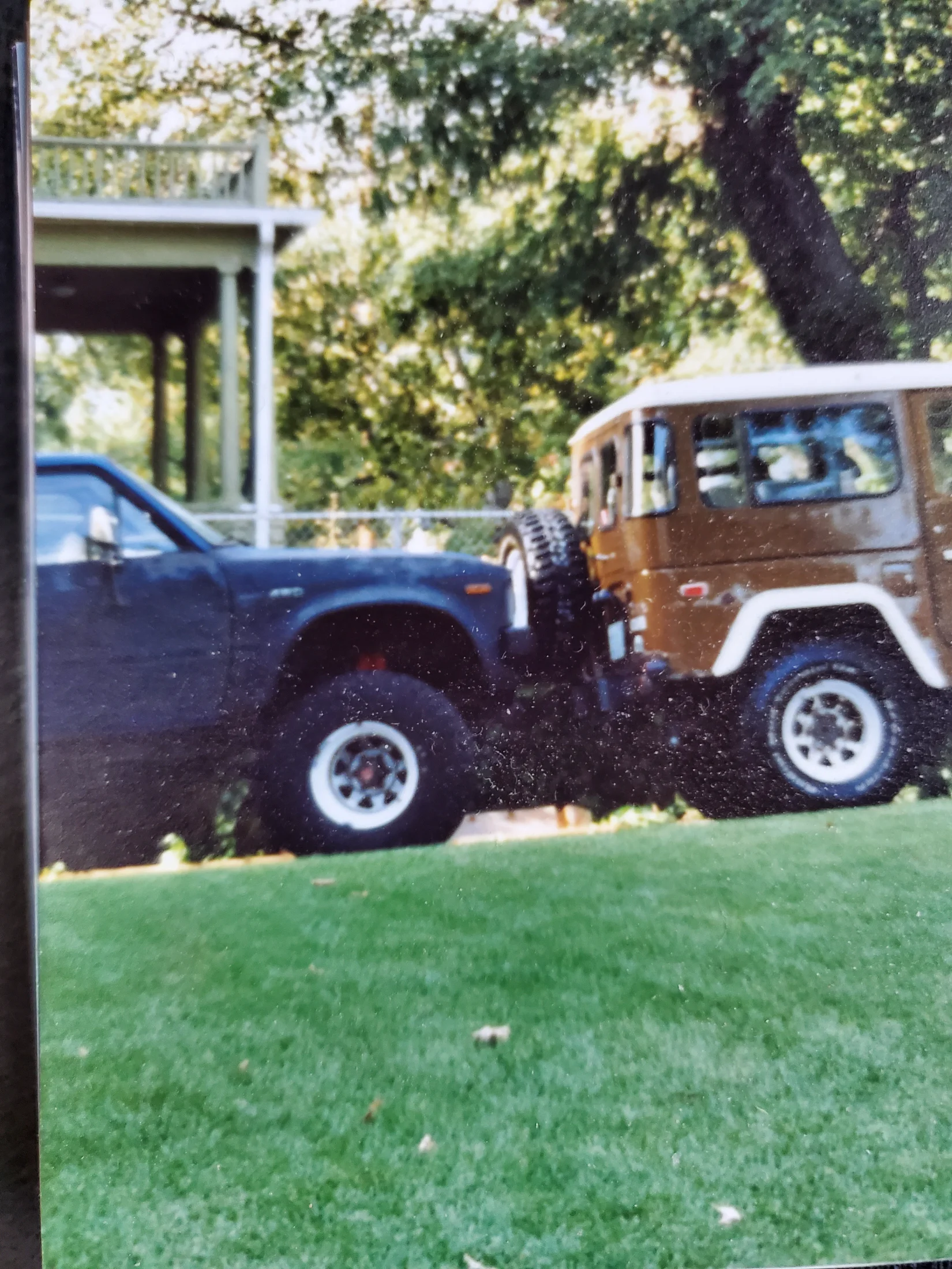

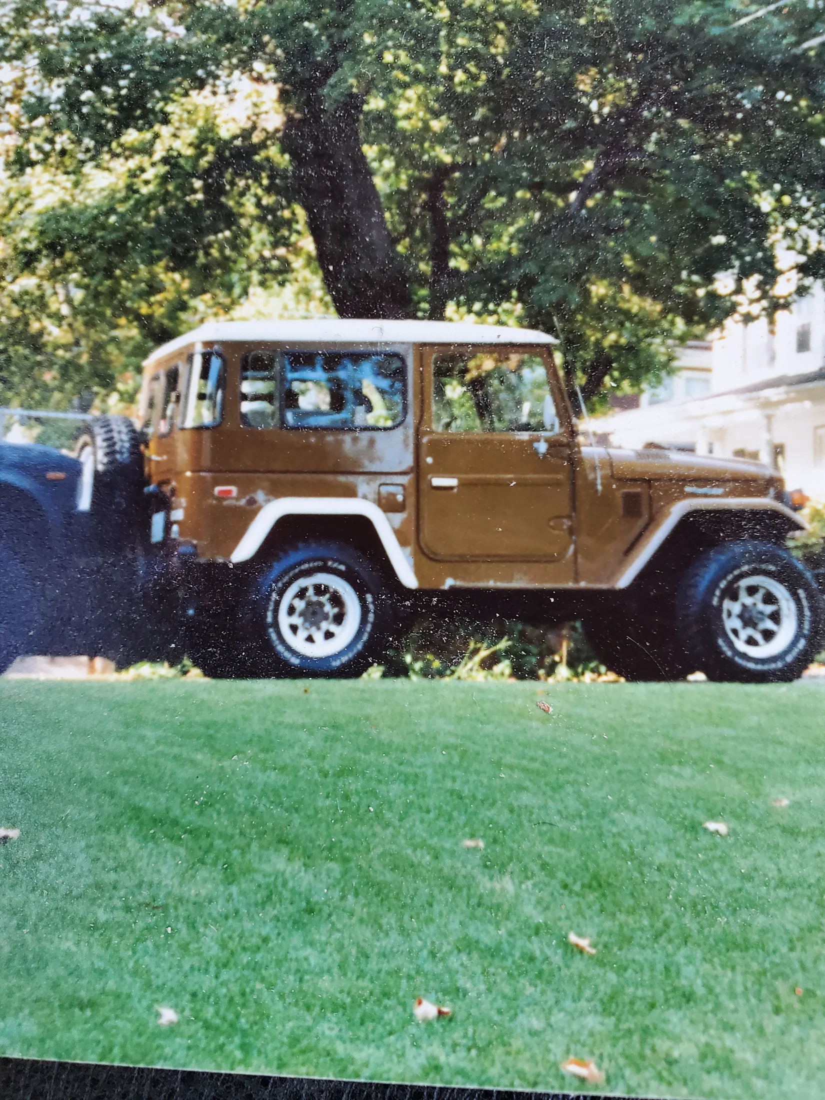

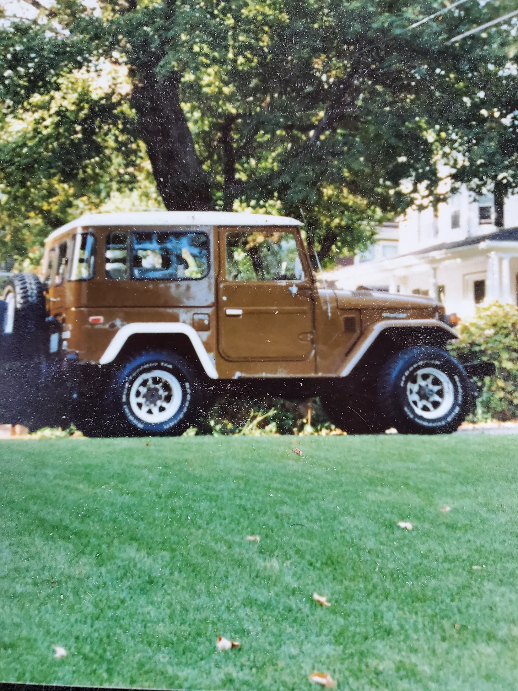

Ran dual KYB's on each corner of me mini truck back in da 80s 😏😉
