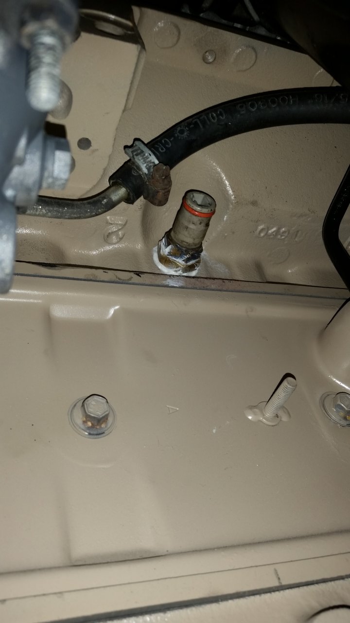

I can’t tell from your photo where this is mounted. It’s too zoomed in to tell if it’s DS or PS. But I think I can figure out where to mount it. Does the A/C cutout switch plug into the amplifier?
Yep that's the drivers side of the block. The sensor remains connected to the factory wiring harness.
