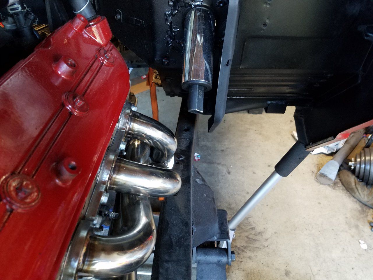

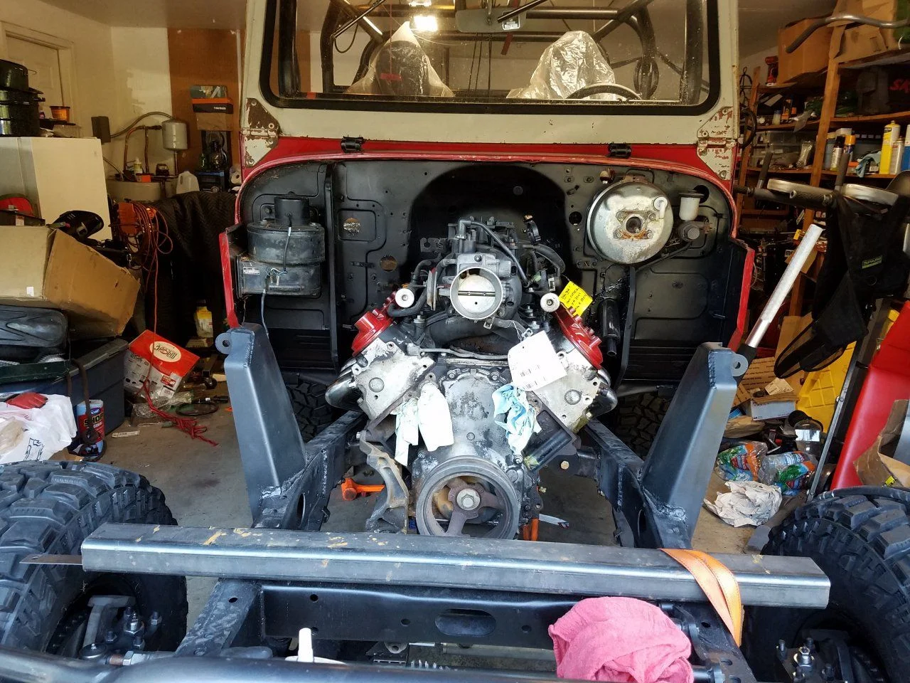

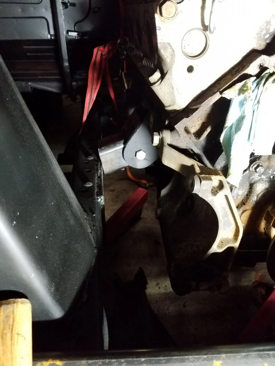

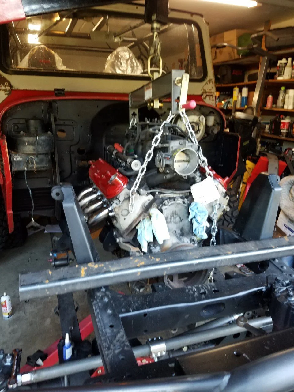

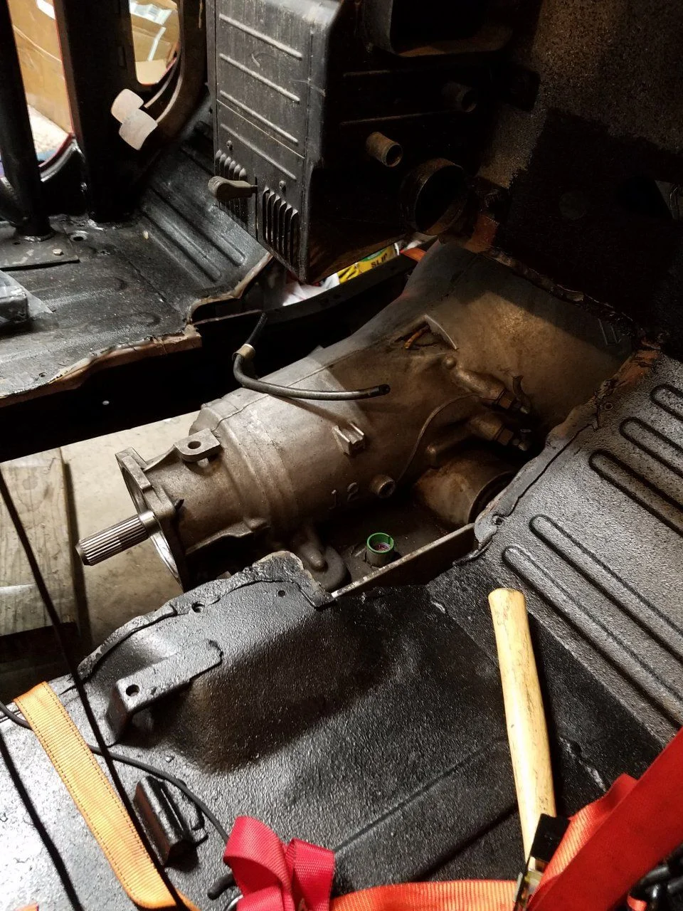

VSS installed into the tail of the transmission and transmission attached to the engine. Engine mounts are almost done, I have some material to remove from the engine side so that there's enough room for the mount to rotate into the proper position for welding.

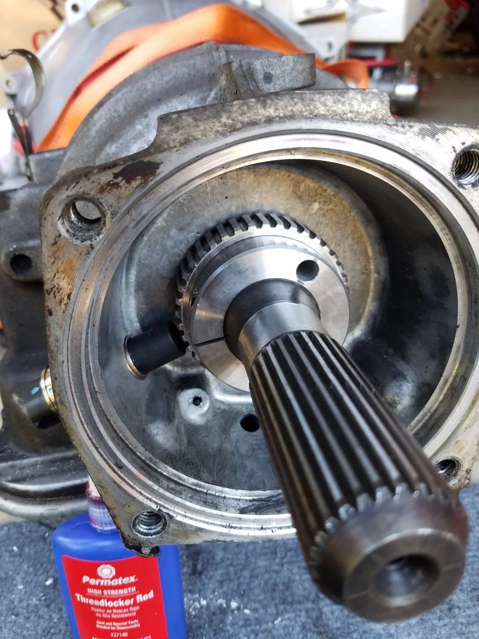

It is coming along nicely, do you have anymore details to share on the vss set up you are using?
It's a kit from Stealth Conversions. Probably the simplest setup out there. Pulse ring that clamps to the 4l60e output, and a stock gm sensor. The only "difficult" part was drilling and tapping for a 3/4 NF thread.

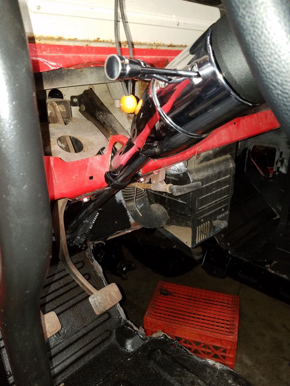

Looking good! Are you planning on keeping the stock heater or are you going with aftermarket?
It's probably easiest for me to keep the stock heater. The gm water pump has provisions for heater hoseso which should be easy to plumb into the stock heater. Aesthetically, I'll have to make efforts to route the hoses properly.
