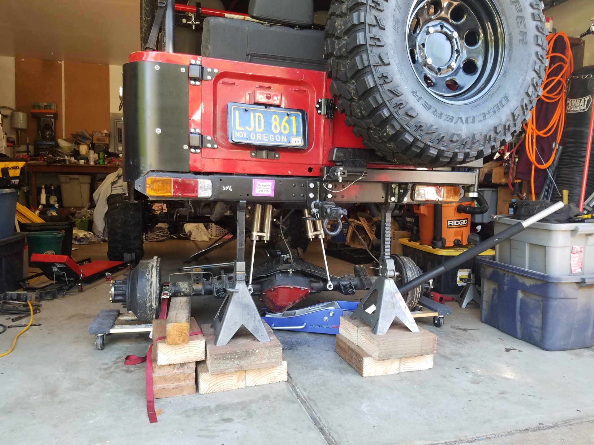

Rear axle is dropped, and springs are out of the way.
Also, I found the transmission issue: the rear tail housing is broken. I'll order up a bare case and swap all of my internals.
