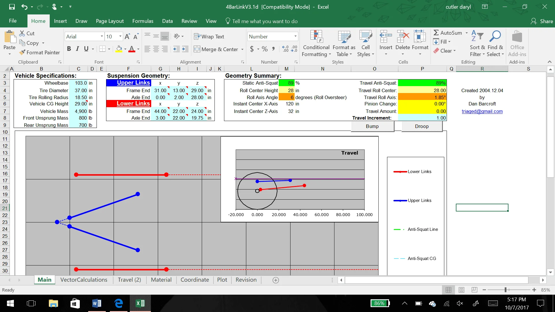

Ditto on link calcs and picture details. Have put off doing the same for years and think I'd be ready to commit if I could afford ORI's.

I'd love to do ORI's, but packaging is a nightmare in the 40 and I don't want to intrude into the tub. Plus, coils and shocks made linking the truck pretty cheap.

Uppers are not set in stone yet, so the calculator is a "rough draft."

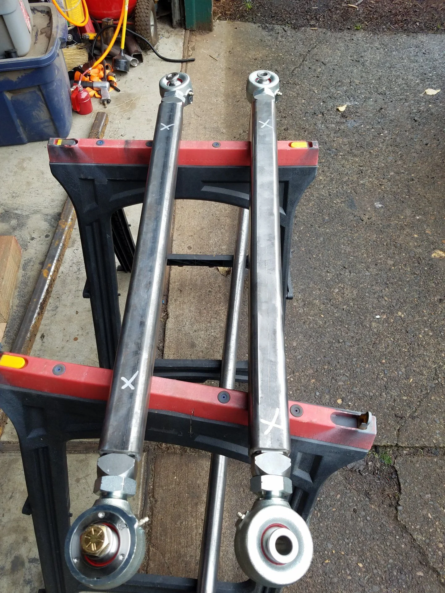

I'm using 2x2 square tube .250 wall seamless for the lower links. I had it already, and it makes good link material. For the uppers, I'm using 1.75" DOM. The uppers don't see impact forces, so the size will work fine.

I've finished the lower links, and am about to attach them to the frame. Upper link tabs are tacked in frame side, so I'll have them in in about an hour.
This has been a blast. My anti squat numbers are looking more like a drag car than a crawler, but what the hell.
And done. Ruffstuff forgot one of the pigtail retainers, so I can't put the springs in yet.

I believe I have 32" of separation at the frame and 4" at the axle. I did manage to get some triangulation on the lower, but it's nothing great. 36" at the frame and 40" at the axle.

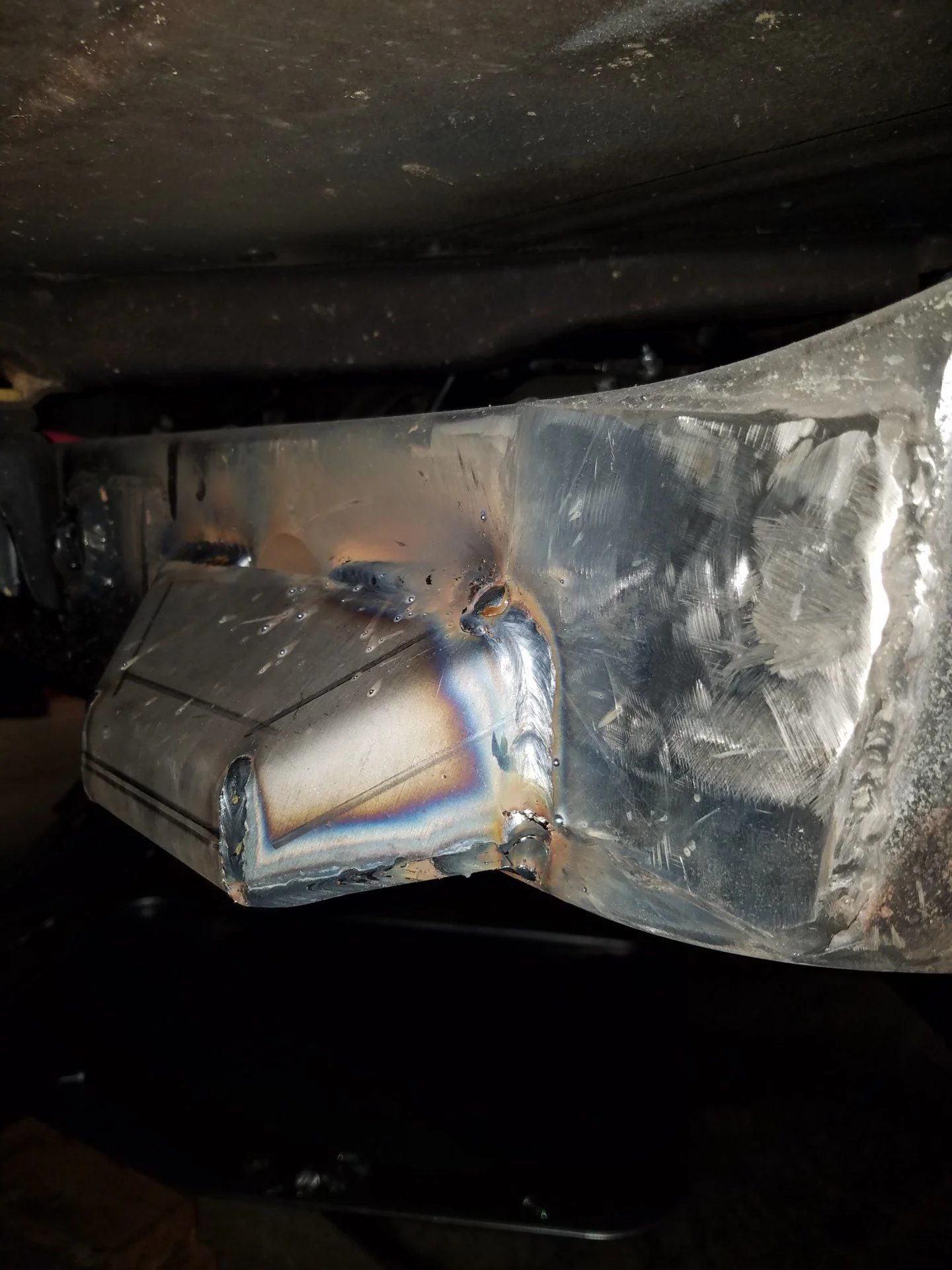

Finishing up the rear crossmember today. Tomorrow will be the install of the new springs, and Friday will be welding the exhaust back together.
